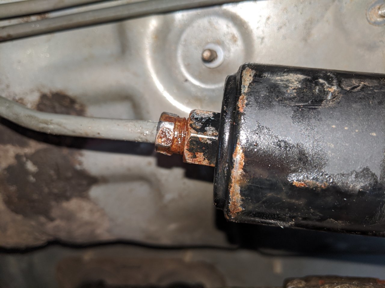

    I figured I would share my series of unfortunate events. I changed all 6 injectors in an attempt to fix my CEL (P0172) and figured I would change my fuel filter too. Well it turns out the fuel filter was REALLY on there and I ended up damaging the nut while removing it.
    Old fuel filter on truck

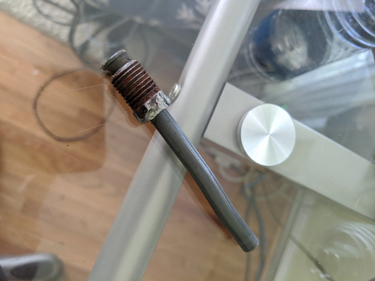

    Fuel line after removal
    I cut off a small section of the fuel line and bought a repair kit in an attempt to fix it. This kit did not work.
