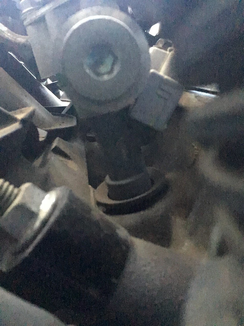

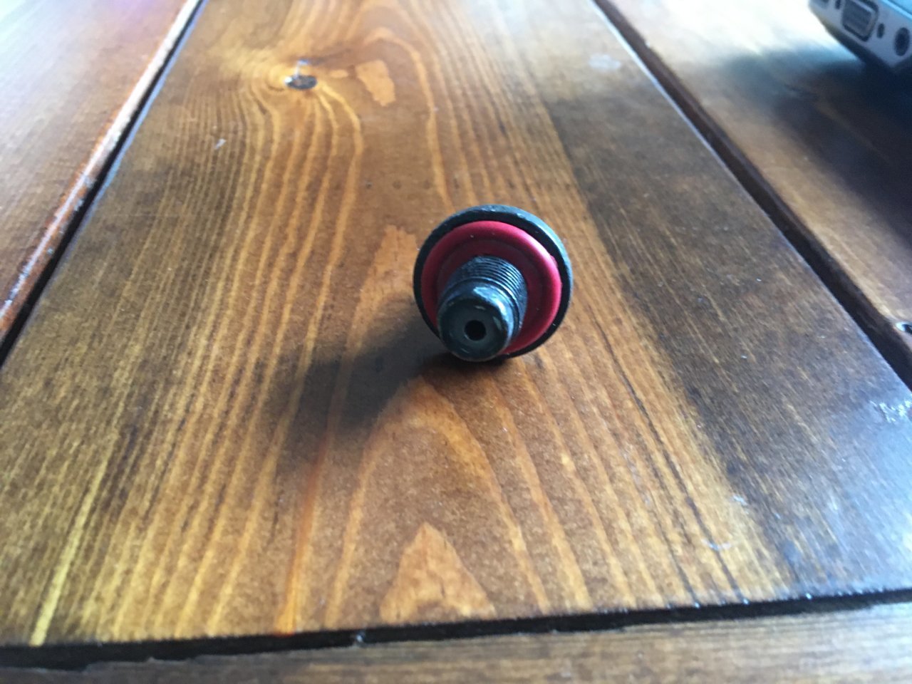

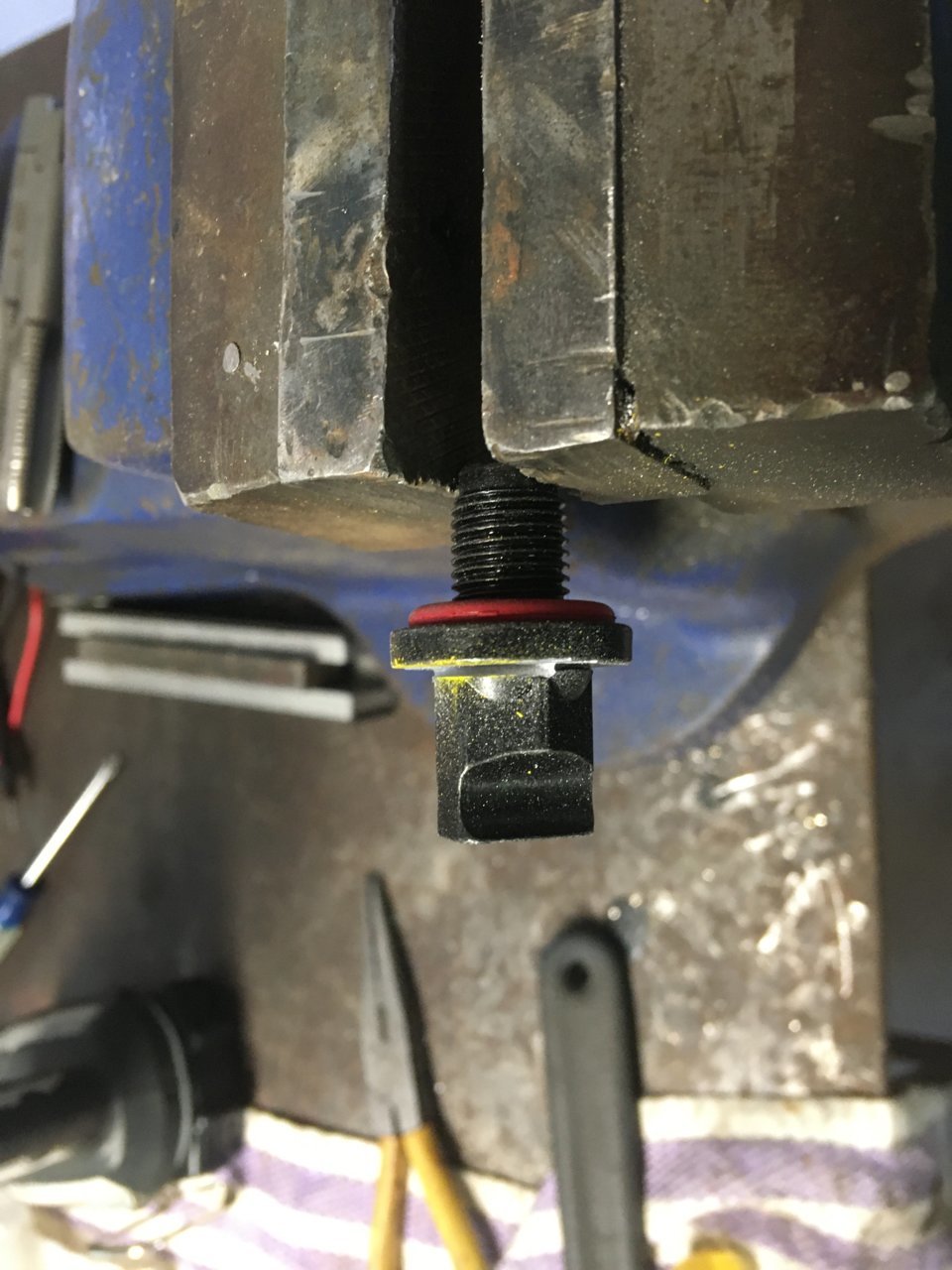

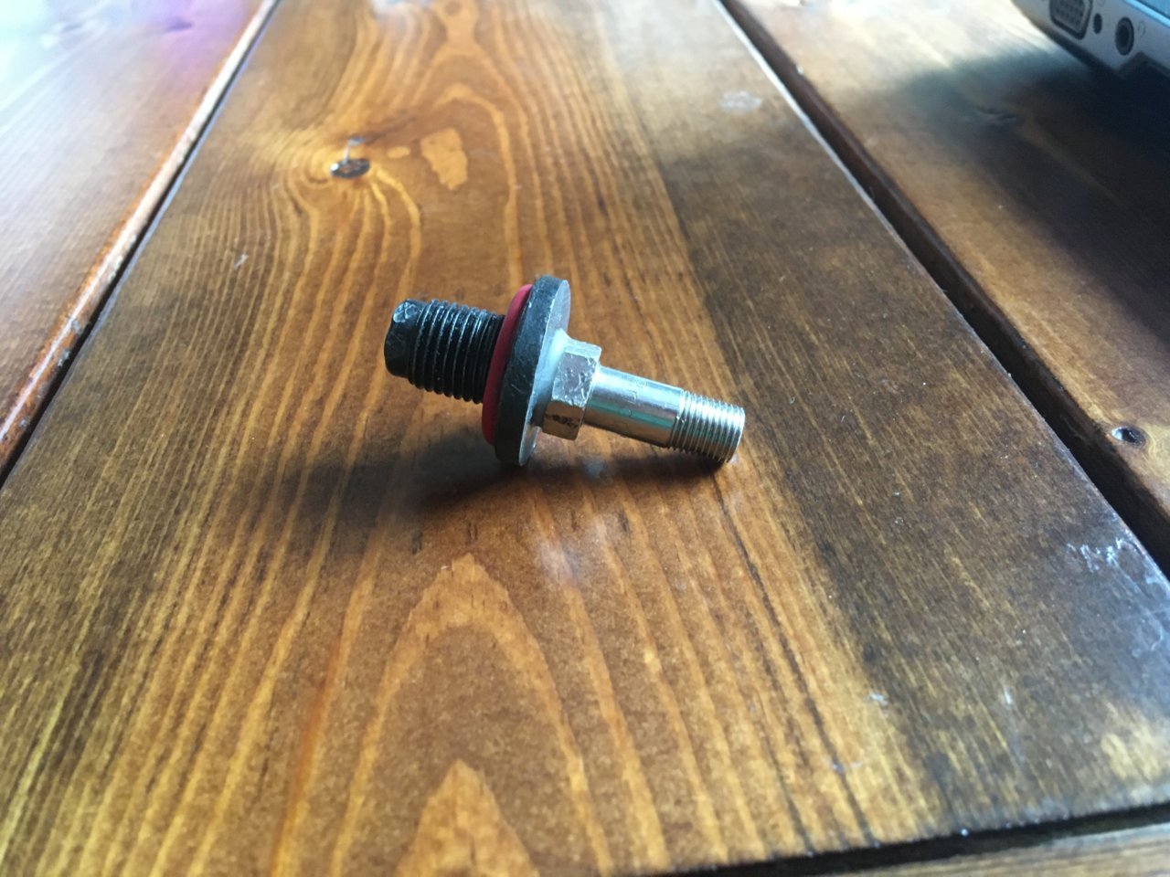

    Thanks all for the replies, very helpful. Ifound a plug at the firewall end of the fuel rail on my 2.7. It says it is the same plug as an oil pan plug. I bought one for $8 and modified it and will take out the plug and replace it with my contraption to test pressure. Fingers crossed! schrader 1.jpg schrader 2.jpg schrader 3.jpg schrader 4.jpg

    Well, I managed to get the gauge attached and I've got 10 psi with my 'new' pump. Going to have a neighbor come over to confirm my diagnosis, then put the 'old' pump back in. Hopefully that will be the end of it. Tried to get the plug at the firewall end of the fuel rail out, but with an old flat faced rubber gasket, I would have stripped out the 6mm hex plug before it let loose. seemed like a good idea. Prolly would be if the plug would have come out. More later. Looking for a couple big lads to help lift the box off,... again!
