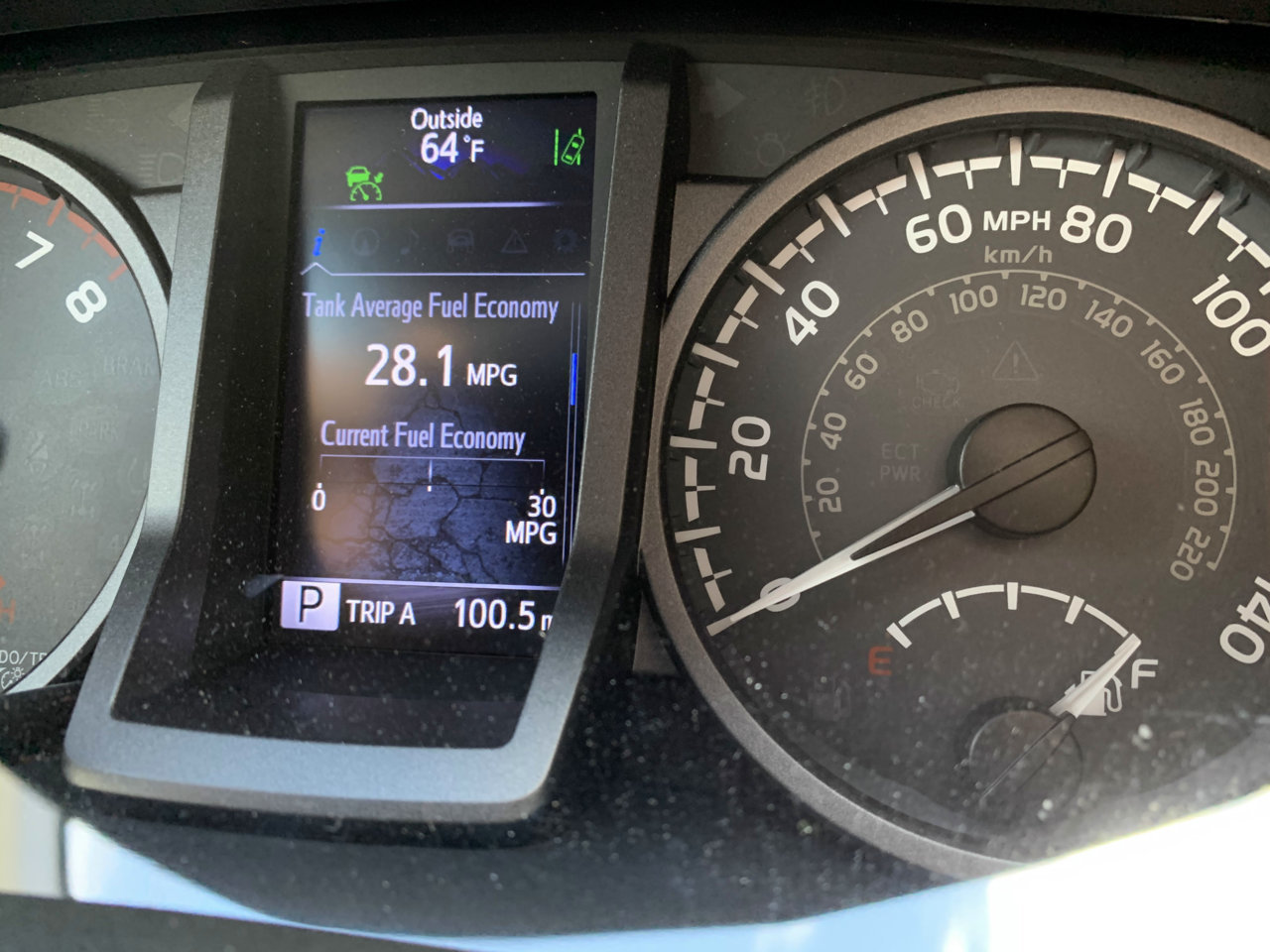

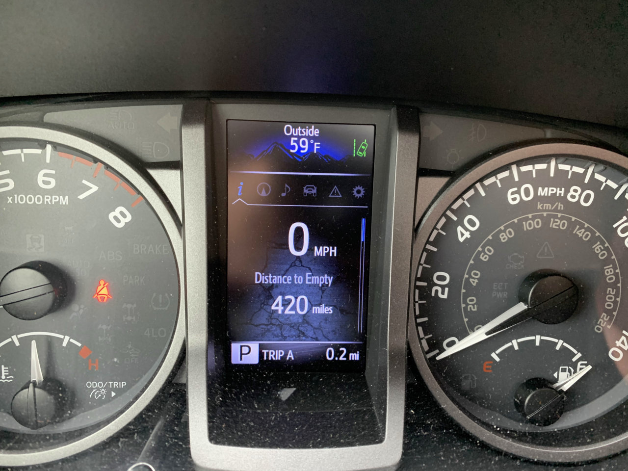

    Got my fuel pump replaced this morning. It took them right at 2hrs to replace it. Stopped by the gas station and fueled up for the ride home, usually the distance to empty is 385 miles. Now it's showing 420 miles. When I got home I had driven 100 miles, looked at the tank average meter it was showing 28 mpg. This cannot be true.

    They disconnected the battery and reset everything, just wait it will go back to normal.

    That's not right. I believe the fuel range is calculated off the sender level voltage input. Your first pic showed the needle way past the full mark indicating the float is reading incorrectly. That would also explain the inaccurate trip miles. I would guess the tank will have to come back down to check for a bent float arm.

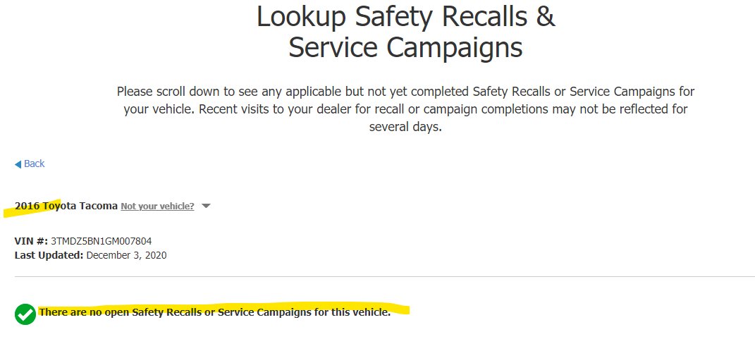

    That's what mine shows also but it's not correct...the recall won't be updated for the '17 until dec 23
