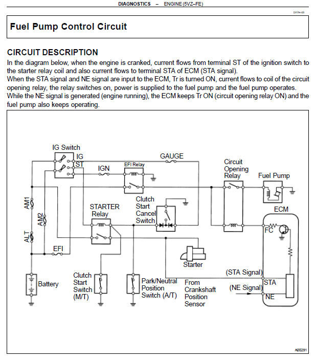

    Does anyone know if the fuel pump turns on when you turn the key to "on" (aka the vents, and other electronics begin to run)? Sometimes I get a stumbly startup but it's rare. Thinking maybe if I let the fuel pump "prime" that it could alleviate this issue.

    It will come on when the key is in the on position, you can probably hear it running
    dirty deeds likes this.
  6. Feb 21, 2017 at 9:18 AM
    Dirty Pool
    Dirty Pool FLIES ON THE FRIES, KETCHUPS WATERED DOWN
    Mar 24, 2013
    #100471
    2,266
    59.4 Miles, 56.67° NE Of Moab
    99 XCAB V6 MT TRD
    Dirty Pool rear bumper/air tank with integrated spare CV shaft storage, DP customized TJM front bumper, 8000 lb Ramsey/Technora rope, E-locked, Extended breathers with front diff catch can, PCV catch can, SAWs with DP heim joint seals, DP custom 6 leaf rear springs/Billies, DP custom skids, 2lo, Gray wire, Cap, Bed Rug, Black steelies, 01 Center console, Map lights, Disraeli gears
    "On" will not start the pump.
    "Start" will start the pump but it will not maintain it when key returns to "on".
    The crank sensor signal (V6) will maintain the pump on, cam sensor on the 4 cyls.
    The cam/crank signal will initiate and maintain pump operation without the starter (STA) signal at all, as in push starting a manual trans truck (key on).

    I know, I should have this diagram on speed dial by now.
    Even though it seems to imply both crank and start are needed together to start the pump, not the case.

    Thanks a bunch. I won't be wasting my time with leaving it on the "on" position for a couple of seconds then :)
