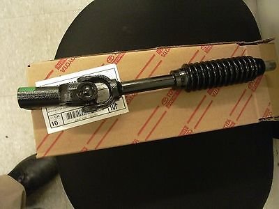

    What exactly should I be looking for? Something loose? Etc

    The joint is prone to rust. Do you have any play in the steering wheel? Grease the shit out of the joint and turn the wheel full lock back and forth. If it fixes the stiffness, that's your culprit. If you do have play grab the top und of the shaft and twist it back and forth while looking at the joint. On mine I notice the play was in the joint. I also did have like 1 1/4" play in the steering wheel.

    Play as in loose or play as in no direct steering feel compared to something more sportier? I have no loose play if that's what you mean. I'll check it in a little bit.
