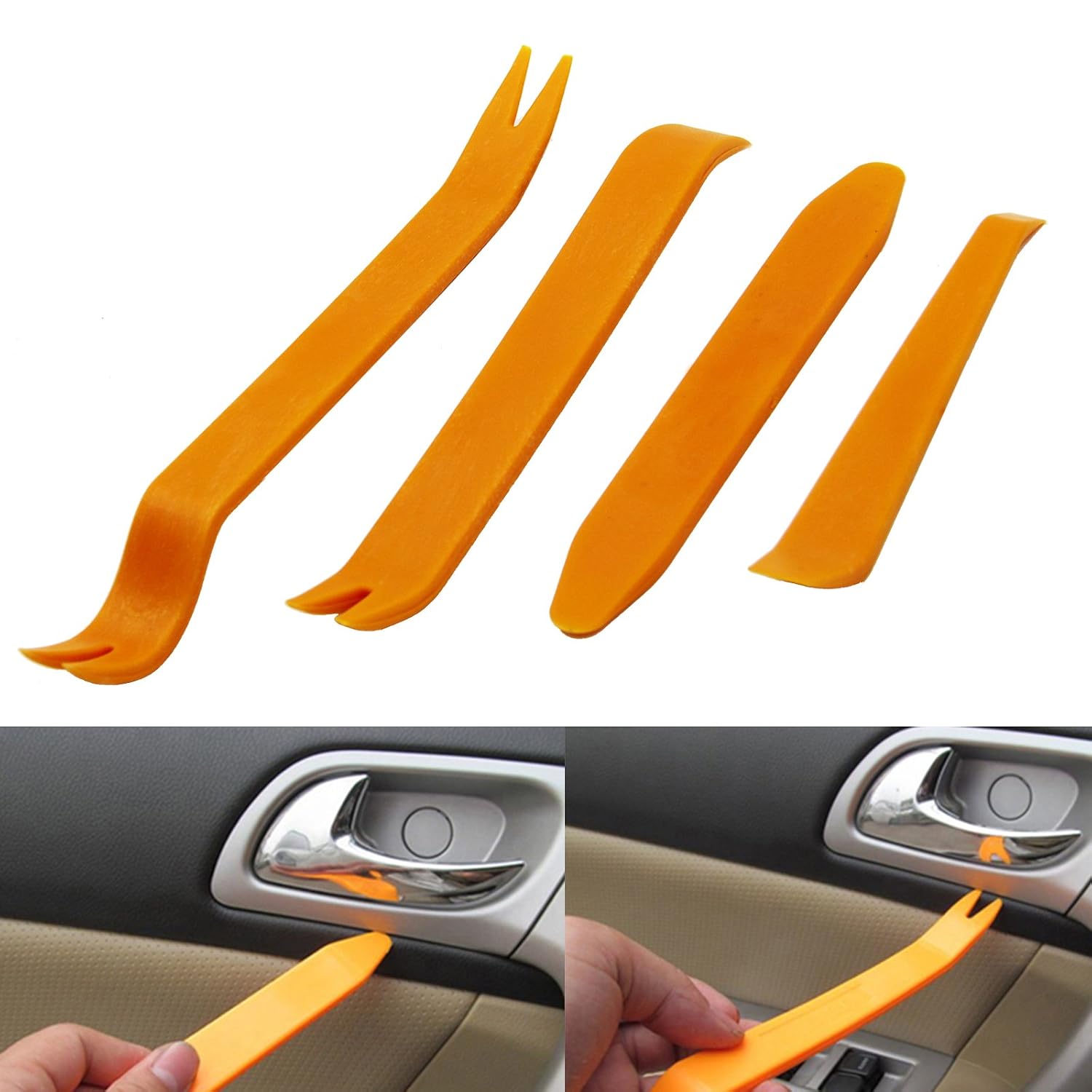

    Yep, I just repaired mine. Takes about 5 minutes. I used a small plastic panel pry tool to force the lip of the gas door back ever so slightly until I had clearance. Here is a similar tool being sold on Amazon.
    https://www.amazon.com/AURELIO-TECH...385787&sr=8-5&keywords=plastic+panel+pry+tool
    In the picture, I used the second one in from the left. I was careful with my tool placement and gentle with the force I used to minimize any chance of bending something I didn't want bent. I still need to get in there and repair the scuff marks but it is opening a whole lot easier as well.

    Thanks for the advice! I ordered the pry tools and will fix tomorrow. Will be sure to oil the hinges regularly now too. I never even thought to do that before!
