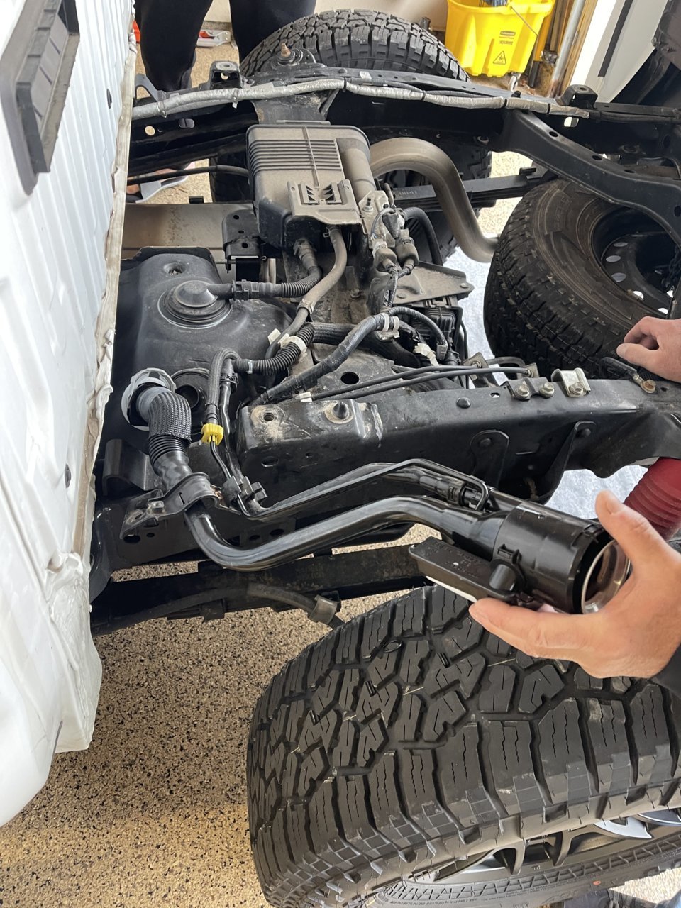

    I know this thread is old, but what part number is the filler hose assembly? I see 77201-04150 in the one picture, but everywhere I put that in it just shows the upper portion. Does that include the lower portion also?

    77201-04150, is the part I bought. It the fill tube from the fill cap to the gas tank.

    Thanks. I just bought it yesterday and it is correct, contradicting every parts diagram I could find on the internet.

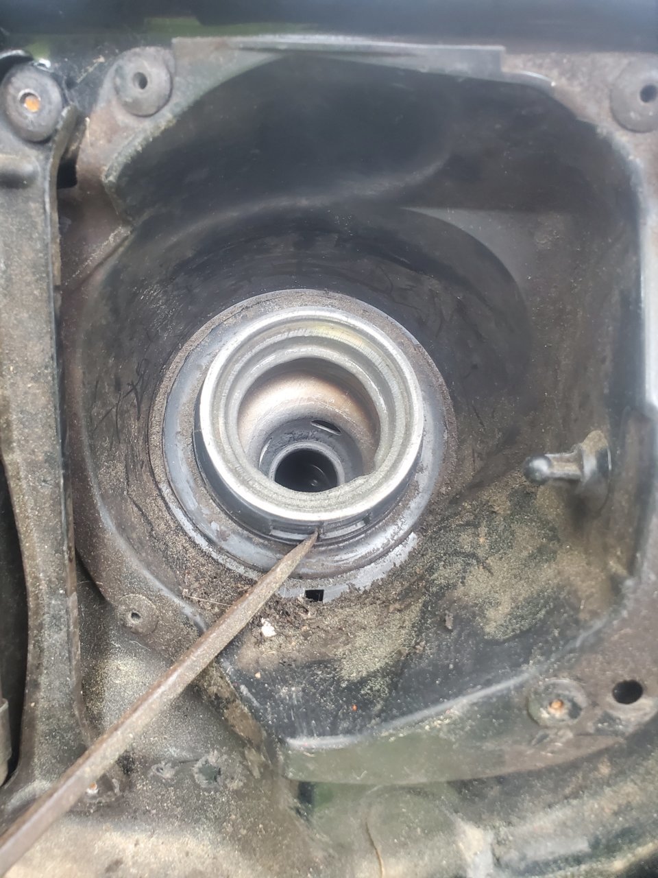

    How did you remove collar

    How do you remove this?

    I'm Doing mine right now and all I did was remove the bolts on the inner part of plastic around the fill tube and just pulled it out.
    without the bolts it's just a rubber seal around the fill tube holding it on.
    yours looks a little cruddy - I would put the cap back on and clean it real good first...also yours may be a little stiff by the looks of it.

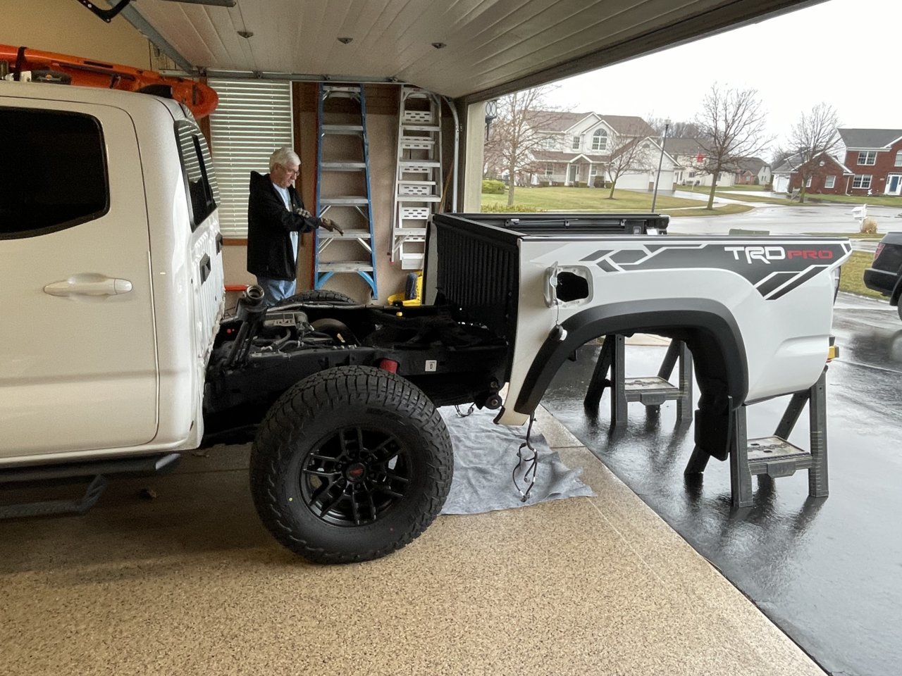

    I just joined the "poked a hole in my filler tube" club and thought I'd share my experience so far. Like everyone else I drilled holes for the tonneau cover drain tubes and i looked at the bottom of the bed before drilling to make sure nothing was directly under. Used a 1/2" paddle bit to drill the holes and unfortunately on the drivers side i pushed a little too hard at the end and it broke through sooner than I thought it would. Looked under the truck and didn't see anything leaking so I thought I was ok. A couple days later I started getting check gas cap messages on the screen and then a day or so later got a check engine light with EVAP code. Was processing it in my mind and figured out I must have put a small hole in the fuel hose. I had not found this post at the time and figured there were two options to replace it, drop the fuel tank or pull the bed. I watched a video on pulling the bed off and it seemed pretty straight forward so i went that route. Took me about an hour to remove the bumper, tail lights, detach the wiring harness from the bed and unscrew the (6) T55 bolts securing the bed. Currently its completely ready to come off and i went to pick up the replacement filler tube this morning but the dealership ordered the wrong part. So looks like I will be working on it tomorrow. After reading how little room there is to work I'm kinda glad I'm removing the bed and it should just be a quick swap and put the bed back on. The bed feels pretty light, I lifted one side of it myself but I'm planning to have a person on each corner just to be safe and then set it on sawhorses while I replace the tube. I'll post more pics when we have the bed off and maybe this will help someone in the future with deciding which route they want.

    The MX4 is an awesome cover. if i had to do it again, I would maybe pull the rear wheel and the fender well and then put a board or something else under the bed where you are planning to drill. Its not like the hose is right up against bed but the problem i had is that bed is a really tough polymer and took a bit of pressure to get any bite on it. I used a 1/2" paddle bit and at the last little bit it popped through faster than i thought it would and the bit fell through a couple inches and hit the hose.

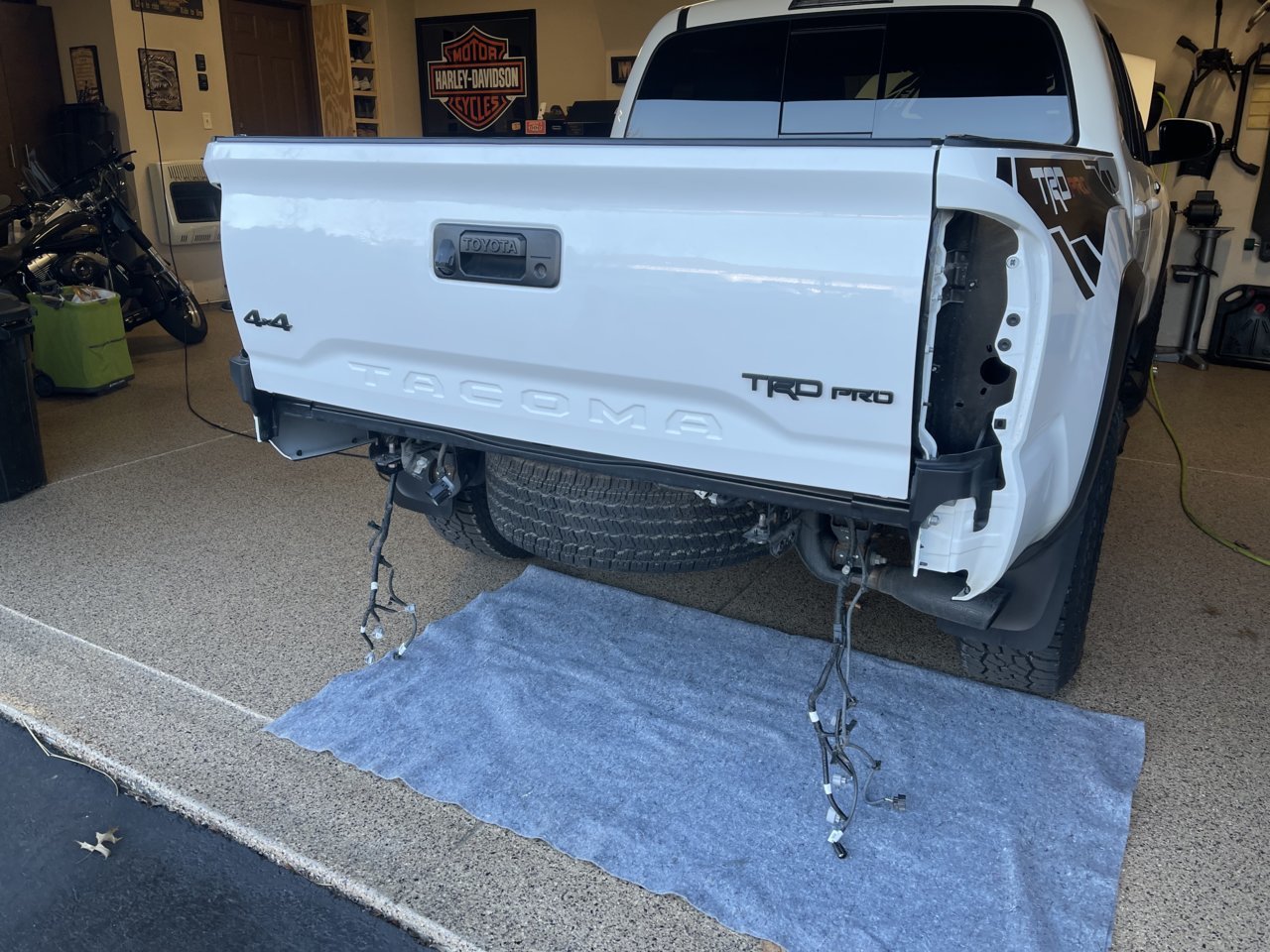

    Well. Pulling the bed went pretty smooth. It may have been a little more prep work than dropping the tank but it made replacing the filler tube a piece of cake. That part only took 10 min tops. Bed was light. We set the front of the bed on the rear of the frame and then rear of the bed on sawhorses. Reassembly was as easy as taking a apart. Everything went back together and no more check engine codes
