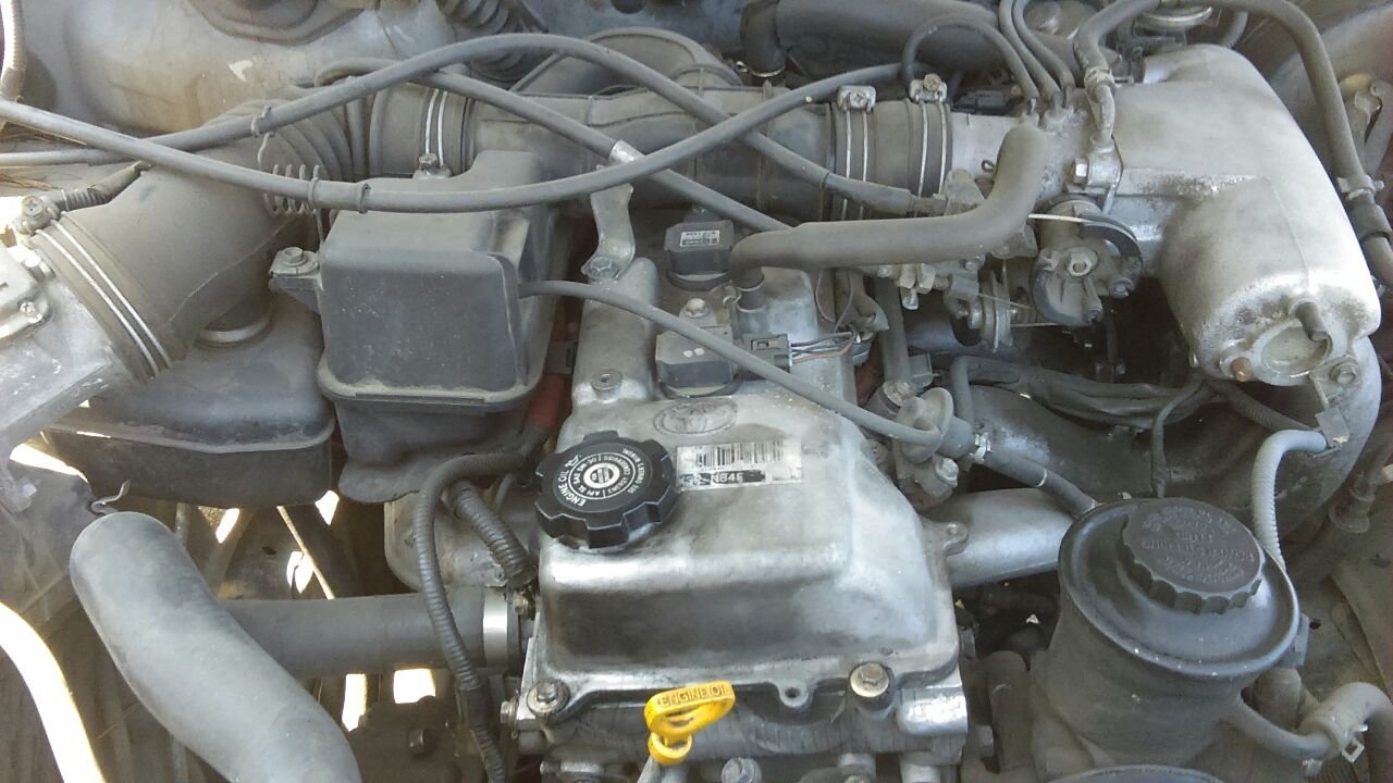

    Is there an area in the specifications of a JDM engine I can look at to compare my engine to a jdm and ensure compatibility. The accessories look decently different and I can't for the life of me make out what that extra metal tubing in the front is.
    My Engine:
    Vs an engine I'm looking at:
    I also still don't understand the difference in some of these engines and why someone will put 2000-2004 or 1997-2003 for compatible years.

    one difference that I know of is the 4 cels can be 4 port or 8 port heads... what years were what I do not know atm.

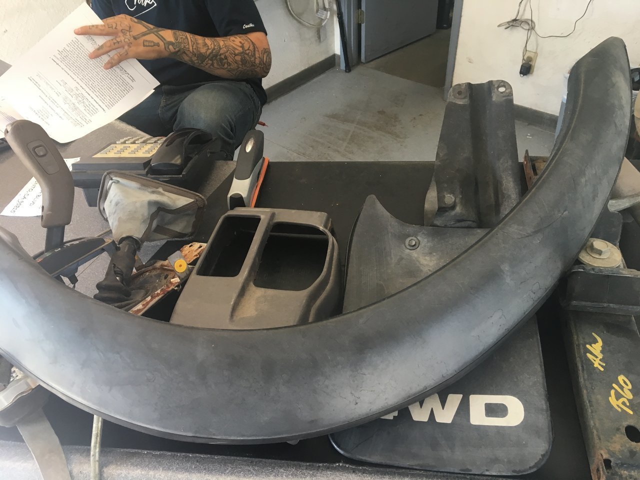

    Gee that's a lot of money for a 3RZ... if you're near Reno, NV I can recommend a good cheap full service junkyard with rows and rows of Tacomas. I got my A340F with transfer case there for $450.

    I needed parts for my 4WD conversion (which I'm doing this weekend!) I called tons and tons of junkyards here in Cali and they all either did not have any Tacomas at all, had Tacomas - but 2WD, had 4WD Tacomas - but charged exhorbitant rates for the parts. Since 4x4 is really unnecesary in the Pacific Northwest 4WD trucks and vehicles are very very rare hence why Cali charges an arm and a leg for 4x4 Tacoma parts. For example, the huge Toyota scrapper in Sacramento wanted $600 for an A340F w/o transfer case plus a $100 core charge.
    I called this yard up in Reno and they wanted a whopping $250 for the exact same A340F, and an extra $200 with the transfer case. Paid a total of $475 with core charge for a complete 4x4 transmission which would have costed me $1,000 plus here in the bay area. It's full service too so you tell them what you need and they take it out for you and if necessary load it with a forklift.
    Shoutout to my man Jeremy at NNAWG Reno Airport. Let 'em know "the guy who drove from San Francisco" sent you, lol.
    They have like a million Tacoma, no exaggeration. Tons of 3rd gen 4Runners too. Lemme find a pic.

    @MikeWH
    That's ALL Tacomas and 4Runners
    My Haul:
    Drove it all the way back to San Francisco
