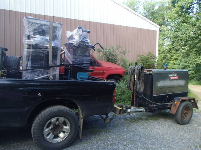

    2000 Work truck 5 speed 4x4 3.4
    Super Springs
    I haul loads like the OP and at times pull another 2000 pounds at most .
    I like my Super Springs with the weight off it rides like a normal Tacoma 002.jpg
