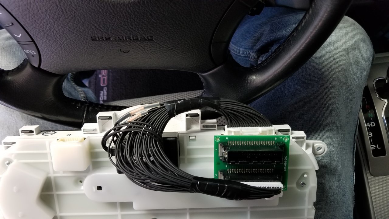

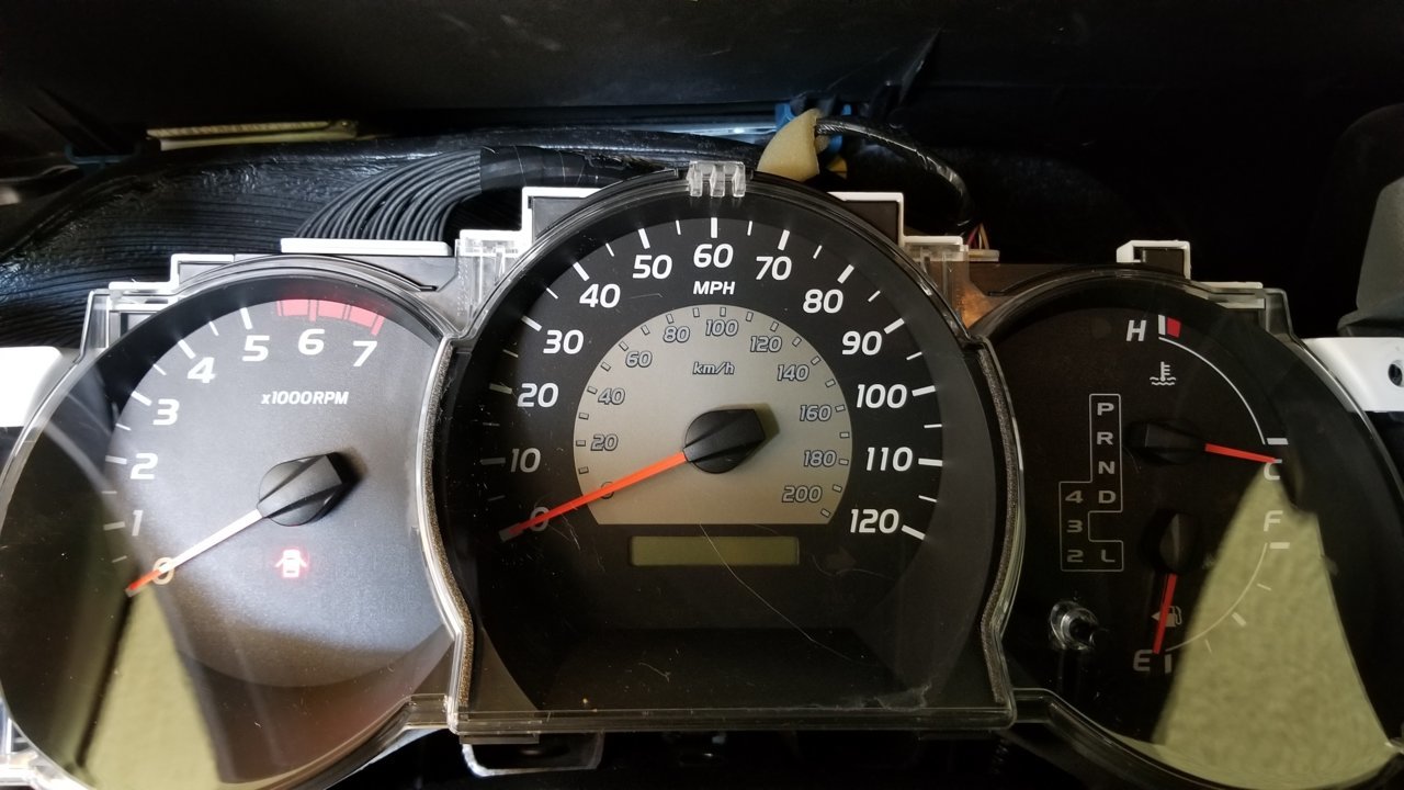

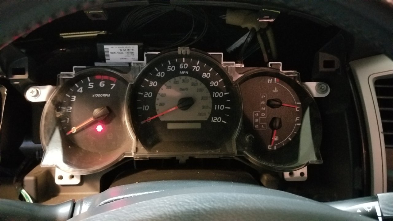

    This is how I had the Hypertech "installed" for testing. You can see the actual control module in the top left. It was loose there and could be unplugged, removed, reprogrammed, and plugged back in for testing.
    After all of the testing and programming was complete, I mounted the Hypertech PCB and controller module to the back of gauge cluster with double sided mounting tape.
    It all went in without bunching or pinching and the clearance was good.
