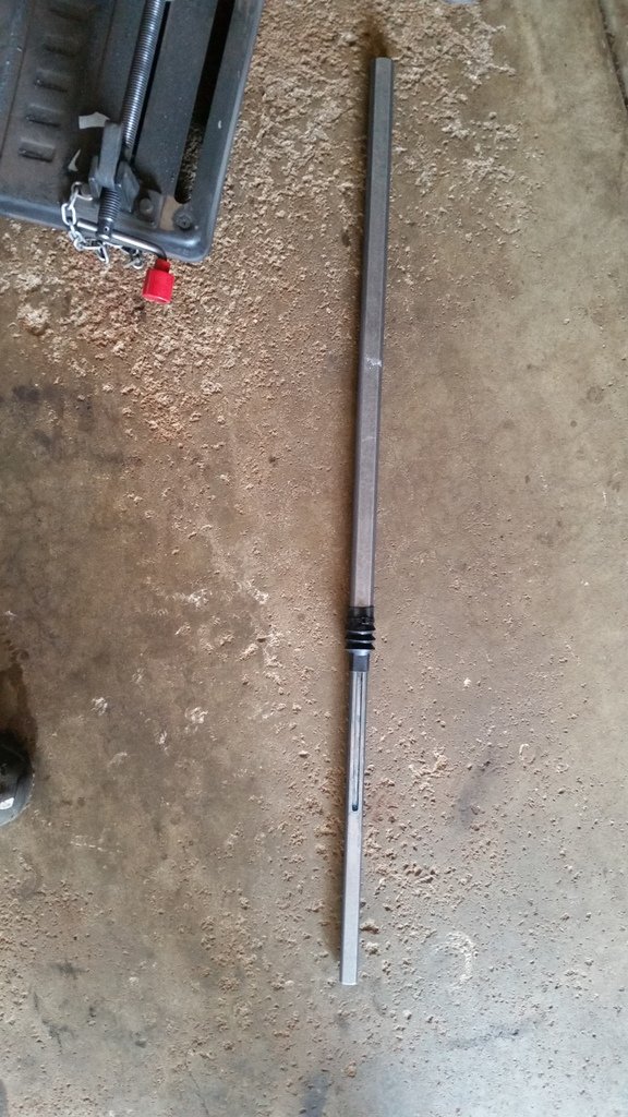

    Time for a pic heavy update:

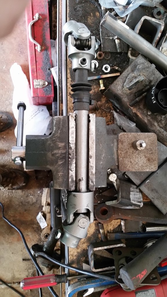

    I made my steering shaft, i started with a 37" borgensen collapse able DD shaft, and had to cut it down to 13" LOL.
    Chopped down

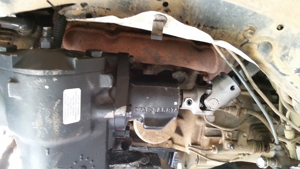

    Steep ass angle at the steering box.

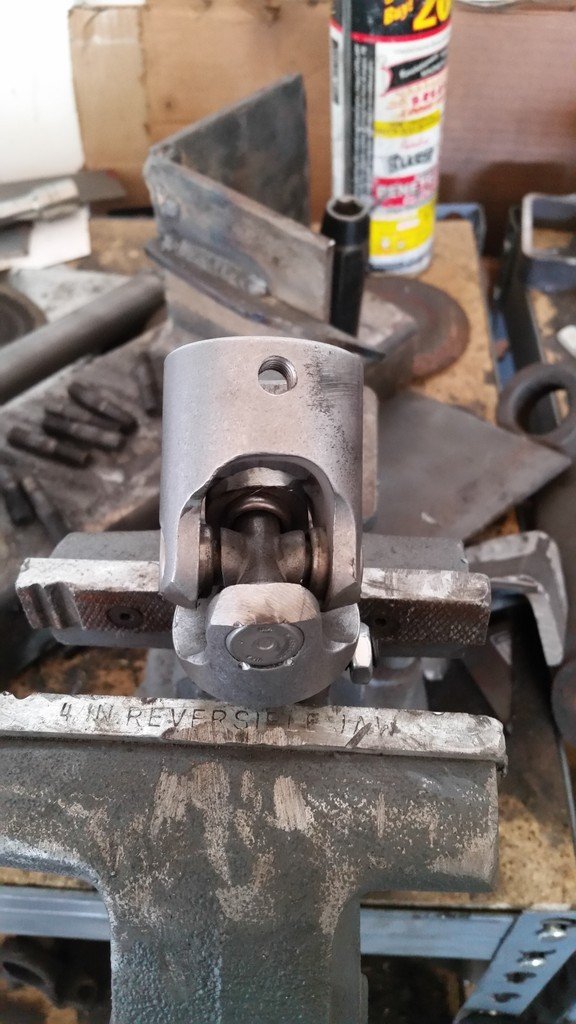

    I ended up having to grind down the yokes:
    Now it works great, no binding.

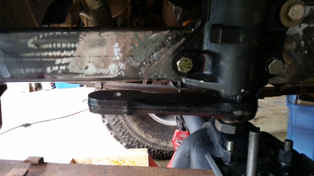

    Next up i test fitted the pitman arm and i am going to have to notch the frame and install a piece of 2"dom cut in half. I did that tonight, and its embarrassingly hack so there will be no pictures of that LOL.

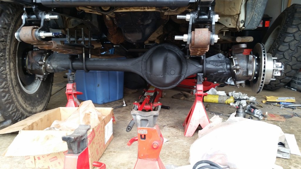

    I also fully built the front axle, everything is greased up ready to rock. It took me 2hrs to center the axle shaft in the spindle and set the pre load on the pax side, drivers side was dead center and pre load perfect with the stock shims. I'm just glad the axle wasnt bent to hell and i put it back together straight.

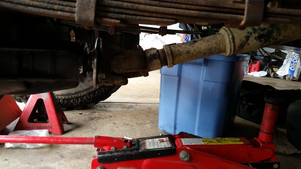

    The stock IFS front driveshaft fits perfectly, i am sure im going to hate that it hangs below the springs, but there's no changing that now.

    Thanks ZUK, ill keep that in mind. Its a DD shaft so they may just be setup in phase, ill read your link over on my commute to work tomorrow.

    Took another look at that pic of the shaft and it does appear to be in-phase. That is a pretty steep angle.

    Yea zuk im not the biggest fan of that angle, but it is what it is. I may get a spare ujoint for the box end and toss it in the trail spares since i dont know long term how it will hold up.

    On track to hit the road friday. Measured and made my steering hoses, set the alignment, finished up my hacked up frame notch and discoverd i only have 2" of uptravel until my tie rod hits my pitman arm, good times.... i must have moved the box forward or didnt test fit the box with the pitman arm on it. Oh well thats what bump stops are for i guess. I have a 15 item punch list for tomorrow night.

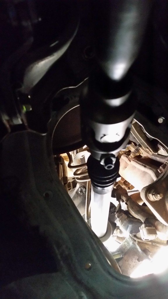

    What are you doing with the firewall plate? It looks as if the joint from the steering column will get into the seal like mine originally did.
