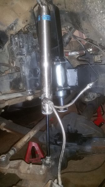

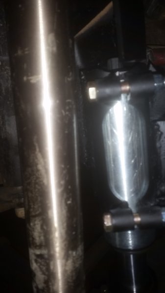

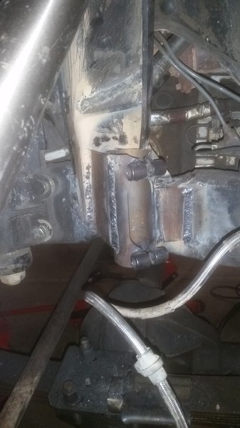

    Drivers side air bumps are done. Going wheeling sat and we will see if this all works as planned. I cut out about 6" if the rear portion of my shock tower, braced it and burned in the can.
    The last pic is clearence at full droop, i have 1/4". It should not hit the shock, but you never know with leafs and when you are out wheeling.

    Went on a shakedown run yesterday:
    - steering still sucks and overheats despite the cooler. Driving in 2wd between the hard sections helps
    - probibly will be going hydro assist in the future (next year)
    - air bumps are sweet! No more tie rod to steering box contact and no more tie rod to oil pan clearence.
    - they are smooth as glass in whooped out sections of trail, i can actually keep up with the group now bombing between obsticles.
    - just about zero body roll on the street.
    - still have a major driveline vibe, dont know if thats because of my square swampers or because my center bearing is wore out. My entire trans/tcase vibrates back and forth alot.
    Overall successful shake down and only a few things to fix before moab next month.

    Just to further expand on how i built that incase anyone cares: all the braceing on the drivers side is 1/8". I managed to burn in the bump can without warping it, which is easy to do with these i guess. On tha pax side its a mix of 1/8 and 3/16s. 3/16 is in a triangle going from the top of the can down to the top of the frame in a triangle. I went a bit overkill with that side since i didnt have enough room to add a brace on the side due to my motor mount being in the way. I was going to use 3/16 for evreything but i read 1/8 is good enough if you are not doing highspeed wheeling or jumping it, which i wont be doing either of.

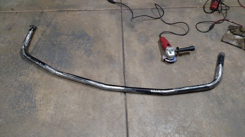

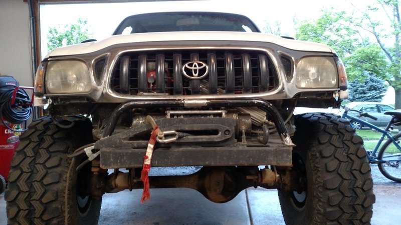

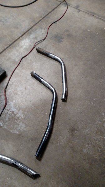

    The next project is a bumper for this thing. I was going to build a plate bumper but didnt want anything heavy as shit. I cut up my old all pro tube bumper and im thinking of using the main horseshoe shaped piece, with 2 angled pieces of tube coming up from the frame and meeting it right under the turn signal. Still trying to figure out what to do in the middle portion by the winch to support the middle of the bumper.
    Bumper cut off:

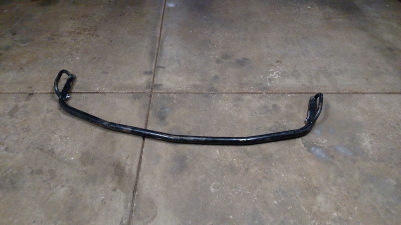

    Cleaned up:

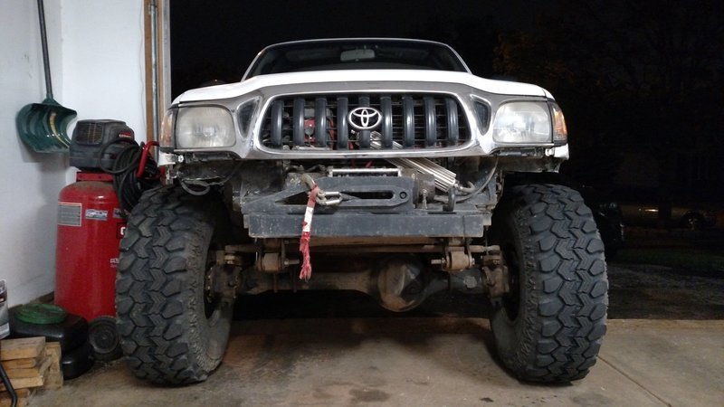

    My current "bumper".
    Fun fact that allpro bumper was part of my first mods ever done to the truck back in 06. All pro bumpers f/r, winch and trail gear sliders which are still on the truck... barely.

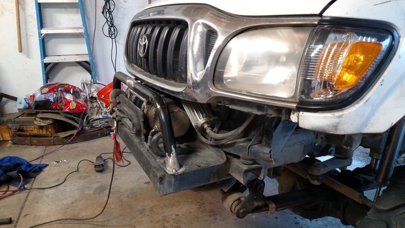

    Learning curve is pretty steep for tube notching, and figures I'm learning on some crazy compound angle. Tacked on my hoop which will get 2 wings welded on that will go back under the headlights. The wings will be supported by a tube coming up from each side frame rail and meeting under the marker light. I had to section the hoop because it was too wide.
    Wings
    Been practicing notching the rest of the night, then distracted by beer that had to be drank.
