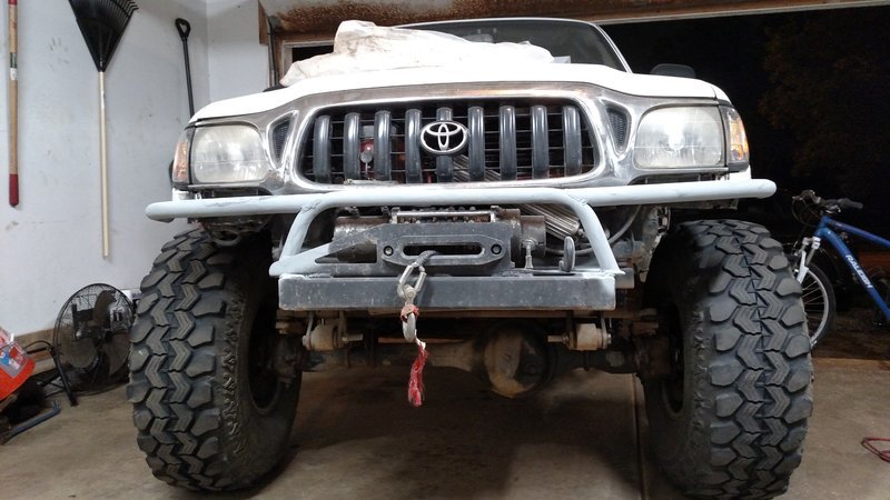

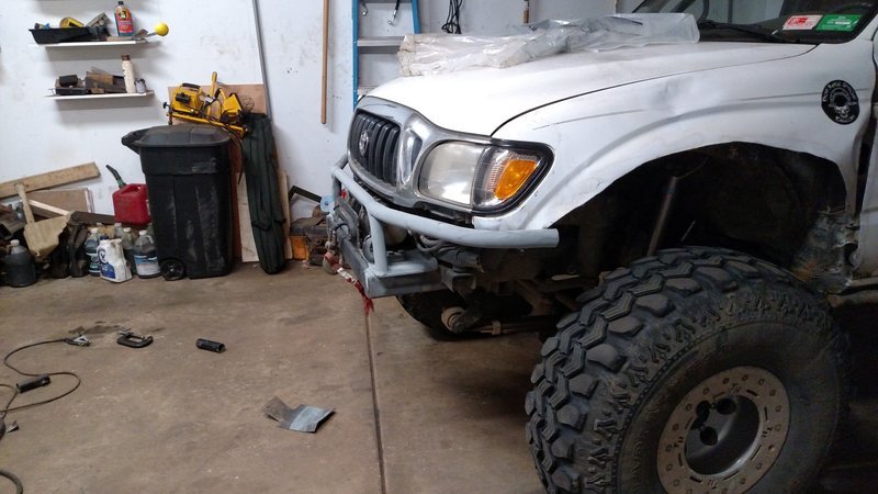

    Thought I had more tube than I did, oh well this will work for the time being.
    Obviously it's getting painted black. Knocking back a brew while the primer dries.

    Black

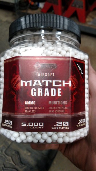

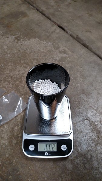

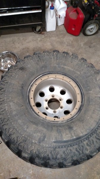

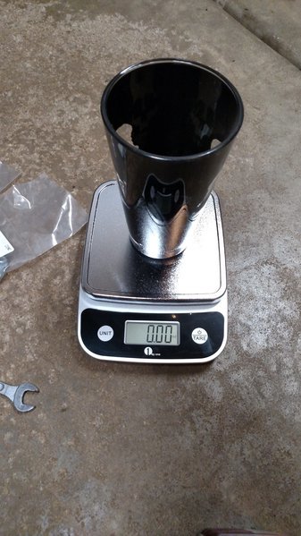

    Tonight I decided to take on one of the most futile battles in the off-road world.... Trying to balance a swamper. LOL. I have also had problems with the front left beadlock breaking bolts and noticed there was uneven gaps around the rock ring.
    Step one break down the beadlock.
    Step 2 weigh out the airsoft pellets, I got this kitchen scale off Amazon for 15bucks.
    I got .20grams bbs off Amazon 2 tubs of 5000.
    10oz. A tire is what I'm going to use. The online charts says 8oz, but these are chunked swampers.... Just peel the bead off the wheel and dump em on in.
    These rims had weights on the inside., 5oz worth lol. The tires also needed a spacer between the rock ring and the rim as the beads are crazy thick on these, I think that may be part of why the bounced down the road.
    2hrs later the tire is inflated. The rock rings were beat to fuck so it took an assload of time to get everything tightened down. Only 3 more tires to go....

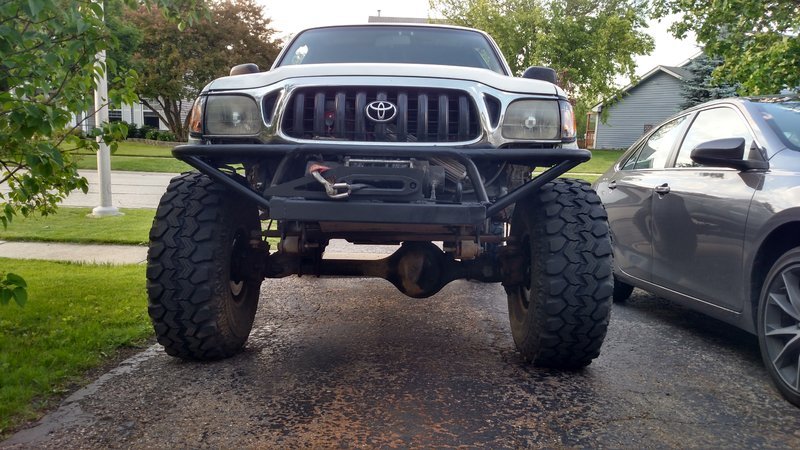

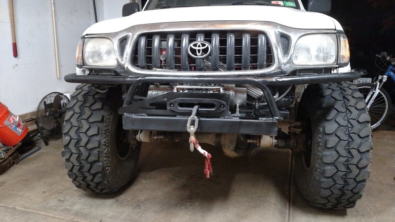

    Bumpers done.

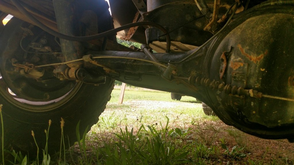

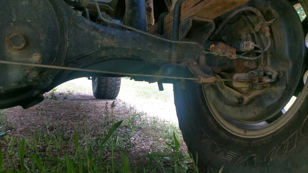

    The Bed is stock...ish
    I made a crude little extension link to connect one side. The other side connected as usual. I'm pretty crappy with a fab work, so I don't have a mount to support the cable on the axle. I have not adjusted the drums yet though.

    Here you go.

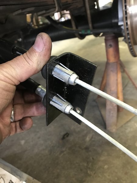

    I did fab a bracket for the cables to go through, then used an FJ Cruiser bracket to terminate, then used all thread to work with the OEM Tacoma bell crank.

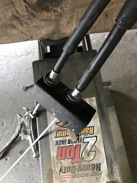

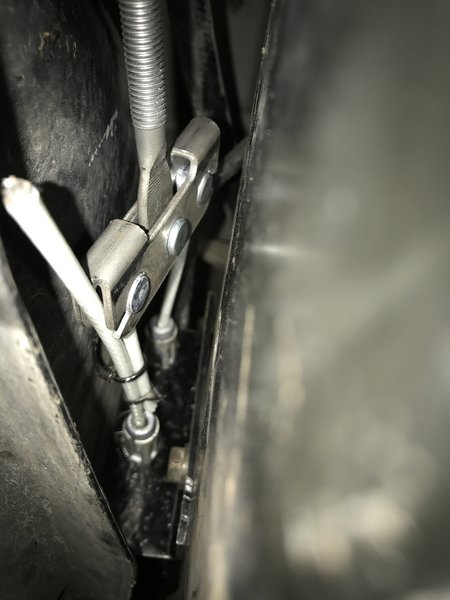

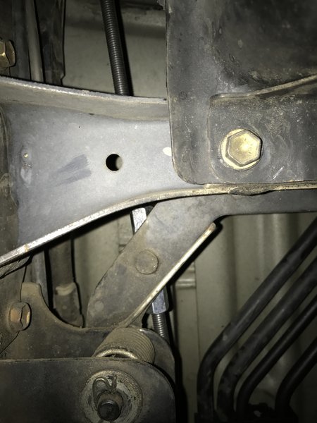

    Hopefully these pics will give you an idea. The FJ cables mounted up in the Tacoma OEM locations. The DS cable
    & housing was shortened as both cables are/ were the same length.
    The bracket I made bolts to the OEM location between the fuel tank and inside frame rail.
