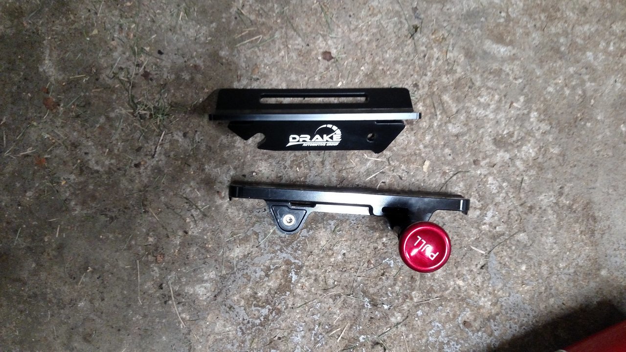

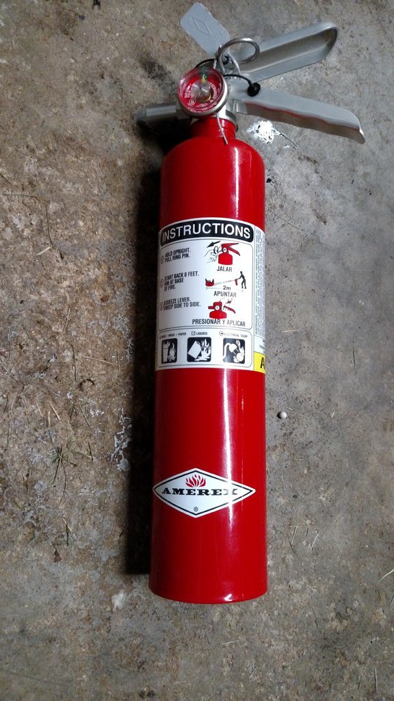

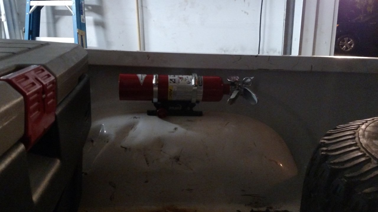

    Since a fire on the trail would suck, and my power steering lines are like 1" from my header pipe, I got a fire extinguisher and quick release mount. When buying a fire extinguisher dont get some cheap big box store plasticy POS, get a quality one for like 15bucks more I got an amerex ABC 2.5lb extinguisher. USA made In Alabama, they are all we use at work, and I got to visit the factory 3yrs ago for work, cool people as well. I got the mount from Drake off-road off Amazon, pull the handle and it's off, mounted it to the wheel well in the bed. Let's see how long before some fuck head steals it lol.

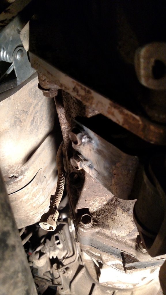

    Ever since I swapped the first crawl box into this truck back in 2007 it's been puking the trans mount bolts out. I tried cleaning them, red locktiteing them, coat the threads in rtv and they would still work loose all the time. I figured it was the trans holes, so when my trans blew up a few years ago and I got my rebuilt Marlin unit, I figured the problem would be gone. Oozed on the red locktiteing and fuck, they still come loose. Once a week I need to tighten them, multiple times a day wheeling or every other fuel stop on a road trip. Today I said the hell with it and busted out the metal hot glue gun:
    Welded those suckers on, that better work!!

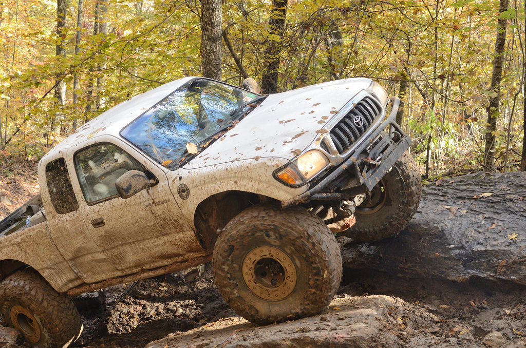

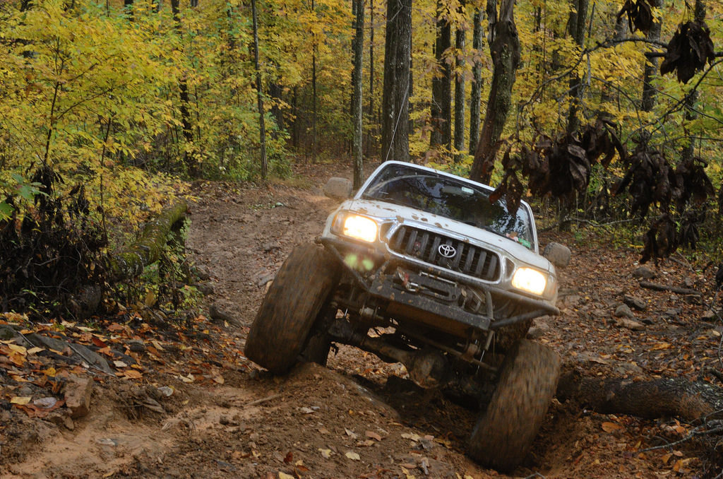

    The welded bolts did not work and 2 broke free. Went wheeling at AOP last week, truck did great. The Toyos surprised me when I aired then down to 4psi front and 2 rear, above that they were not hooking up to the wet and muddy rocks. I think I have sprung an oil leak which sucks. It's leaking from the front of the bell housing alot (for this truck), there is a slim chance that came out of my DD that was parked there for a week. I'll add that to my list of winter/spring work along with hydro assist!
    Found pic and video:
    https://youtu.be/YOaZZ0XFyIQ
    I normally don't wheel that fast, and prefer to crawl however that was wet clay covered rocks on a series to stair steps so I had to use momentum to get up that.
