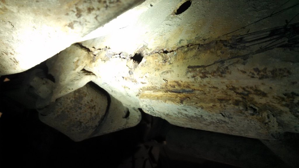

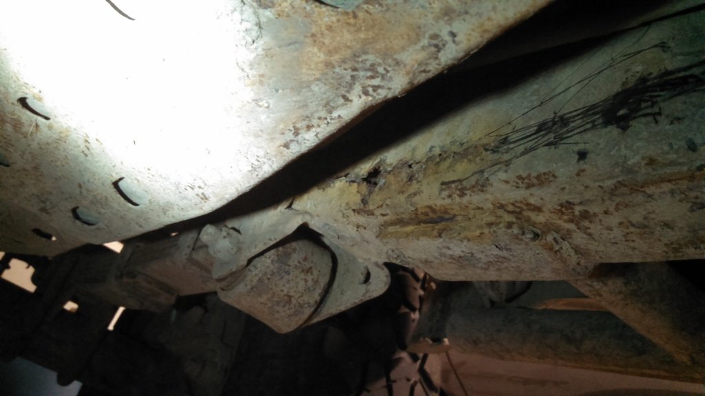

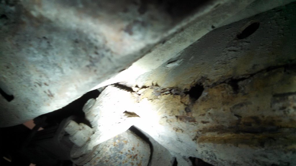

    Joy

    Dead Truck
    Rust, dents, cracking plastic, oxidized paint...
