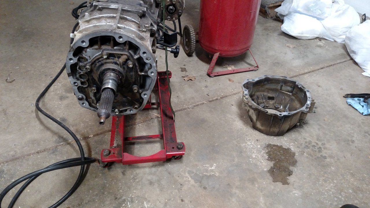

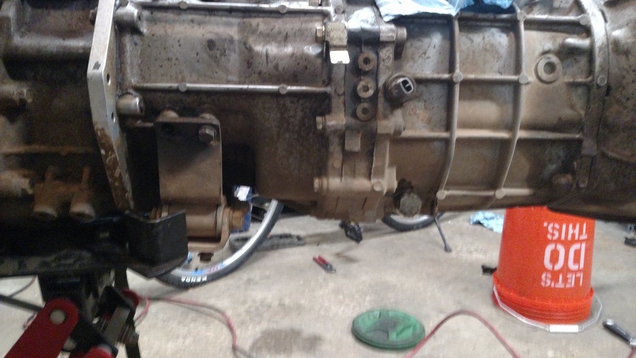

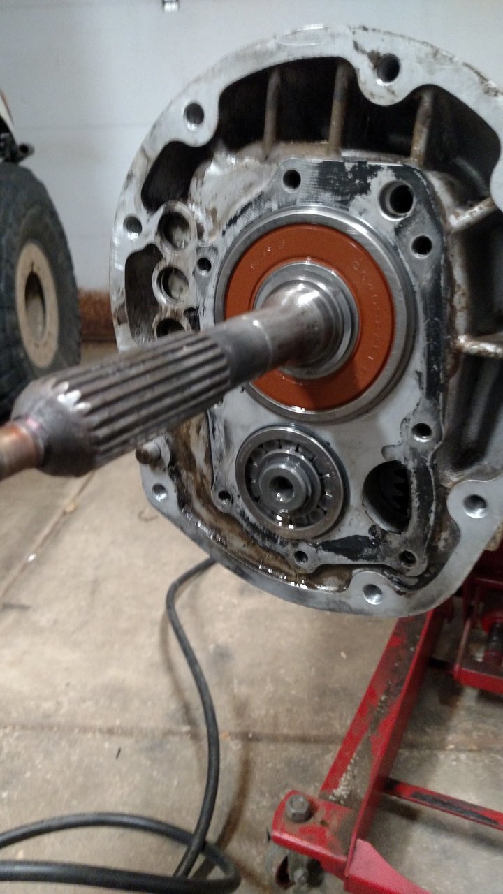

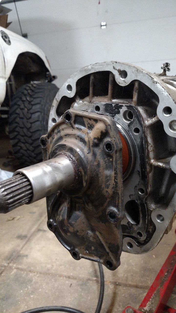

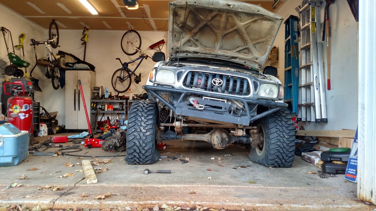

    Good news, it's not the valve cover gaskets leaking! Instead the input shaft of the trans is. I was NOT looking forward to taking 1/4 of the motor apart to change those gaskets. Kind of sucks since this is a Marlin freshly rebuilt unit with around 30k on it. So much easier to get the trans out without all that IFS bullshit in the way, the last time I had the trans out it took me 8hrs, this time it took me about 1.5hrs of not working that fast.
    That last pic I just thought looked funny, like the truck was taking a leak on the trans or something.

    Your tires are flat...

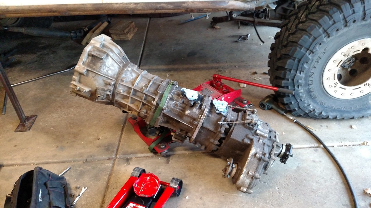

    I did that so my trans jack would be able to reach the trans not fully maxed out. It's leaning over because I had to jack it up with the highlift to get the trans out from under the truck.

    I was just being a dick. Thanks for the explanation though! :p

    Lol!! Both my rear tires did go flat on their own prior to me working on it, I had it on jadkstands lol

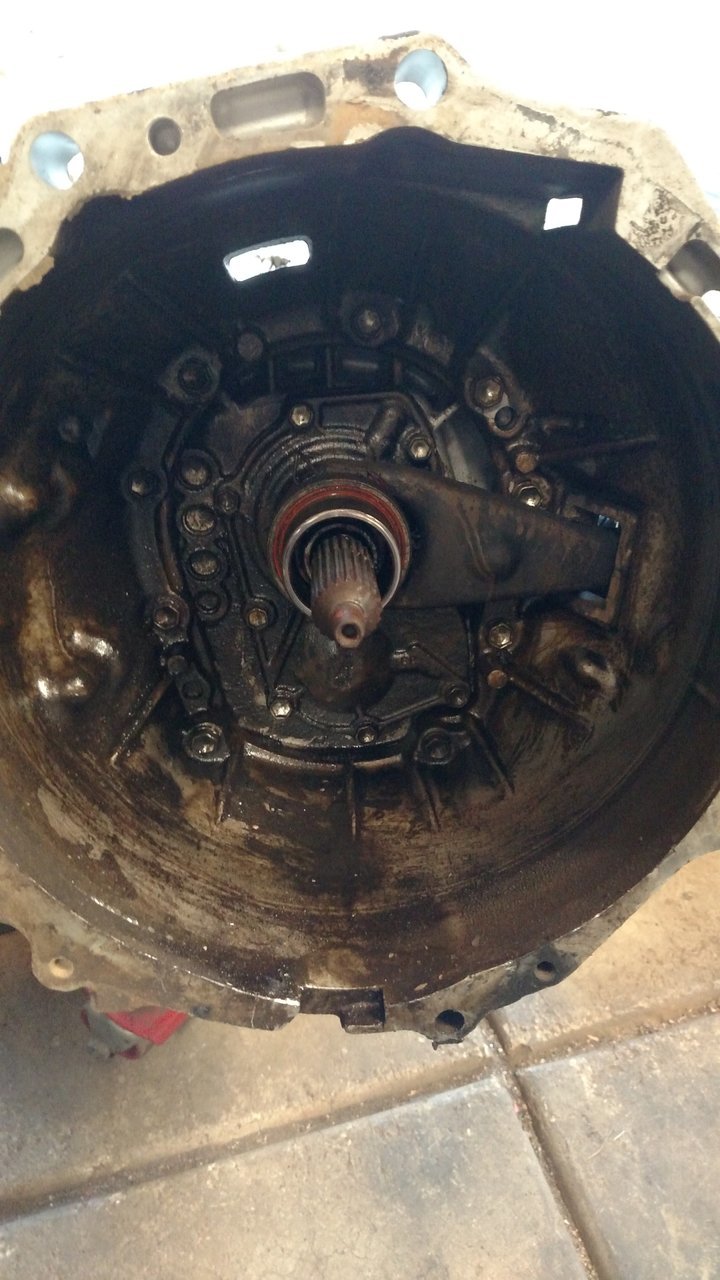

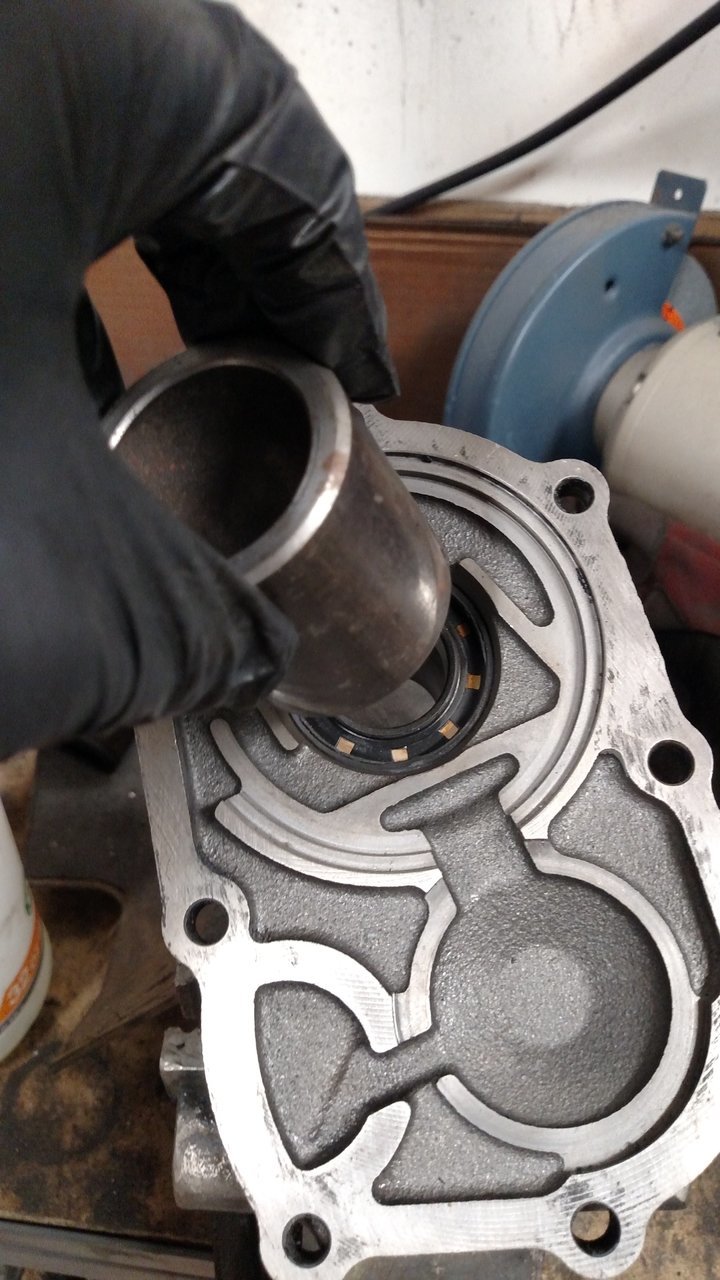

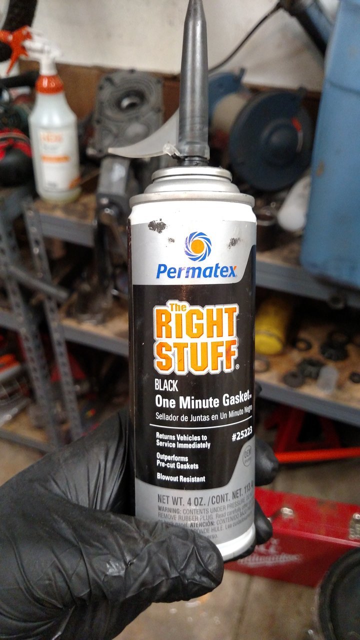

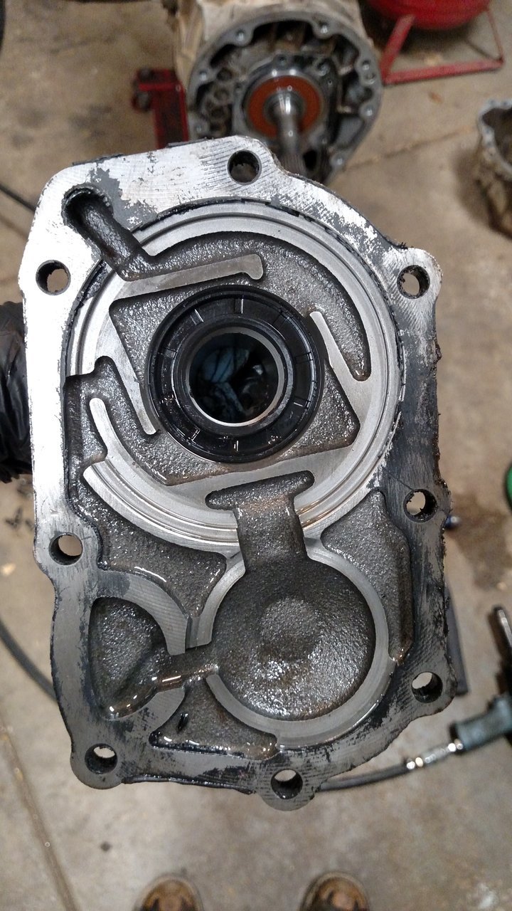

    Trans input shaft seal replacement:
    1. Take off the bell housing by removing every 14mm bolt you see inside the bellhousing
    2. Remove input gear cover. Unbolt every 13mm bolt you see and break the FIPG seal.
    Scrape all that black shit off everything.
    3. Look at the bearings and front of the trans, turn the input gear and stare at it a bit more. This would be a good time to drink a beer... Oh yea spray everything down with some brake clean.
    4. Backside of the cover is where the offending seal is. Flip it off (not pictured).
    5. Pry that bitch out with a set of small channel locks. No picture, if you need a pic for this step you should not be doing this.
    6. Pound in new seal with a SST (chunk of scrap tube I had laying around)
    7. Apply a real sealer like the right stuff, not that pussy ass FIPG crap. I put this evreywhere the old stuff was and on the bolt threads.
    Install is reverse of removal, remember to grease the new seal when you slide it on the shaft, don't want to burn up the new seal.

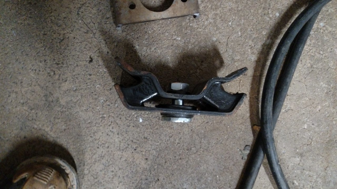

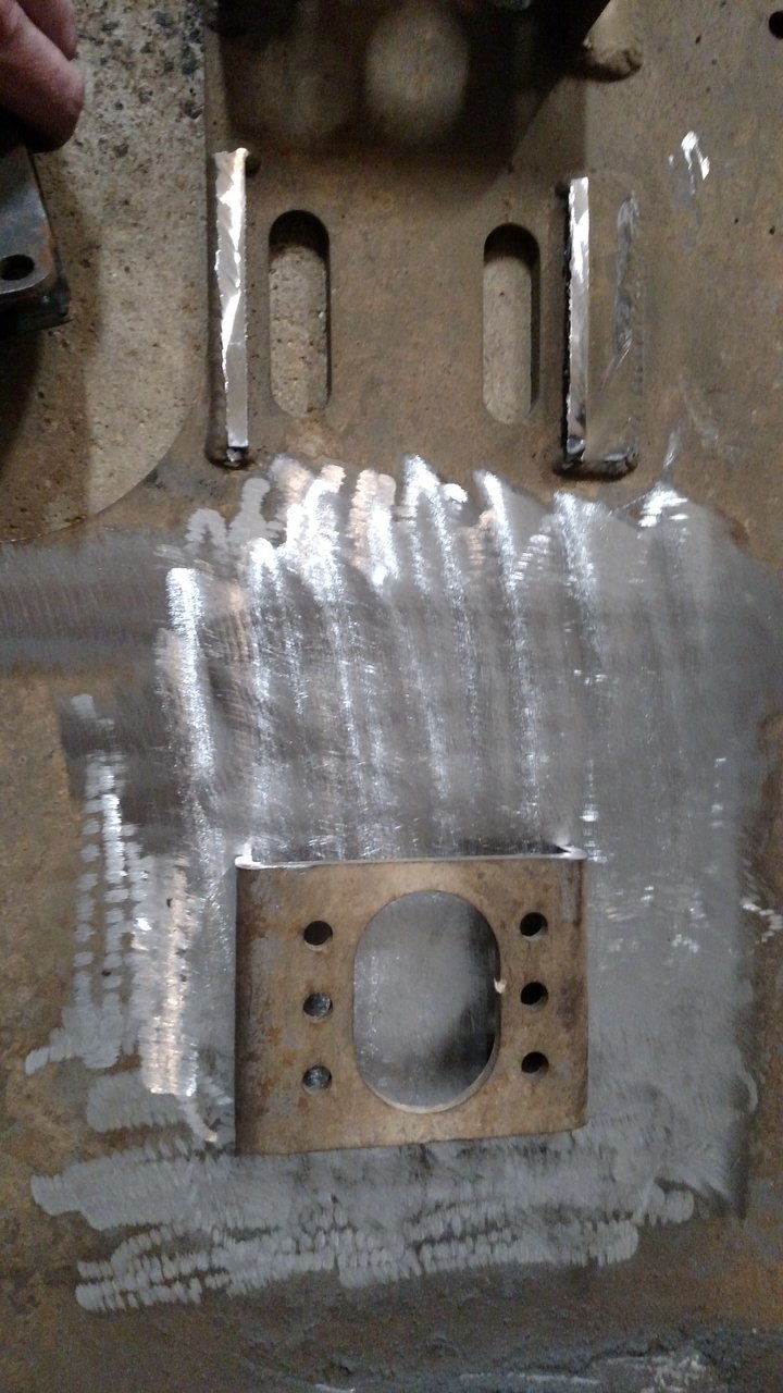

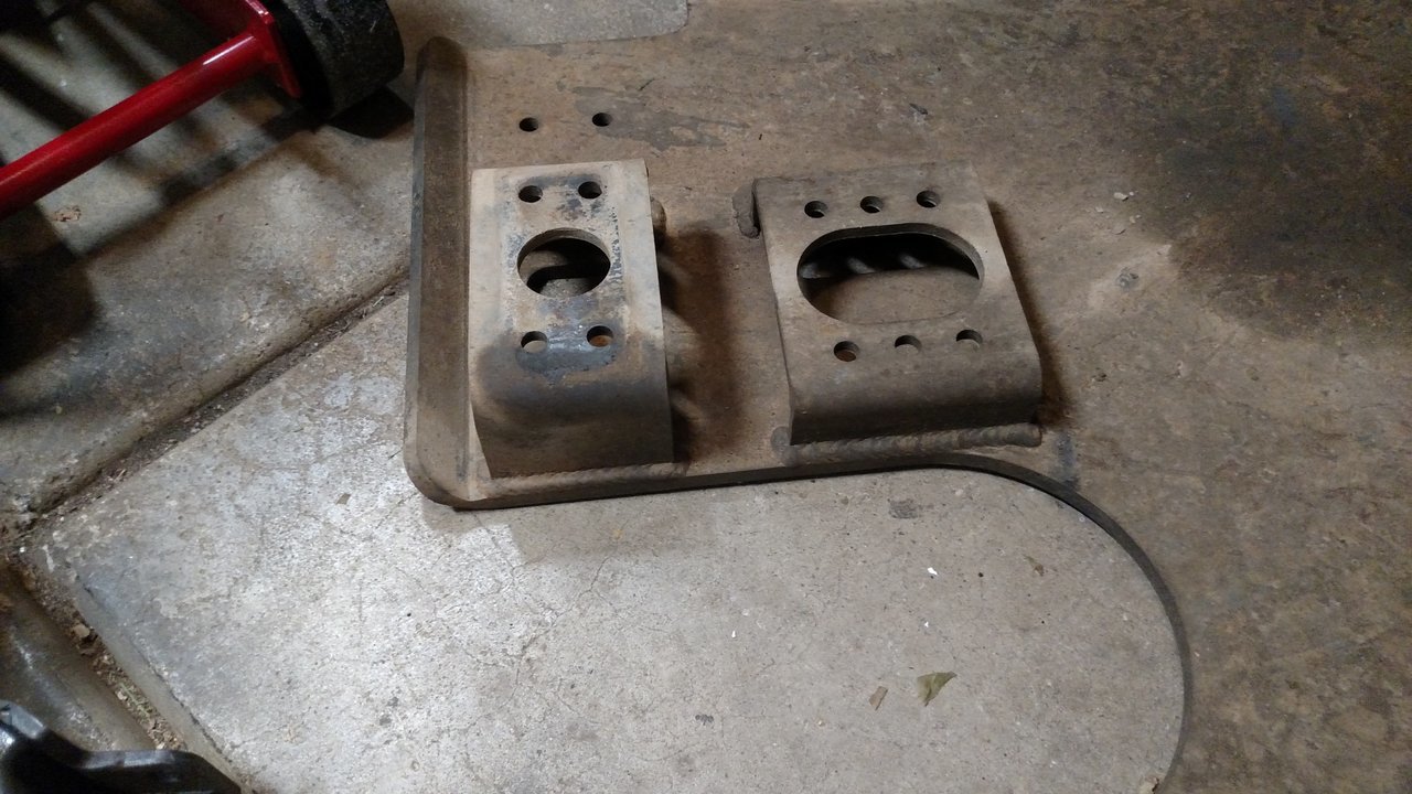

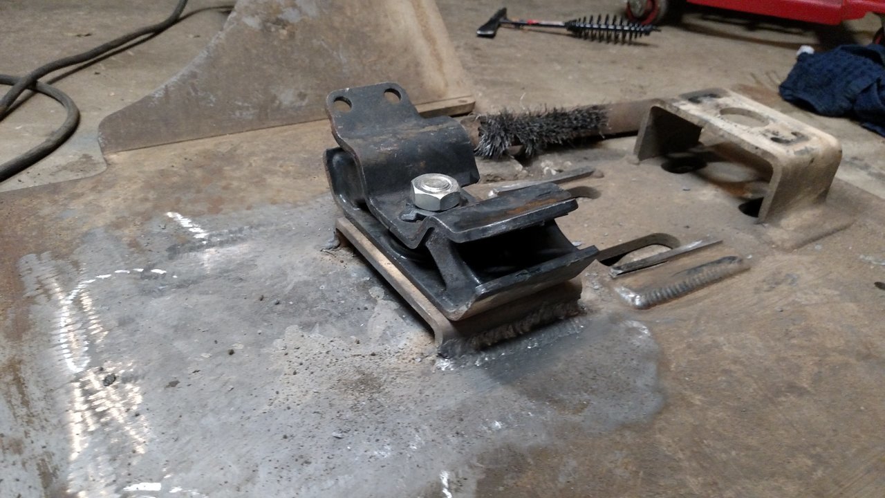

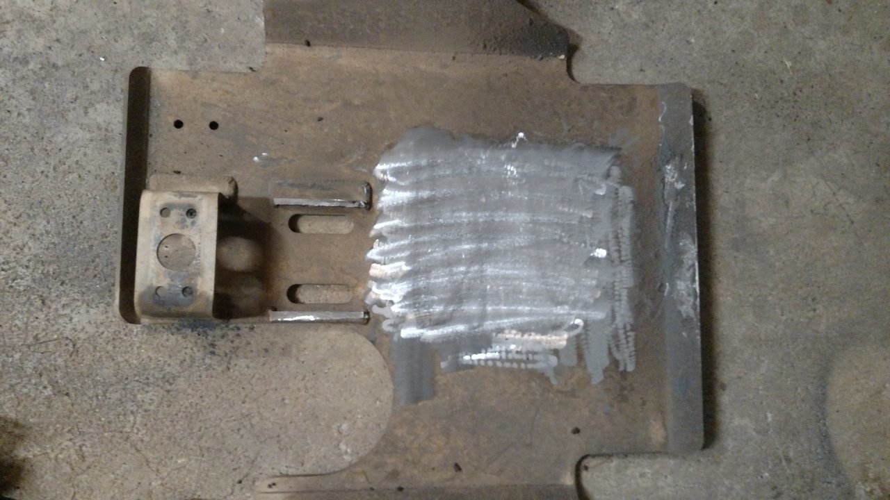

    Since I have the trans out I'm going to redo my tcase mounts. Currently I have a 4xinnovations mount on the stock Tacoma mounting point. This worked for years until I stepped up to 37a and now my entire drivetrain shakes all over the place. I think the poly mounts coupled with blown out stock motor mounts may be the issue. The plan: since you can probably count on one hand how many people are running a lefty dual combo like I am on a Tacoma I'm going to have to modify my trail gear cross member. I'm going to mount a new factory rubber mount off the rear most case, and put some new rubber motor mounts in and chain the motor mounts to limit movement. The goal is to keep the mounting bolts from backing out with the softer mounts and the chain will keep me from ripping my motor mounts apart. Onto the pics:
    I'm going to chop off the mount with the 3 holes. On the trail gear cross member this is where you are supposed to run a mount for the crawl box. I'm going to move this mount back around 8" to mount to the lefty.
    Mount cut off and skid cleaned up:
    Roughly where the new mount with be welded on, won't know for sure until the trans is back in this week.
    New mount, this is the early mini truck style tcase mount.
    How it's setup now, you can see the 4xinnovations mount near the jack platform (far left)IMG_20171125_195736371.jpg .
    When all is done I'll have only one mount for the drivetrain, but it will be the furthest point back.

    New mount welded on, multi passed the shit out of it, now the mounts all soft lol, and no you cannot get the bottom mount bolts off. I'll need to haul this junk over to one of my friends with a plasma cutter and cut some access holes in the skid. I should have the truck driving tomorrow, just need some shorter bolts for the tcase mount.
