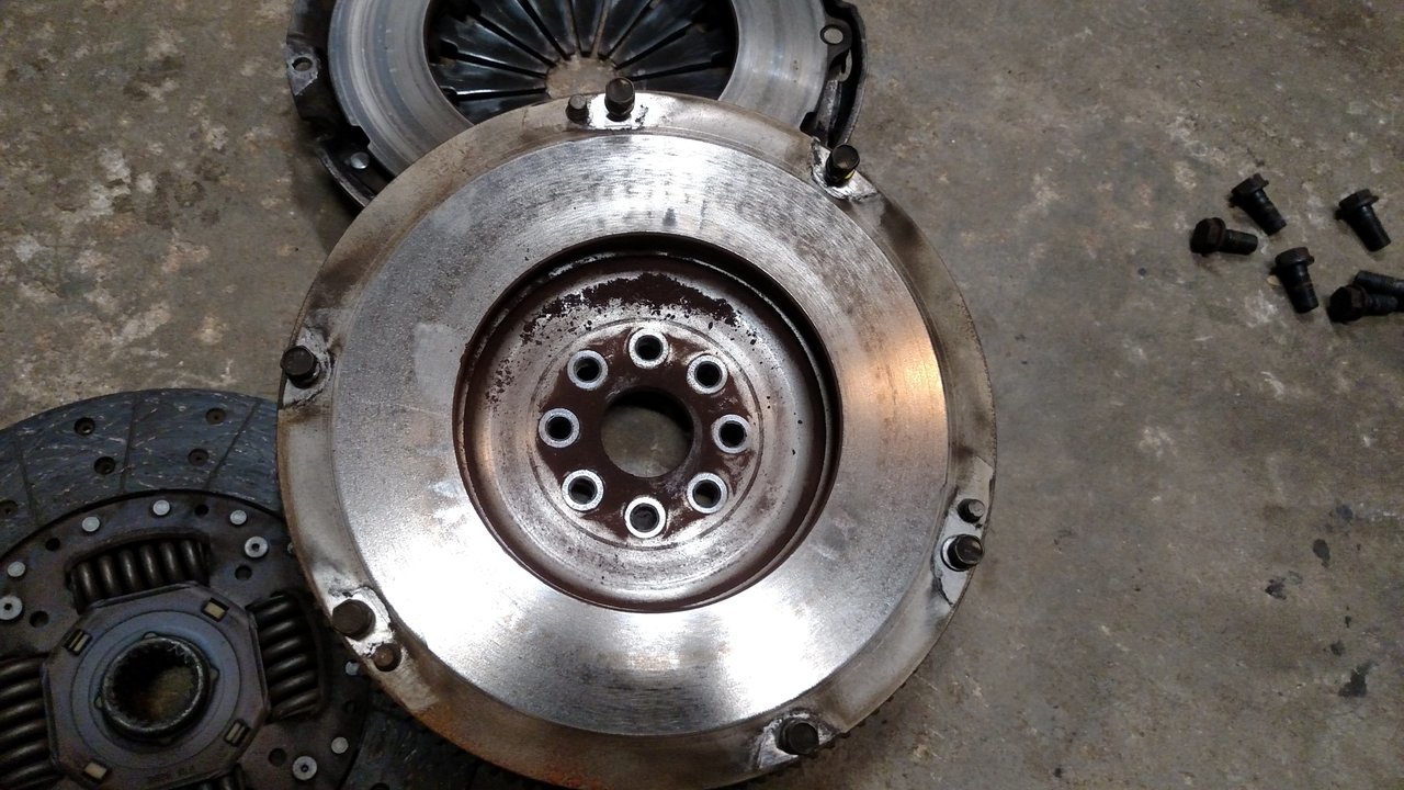

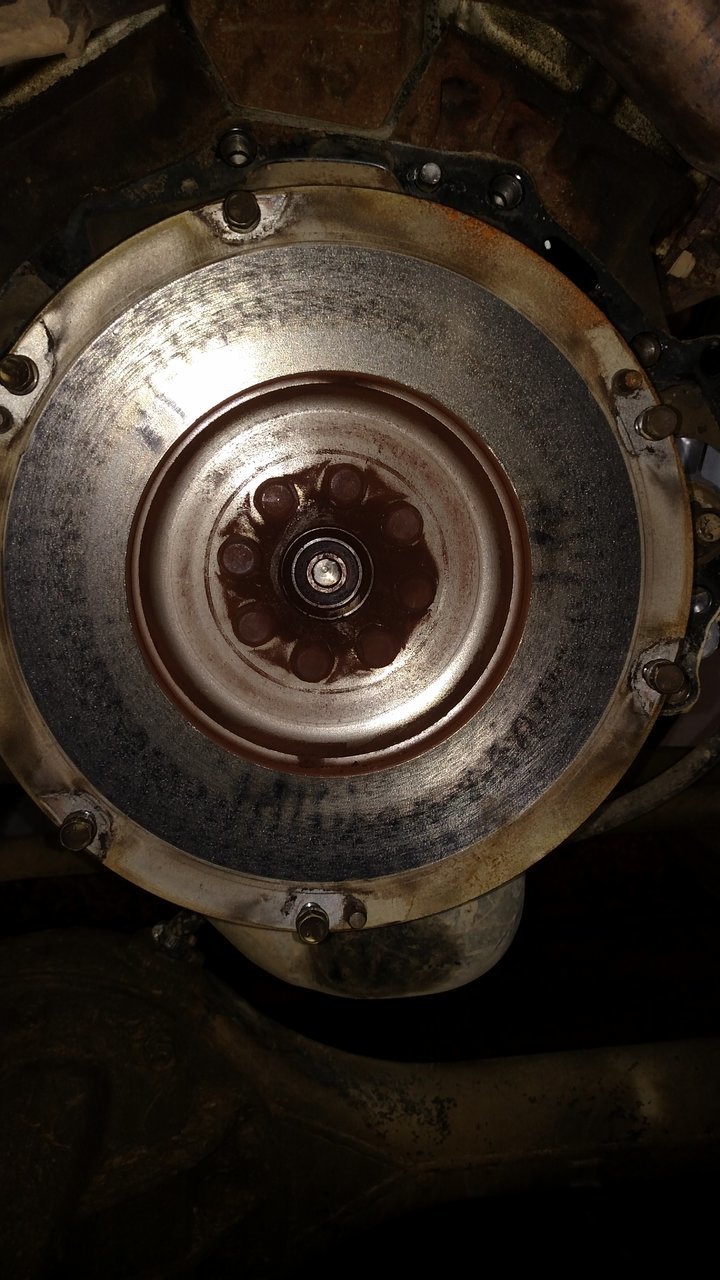

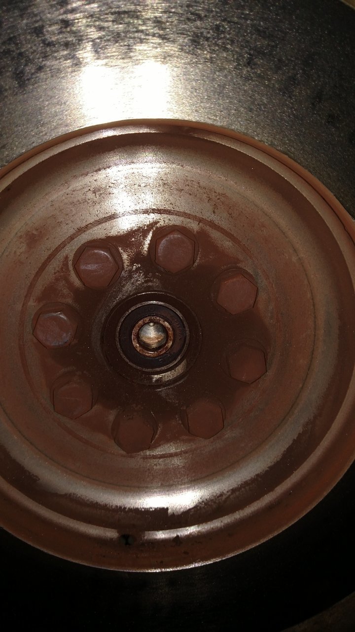

    Not as fucked as I thought. I was worried I was going to have to flap disc down the input or even swap it, not so! It's only off by .005" between the thickest and thinnest part. I'm going to toss a new (Toyota, not mar... I mean Chinese shit) pilot bearing at it and see what happens. Waiting on a slide hammer since the bearing blew apart using the grease method. Also good news, no gear lube on the clutch disc!
    No idea how this flywheel looks, any opinions?

    Told you to be patient and check out your input before going off the deep end!
    If you replaced/surfaced the flywheel when you put the new trans (and presumably a new clutch) in then I'd call it good. If you were swapping in a new disk, I'd probably get it surfaced just for piece of mind to make sure that the new disk mates correctly.

    I'm not going to swap the clutch. New flywheel when I did the clutch, it was cheaper new than resurfaceing. Do you need a new pressure plate when swapping the clutch?

    Think of it as a second flywheel friction surface. New disk, I'd probably swap in a new pressure plate like I would a flywheel so the new disk does not glaze.

    That's what I figured thanks! I'm putting this clutch back in, it felt fine and didn't have any oil contamination.
