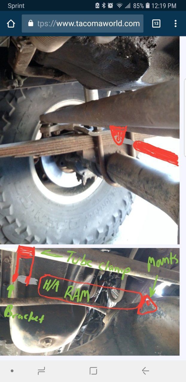

    Any reason you cant run the ram parallel underneath the tierod and run mounts on the diff cover/near diff cover and then the tierod clamp mount at the other end?
    Then you just build some kinda small skid/tube from the axle tube up close to the ram.
    Or you could use your idea of running the factory lower arm and put it behind the axle like the factory fj80s.

    Looked at that, when fully extended the ram would hit the spring plate/ubolts. The other option I'm thinking is attaching it to the spring plate and pads on the pax side with some tabs. The ram would be extending opposite of your picture.

    Yeah first option would be tight ram length wise extended. Mounting one side on the spring pad isn't a bad thought. U bolts could easily handle that pressure I would think.

    I was able to mount mine on the diff almost centered. I offset the mount on the tube clamp so it would clear the u bolt plate. Took a little bit of time and messing with different ways but I was able to squeeze mine in there. Worth a shot atleast. And I set up the ram at 0* to the tie rod with the wheels straight on my new axle and I have zero flip/rotation in the tie rod and tie rod ends. On my old axle it was pushing at a slight angle and they would constantly flip and wear out.
    EDIT: and I don't have a skid on mine although I do have some rock marks extremely close to it so may build one at some point. But that's a pretty big rock im hitting to hit the ram since its so high lol

    The good part is, I can use the studs I ordered anyway. I figure mount the arm, tack the ram to the tube and start cycling the steering (with the ram dead of course) and see what happens. Worst comes to worst I'm out my time.

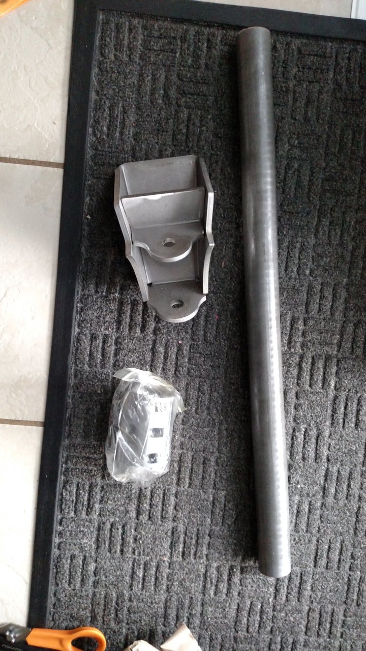

    Finally have the last of the parts to hydro assist this truck. Thats tube to sleeve my tie rod, a tube clamp and a generic 3link bracket because I'm too lazy to Fab a ram mount. The box is already partially tapped, weather I did it right is another story LOL!
