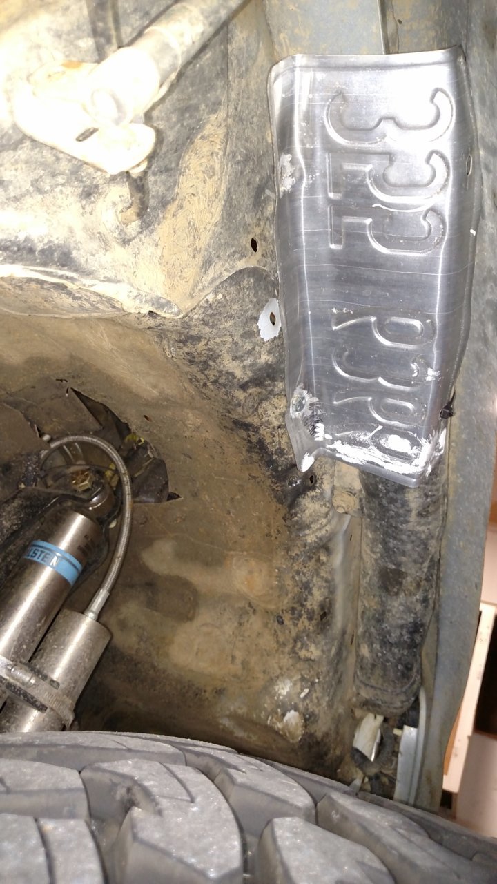

    More licence plate Fab, hopefully this keeps all the shit out of my airintake that's kicked up by my tires.
