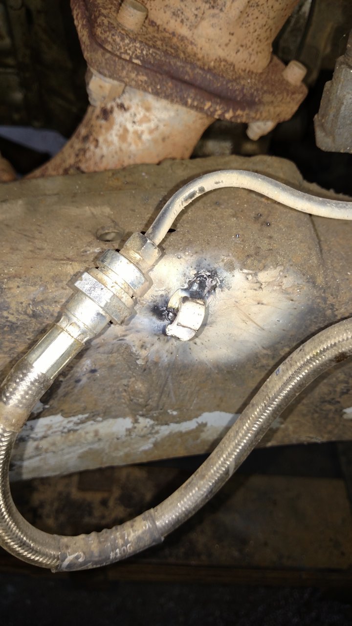

    Last trip out my spring from my brake lines got snagged on the line and was flexing the hard line up and down. The fix, booger weld a nut to the frame and tie the Hardline off to that to keep it in place.

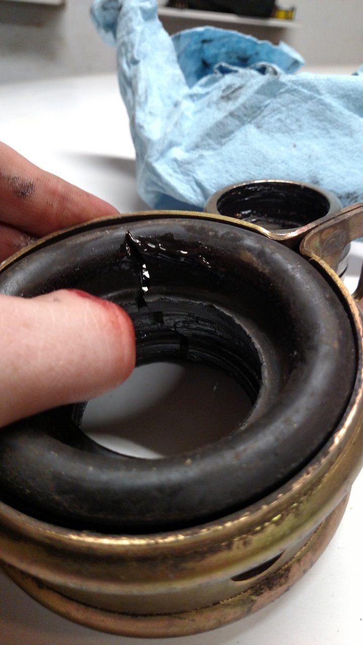

    Pre trip repairs needed: I think the bearing on my fan bracket is taking a shit, ordered a new one, may start ripping into it tomorrow. Rear center bearing is totally fucked, have one Amazon prime to the house. Good part is all my welds look good, after these repairs it's grease evreything up and I'll be good to go!

    Thinking it may be one piece drive shaft time. Tossed another tinken center bearing in it for October road trips, may be giving hi angle driveline a call this winter to build me a beefy shaft.

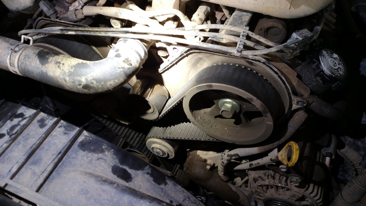

    I had a howling coming off the front of the motor, I thought changing the bracket would fix it, it kind of did. Timing belt looks good and the water pump isn't wearing, the cam seals are still good as well. I was committed to changing that bracket since I purchased it, and if I didn't it would have let loose in the middle of no where southern illinois, it's the way the universe works.
