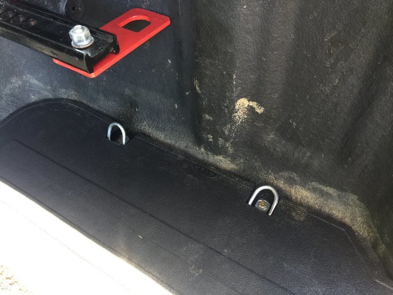

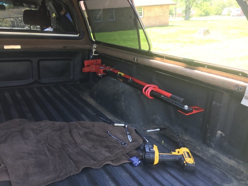

    After destroying the bed mounted toolbox I lost a place to mount my hi lift. When I installed my internal cage, I mounted it to that, when I cut my cage out this spring, I lost that mount. So I need a place to put this thing, I ordered the truck bed mount from hi lift and this thing kinda sucks. It's made for brodozers, or at least not tacomas. I was only able to mount it on 4 of the 6 bolts, over under on my bedside ripping off lol!! Note the quality paint job I did.

    2 tips from my 88...1/2" bolts tacked onto the top of the wheel well with a few nuts to space it up, then wingnuts on top to hold it on worked great for me, can't find any pics of it right now. Also, the rubber jack handle isolator things are worth the money.

    Cool thanks! I anticipate this mount falling off the bed rail this weekend anyway so thats a good to know. The handle goes in the tool box, the ends are smashed up and won't accept a bolt to hold it to the jack anyway.

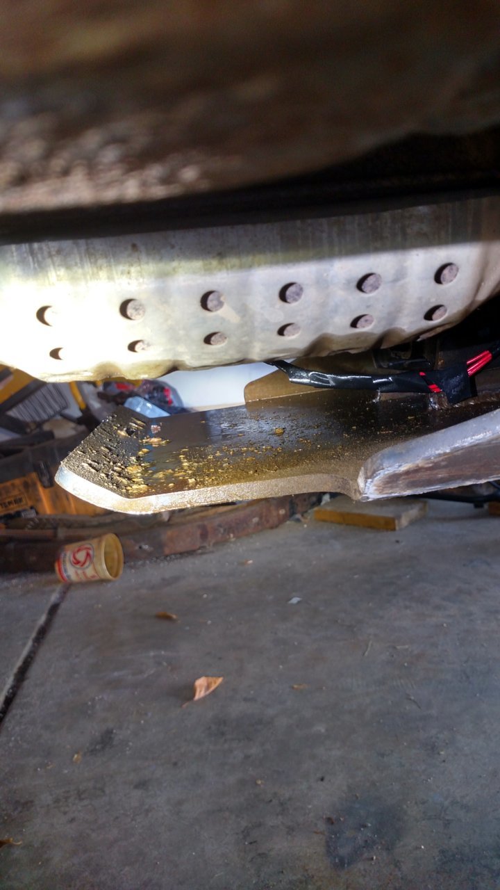

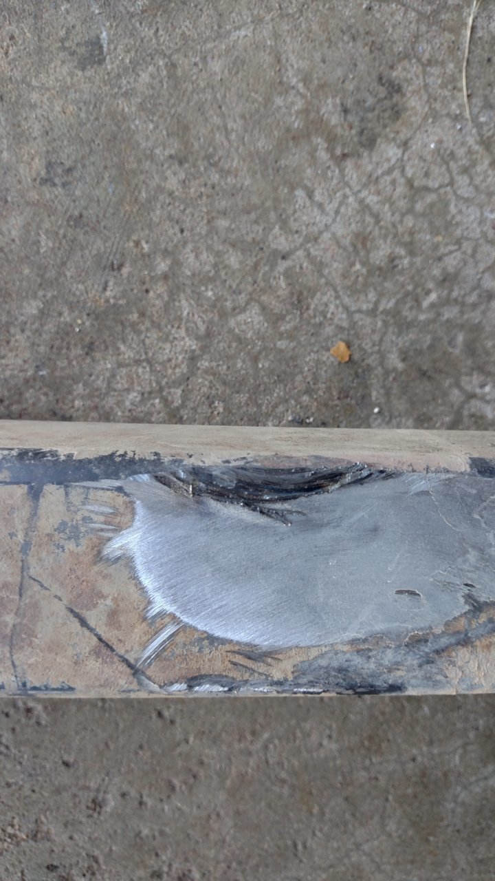

    Clearenaced that cross member, assemetrical notching for the win.

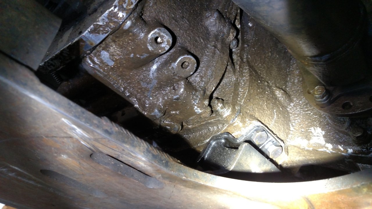

    IMG_20181015_121603313.jpg IMG_20181015_121617479.jpg IMG_20181015_131132309.jpg
    Good thing is it looks like my gear lube issue is from over filling as it appears to have come out the top of the case. Saying that I have 2 output seals that should be here Thursday from marlin. I also have a Toyota center bearing on it's way as well.
