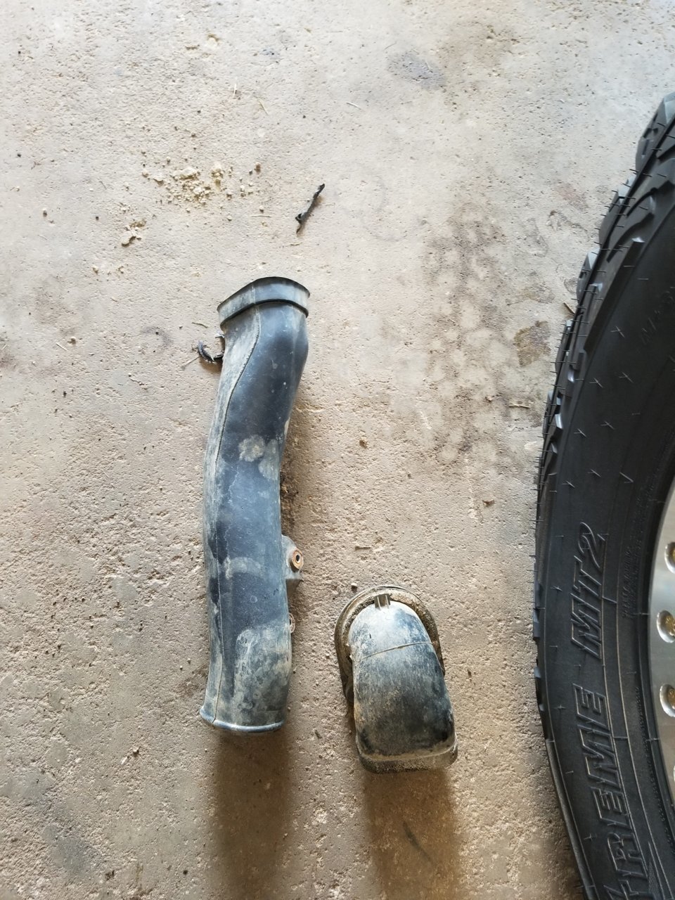

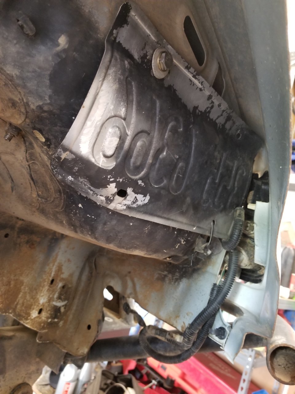

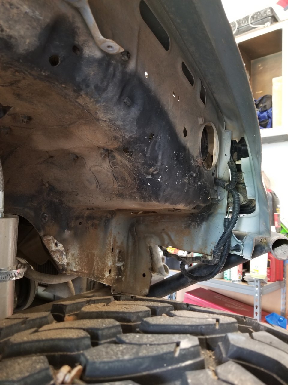

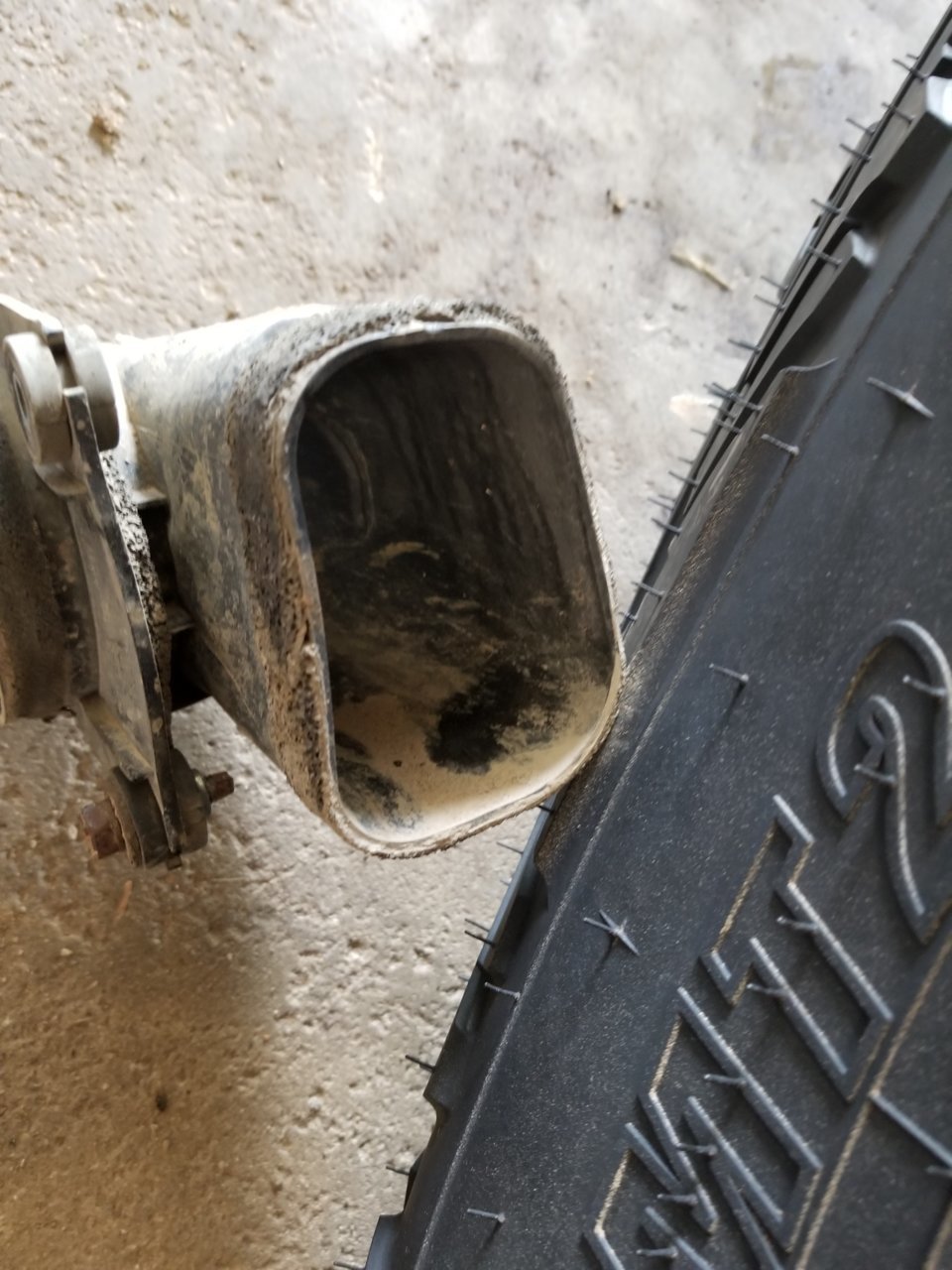

    Changed the oil today and noticed more dirt and gravel in my intake, so my licence plate deflector is not working, so...
    So I yanked the intake tube off and covered the hole up with a license plate. I have no idea what to do with that intake, and hell no to a snorkel. I dont need every #EAFBRO #EXPOLYFE #YOLO #INSPIRED #YAKIMARACK Instagram bro blowing their load everytime I stop somewhere and I rarely go in any water, let alone water deep enough to need it. All this shit is being flung off the tires on the trail or on the street. Any ideas?
    Also that drain valve I put on my tcase never stopped pissing fluid so off it came and the stock plug back in.

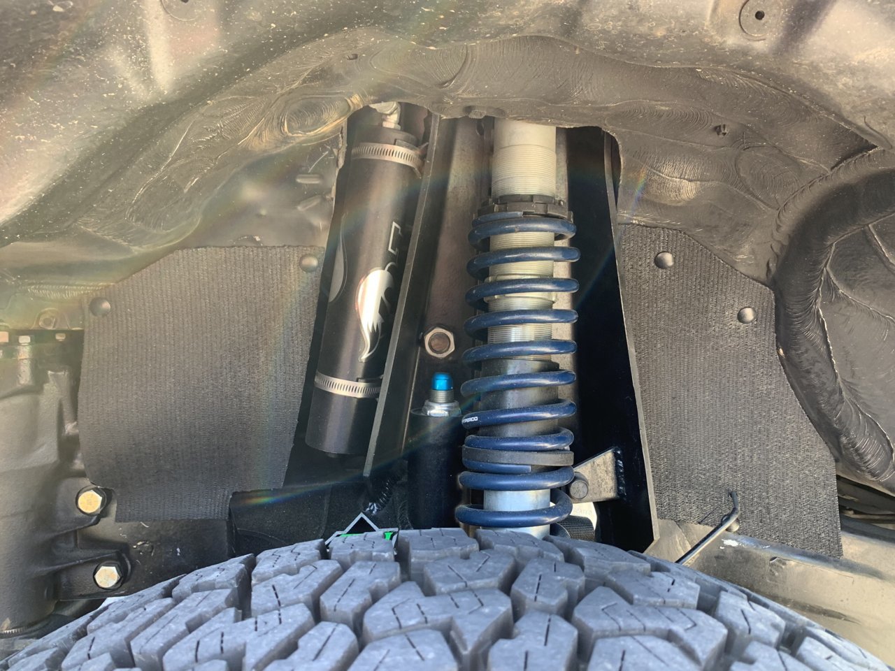

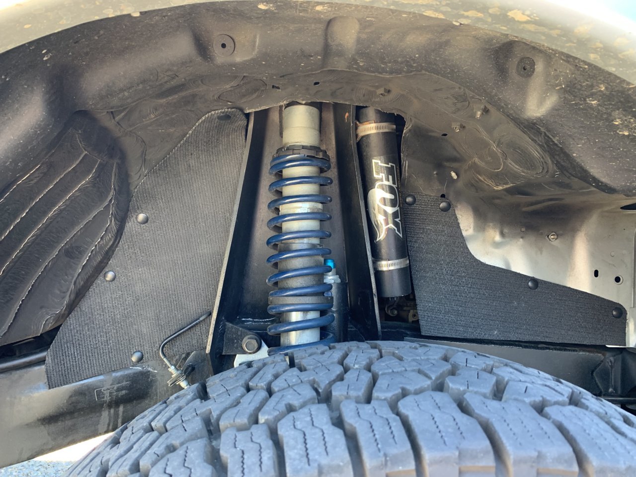

    I may be able to get my hands on some old conveyor belting, should I make some fender panty liners out of that and put the old intake tube back on?
    Ritchie likes this.
  17. Jul 7, 2019 at 3:59 PM
    #817
    Ritchie
    Ritchie Well-Known Member
    Dec 24, 2012
    #93649
    1,931
    San Diego (North County)
    RC Step side Pre-runner
    2.7 w/auto, 4WU 3 link, F & R Diamonds, ARB's F/R w/ Yukon 5.29's, Inchworm 4.7 Lefty, Deavers, ARB OBA, Schrockworks up front.
    You will like the 1/8" conveyor material. Here is how mine turned out. Very easy to work with.

    Yea I saw that in you build thread, looks good. Thinking of making a tube of belting around the intake or a mud flap to keep the tire from throwing material right into the intake.
    I really like the stock intake setup, seems to suck in cool air and is in an easily identifiable spot if you do end up in water, just sucks if you take the fender liners off.
