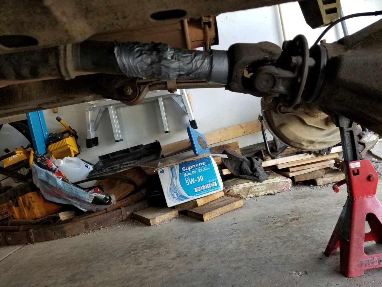

    Here is a trick one of my employees showed me. Everytime I disconnect the rear driveshaft, no matter how careful I am it separates, he told me to wrap it in duct tape. You can still move it in and out a bit, but it wont come apart. Works pretty damn good!
    Rear driveline is dead on inline according to my digital angle finder. The test will be taking it to work next week to let it rip on the highway for a bit in various gear combos.
