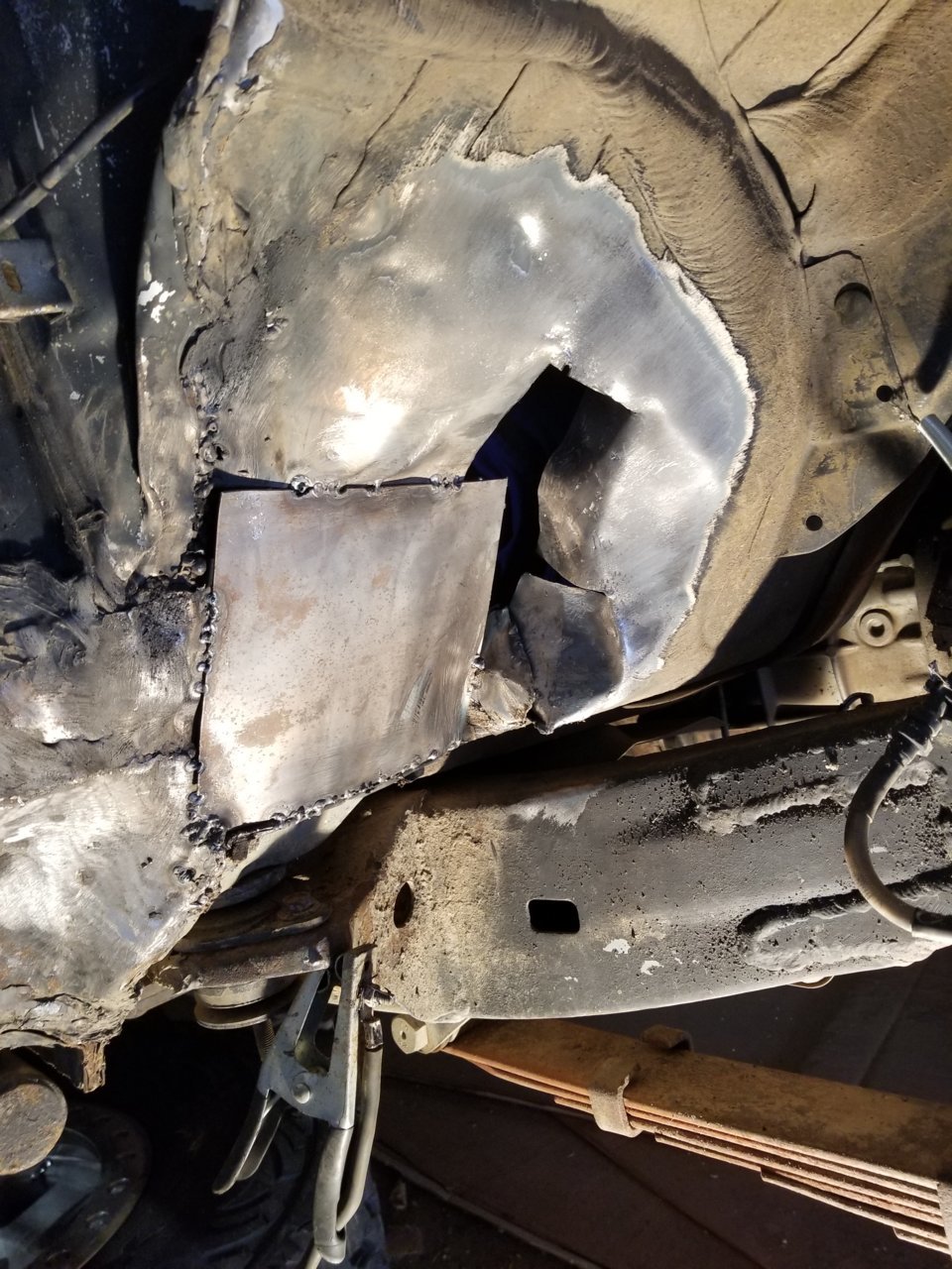

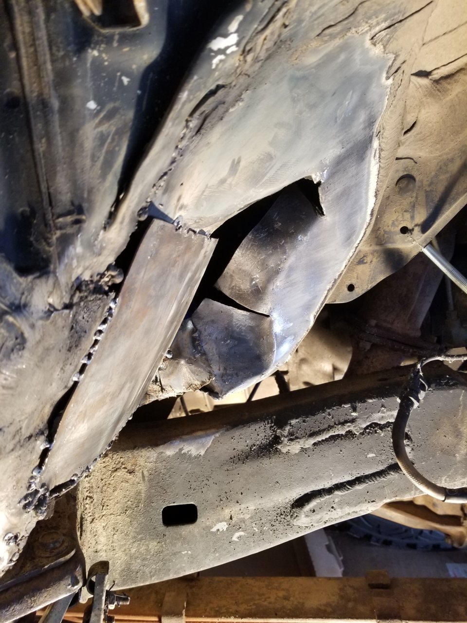

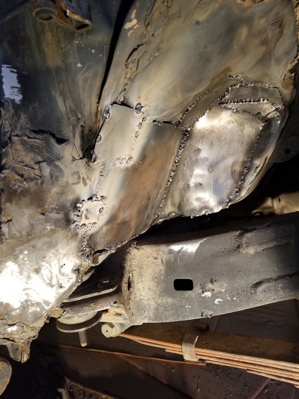

    Getting there, goddamn I hate sheet metal work!! Stepped down to .030 wire and it's working better for welding the toyota aluminum foil thickness sheet metal. I have no idea what I'm going to do about the far left side of the wheel well. 20200204_130424.jpg 20200204_130601.jpg

    Yea it sucks. A series of preventable errors when I did the SAS lead to this, the big one being I accidentally located the axle center line where the factory IFS axle center line was, oops. Other one was I tubbed for 14.5" wide wheels with some crazy backspaceing, now that those are gone I get to re do it. Somehow the drivers side is ok, which is odd. I'm pretty much limited to 37s now, which is fine with me honestly.

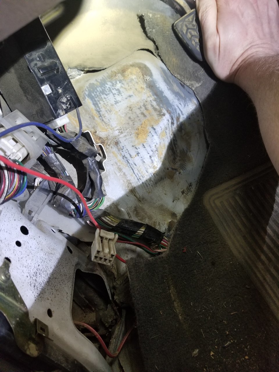

    When you get time could I get you to take a pic of the inside driver's side. Curious of how the tubbing messes with the clutch pedal.

    My drivers side is a mess, I just smashed it with a sledge hammer like I was driving a golf ball a ton of times. I'll get a pic for you though, it messes with the clutch a bit if I'm wearing boots. If I went any deeper I would mod the pedal a bit.

    Yea I would like a pic,most times people talk of tubbing I never seen pics of the inside. Or if they do show it's an auto. Nice truck by the way, crawl box is on my bucket list for my truck.

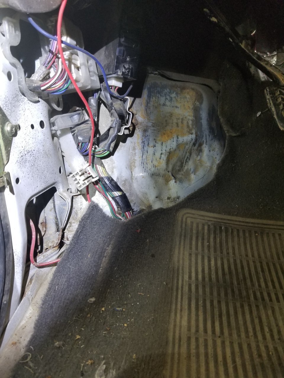

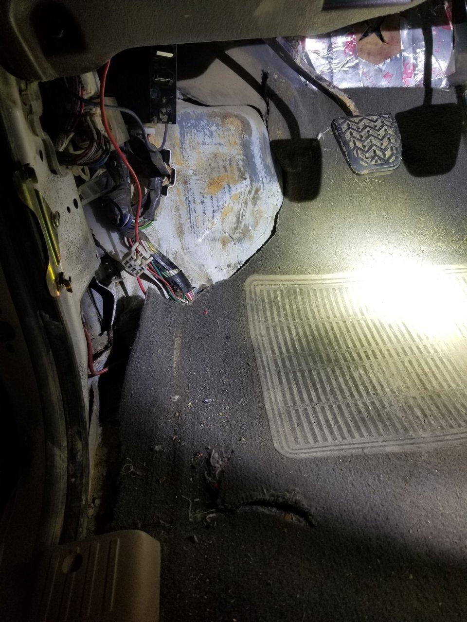

    Here ya go. Tried to get one of the clutch depressed for you. You can see the paint where my foot hits the floor when I shift. Thanks on the truck, been 15yrs in the making. Crawl box is hands down the best mod, I like it better than the solid axle for sure.

    I never had an issue with any clutch pedal interference after tubbing. But then again I’m only size 10 boots. Meh.

    IMO the only thing it affects is the amount of space you have to rest your foot on the highway.

    You can see my precision fender well sheet metal work left me with a good foot rest.

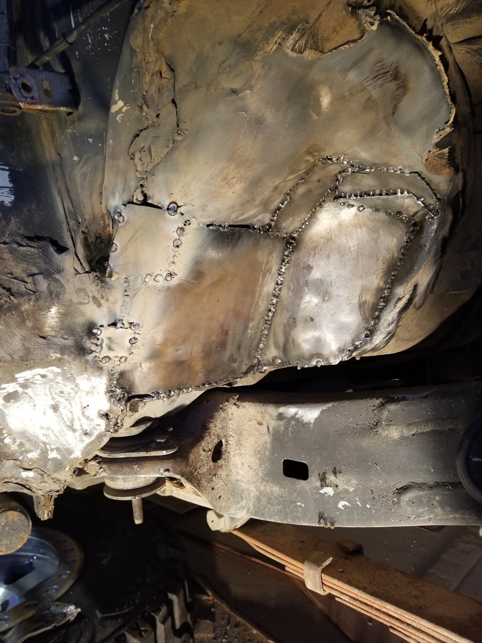

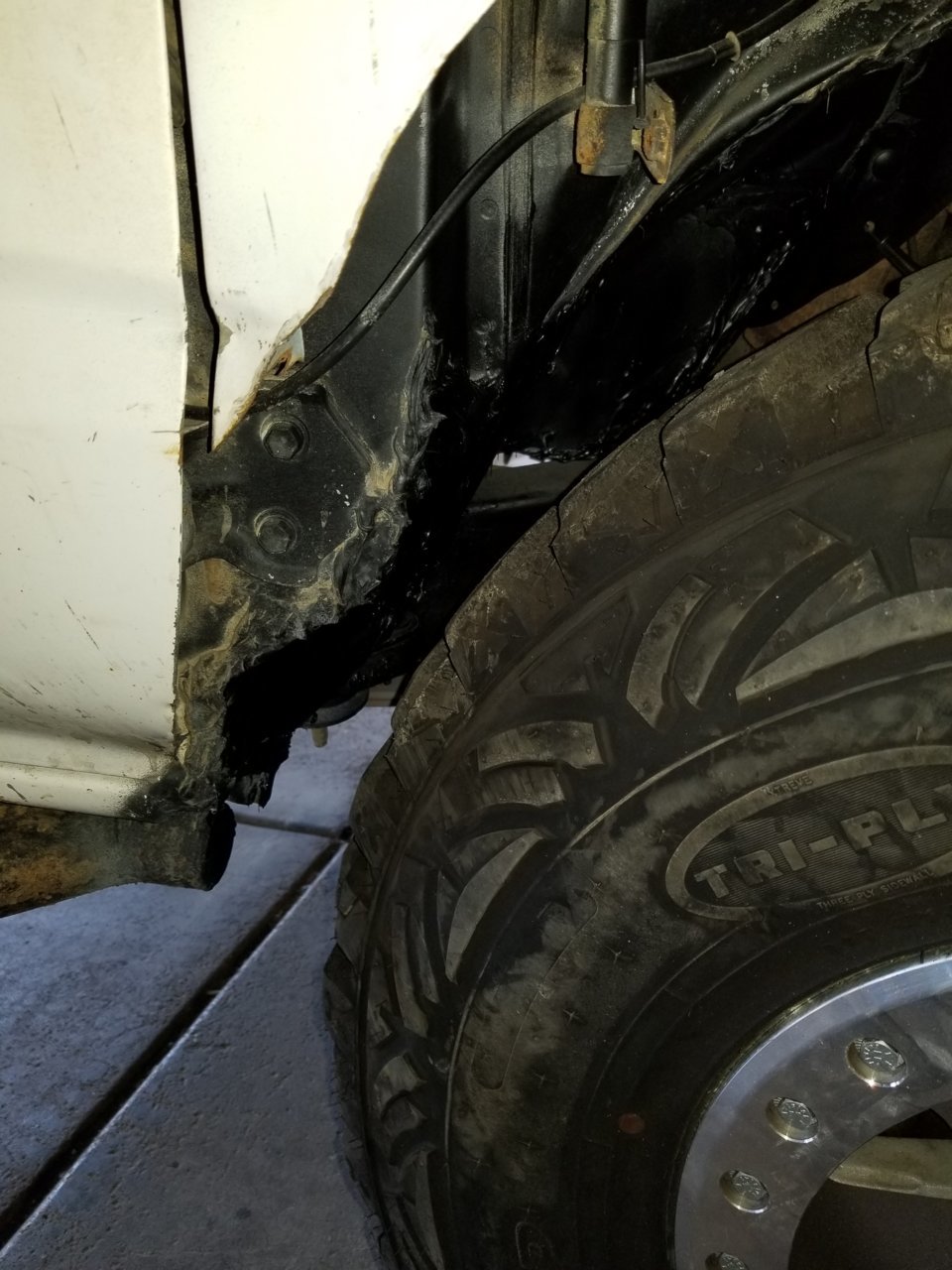

    Frigging finally done with the welding!! Just need to seam seal this and trim some sheet metal inside the wheel well so my pax doesn't fillet their leg. Only had one fire behind the dash, snow does a great job at putting fires out.

    That reminds me.. my new cab has a rust hole in that spot I need to repair.
    Good job, dude!

    Thanks! I'm a beast at flux coring sheetmetal now. The .030 wire was a lifesaver, so much easier!!

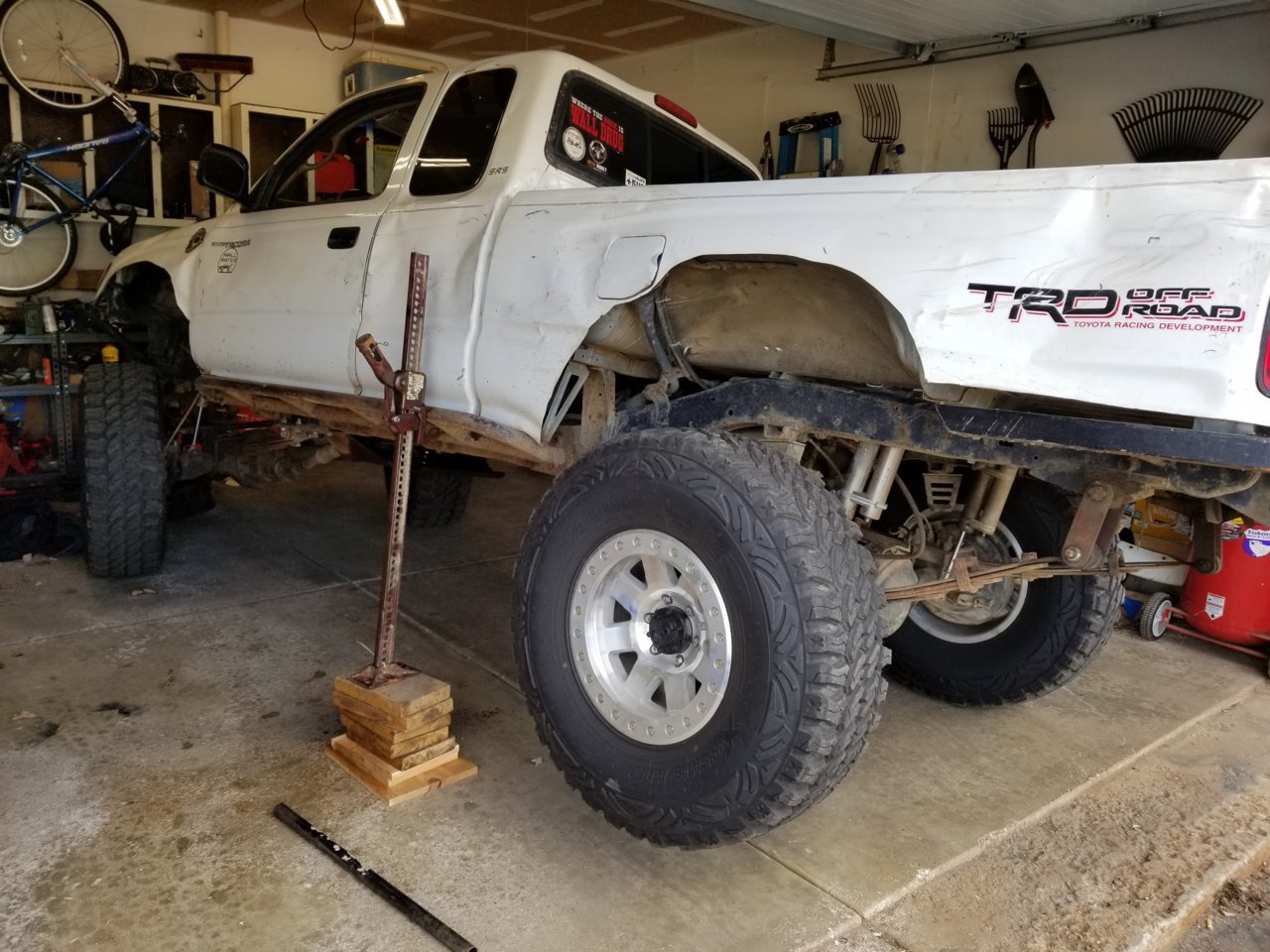

    75% confident the tubing was successfull. Sketch as hell hi hlift flex test, I'm a certified safety professional so dont try this at home!!
    Looks like the tire clears the fire wall but may be into the body mount, only way to know is to wheel this thing.

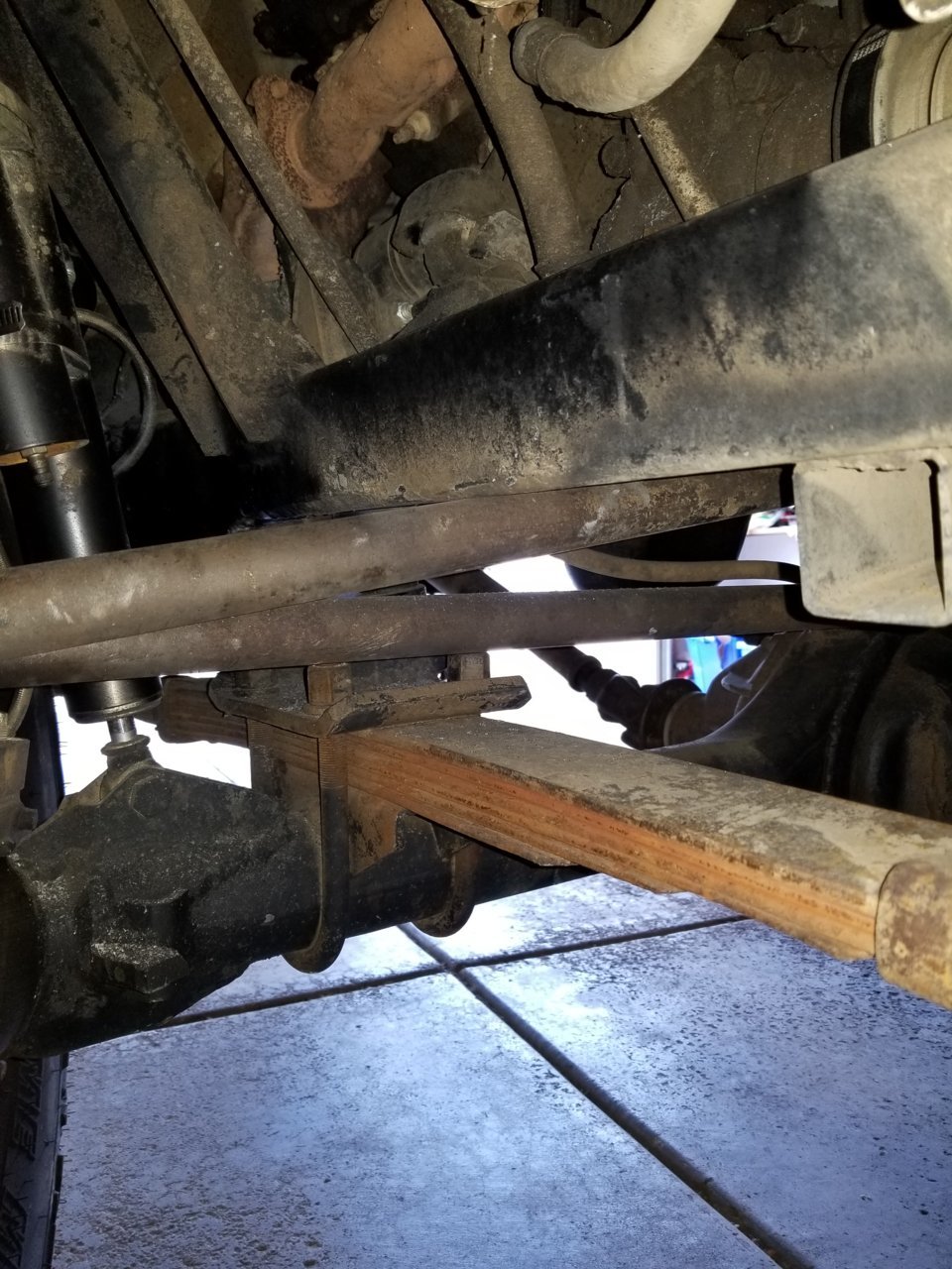

    Heres what I did find, the drag link is into the frame pretty good when flexed that way. I knew it was rubbing but didnt know the extent. I could probibly fix this by moving the air bump to outside the frame rail and building a new pad for it.

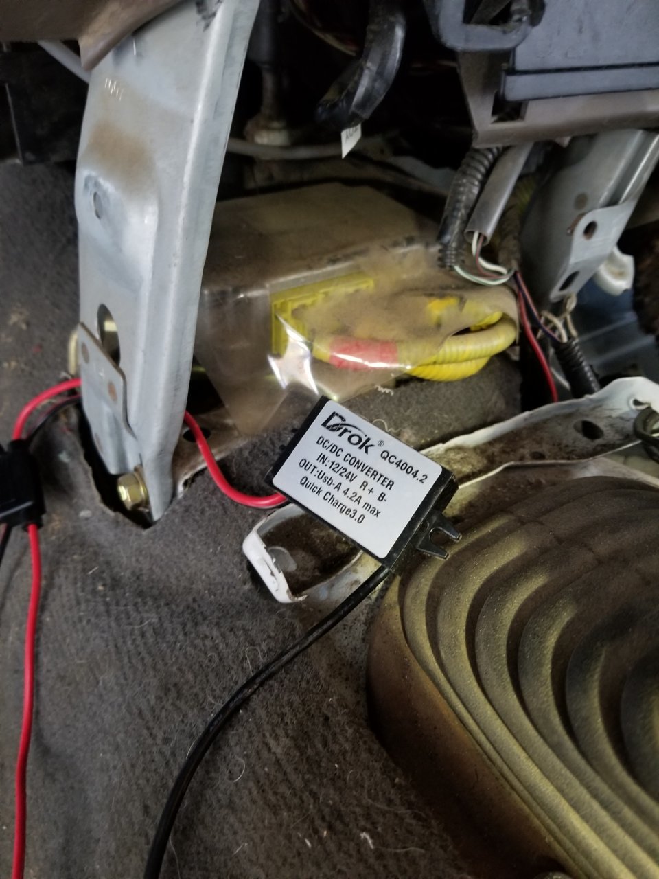

    installed this power inverter thing to fast charge my cell phone, I can use my GPS now and dont have to print off directions anymore!! (I seriously had to do this)

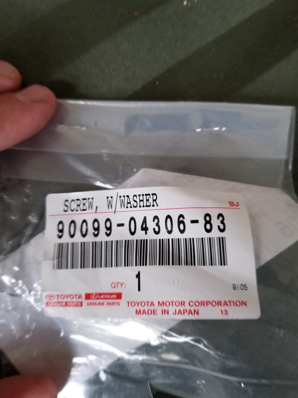

    This is the part number for the tensioner adjuster bolt for the idler pulley, it took me for fucking EVER to find this!! Looked at Multiple different sites, the fsm didnt have it, eventually found it on some foreign site that had exploded illustrated parts catalogues for all the sub systems. Would have been a good site to save, but my dumbass didnt. This was $.79 from toyota parts deal. I have no idea if it fits on the alternator or the powersteering pump. I may snag another and try the ps pump as that snapped off as well.
