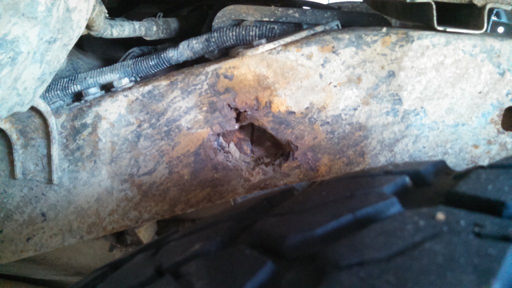

    Well i found another rust hole:
    I have watched that rust spot get bigger over the past few months and smacked it with a hammer, and went went through it. Its on the same side as my other rust related frame damage/tear. So i ordered up a set of CBI frame plates, trail gear frame boxing kit and some leaf spring hangars from ruffstuff and im going to rebuild the frame rails. I was thinking back half, however i only have limited time to work in my buddies shop, and i need to get this truck back on the road soon since i need it to wrap up some house projects before the snow starts flying.
    I have to bring the camry in for its 5000 mile service and im going to explain the situation to the service manager, explain the condition of the truck over all and see if it qualifies for the frame replacement. I'm going to stress that im not stripping the bumpers off, taking off my trans hump cover and rear shocks and trailering it to the dealer just to have them say no. I may have better luck with the dealer that i just spent 40k on a new car with then my local one who was giving me shit for wheeling my truck and welding my sliders on when it went in to get sprayed.
    If that doesnt work, then ill pull the bed off and start plateing away. I am also going to fix my rear shackle angle, re route my exhaust and add a traction bar while the beds off. How do magnaflows sound? I like the small size and that's the only reason im eyeing one up, i don't want something that makes my truck sound like a rice burner.

    Damn, that sucks. Looks pretty bad. Does it spread under the cab? If your not eligible for frame replacement... And it's ok under the cab. I'd chop the back half off and box up a custom frame.

    Look at post #58 in this build for pics of the rest of the frame damage. The drivers side is bad, the pax side is solid and fine. Ill use the frame plates to kick the rust can down the street for a few more years when i'm ready to back-half and flatbed the truck. By then my stock bed should be destroyed enough to no longer be use full anyway.
