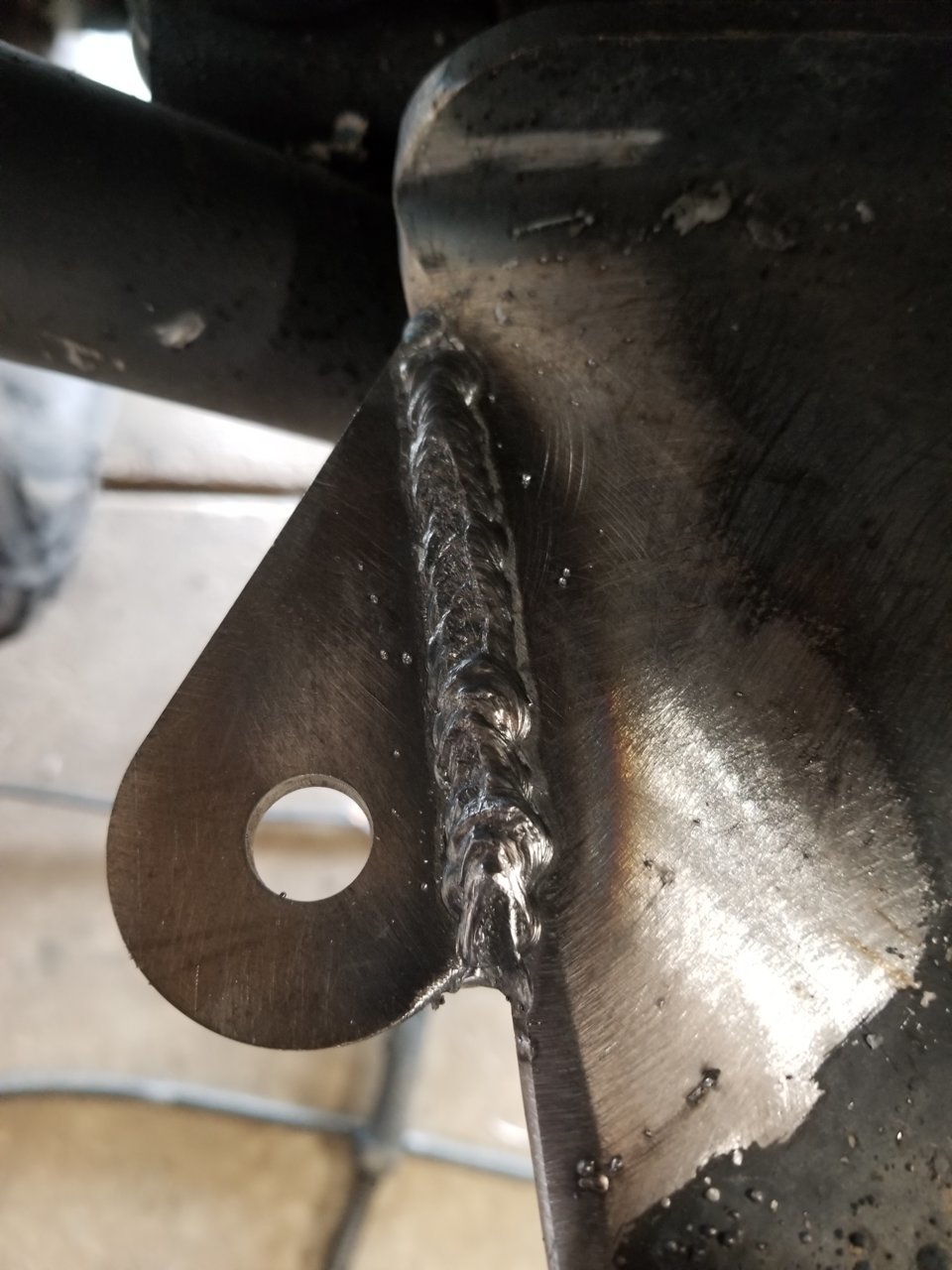

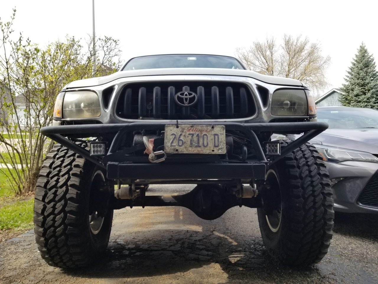

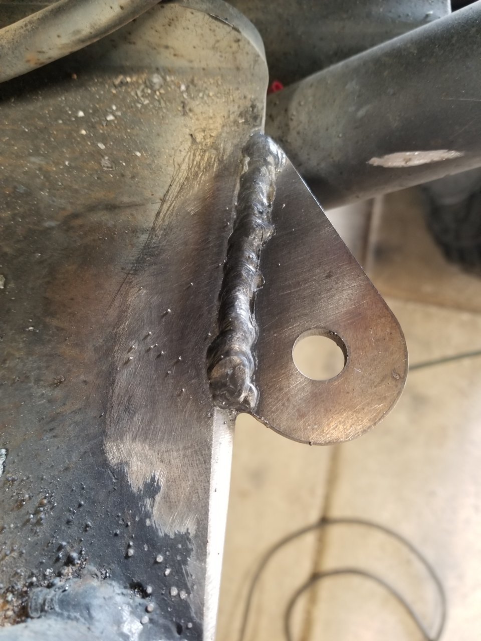

    Sign of the apocalypse, the tacoma got some LED lights put on it today that I have had in my garage for 3yrs.
    I'm mentally cracking as evidenced by this mod. #endthelockdown
    Crappy weld porn, these are the tabs, just glued then to the side of my winch mount.
    I still need to wire them up. I'm going to try to reuse the elocker switch as a light switch. That is unless I have to rip the entire dash apart to get to it, then I'll just put a regular 2 way switch on there.

    Lights are now functional, end of the world inbound. The cali raised harness and switch are fucking retarded. Who puts a lighted on/off switch on a harness that goes right to the battery?
