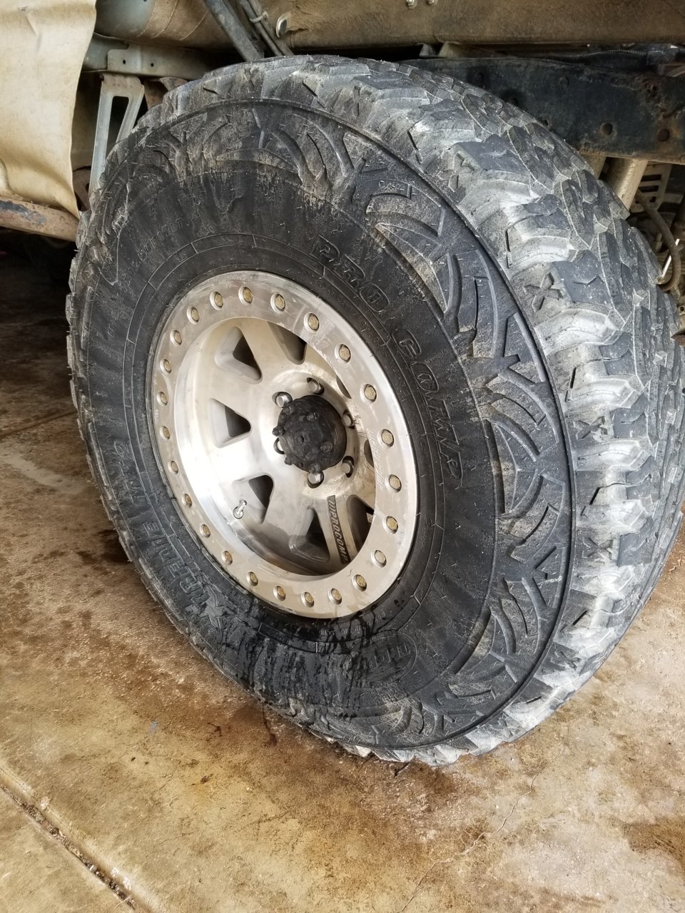

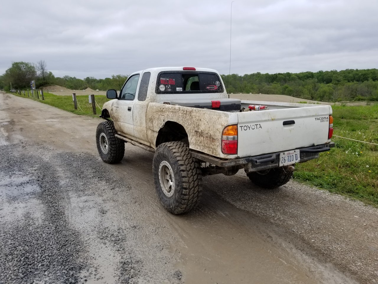

    Finally went wheeling for the first time in almost 2 yrs, hit up an offroad park with a small group. The pro comp MT2s are pretty sweet, I like them, this was my first time out with them. It was wet and sloppy and they did fine. I ruined a JKers attempt at youtube celebrity and their drone shot, and didnt break any parts on my truck, so today was a good day. My 2 pics for the day:

    My halfass review of the pro comp MT2 in 37x12.50x17:
    On road: they are great, balanced nicely even on beadlocks, great in wet weather and overall a nice street mannered MT. I only have 5k miles or so on them, and the truck is used more as a toy now, so dont expect any long term wear data.
    Offroad: worked great so far. I wheeled them in wet, muddy conditions on sandy rocks and they stuck pretty well. I was running them between 5 and 2psi. They wrapped around the rocks very nicely, no chunking, and no side wall gouges, and I was trying to jam the sidewall into rocks to see how they would do. They also cleaned out pretty well even in double low. I like them better than the toyos so far and light years better than the swampers I had. So far they seem to be about as good as the KM2s which I ran for years and loved!
    I would recomend them for a nicely priced street biased MT that works real well offroad.

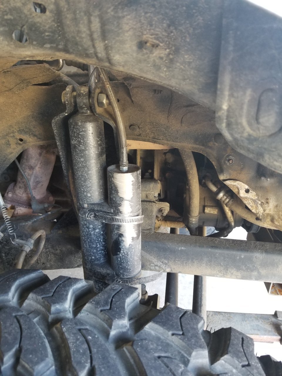

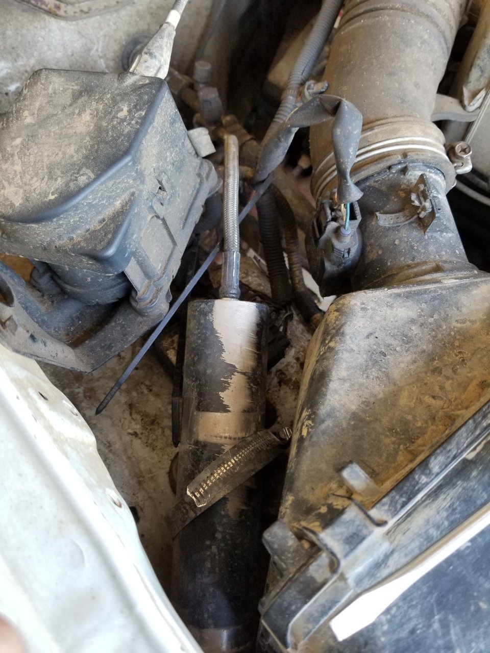

    After wheeling noticed my tire now rubs on my pax side shock resi. Time for some internet wheeling poser point reduction.
    Moved it to the engine bay, hose clamped it to the airbox support.
    Other than that, the firewall tub was successfull, tires dont come anywhere near it, they actually just barely kiss the body mount now.

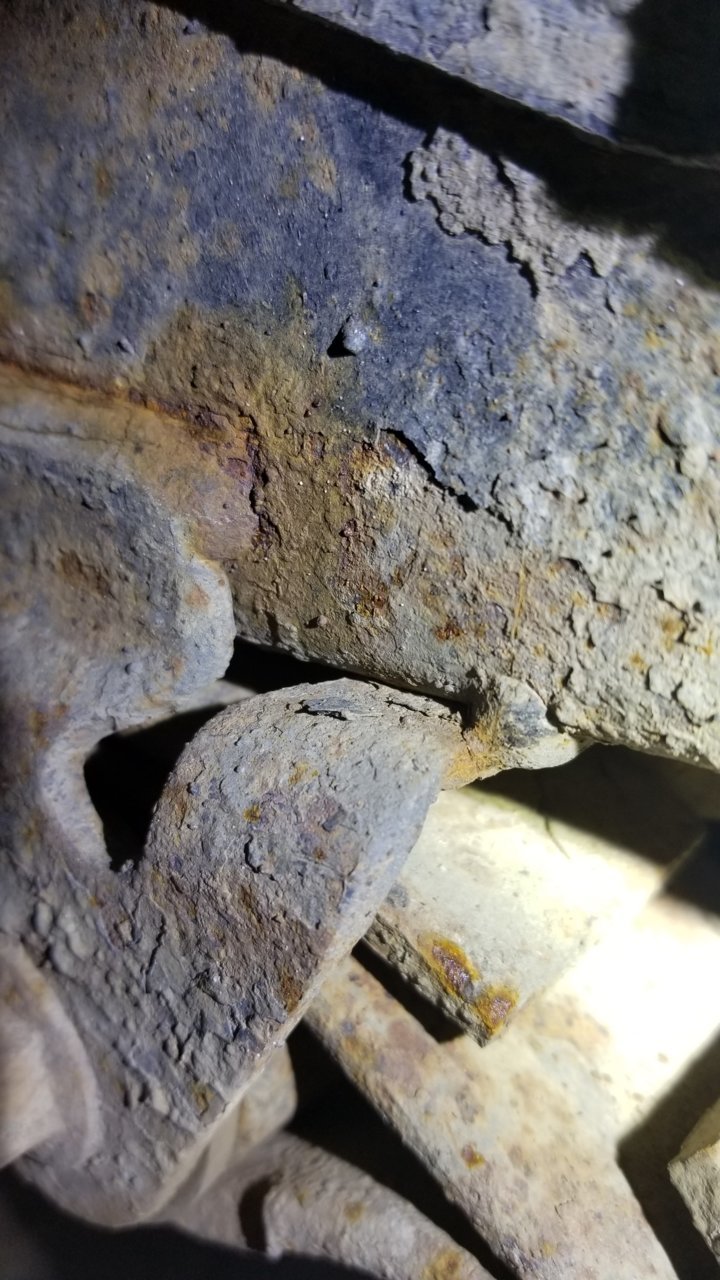

    Was looking at the truck today in the garage and noticed a crack on my rear spring hangar. Also looks like I'll need to plate above the rear hangar and tie it into the hangar with a scab plate as the metal around that weld looks pretty rough. Man its tempting to just frame swap this truck once I find the $$$
    Note the crack on the rear most weld.
    Rust around the top of the weld.
