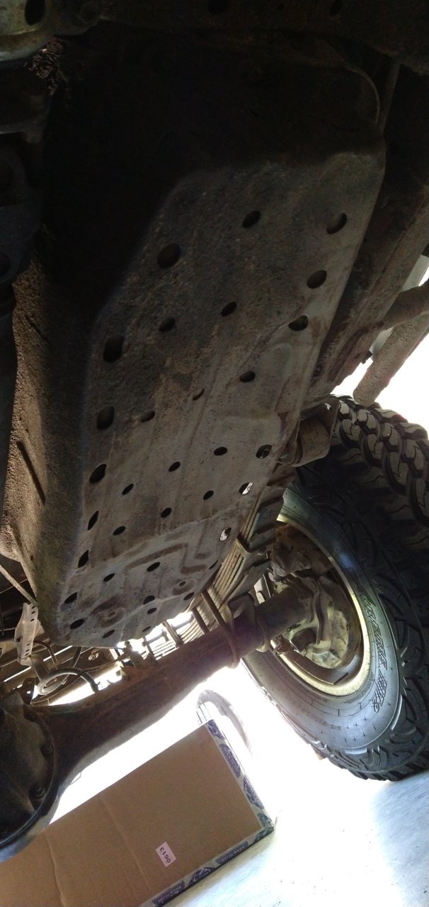

    Factory tank. I like the location of it as it protects the driveshaft. I don't want it behind the axle because I don't want to worry about anything but the taillights dropping off ledges, and I don't have the clearance to stick it above the driveshaft/below the bed, plus a shaft breaking and blowing a hole in my fuel tank sounds like it wouldn't be fun. Plus I like to keep the critical systems simple on this truck. I know that low range skid has some issues, but some steel and an afternoon with the welder I may be able to fix some of those, mainly some extra braces over to the frame.

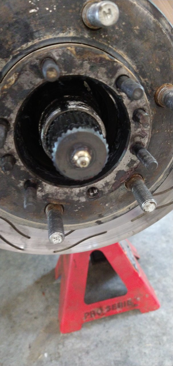

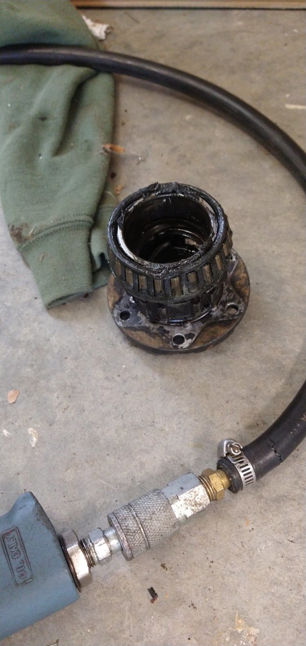

    Preventative maintenance day on my DD Camry, so that means take the front axle.of the Tacoma apart LOL!! This is the first time the front ends been apart since I built it, I was chasing a hub that wouldnt unlock all the way and a chriping noise while turning left. Both hubs looked good, no birf soup and no evidence of water. I tore the pax side apart and regreased the bearing and slapped it back together, waiting on gaskets now. The chirp appears to be coming from the brakes. It looks like the hub issue was a chunk of RTV that got stuck between the hub clutch and the spring.
    I do need to adjust the knuckle shims and center that axle shaft in the spindle, but I don't have any shims on me and it's pretty tedious so screw it LOL!!
    Bearing looked good as well! I'm going to tear the driver's side apart later this week or next weekend.
    Just for fun here's the current state of the fuel tank, LOL!!

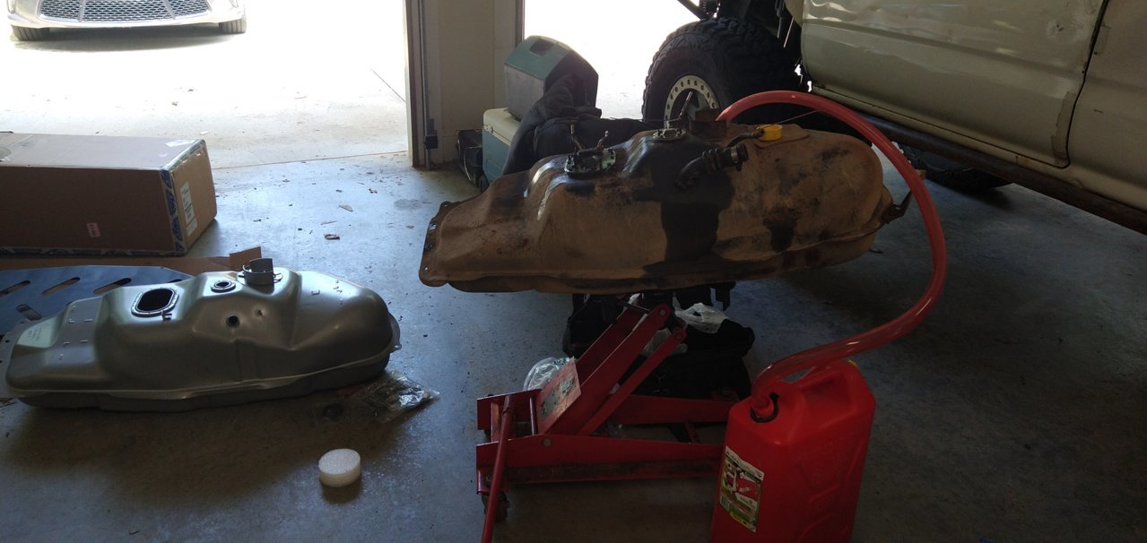

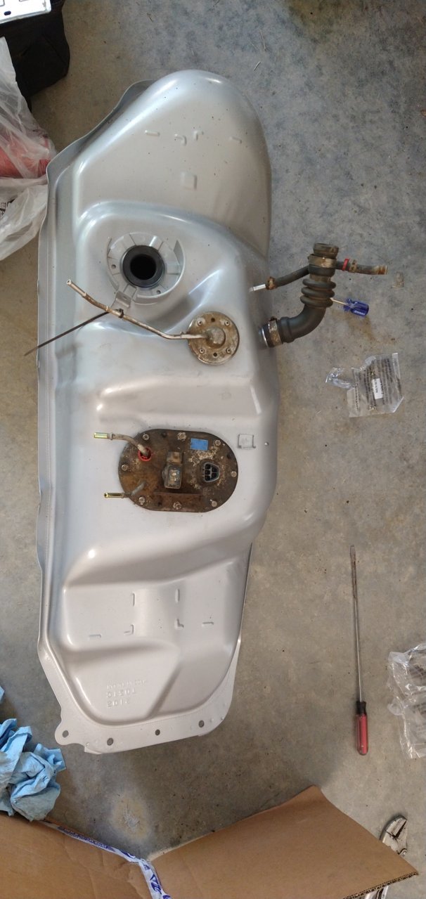

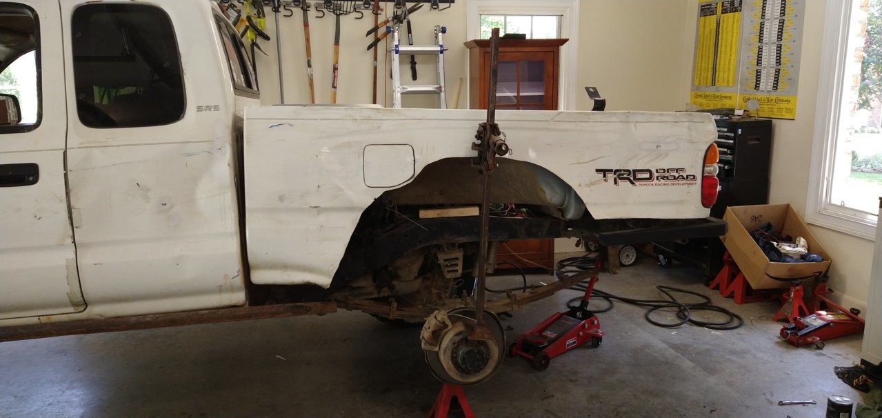

    Got the fuel tank out of the Tacoma today, fucker put up a fight!! The damn rats nest of hoses going in and out of the tank is the biggest PITA. I need to replace to hose that crumbled and I broke a nipple off the charcoal canister purge valve thing. I'll need to figure out a solution for that, either rig a nipple back on it or just buy a new one. Onto the pics:
    Don't try this at home, I'm a 17yr credentialed safety professional (that's actually 100% factual)
    Unbolting the bed and jacking it up helped a ton.

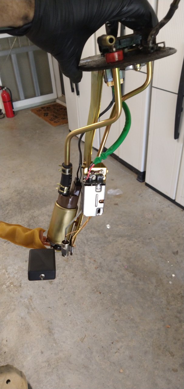

    Tanks out, now for the interesting part. My truck was showing less than a half tank, I sucked over 22 gallons out of it. So I believe the dents in the tank moved the fuel pump/sender back and up, thus reducing my usable fuel capacity. The truck would die going down steep hills with less than a half tank indicated.
    Bent ass fuel pump assembly.
    I'm going to install the new tank any way, and I do have an idea to more solidly mount the low range skid plate so it's not relying on the fuel tank to support the weight of the truck. More pics to come on that once I get some steel!
    Install should go MUCH quicker, I was smart and marked all the lines with color coded zip ties so I know where they go.

  8. Sep 5, 2021 at 2:42 PM
    #1108
    Dalandser
    Dalandser ¡Me Gustan Las Tacos-mas!
    Feb 19, 2015
    #149090
    16,797
    Anthony
    Downey
    08 PreRunner Regular Cab / 98 4x4 Extra Cab
    Empty Wallet Mod
    A cherry picker works to remove the bed and pick up the engines for motor mounts etc. Harbor freight 2 ton is only $209 regular and less than $200 couple times a year.

    The part I broke is called Part No.: 77390-35010
    VALVE ASSY, FUEL TANK. It was $51 from Toyota parts deal so I ordered it up, should be here next week. I live in a county that doesn't do emissions inspections, but I would much rather have this all fixed when everything is out and accessable so I don't have to worry about it again. I don't need the truck running until the 18th anyway when I'm going wheeling next, so this gives me time to build those extra supports for the skid plate.

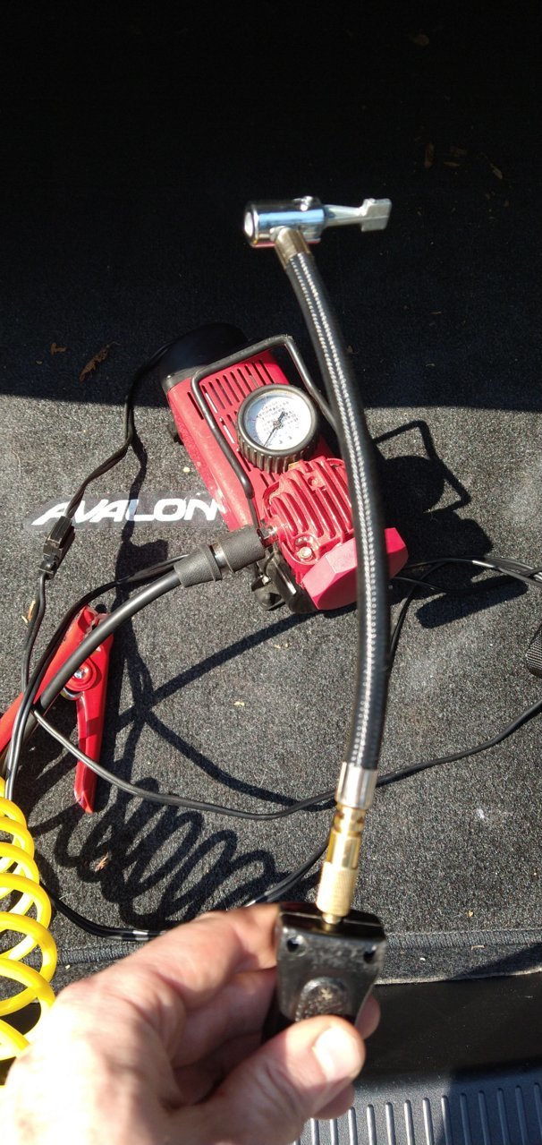

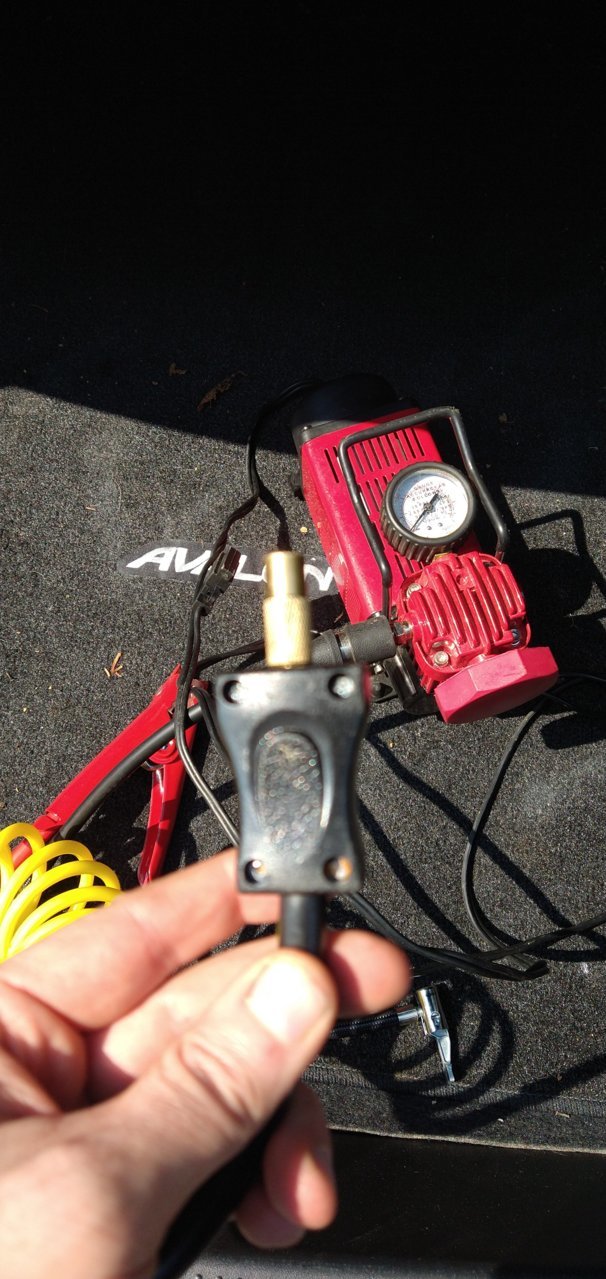

    The hardcore mods keep coming! My tsunami mv1050 whatever the hell they are calling them shit week air compressor has this screw on air chuck, this sucks because it doesn't fit on my beadlocks and is all around kind of a PITA.
    Weird chuck thing;
    Well random Amazon vendor selling Chinese parts for my Chinese air compressor to the rescue!! They make a clamp on chuck for this type of hose that screws right on, so my compressor works with my beadlocks and allows me to air up my leaky DD avalon tires weekly very quickly because Toyota made wheels in the early 2000s out of swiss cheese.
    Sweet new chuck:
    Inb4 buy a viair or a power tank, NO!!
