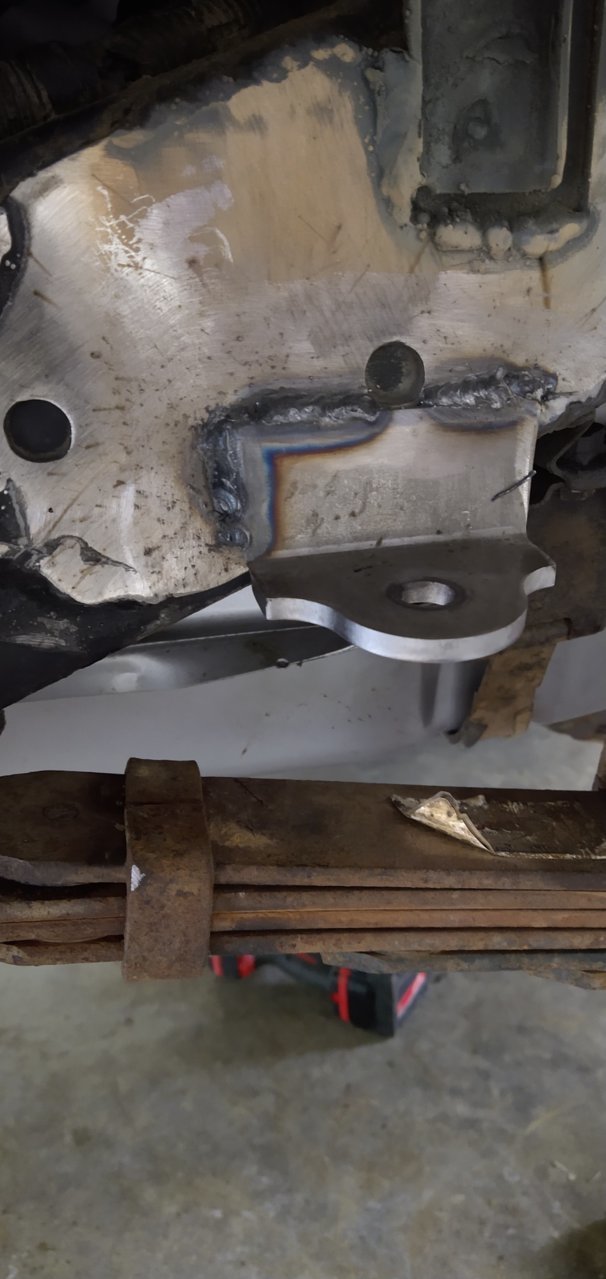

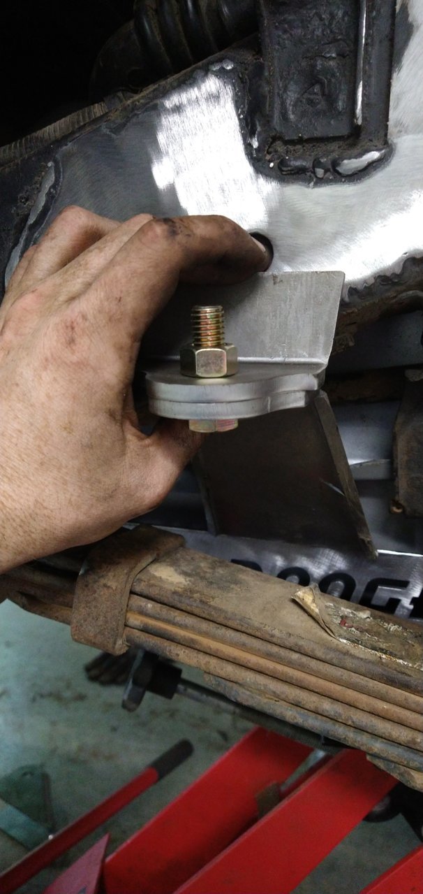

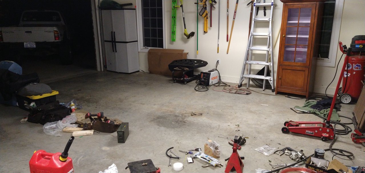

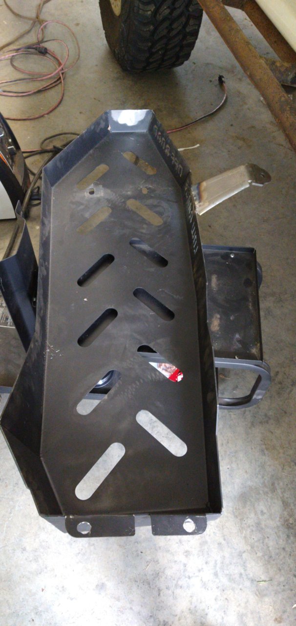

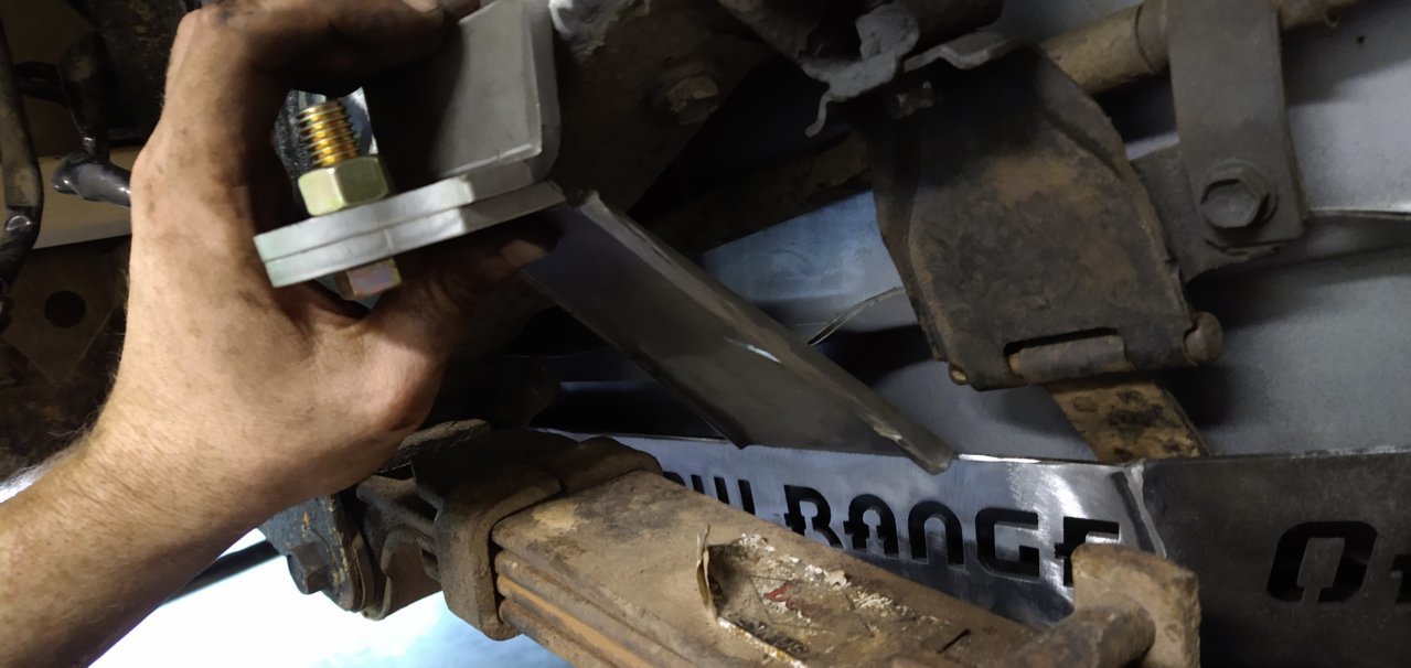

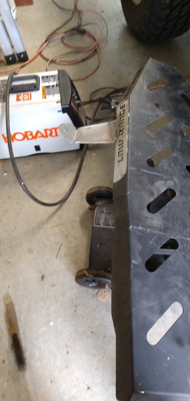

    My first set of mounts are burned in for the skid. I won't have time/ materials to do the u bolt up to the cross member that I want to do for the pax side of the skid. Found out my garage breakers are happier if I plug the welder right into the wall without an extension cord. This should hold:
    It looks like it warped down when I welded the brace to the skid, the good part is the skids pretty easy to bend with a jack/holy crescent wrench, so I'll just gun the bolt on there and call it done once it's mounted.

    If the breaker is tripping with the extension cord try a higher Amp rated cord. My miter saw did that with cheap small cords when I got a good 30a rated cord no more problems

    It's the crappy 15amp GFCI garage outlet breaker. I have an appliance extension cord that worked great in my previous garage with a 20amp breaker/outlet.

    It's half right now, but yea that's my end goal. My end plan is a piece of square tube or angle iron, and weld that to the rear pax corner of the skid plate, and attach it to the spare tire cross member with some square u bolts/u bolt plate. If you lay under the truck you will see what I'm thinking and it will make sense. I won't have that done now, but I'll knock it out one weekend in the future and post pics. The other advantage is you won't have the mounting bolts sticking down, which at minimum need a bolt protector welded to them IMO.
