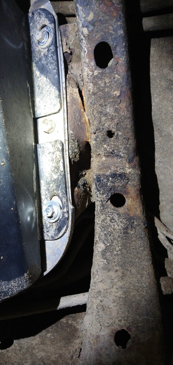

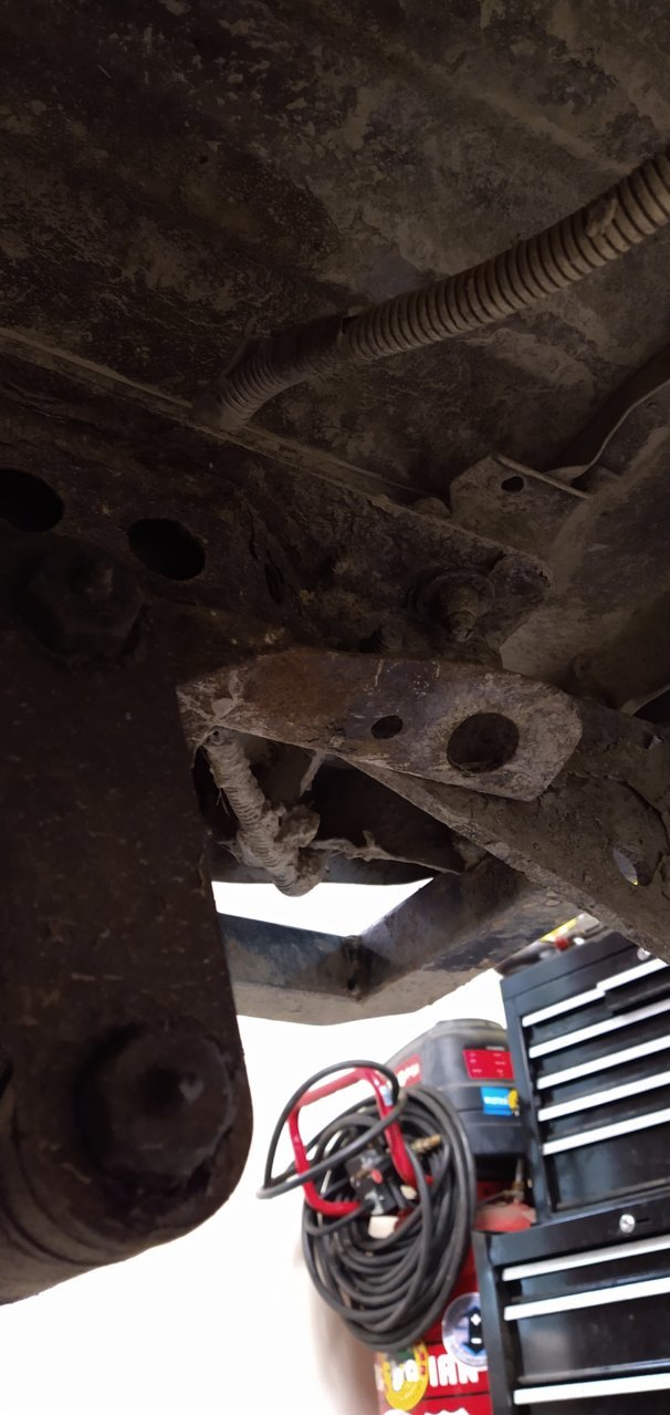

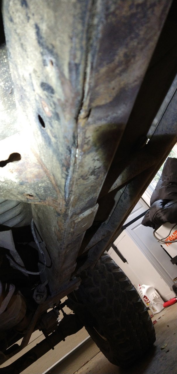

    Laid under the truck for a few hours today with a slag hammer and a screw driver trying to get the truck to tell me some stories of wtf happened. I found a crease back by my shock mount on the rear frame rail and nothing much else. I think all the force just bent the bastard. I was whaling on the frame with a slag hammer trying to find soft spots and holes, everything is solid. The only issue I found was on the opposite side by the fuel tank where I patched a rotted out hole. The frame cracked and a chunk is ready to come off. The rest of the frame forward of the body mount is good. The new plan I think is to chop the rear end off right at the rear body mount and rebuild the ass end of the truck. I may flat bed it, probably a roll bar back there as well. I do need to be able to carry cargo and shit so probably some sort of removable spare tire mount for when I go wheeling. I'll most likely keep it leafs and dump all my money into tooling and metal to fix this shit.
    More pics of where the frame bent. Super solid metal.
    Found my gas tank mount is tearing off

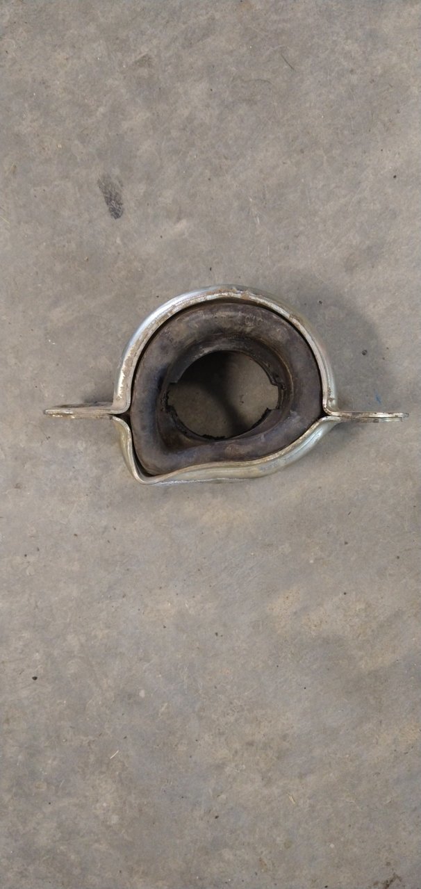

    Replaced the carrier bearing today and did some preventative maintenance while I was under there. Greased all the u joints f/r, tightened ubolts etc. Truck is smooth as glass, some of those zerks we're thirsty!!
    I have been chasing down a rattle, screeching, almost like a stripped out spline sound since I went to windrock a few months back. It's loud as hell, like people turn and look loud. I serviced my front hubs thinking something was fuckerd up there, well today I pinpointed it to the rear. Of course I assume the worst and was thinking my lockers fucked. I drain the gear lube looking for metal, and while I was down there I bumped the pinion dust shield and it rattled and sounded like the noise I have been chasing. Gear lube looked good, so I am writing it off as the dust shield and not worrying about it.
    Goes to show to assume it's the simplest problem and go from there.

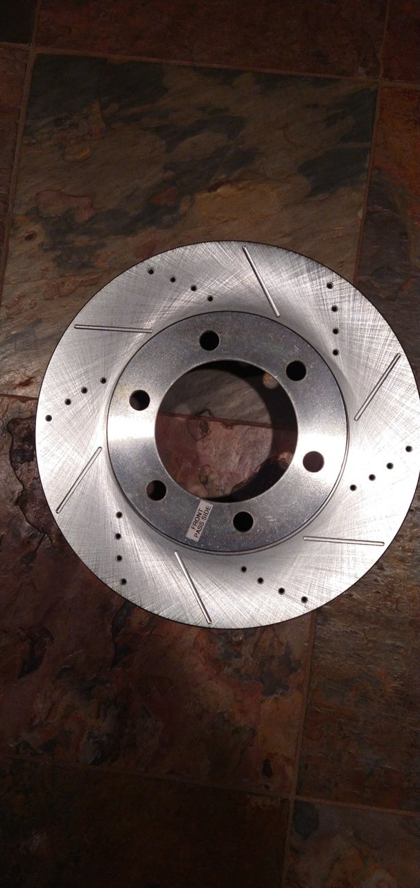

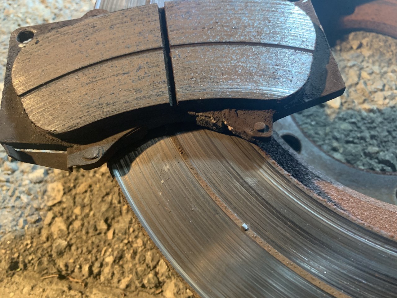

    Warped my front rotors (I think), so I picked up some power stops from rock auto.
    The truck violently shakes the steering wheel under braking, everything looks tight...

    Developed a bad shake on braking when this thing imbedded itself into the inboard side of one of the rotors.

    Damn!!
    I'm running some really old brake pads that I'm sure aren't helping the situation either. New pads show up Friday, fingers crossed these actually fit over the rotors unlike the last time I did the brakes on this axle!!

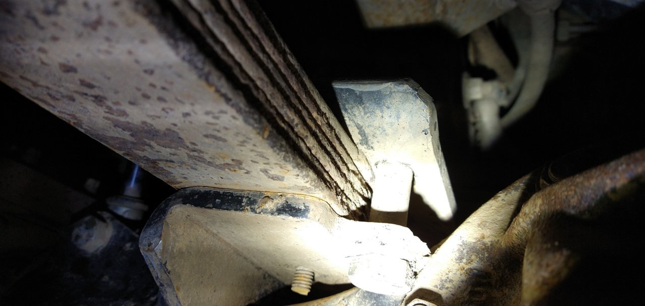

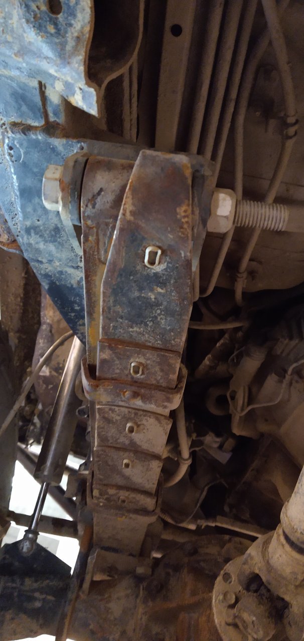

    Well this truck isn't moving for a while, looks like I broke the main leaf on the front driver's side at either windrock or Harlan. Probably both trips did it in. Anyway at least I didn't put some unicorn springs up there, fawk LOL!!
    Look real close by the spring plate.
    I was trying to bang these straight and notice the main leaf was u shaped...
