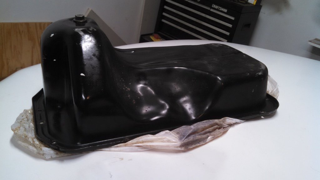

    Got my oil pan. Its off some forgein model v6 toyota something or other. All i know is that its rear sump, has a cool indentation for my axle and will bolt up to a 3.4. I got it off a dude on pirate for 40 bucks, cant beat that.

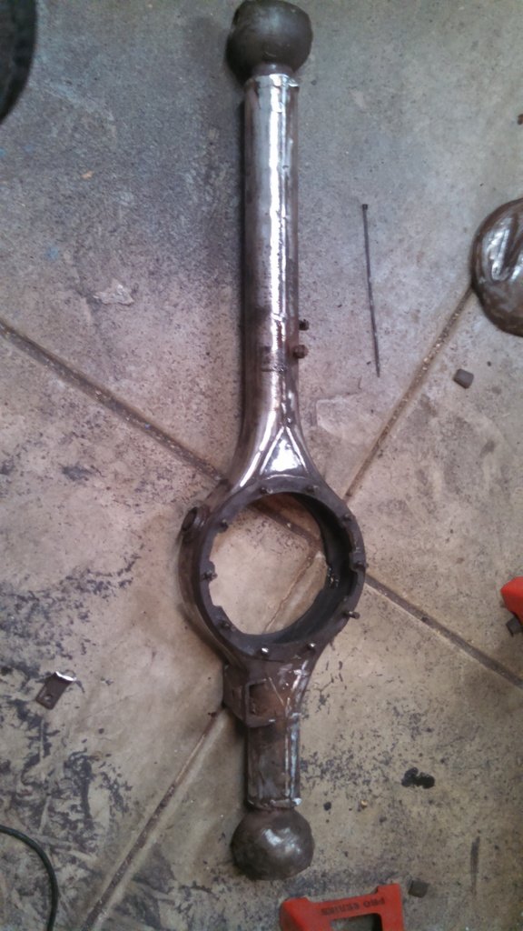

    Just about cut my finger off cleaning off my axle, i fucking hate my grinder. Got the diff cover cut off for the axle flip, along with the steering stops and some other little crap.

    wow....its got the dent on the driver side of the oil pan...perfect for extra clearance on the flip. Nice catch.
    Glad to see you are flipping out. Gonna rotate the knuckles a little?

    Flipping out indeed ZUK! Knuckle flip and rotate is a given, I just need to get a better grinder first. It has no guard and kicks all over the place. Those notches in the housing for the gears are a surprising pain in the ass to cut!
