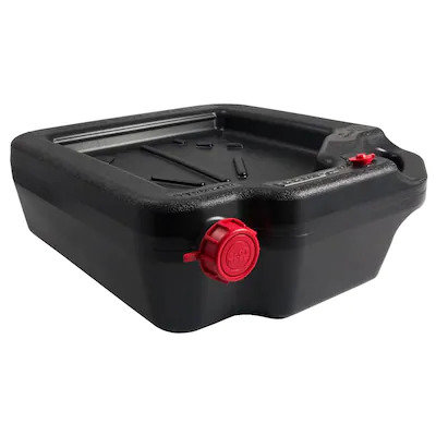

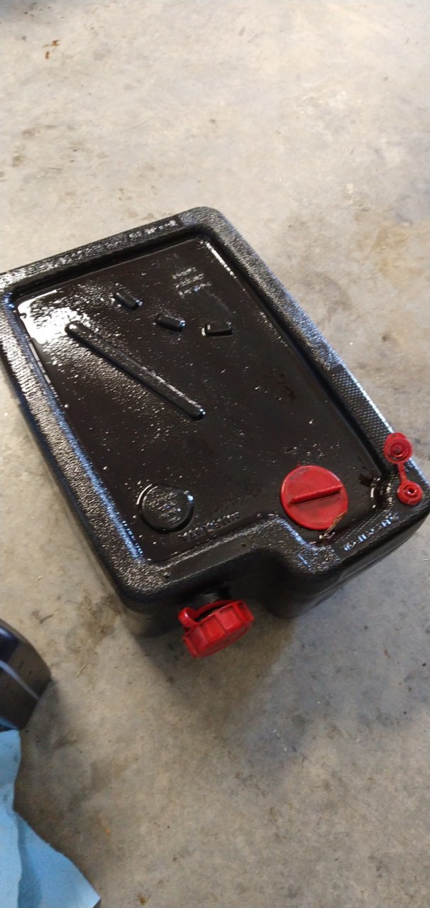

    If you ever decide to get this style oil drain pan/container, punch yourself in the dick until the thought goes away.
    I'm fairly sure I could make less of a mess just draining my oil onto my garage floor.
    Anyway changed the oil for the first time in God knows how long (probably 2yrs and less than 10k miles) and nothing shiney. Next week is my favoritist maintenance activity, changing the fluid in my crawl box :barf:

    Dang surprised you don’t like it? I have the big one and little one and never spilt nothing. Little one works well for holding oily third members lol

    That thing overflows instantly it seems and the stream of oil hits the raised fins and sprays oil all over the place.

    I could see why, it looks super shallow.
    This is the one I have and I love it. Handles the 15 quart oil changes on the 7.3 fine and you just put the caps on to run the used oil back for recycling
    FloTool 42003MI 16-Quart Drain Container

    I use this one for oil changes as well. Just dumped 3 gallons from the dodge into it with no issues

    Yeah screw this thing. I have one and it just ramps the oil all over the garage floor when I do my Sequoia. Swapped to one of these and didn't look back. The old one is still good for non-engine oil.

    I use this style and it's mint. Mine has the ability to cap the drain too.
