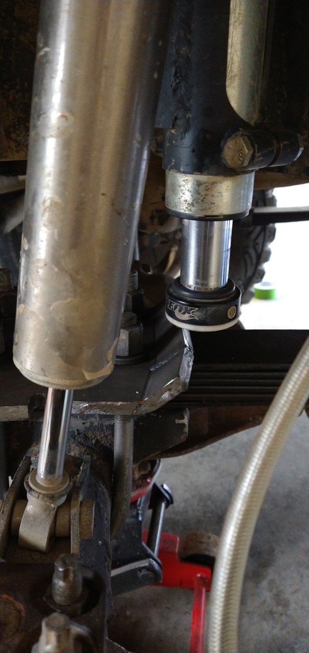

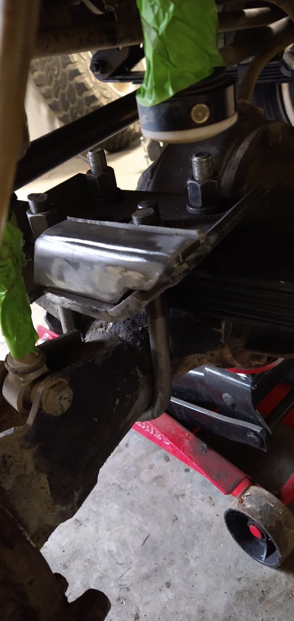

    Prepping for the wheeling season, welding on my air bump pads. Man this has been such a PITA ever since getting these, it seems there is no good place to put the pads on this axle with leafs. So here is version 2.0.

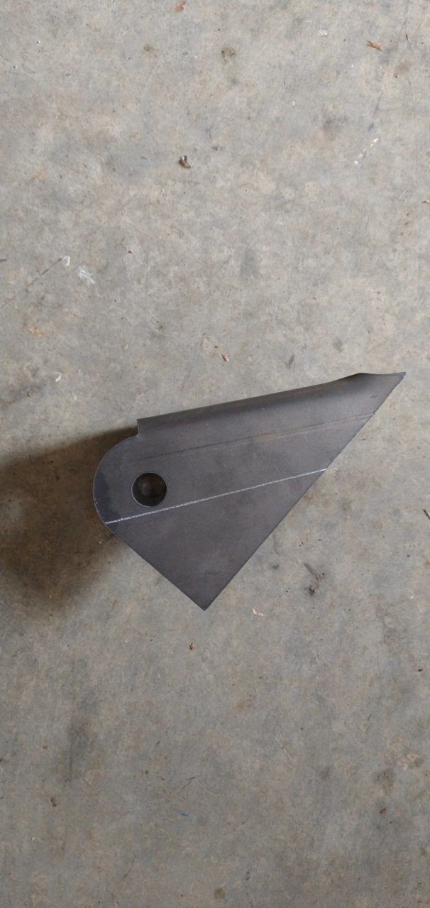

    Pax side:
    Took an leaf bracket I had laying around and cut it.

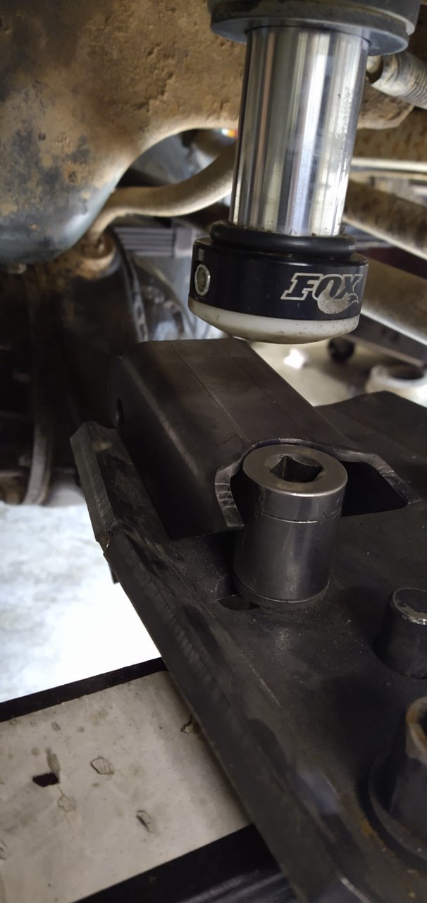

    Then test fitted:

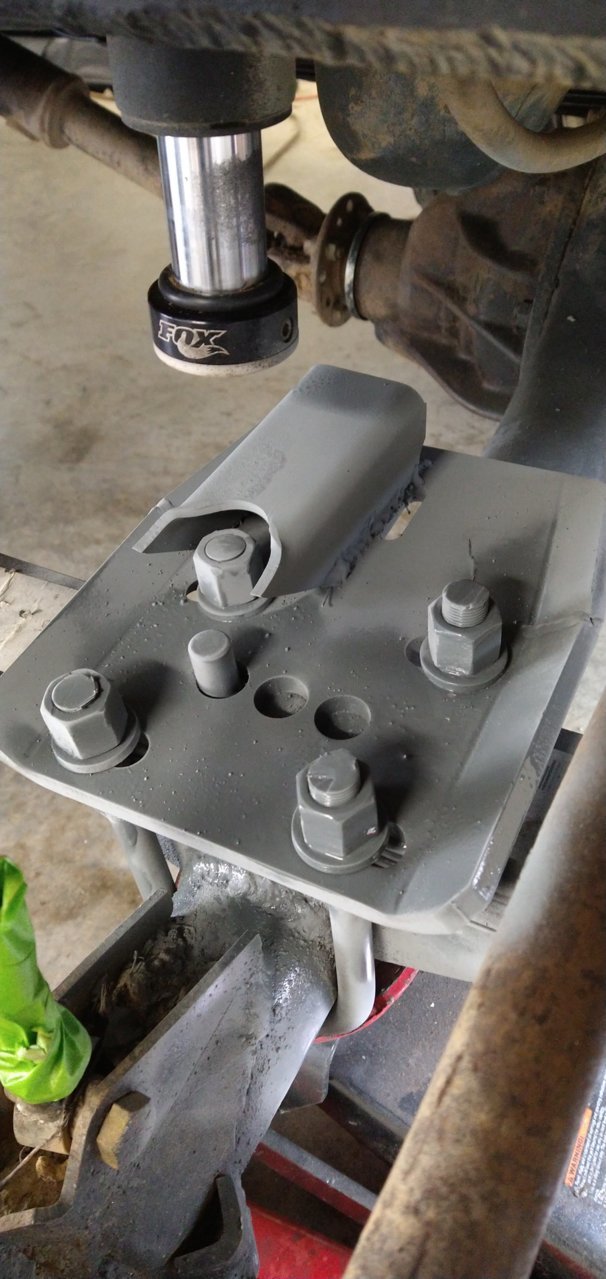

    Waiting for the primer to dry, boogered in. Man I hate only having a 15amp breaker in the garage.

    Some guys use a hole saw and put the bumps through the frame or inside the frame.

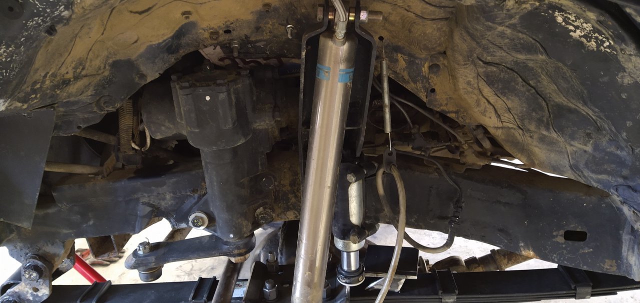

    That was me mostly making fun of myself, I have this stupid forward swing box steering in the way of everything on this side. I may cut that lip off the spring plate and build my bump pad mount off that now that I have been thinking about it for a day. I don't think I'll lose too much strength on the plate either.
    Pic for reference of what I'm working with from a frame/bump mount perspective.

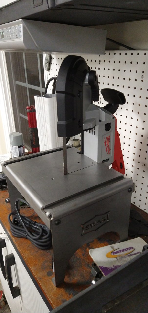

    Impulse morning tool buy:
    I'm done cutting parts on a cut off wheel with a grinder while they fall out of the vice. Now I just need to figure out what band saw will fit in there.
    So the truck may be chilling on jackstands until my new toy arrives :D

    I think one of the HF ones works and of course the Milwaukee

    They have a list of Milwaukee ones that fit but it's like 20 part numbers. I'll make a spreadsheet and compare them all while at work when I really should be making a spreadsheet for my actual job LOL!!!

    I'd go for more quality on a saw blade. HF sawzall blades suck - and I have an extensive set of HF tools I use... I've got nothing but love haha

    I know you’re busy looking down on the rest of us plebes, but I love the Bauer portaband that I got from HD. Pretty sure it works with one of the Swag tables too.

    That's the one I was thinking of it's pretty much a direct knock off of the Milwaukee.

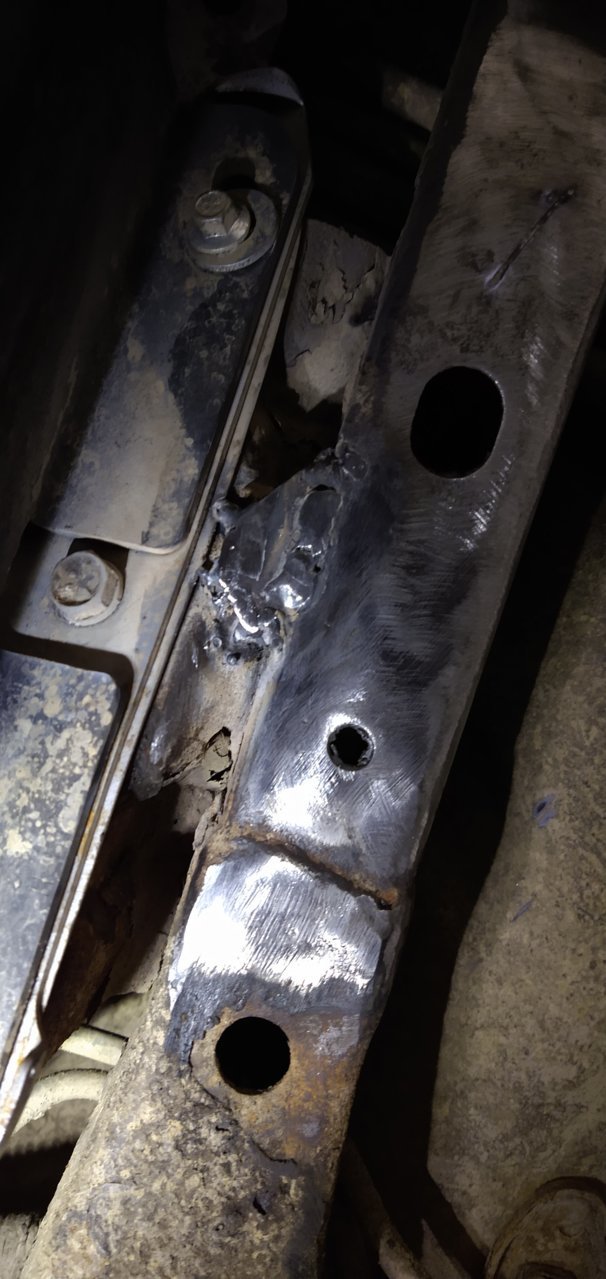

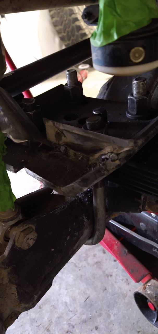

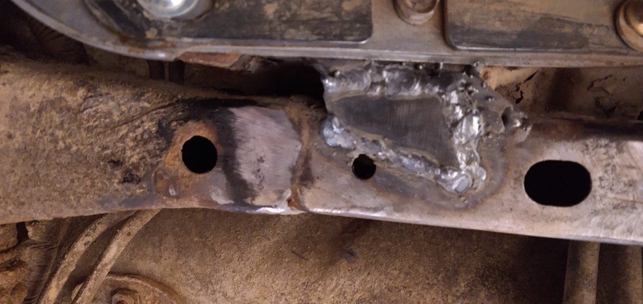

    Finally was able to get out in the garage and play with my new saw and work on this POS. I have a few trips in March so I need to get my shit together.
    First things first, fix my gas tank mount that was ripping off the frame.
    Added a filler piece then put a plate over it:
    After that I fixed where I bent my frame at Harlan with some angle iron and patched up some rust holes on the pax side.

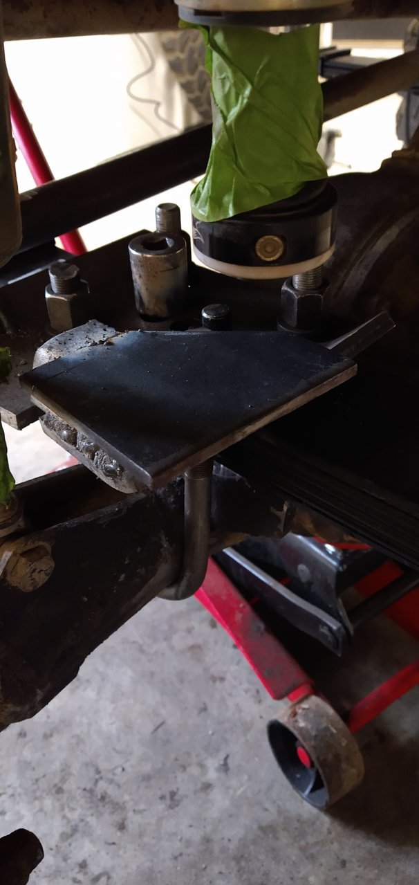

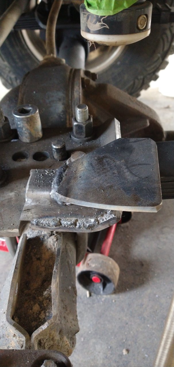

    Then onto my hell project of building my driver's side air bump pad. I was seriously ready to cut the front suspension off today and move the whole axle forward, but cooler heads prevailed. This was my final.solution:
    Leaf spring mount, cut in "half" and welded onto the spring plate
    Next half welded on:
    Then a plate over it, at this point my welder was being a cocksucker so it's kinda boogered on there, I may just say f it and run it lol
    Just about my entire day was spent laying on my back, covered myself in rust dust, welding mere inches from the gas tank, covered in welding slag and what's left of my frame undercoating melting and falling on me. Doesn't look like much but I made like 3 revisions of that bump pad mount. That band saw is badass and its nice not shaking hands with death evreytime I need to cut some metal like it is with the grinder. Also it's a lot slower, but more precise which is what I was looking for.
    I also saw my driver's side fender is caving in pretty bad, so I'll need to move my battery sooner than later.

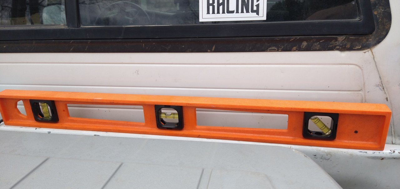

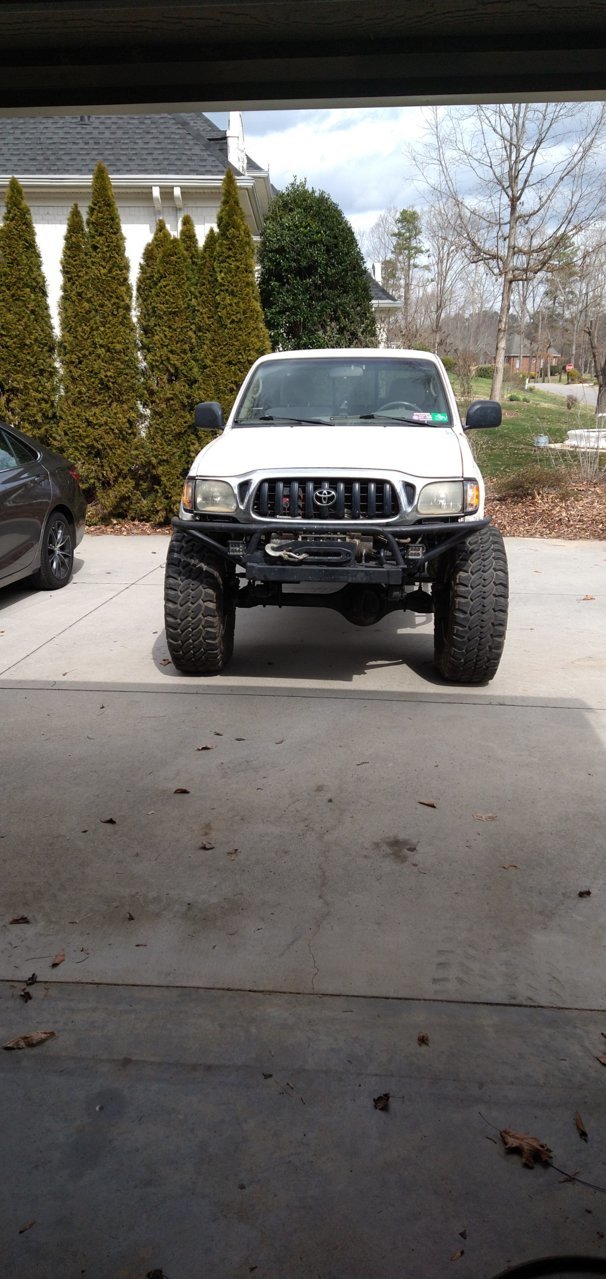

    Finished up my bump pads today
    It left the garage finally

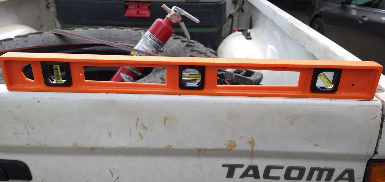

    Threw a level on it for the hell of it, my driveway must be sloped or something.....
    Spa day continued for the truck, I changed the tacse fluid, that 75w-140 I run is like snot, but clean with only the usual metal shavings in it. Refilled and it should be good to go for the season. I'm ready to wheel this upcoming weekend!!
