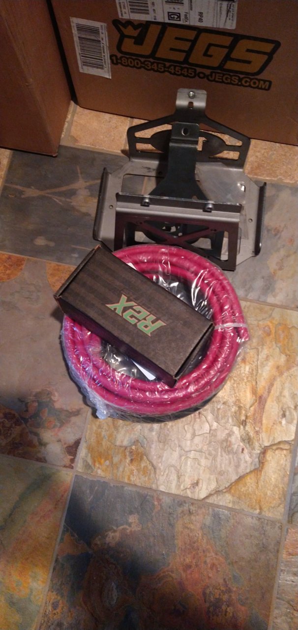

    Got all my parts, except for crimps, for my battery relocation. This will be my next mod once I get back from wheeling.
    TG battery box, positive and negative bus bars and 20ft of black and red 1/0 welding cable.

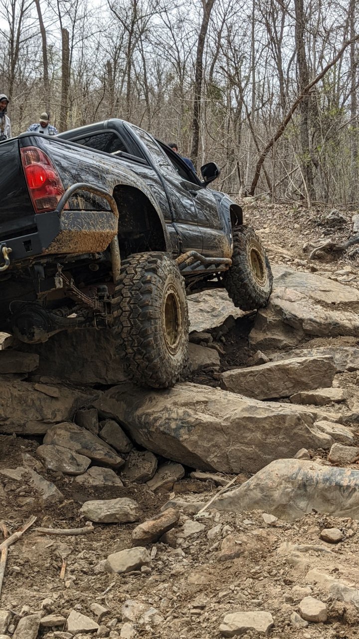

    1st trail of the day:
    Front shaft

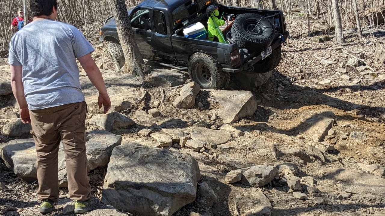

    So good evening ranch in WV is pretty awesome. I broke 15ft into the first real trail of the day so I rode bitch the rest of the time, definitely going back!
    IMG_20220311_174705853.jpg IMG_20220311_174004615.jpg IMG_20220311_133116024.jpg IMG_20220311_102653295.jpg
    I left the park this morning, it was snowing like crazy so I headed home, I'm sure it will be a carnage fest today with the rest of the group that stayed there to wheel

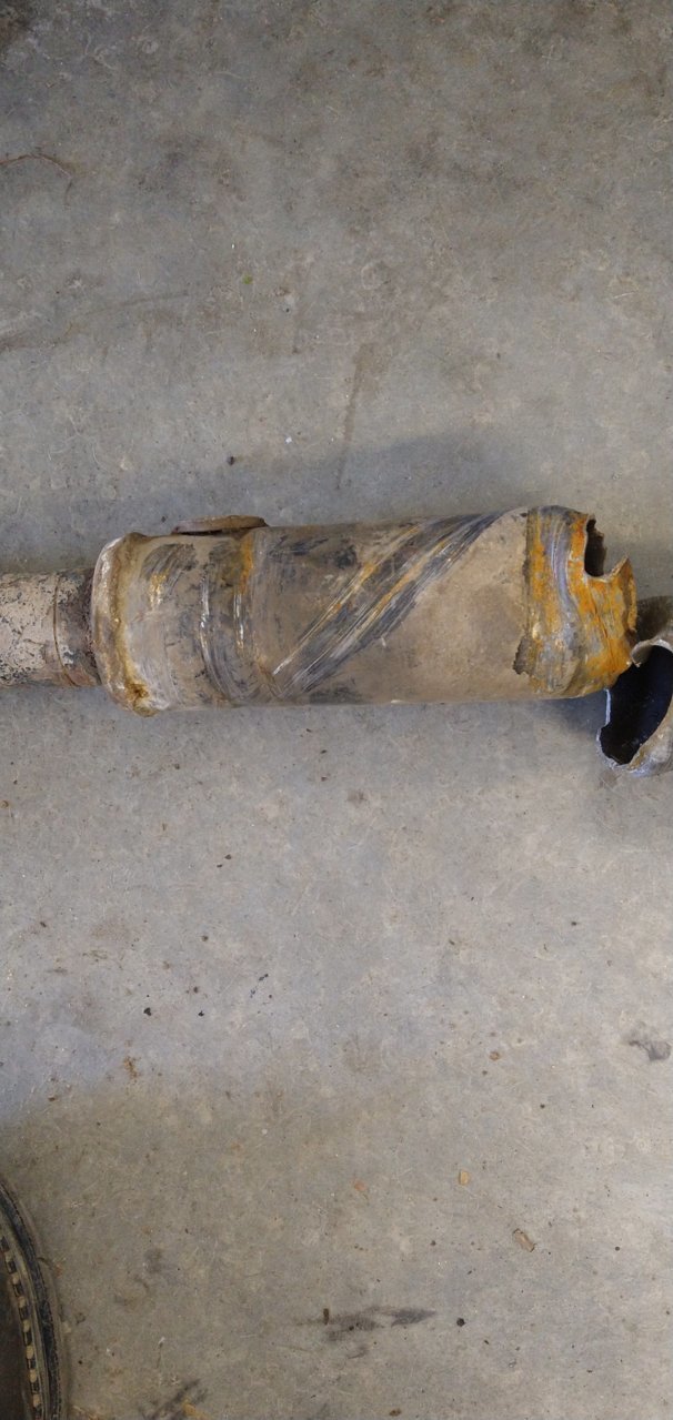

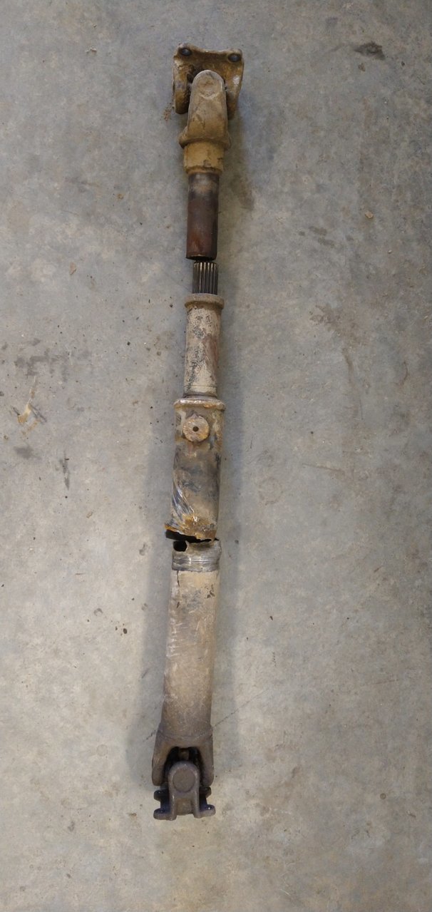

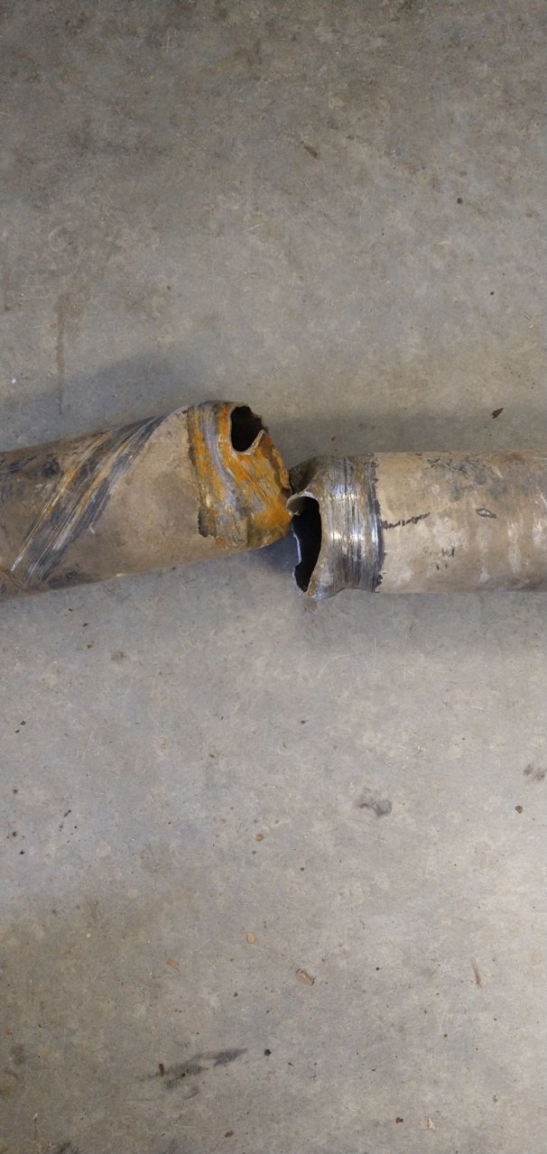

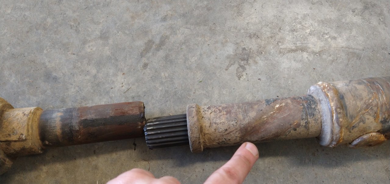

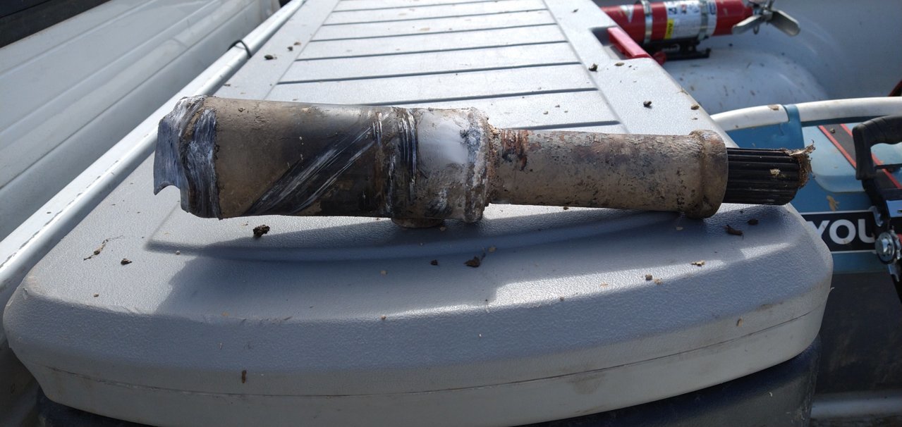

    Took the tests of the broken parts off this truck and hosed all the road salt off. May have found a contributing factor to the driveshaft failure. That stupid ass spine/dust shield got me again!
    That shield dented and would not allow the shaft to compress, that happened on my rear axle as well a few years ago. I recommend cutting that off if you wheel!
    Rest of the pics:
    Heh!!
    Going to drop the parts off at a local place tomorrow and see if they can build me a shaft so I can at least wheel at AOP at the end of the month. The rest of my battery relocation parts come tomorrow as well.

    Interesting. So was your axle binging during travel since the splines weren't able to plunge?
  10. Mar 13, 2022 at 2:59 PM
    #1250
    slander
    slander [OP] Honorary Crawl Boi
    May 10, 2013
    #103909
    8,964
    Hickory, NC
    02 Tacoma, fixed with curse words.
    I was trying to bump up a ledge while putting my driver's side tire up on a rock, I slid off and BOOM. No idea if it was binding or not. I also could have prevent that shield from being damaged (don't know if that had a factor in anything) if I turned the driveshaft around and had the splined end on the tcase side.

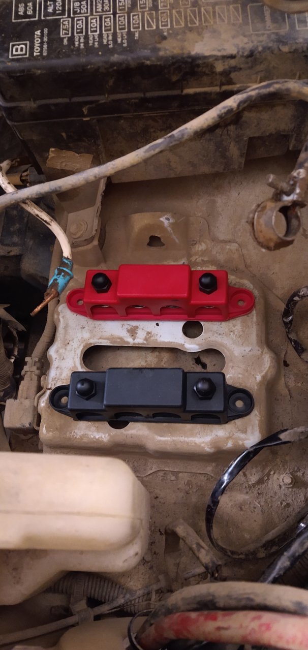

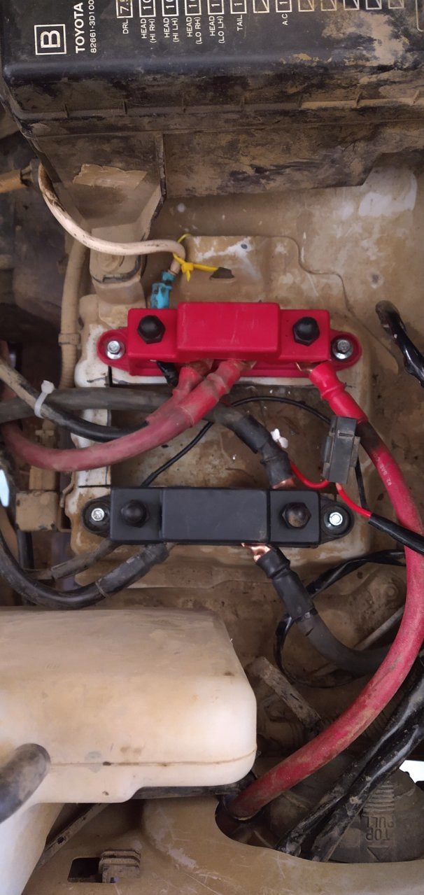

    In the middle of relocating my battery, any recommendations on where else to put my bus bars?
    malburg114 and Dalandser like this.
  12. Mar 20, 2022 at 7:27 PM
    #1252
    malburg114
    malburg114 Well-Known Member
    Dec 26, 2012
    #93766
    3,820
    Las Vegas, NV
    2001 Toyota Tacoma TRD
    I put mine near the fuse block so I didn’t have to lengthen any the stock stuff

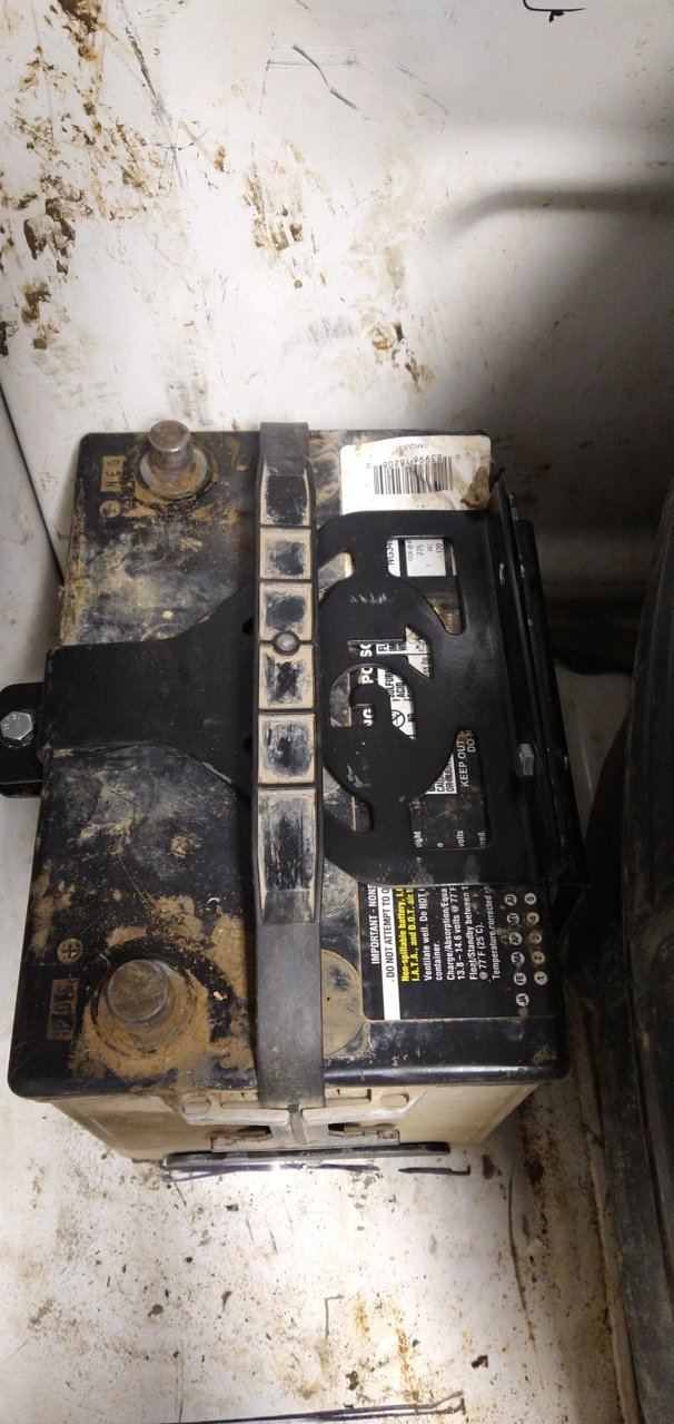

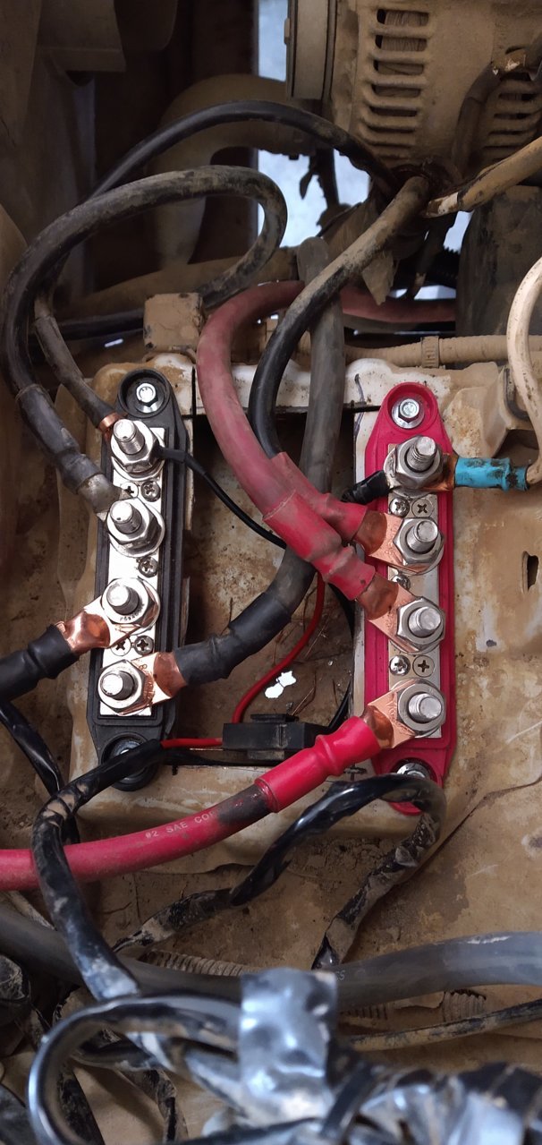

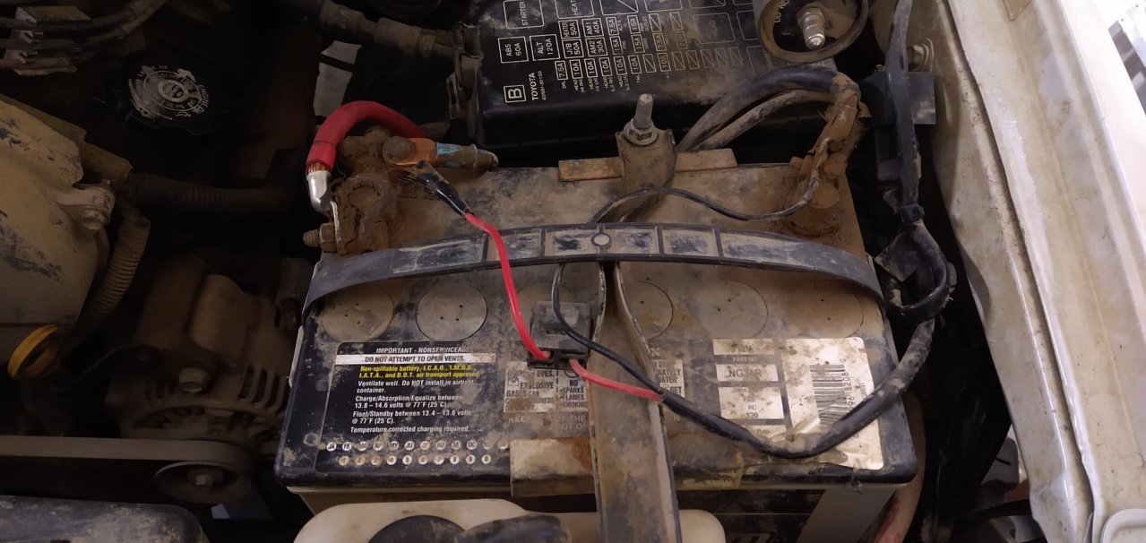

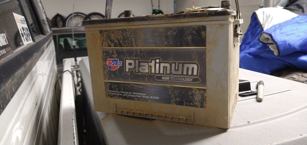

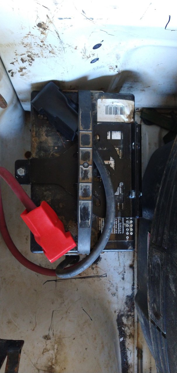

    So I started my project to move my battery to the bed, who would have thought if you cut 75% of your inner fender out it starts collapsing under the weight of the battery... So trail gear continues to suck, I'm pretty sure they could fuck up getting out of a paper bag with it ripped half open. So the battery box I got from them, the bolt heads cause the battery not to sit down in the holder, so I'm probably going to grind the heads down. So far the only product of theirs that I actually have liked are the wiper seals for SFA, those are badass!! As shown above I'm dropping the bus bars into the spot where the battery once lived. I stopped tonight when I didn't have the right tool to cut the 1/0 cable, but all I have to do is make my cables and run them and I am ready to start trouble shooting electrical issues that I will have inevitably caused by doing this!!
    What I started with:
    Battery in it's new home
    Behold the Chad of batteries. I have beat the fuck out of this battery, including draining to dead and bringing it back to life with a jump from my Avalon and a trickle charger and it keeps on going...

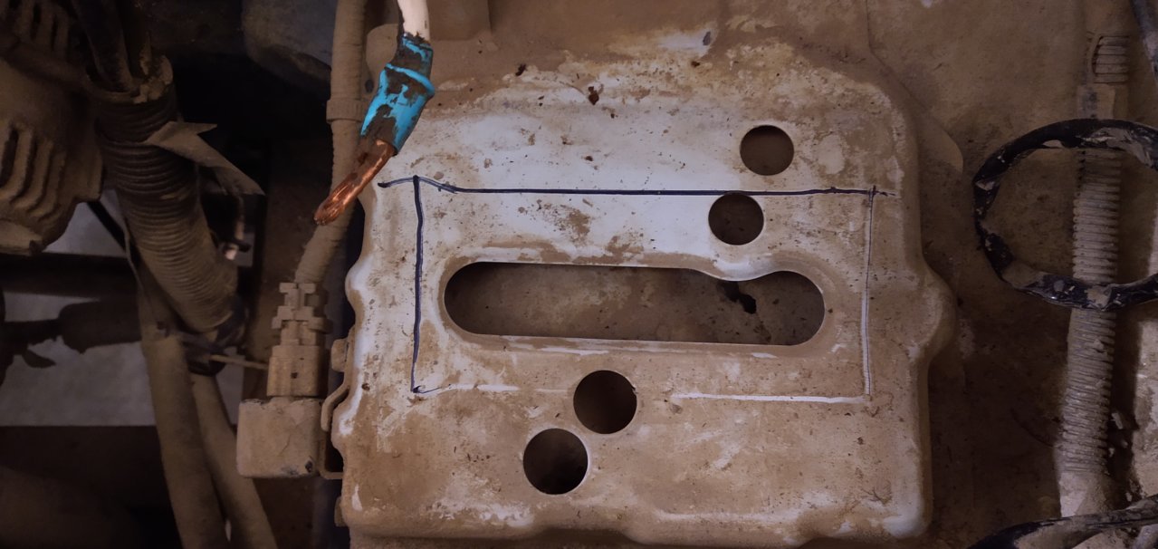

    It wouldn't be a project if I didn't have to get the grinder out. I had to cut the middle out of the tray so I could bolt the bus bars down.
    This is basically where I left off, waiting on a cable cutter, some more ring terminals and another battery terminal because the one that was already in the truck cracked.

    Trucks back in action today and ready for AOP on Wednesday!

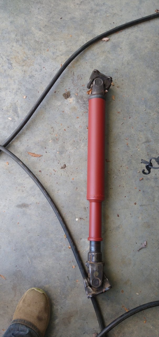

    Fixed driveshaft
    Done with the battery relocation. Overall it's an easy job, just time consuming and running those cables kind of sucks and takes forever.
    Wireing shit show:
    All systems work!

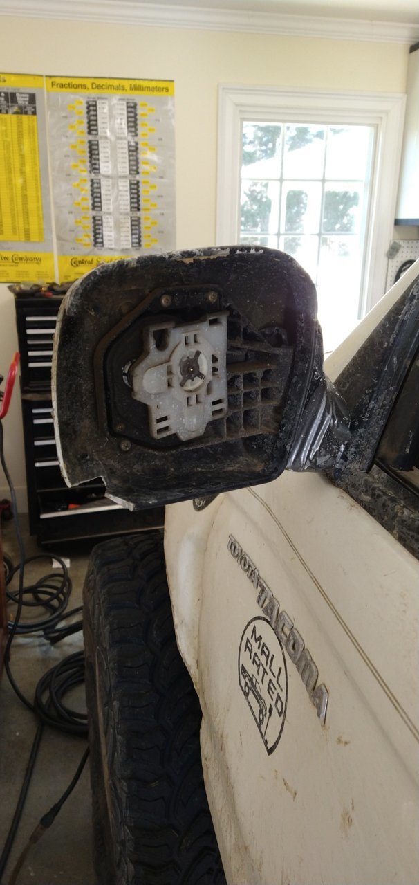

    I also swapped out the mirror that I broke.

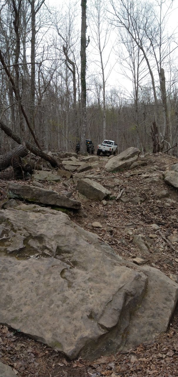

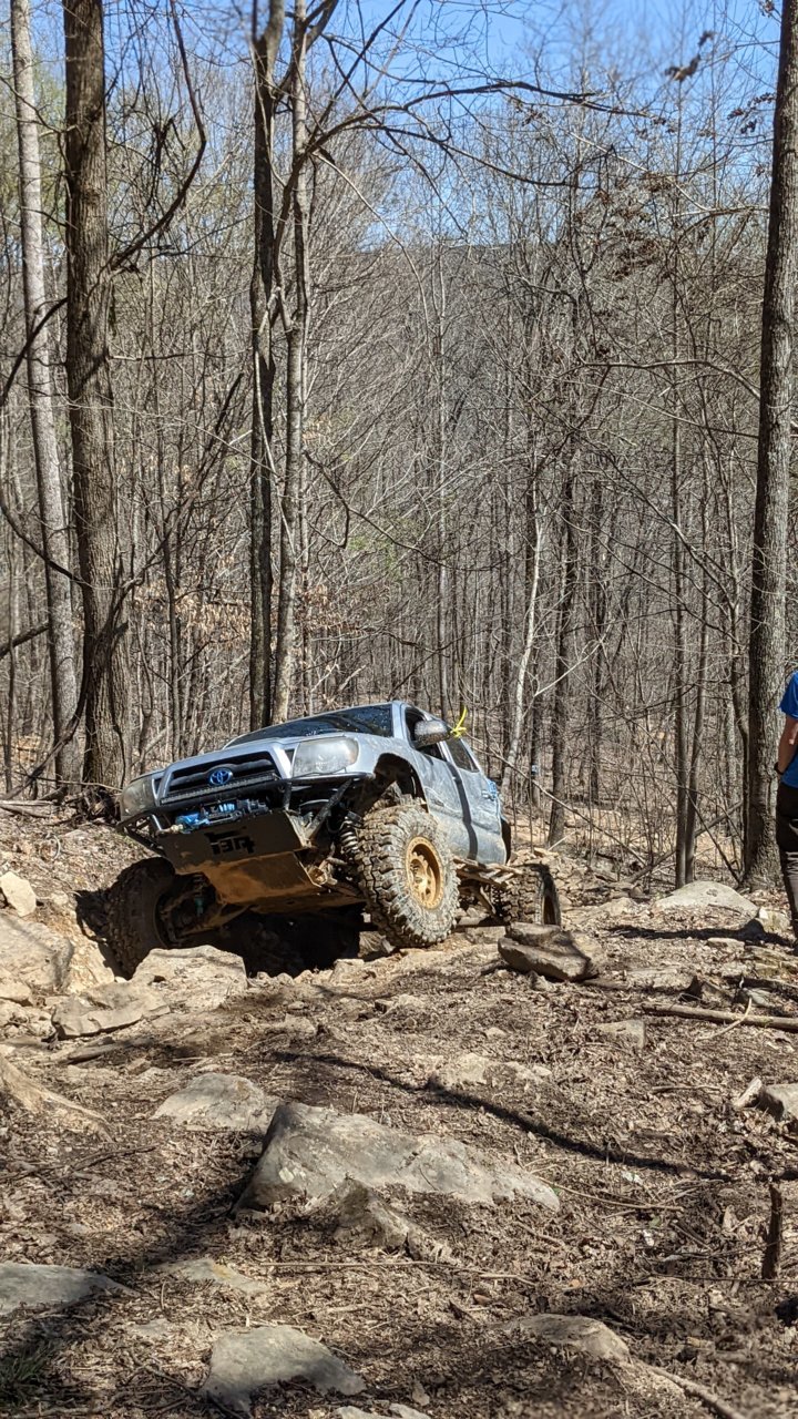

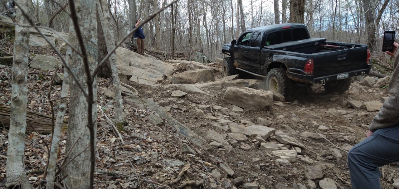

    Went wheeling at Adventure Offroad Park in TN for 4days with the TN TW crew. No issues with my truck, which was good because it was starting to piss me off breaking evreytime I went out. Pretty much everyone else broke something. Onto the pics:

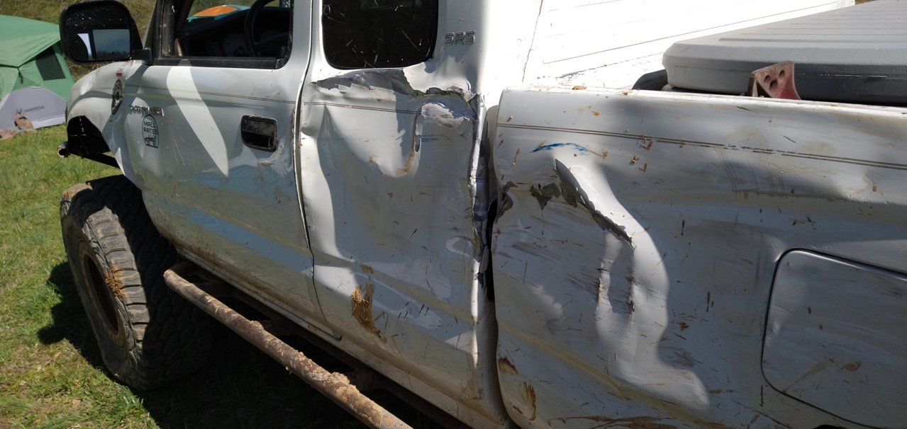

    No idea how I didn't smash my window out on this tree

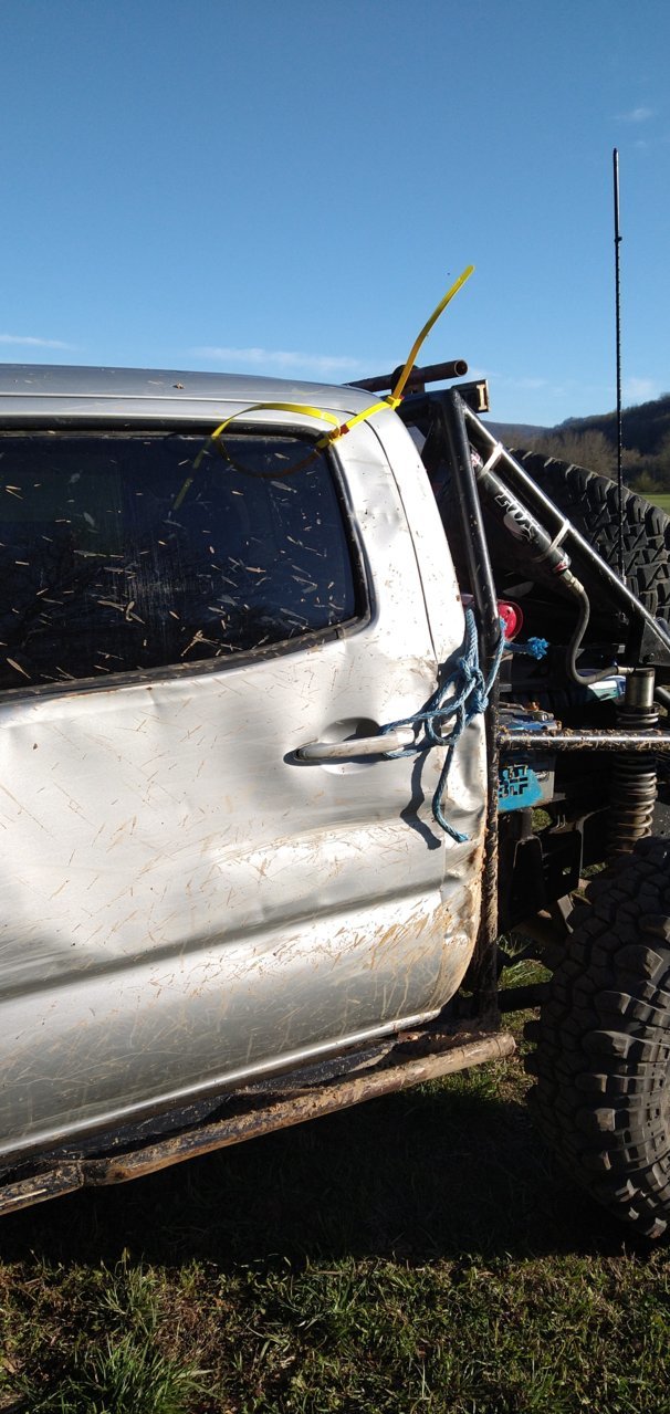

    A sign off a good day of wheeling when you need to hold your door closed with the winch line that you had to cut off because your winch got stuck under tension while winching yourself off a tree:
    Good times as always with this group!
