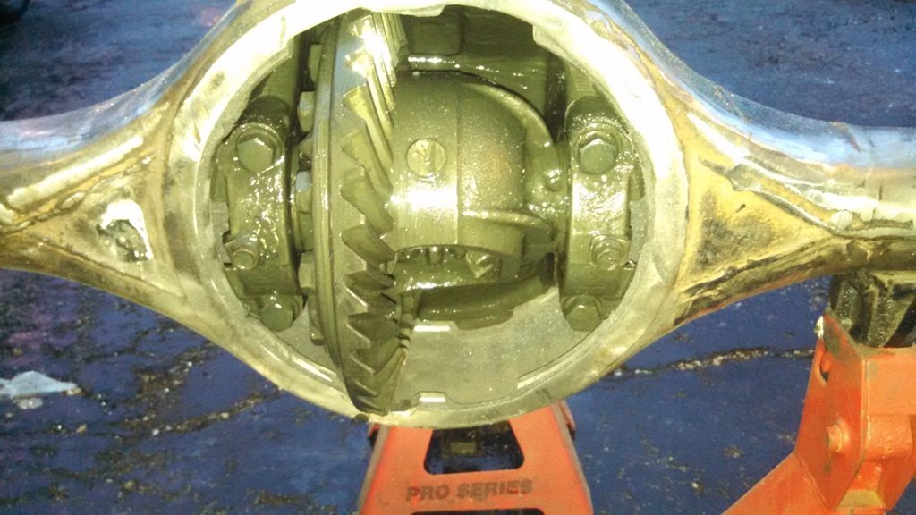

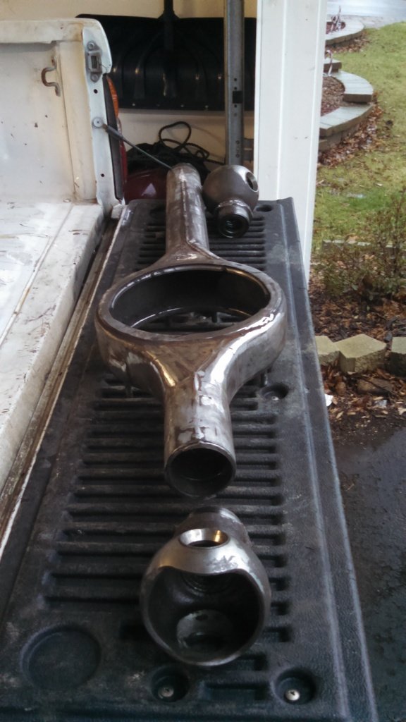

    Finally finished grinding on this axle today, now its time to start putting stuff back together.
    Holes ground for the ring gear:
    Getting close. All i need is the steering shaft figured out, a knuckle rebuild kit, steering hoses, steel for the new front frame, and a custom pitman arm made and its ready to be swapped so i can get measurements for ZUK to build my steering arm.
