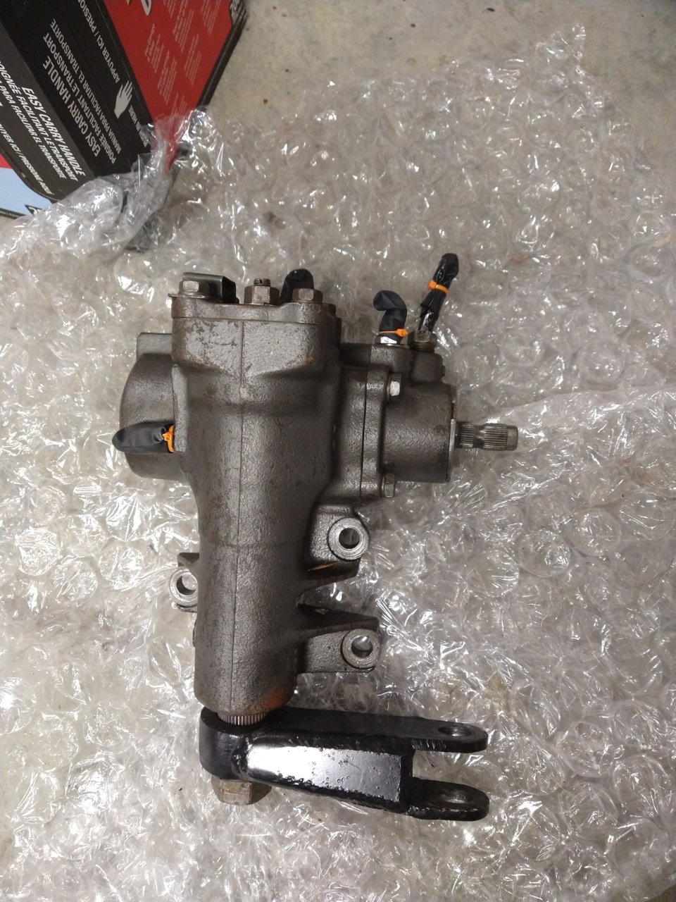

    I have been hardcore web wheeling for the past week distracting myself while some family has been in town and staying at my house. So below is going to be some random notes about a possible front end rebuild this winter and a way to catalogue my thoughts. I need to get more uptravel, get the truck riding nicer on the street, some better on trail steering, and right some wrongs I made when I did the SAS.
    Hydro assist with a double ended ram tech: https://irate4x4.com/threads/double-ended-ram-hydro-assist.395668/
    If I push the front axle forward 4" I gain 2" of uptravel on my current springs. I also need to explore ditching the fj rear springs and tossing something a little easier to find on here. I'm eyeing up some yj leafs. I'm also looking at moving rh front shock mounts and going from having the lower mount on top of the axle to behind and get the shocks working some more and doing its job, this will also give me a nice spot to land the airbump, right onto the knuckle gussets.
    I also would like to ditch this stupid Ford forward swing box and go with either a Toyota IFS box or a heep rear swing box, whatever I fall into. In the interim get a "radiator" style power steering cooler and ditch the heat sink style I have now and see if that cools the truck down at all.

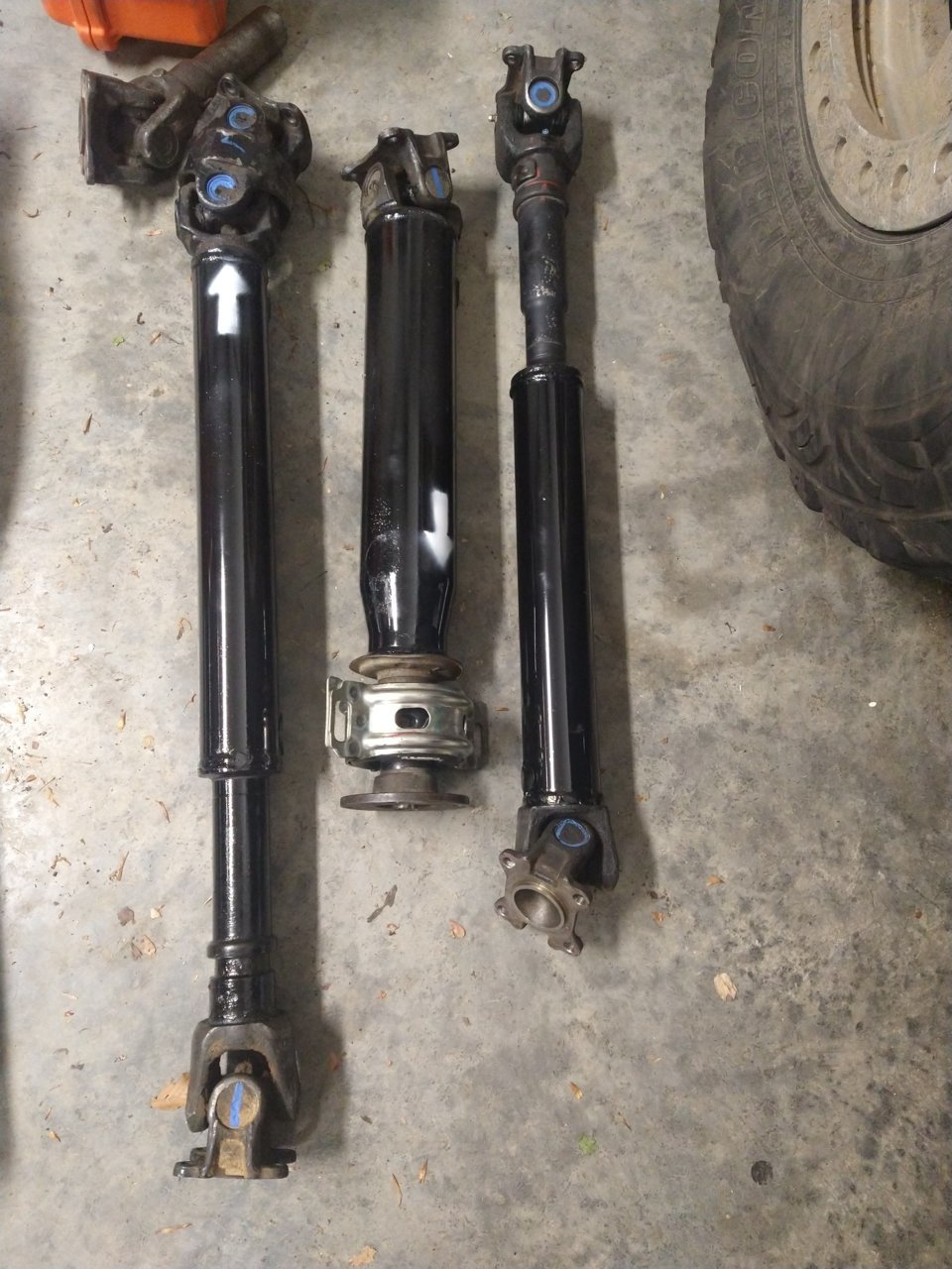

    New driveshaft day.

    Driveshafts are smooth up to 80 which is awesome, can't wait to bang them off some rocks in a week. It will be a long got week in the garage knocking out a bunch of punch list items I have been kicking down the road. Why wrench when it's in the mid 70s during the day and low 60s at night like it was a month ago, when you can do it in 90* in 90%+ humidity instead??

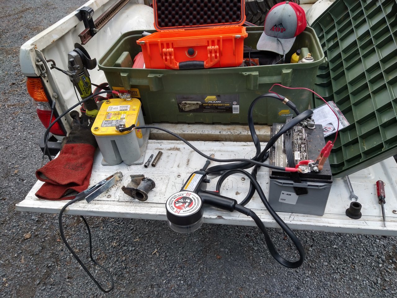

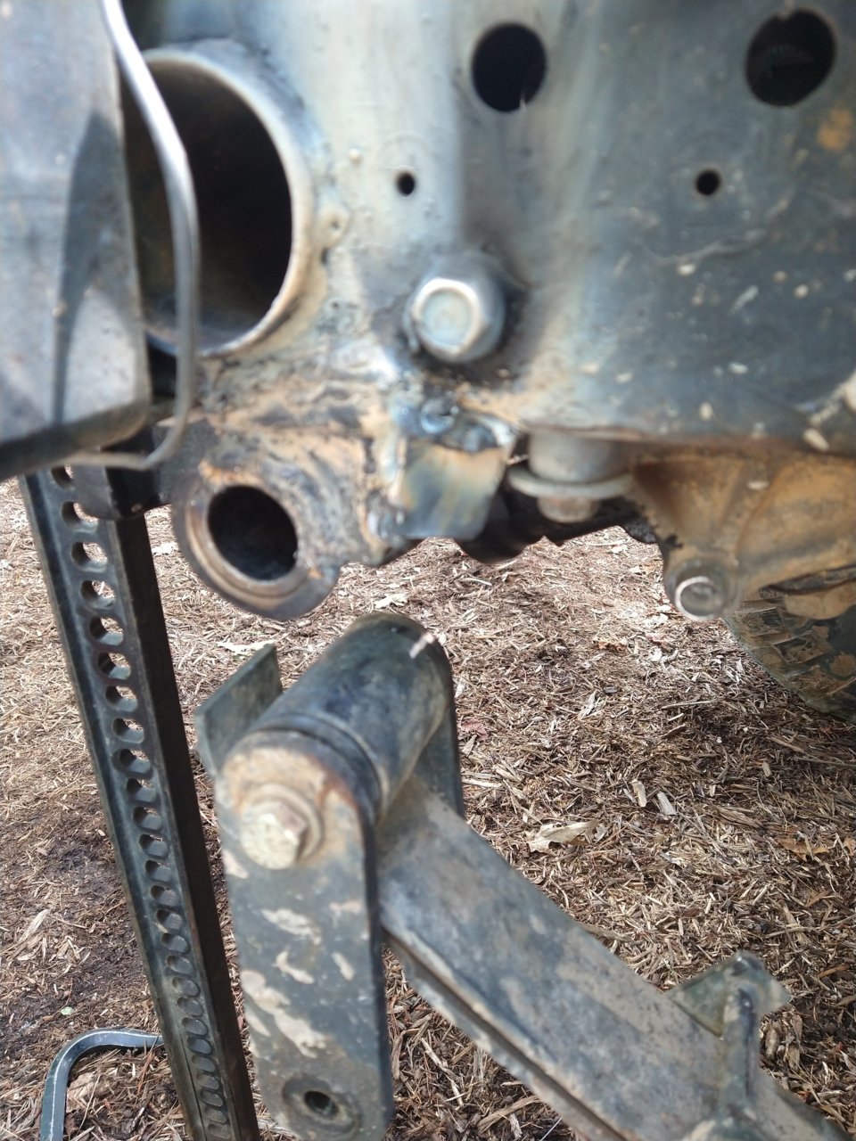

    I got back from wheeling in WV, of course almost zero pics. Truck did fine, pretty uneventful trip for me. A yj in the club tore a front shackle mount off, so new battery and Bunn trail welder to the rescue! He would have been screwed if I didn't have the welder with me as he flat towed it there.

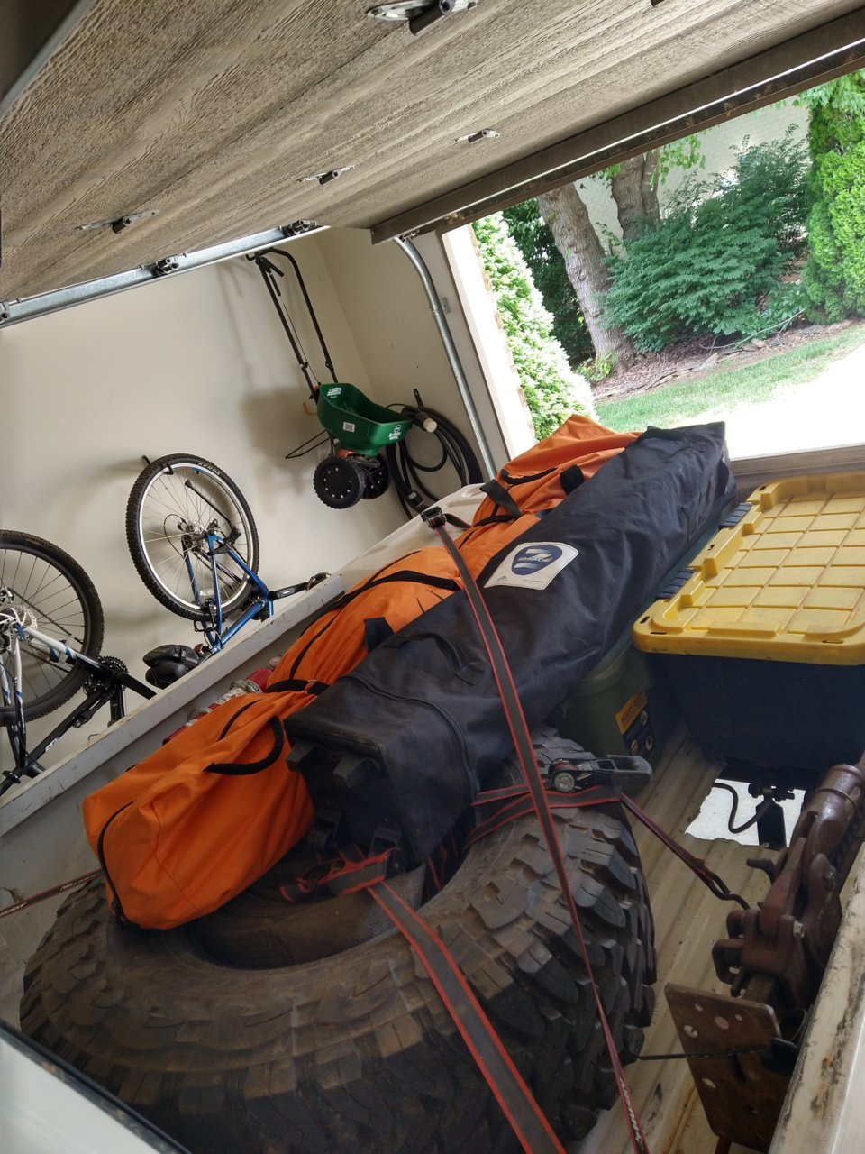

    I'm really getting the bed storage dialed in, which is awesome. It was a disorganized shit show, not bad now.
