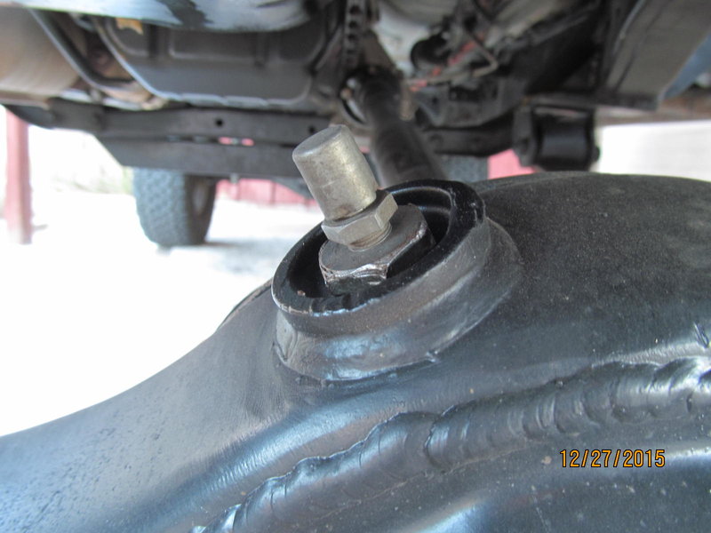

    I have not taken a picture of it yet but you probably noticed that the hole that used to be for the breather will get filled in with the MIG welder since it's on the bottom side now. So I used my new fill port on the top of the housing as my breather location....see below. It was easy to tap it for 1/8" NPT even if it was the Japanese near equiv of the American tap it still seals just fine. NON-magnetic plugs tap much nicer!! :)

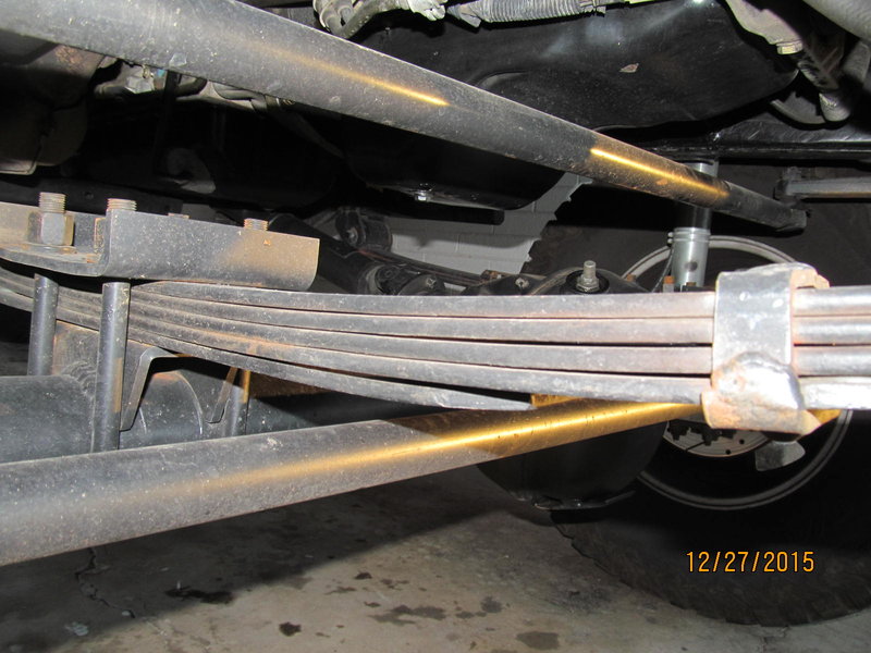

    I just need to know how close your tie-rod(cross-rod) is to the bottom of the leafpack....As shown in the pic below, I'm about 1 inch away from the bottom leaf ....The closer it is the more the castor.....hmmm, interesting way to set the final castor.
    Now, I will do a much better job of setting your upper arm such that you don't have a full 3 inches of clearance with the top leaf like mine is. Mine is too high.....wasting draglink clearance to the frame. That will change in the near future though.

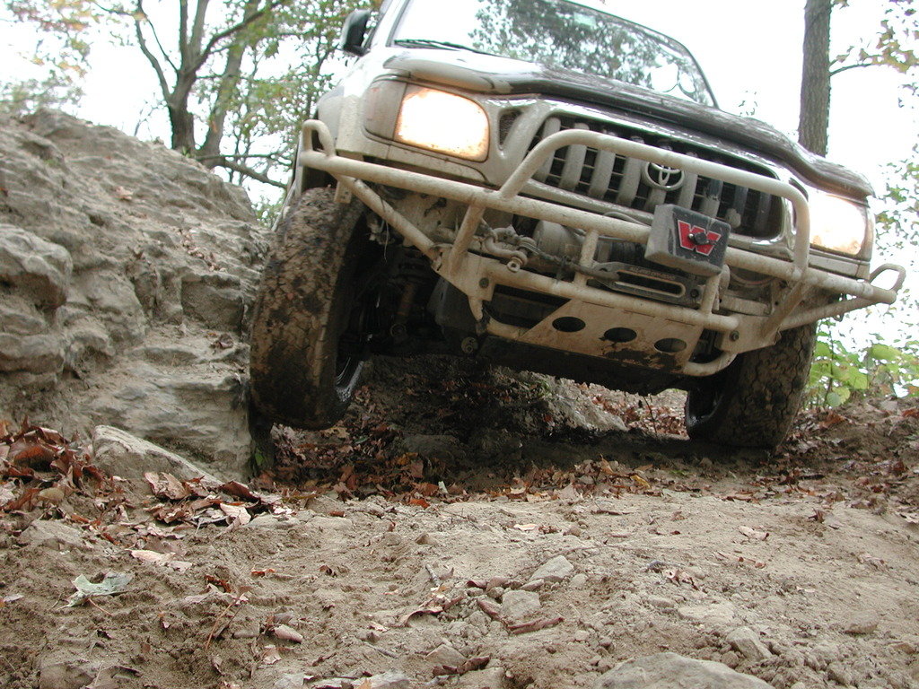

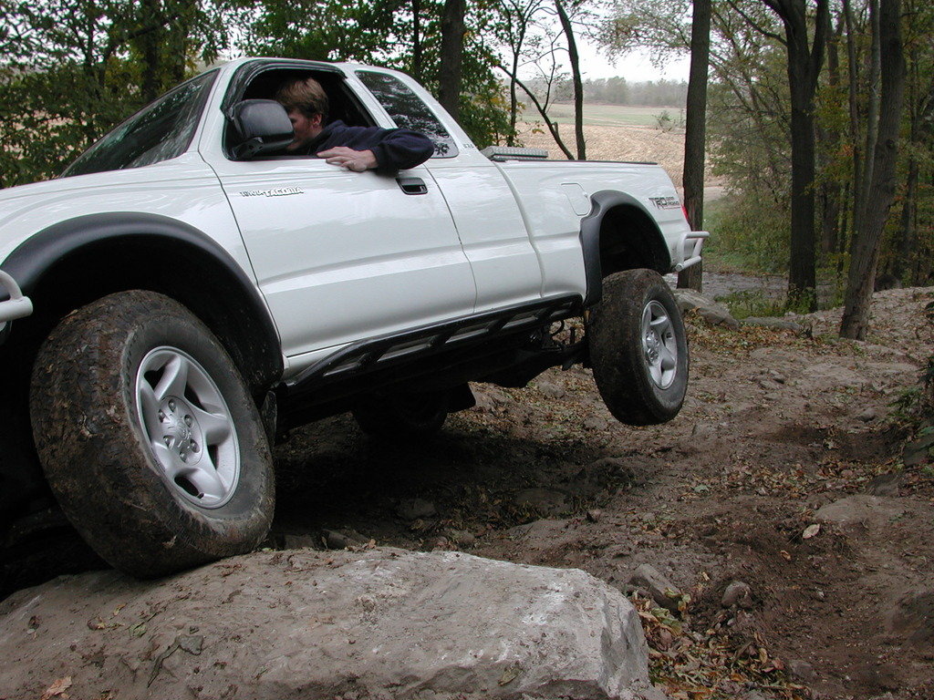

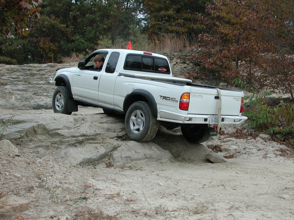

    Was going through pictures and found some wheeling pics from when i first got the truck, my how things have changed LOL!!
    Holy shit non rusty sliders!!!

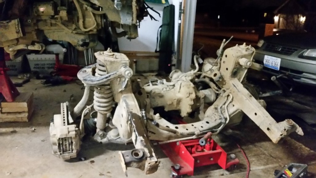

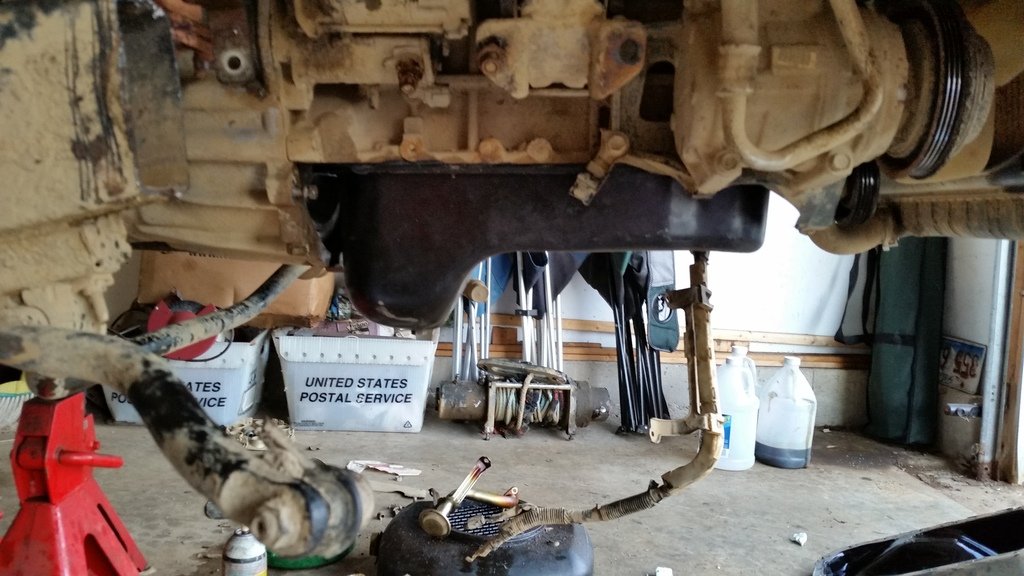

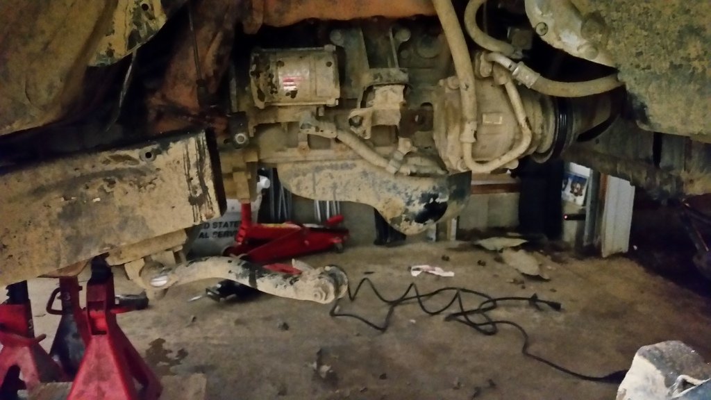

    20160228_1951511_zps9zzcpkb5_21031d8a79c29cab9f9b1e89b1232b021bdb86e0.jpg 20160228_1951431_zpsatokaytf_a21b3e9a450763c71d7d2fa6ce63c88138890586.jpg
    Some observations: Its amazing the condition of the motor mounts after 8+yrs of wheeling with a crawler. The rubbers still great and the metal around the mounts look great! The frame snip is a bit more labor intensive than i thought, the motor mount bolts are a BITCH to get to. There is also a lot of little crap bolted to the frame. Another tip is to disconnect the steering shaft before cutting, i thought the shaft would just pull out of the rack when the frame dropped with the shaft clamp undone, wrong. The frame got hung up by that and kicked back into the jack stand holding the engine and trans up, WHOOPS. I had to cut the shaft in half with a grinder and it all came free after that. took about 3 hrs to disconnect and drop everything working by myself and taking my time.

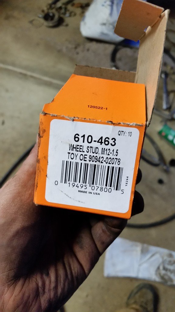

    I also got some extended studs since im going with IFS hubs, taco rotors and trail ready beadlock wheels which are thick. Here is the Dorman part number of the extended studs, i snagged them off Amazon, i think they are off a matrix or something.
