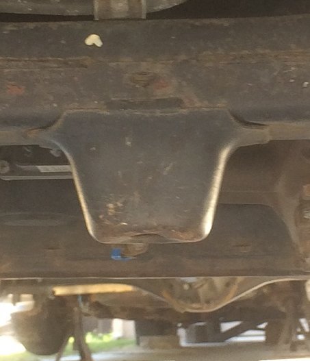

    Anyone concerned about potential damage from off-road? Or y'all think she's pretty hidden up behind that cross member.

    I was concerned about damaging the drain valve as well when wheeling. Over 2yrs with it on and no problems so far. Did an oil change yesterday and besides road kick up on valve, doesn't look like anything has made contact with it. That cross member seems to shelter the valve pretty decent.

    Yes. A front cross-member has a thingy welded on that provides most of the protection. But, there is about a one-inch gap that could take out the valve. So, the solution is to avoid driving over things down the middle. Driving backwards, you're okay because a rear cross-member right behind the valve extends about a half inch below the valve. I have a 4X4 DCLB; the cross-member setup could be different for other configurations.
    That thingy has a hole in the middle. One could weld or bolt something to it so it hits before the valve.

    I was wrong. The thingy protrudes below the valve line. I measured them: valve is 8 1/2 inches from gound; thingy is 7 5/8 inches. In the pic below the valve is visible because of the angle I used to take the pic. The thingy is a foot in front of the valve; so, I think it's still a good ideal to avoid things down the middle in event you hit a dip.
