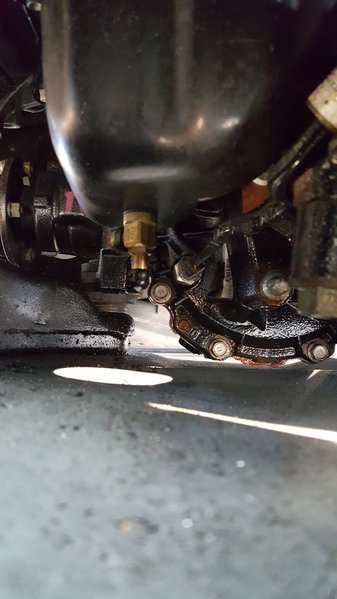

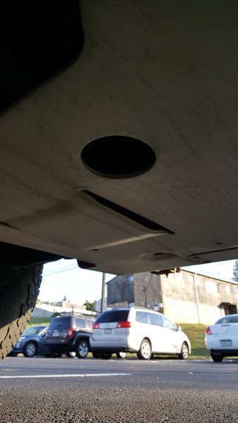

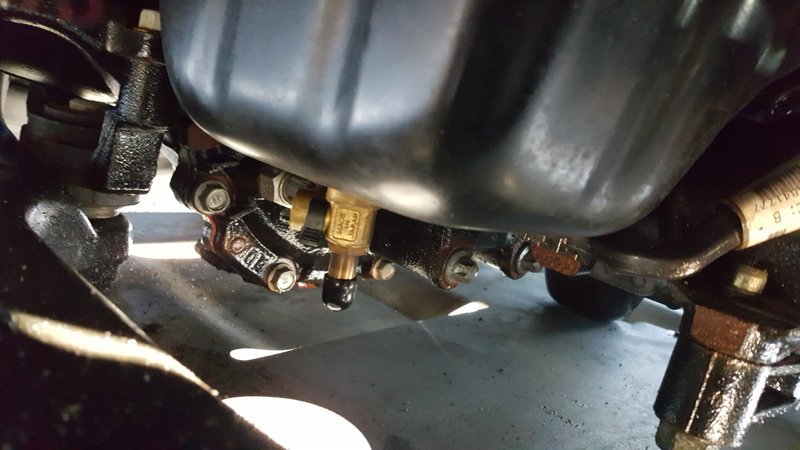

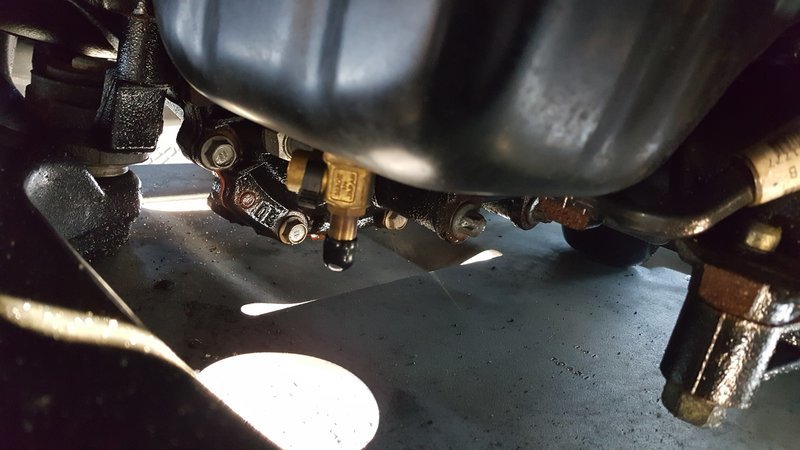

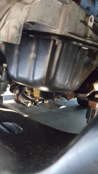

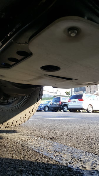

    Just got home and got you some pics! Hope these will help and are what your lookimg for. If you need anything else let me know! @anitasanger
    From underneath:
    These are taken on top of the cross member:
    This is taken from the passenger side of the trd skid on the edge:
    Monte24, bowhun2r and SilverII like this.

    Wow man those are so perfect! Thank you very much, shows me all I needed to know. I'll be ordering one tonight! Thanks for the help, you're awesome!
