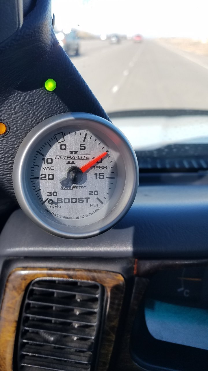

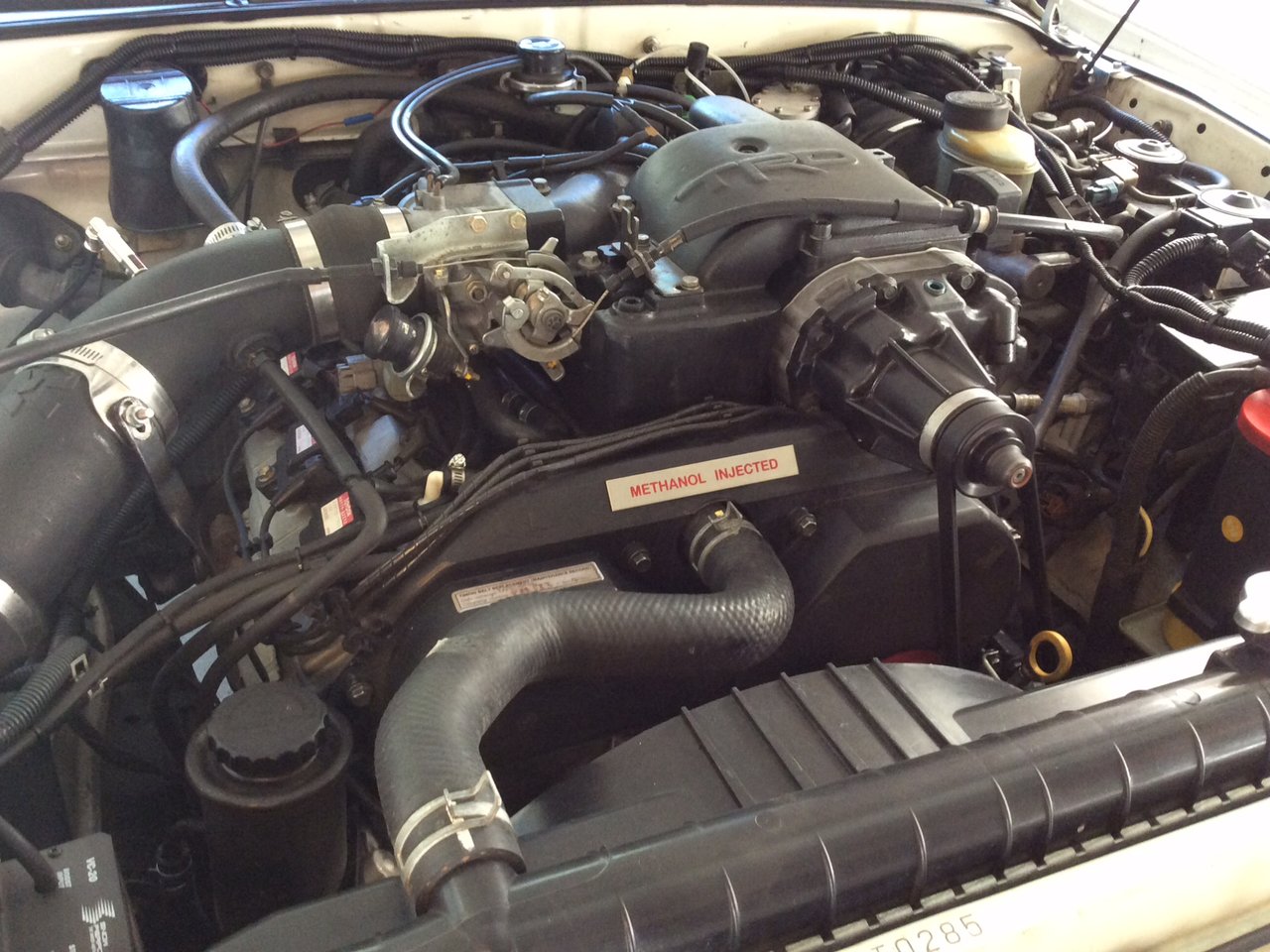

    V6 5sp,RegCab,TVS1320 Supercharger, 56mm pulley, methanol injected Haltech ECU, AC Tvs1320 supercharger,(MUST DO) every 125,000- 150,000 needs rebuild Projector headlights HID 5 speed manual Amsoil for all drive train Smaller 56mm custom pulley, (MUST DO) 2004 DESNO fuel injectors, zero ping ping, 2004 side door mirrors Dick Cepek Rims, Michelin tires LTX, ATM Pathfinders Dynopro ATM ( that last 100,000 miles) Now running Dynopro ATM mud and snow tires KN cold air intake Cat back dual exhaust with ss exhaust tip, Raised exhaust tail pipe to 2" below body line Optima*dry cell battery,red top Alpine sirius radio, 200 watt amp, focal is165 split door pod speakers Focal door speakers Subwoffer behind seat Viper alarm, Electric Locks Dark tinted windows, bucket seats corbeau lg1 Tacoma Rubber floor mats TRD fender extenders, Bilstien shocks, King shocks JBA UCA trailer iv hitch, electric brake control, Drilled slotted brakes, High carbon steel (MUST DO) EBS green stuff 7000 series pads(MUST DO) TRD engine oil cap TRD stick shift, Marlin crawl shift kit. Rear sliding window 2002 4Runner functional hood scoop cut into Tacoma hood, 4Runner dual overhead map light Gentex Auto dim + Compass + Temp, garage,rearview mirror Snow Methonal kit stage 2 Custom 3 core aluminum radiator Linex bed liner Haltech stand alone ECU, Intake supercharger gauge. Stainless steel brake lines, Custom leather wrapped steering wheel, Haltech stand-alone ECU,
    A functional hood like mine definitely makes a big difference if you're running a supercharger, the supercharger creates 10° of heat for every one pound of boost so I'm putting 10 pounds of boost down which adds temperature 100° More, so I'm happy to have a functioning hood scoop and methonal to get rid of those added temps
    The scoop lines up directly infront of the supercharger
    volte and ChadsPride like this.

    I have a boost guage that shows actual 10 pounds of boost but remember I am 6000 feet.
    Also had a dyno chat done for it with the larger pulley at 9.25 pounds. The 2" pulley pushes 10 pounds
    at 6000 feet. If I was at sea level numbers would be different.
    That figure is all depending on what size pulley you put on
    ChadsPride likes this.

    I take it you don't have a supercharger and are not aware of the added heat it makes.
    Did not use any technical stuff, don't need to, but if you have a supercharger you are well aware of all the added heat trapped under the hood because there is no intercooler for these 3.4 motors and if you have any experience in running 10 pounds of boost that adds 100 more degrees any added air coming in ontop
    of the supercharger from a scoop is a win win deal. I can run the supercharger super hard and can put my hand on the supercharger without it burning my hand, it's a combo of meth and the scoop, before I could not do this
