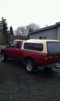

    You run a 30x9.5 r15 with the OME 881 and 5 leaf set up?
    Have any pics?
  13. Mar 19, 2014 at 5:32 AM
    40950
    40950 Well-Known Member
    Jul 29, 2010
    #40950
    1,787
    CR, WA
    1999 8 port 3RZ 4WD SR5
    stock
    I started looking around and I really don't have alot of pics of my truck. Builds or otherwise.
    It's easy. Envision your truck with a 2" and 30x9.50 BFG's with a old white HD Brahma canopy for a long bed toyota. lol. It's the best I can do. This is right after the 2" and tires, just picked up my canopy at my buddies place. Hounded him enough and he finally broke down and sold me that cap.
