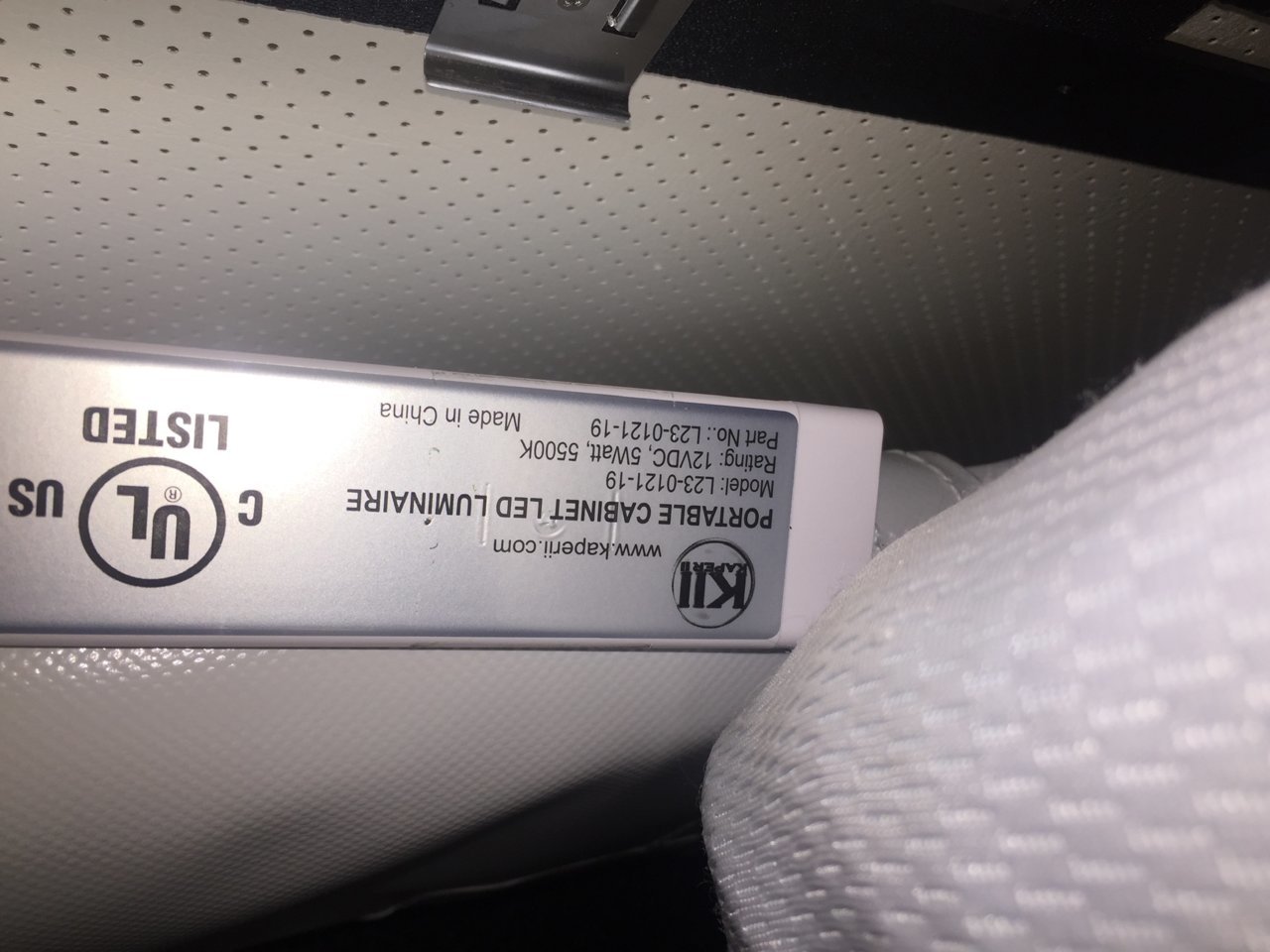

    Does anyone know which brand/make the interior led lights are?

    This is what mine came with.

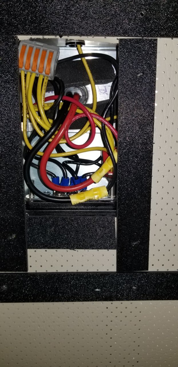

    Replacing the wire is on hold for now. Not sure why they used 14awg? Actually, not only is it limiting, it can be dangerous! I have sealed all the trim with sikaflex 221. No more water intrusion. However, still finding poor workmanship.

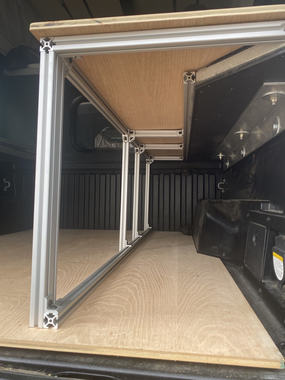

    Got the first part of the build done over the past few days! Need to apply a coating to the floor plywood, I'm going to let the countertop wear/patina naturally. The rivnuts and 8020 feels surprisingly skookum.

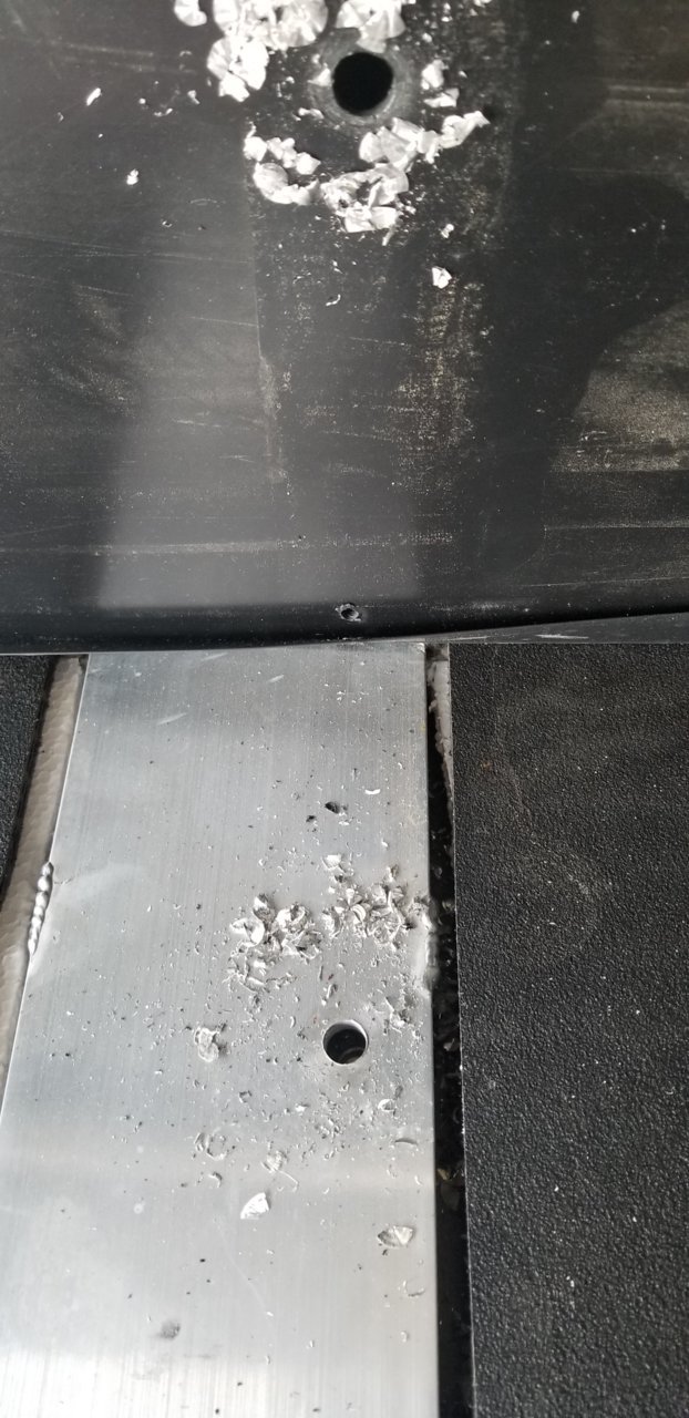

    I definitely expected the rails extending into the bed to not be 1", so that threw me for a loop trying to get good purchase with rivnuts on the aluminum but also keep it flush with the top of the surface. You can see in the second picture that the rivnuts are slightly low leaving a bit of a gap between the cross supports and the plywood.

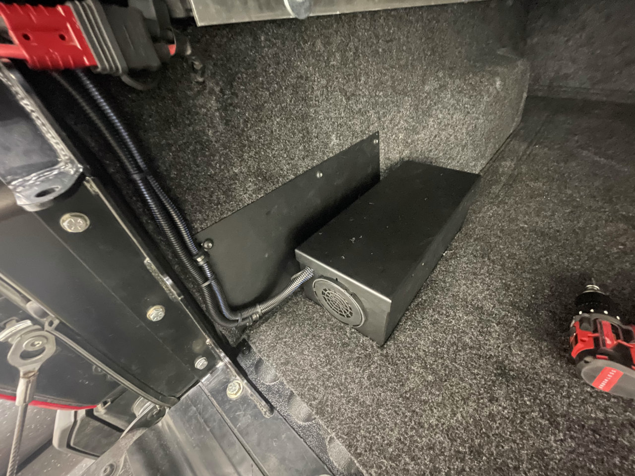

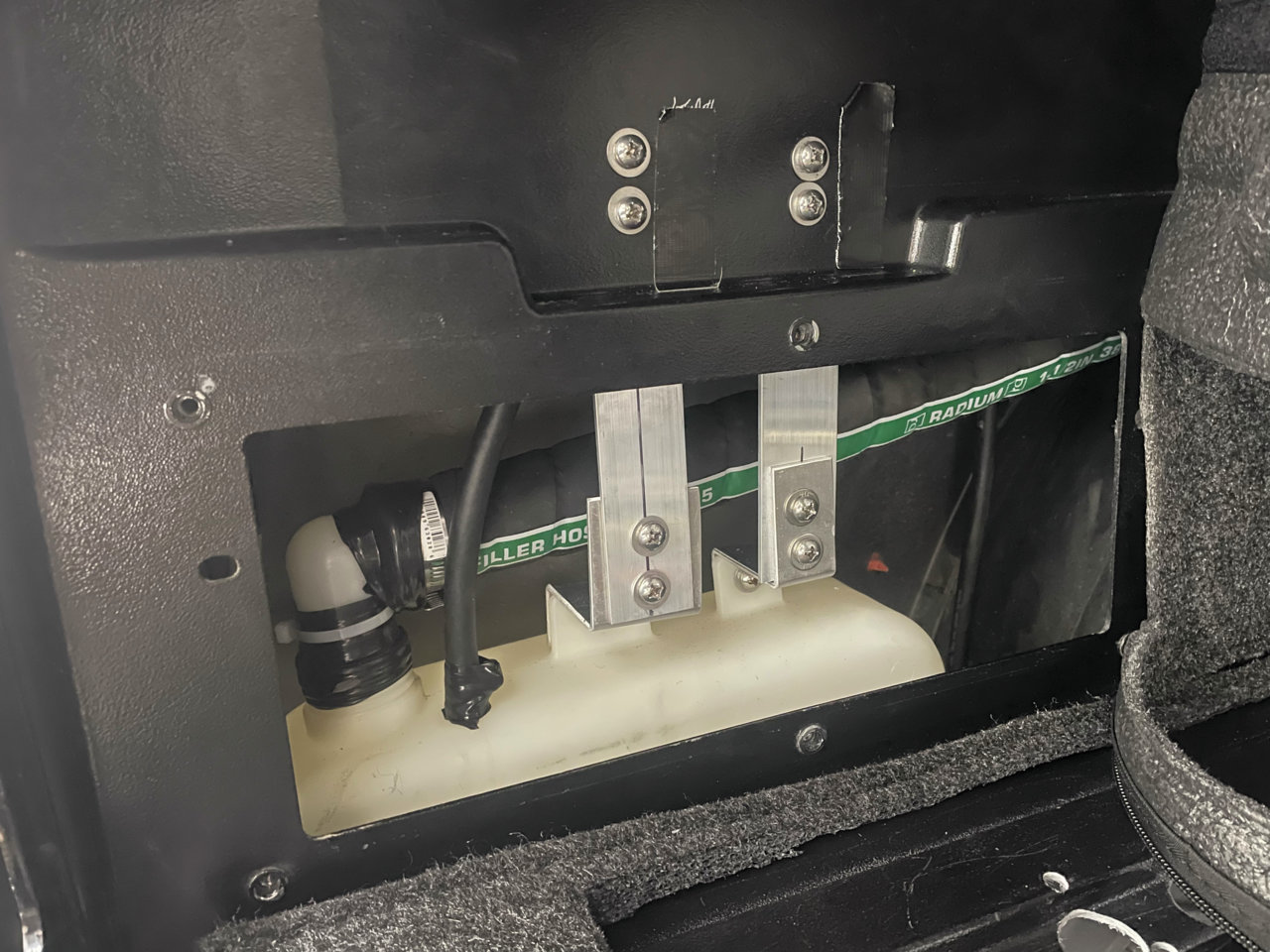

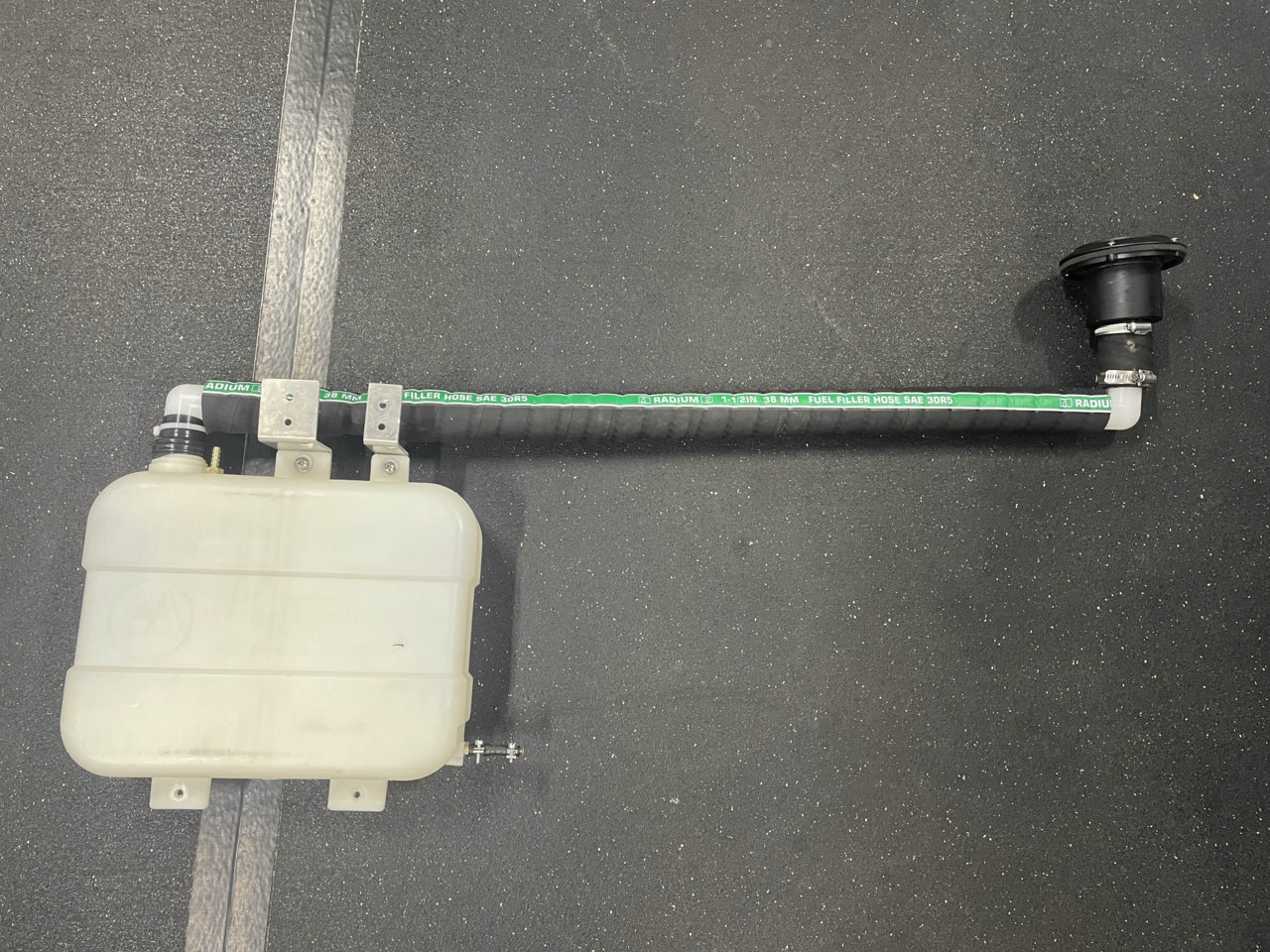

    Project M heater install. Used the new petrol fired B2SL heater w/ built in altitude controller and a 2.0 gal tank. Was able to tie it all in with the FWC battery box for a cleaner looking install. Had a local powder coat shop do the finish work on the mounting box and plate. Paired with the BedRug + the thermal pack we are sleeping comfortably in southcentral Alaska during this windy and cold winter season. OAT +3F with windchills well below zero and the camper will maintain 45-55 degrees all night. BedRug was a huge improvement for insulation. Running all night it sips fuel and maybe will burn 1/2-3/4 of a gallon, it's also very gentle on amp draw, usually pulling just over 1 amp but up to 8-9 amp during initial start and shutdown but only for a minute or so.
