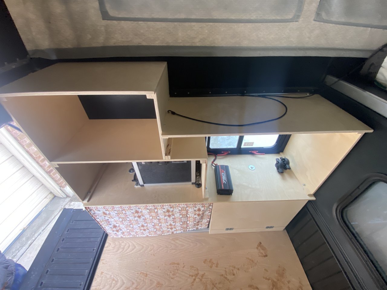

    4
    Attached:

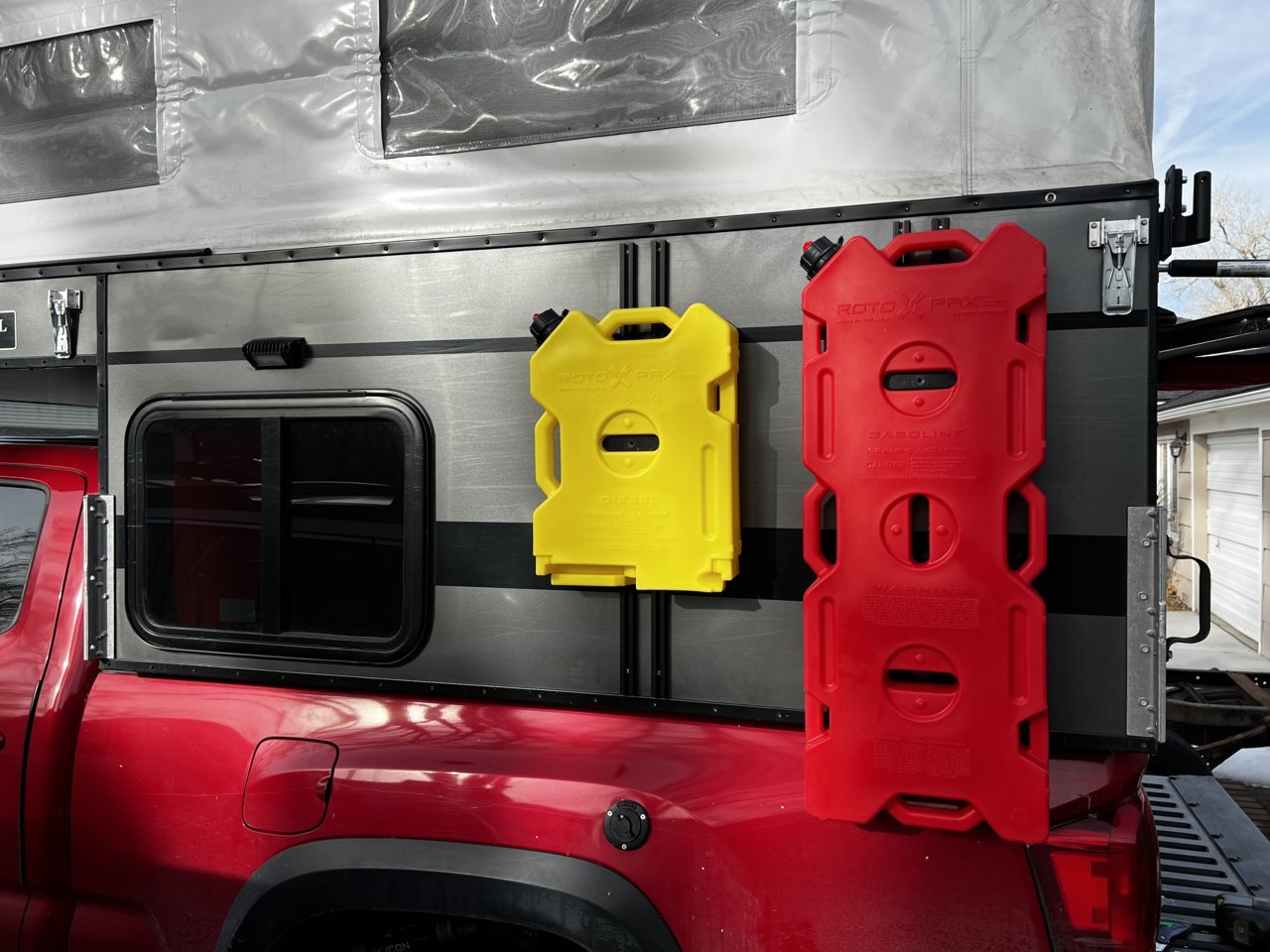

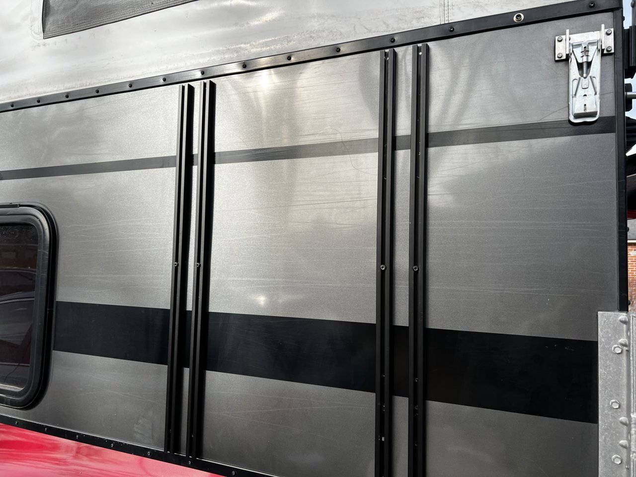

    A quick update. I installed 8020 half rails on the side of the camper to attach spare fuel tanks. I had been putting the fuelpax tank in the roof. The tank started to split. Rotopax warranted the tank and allowed me to upgrade to a Rotopax 2gal. I also got a 2gal tank for diesel to carry extra fuel for the heater. Having the tanks on the side will allow for burping the tank more frequently on hot days and not having to take the tank off the roof to do it.
    Turned out super clean. I used 1050 profile which is half of the normal 1” 8020 profile. 75BD7335-15D6-42EA-8EA9-7D5F9FC14C9B.jpg

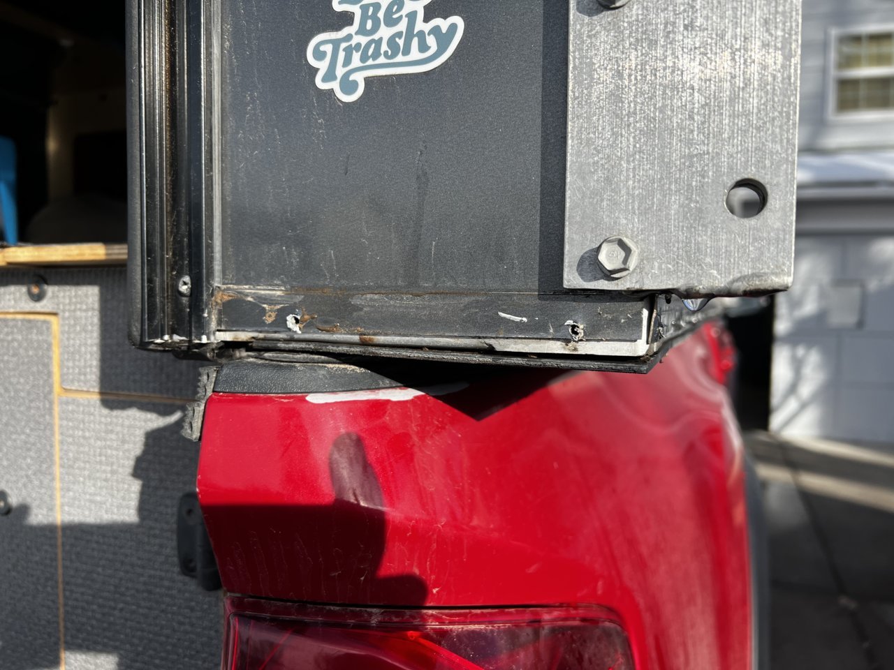

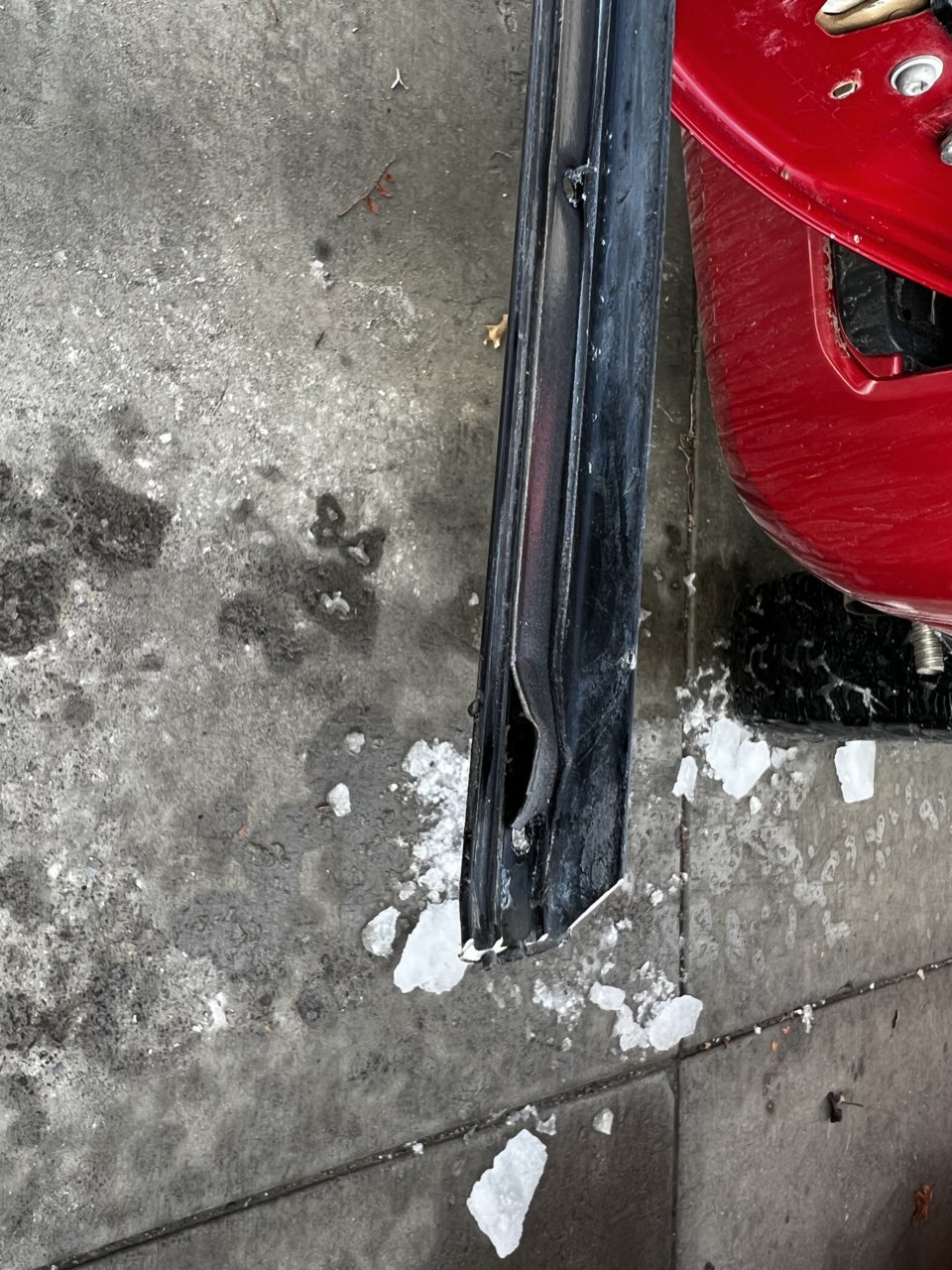

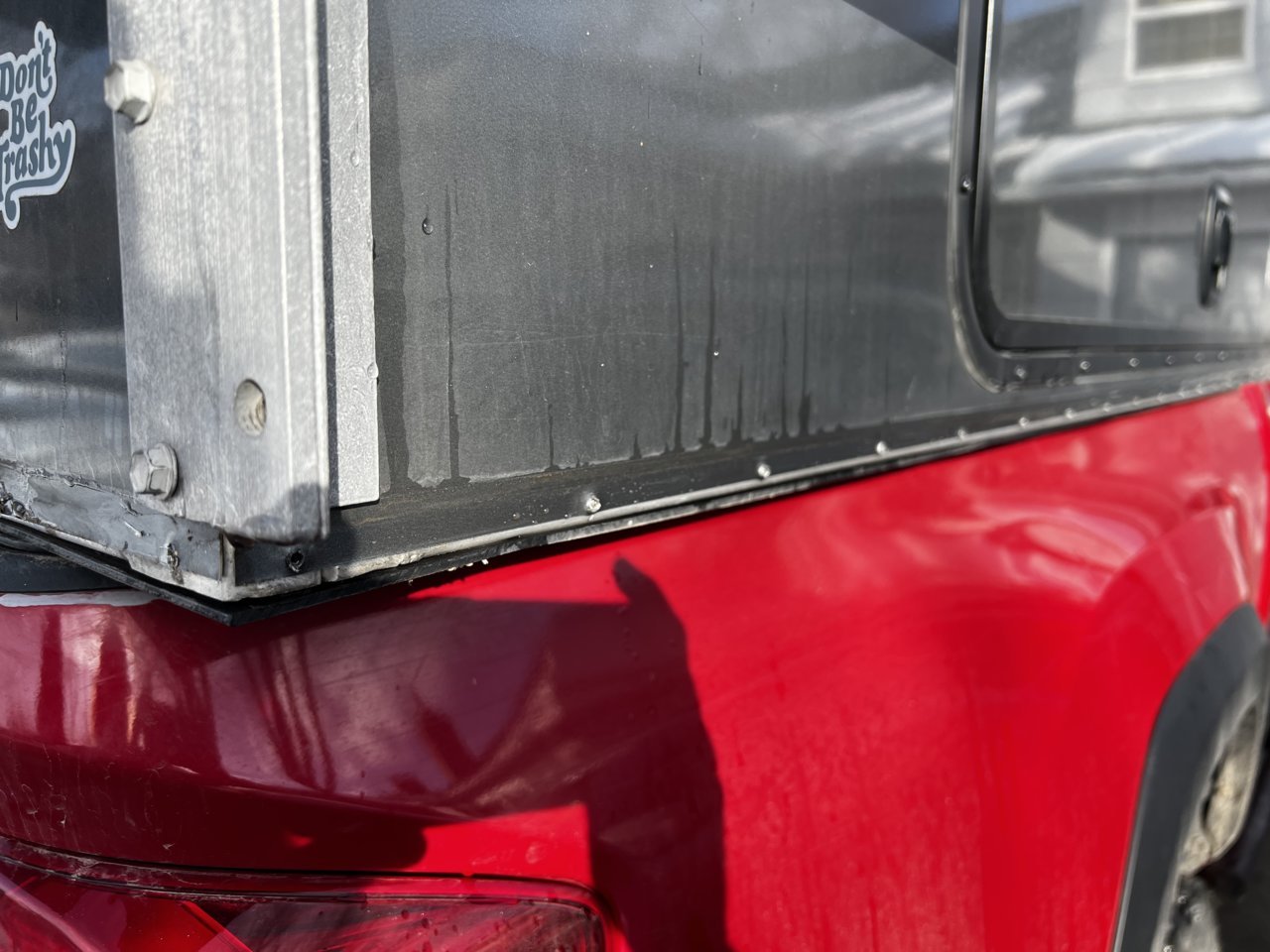

    Water leak update:
    I started getting leaking water in the back corners when it rained. Took some time to figure out but I eventually discovered the bottom black trim on the outside was no longer sealing right. FWC only used double stick tape to seal the trim and no caulk across the top. All the other trim pieces are caulked so not sure if they forgot. Water was getting in between the trim and side wall. It worked its way under the bottom plastic and got in between the bedrail and shell.
    I pulled off the side and back bottom trim, removed the tape and replaced with 1” butyl tape. I also added some black caulk to the back for a better seal. It no longer is leaking.
    5FA1FB4D-E8B8-488F-B022-97C5EBBBB9D0.jpg9DB01B9F-468F-4A30-AFC0-068C4BB5128D.jpg 412D3427-4B7B-47A2-9EA8-B65FC956AB34.jpg CC1BB611-CE56-4224-9317-33B4AC67FB17.jpg A40497E3-4E43-47FA-B617-2AE8BBCFE0E0.jpg

    My god! That's where the water is coming from! My corners also get wet when it rains. Same deal, no sealant. As soon as this bomb cyclone is done I know what I'm doing next.

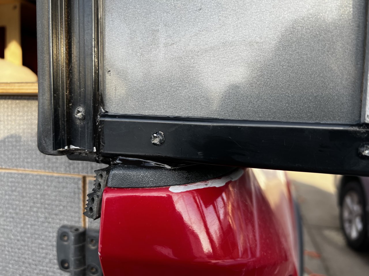

    After investigating the trim and corners of my own PM, it looks like I'm having two problems contributing to my leaks.
    The first one is the same problem as AGT. No sealant on the bottom trim. You can see the water lines going right into the trim piece. Funny thing about going to the Black Rock Desert is that it makes all my water leaks super visible!
    The other part of the problem appears to be due to the weatherstripping job. In the upper two corners closest to the truck cab there is a gap where weatherstripping ends and the bed rails begin.
    My theory (as annotated by my excellent MS Paint skills) is that the water is creeping in through the channel the weatherstripping creates on top, as well as to the side where the gap is.
    [​IMG] [​IMG]
    Unfortunately I think the only solution here is to squirt a bunch of Sikaflex in the gap :/ This is an especially crappy place for the camper to leak as all my electrical components are in the drivers side corner.

    Adding Sikaflex to the bottom trim pieces and the JB Weld "ramp" on the PM door helped cut down the water by a LOT. It rained again today so I got to check out how I did on sealing. Looks to be like there's only 1 spot left leaking -- the rear passenger-side corner.
    The weatherstripping FWC used in-between the camper and the bed rails appears to have ballooned out in this corner. This significantly reduces the compression on the weatherstripping, and therefore its water-sealing ability. Since this piece of weatherstripping goes in to the camper itself, the water is running down this uncompressed portion and into the interior.
    Unfortunately I think the only solution for this problem is to attach my jacks to the camper, lift it a bit, tuck this corner back in, lower the camper, and seal in-between the truck and the camper with Sikaflex for good measure. I'll keep you all updated.

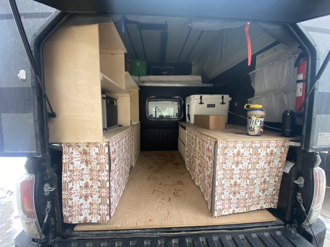

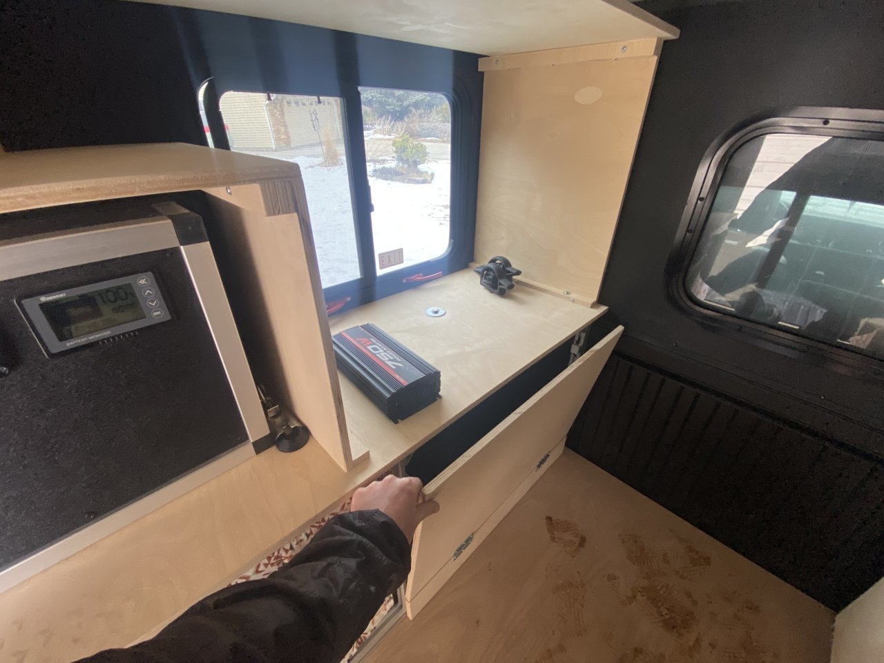

    Dang 831, I haven't had any problems (yet) with water intrusion but that seems pretty nasty. I have had some weird slippage on the topper, it looks like it's slid ~1/4 inch back on the truck rails. I need to get it resettled because I'm worried about water.

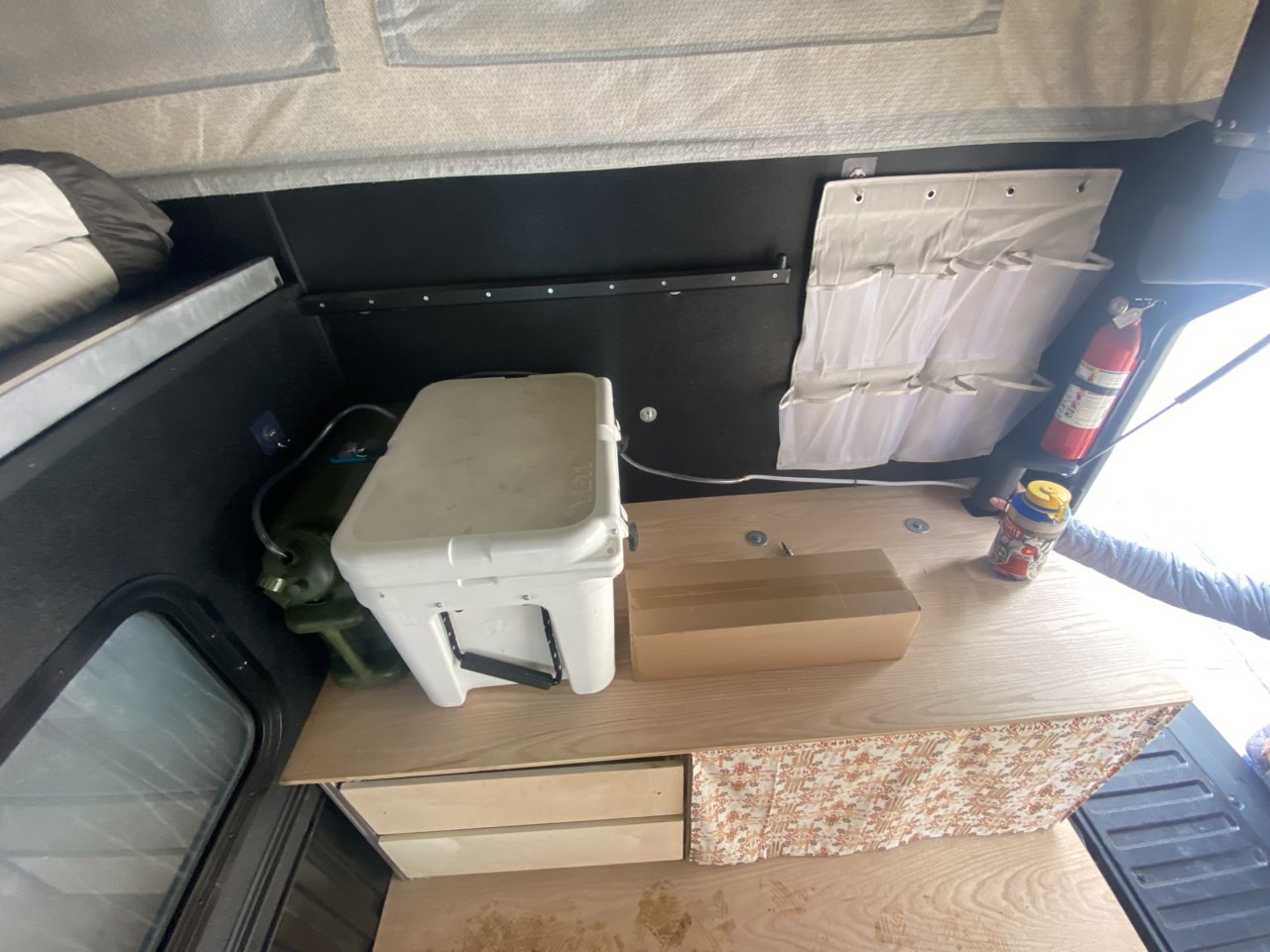

    In other news, I've mostly finished my build for now! Thanks for all the help everyone! Pics below:
    Notably, I added the storage above the left bench which will eventually have drawers in-built, affixed my water can against the back right that connects to the new Dometic pump, and installed that piano door on the left floor to provide "infrequently used" access. It's starting to feel a lot more like home!
    Still on the list for future improvements is:
    1. A new battery system & solar upgrade
    2. Awning on the outside, probably will do the moveable system like you did AGT
    3. Better bedding/mattress to make everything work better with the bed collapsed
    4. Removable mount for my Insty Connect internet setup

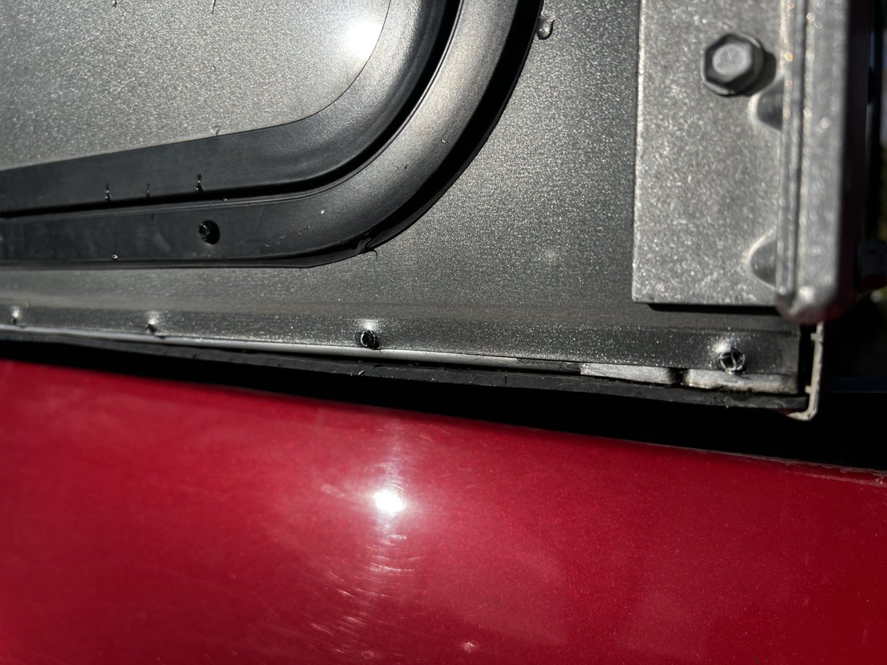

    Finally ripped the bandaid off and decided to pop the PM off the truck and reseal the entire camper. Honestly, it was the best decision I could have made. Even if it took me an entire weekend.
    The bulb sealing on the bedrails was completely flattened in some areas, and the sealing on the front rail had lost all compression and was letting in a ton of water.
    After reading some Alucab forums, I found some guys talking about the same front rail sealing problem I was having on the gen 2 Tacoma. The front rail sits lower down than the sides so you have you really bulk up that area.
    This is what they recommended for the front:
    https://www.amazon.com/gp/product/B07147Y43J
    And for the sides:
    https://www.amazon.com/gp/product/B00NCCDXJ8
    These seals are much more heavy duty than the ones that came on my PM. Since the bed rails on the gen 2 Tacomas are curved I cut the front seal as best I could to match curvature, then filled the joint with butyl putty.
    Ended up putting more butyl tape on the bed rail to match up with the butyl tape on the sealing (not pictured).
    After applying both front and side weather sealing I am happy to report there are no more water leaks!
