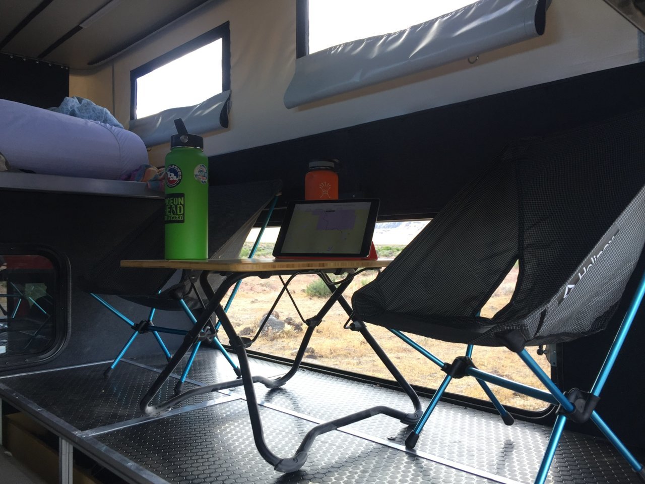

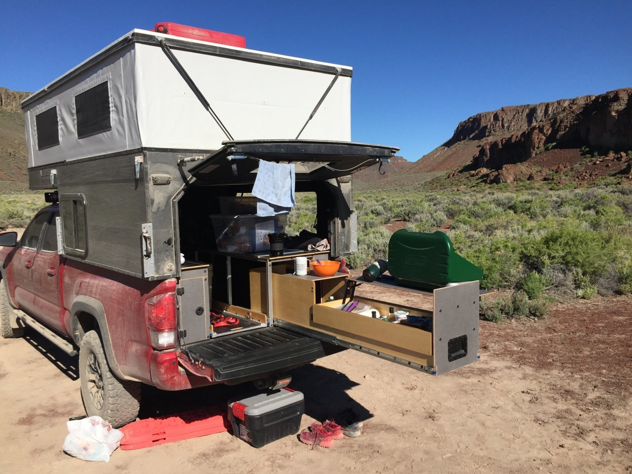

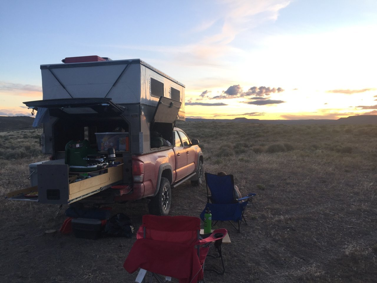

    We did a 6 day trip into NW Nevada last week. The topper and build worked extremely well. We were off-grid and on dirt for 4 days.
    In my last post I talked about hanging out inside on a hot afternoon with no breeze. It worked out great using our backpacking chairs inside.

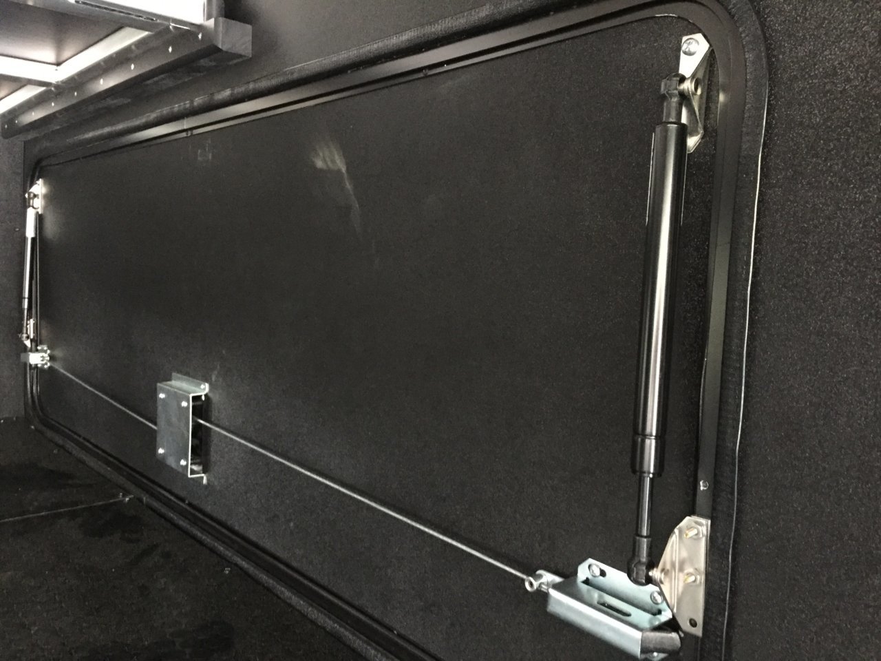

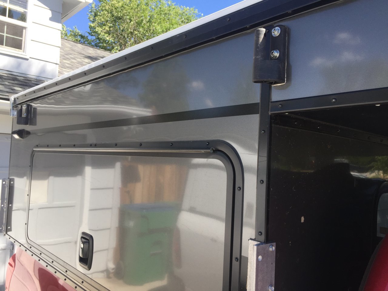

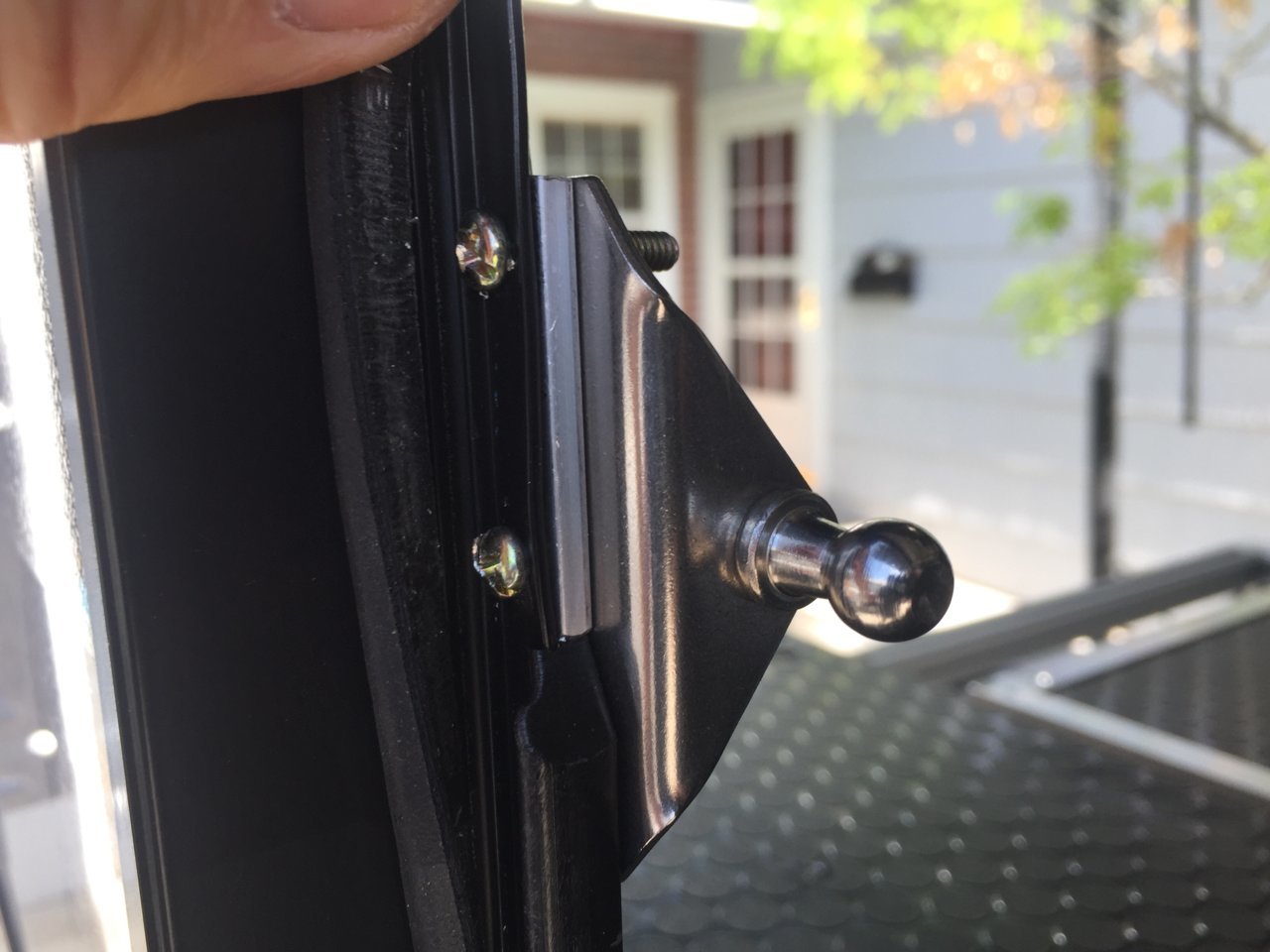

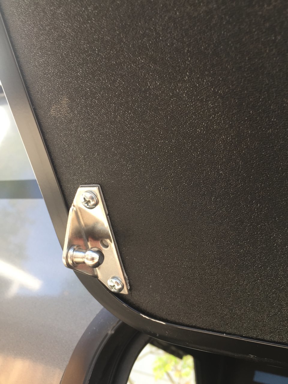

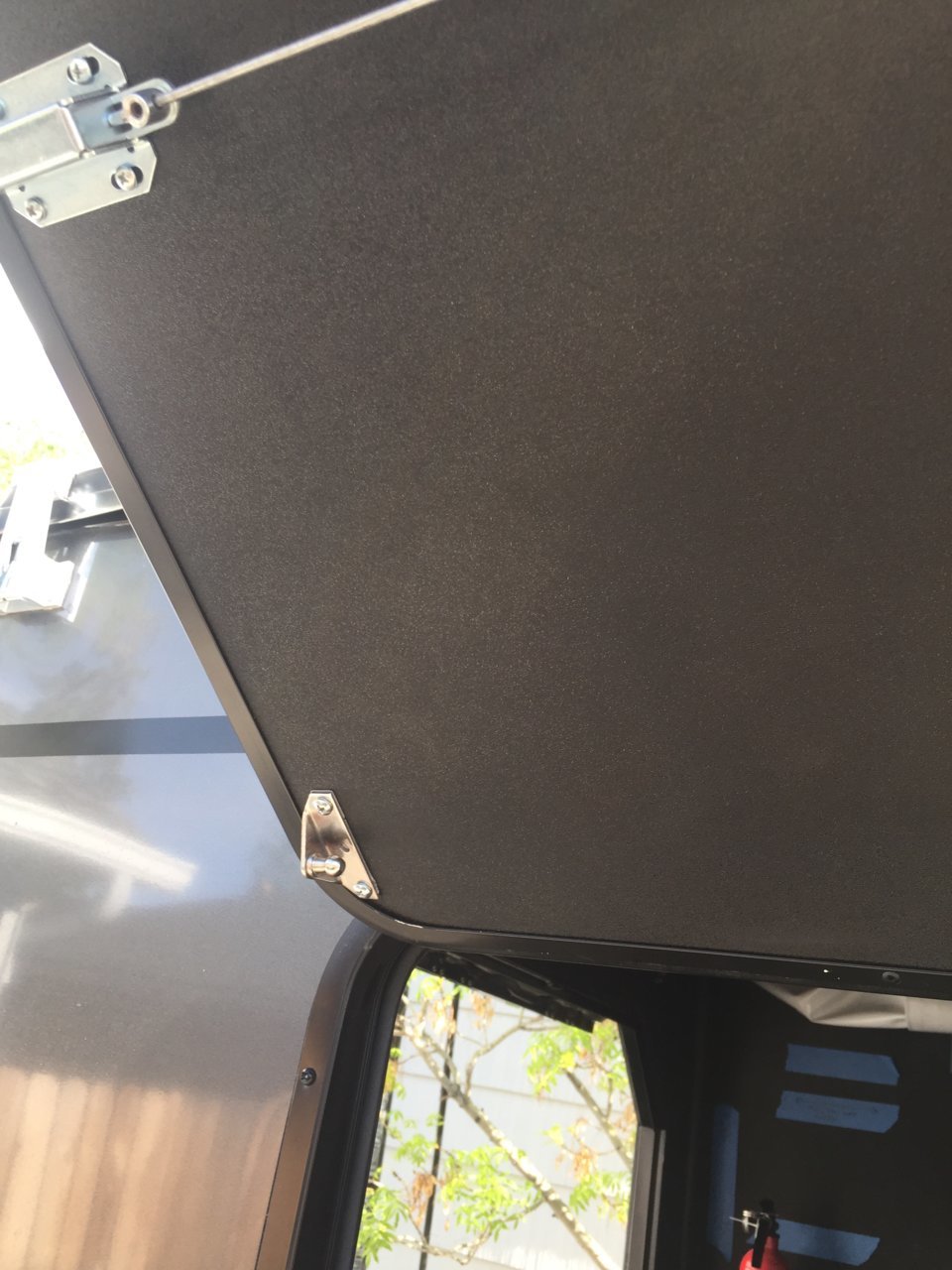

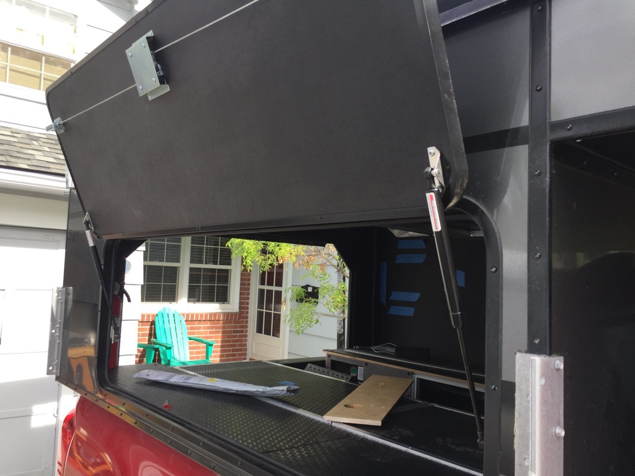

    One of the options I went with was the side door. I liked having the side doors on my last shell but was unsure if I’d like one on the Project M. After our latest trip, we are completely sold on it. They do offer a smaller side door but we went with the large one. The biggest advantage was being able to open it for air flow during the afternoon. The temps were in the 80s with no shade. We also kept our bags next to the door so accessing cloths, toiletries etc with out having to crawl in the back was great. The door frame on the inside of the topper is metal so I plan on making a screen with magnets to hold it on. It would be nice to have a way to keep the bugs out.
    The biggest issue and gripe I have with the door and reason I was unsure on how useful it was going to be is FWC does not put lift supports on the door. Without them the door is a pain to hold up while accessing your stuff.
    After some research I found a company called Lift Supports Depot that was great to work with. I purchased several different lifters and sent back the ones I did not use. The install was fairly easy and the overall cost was $68. The lifters I ended up using work great although I probably could have gone with shorter ones. The ones I am using are 15” extended and 9.5 closed. They are 40lbs lifters. I may have been able to go with 30lbs. Below is the list of parts:
    Liftsupportsdepot.com
    Brackets
    https://www.liftsupportsdepot.com/er-ball-stud-joint-10mm-3-8-3-bolt-l-bracket-s316-stainless/
    https://www.liftsupportsdepot.com/es-ball-stud-joint-10mm-3-8-3-bolt-l-bracket-s316-stainless/
    Lift support
    https://www.liftsupportsdepot.com/lift-supports-depot-se150p40s10-gas-charged-lift-support/
    The install was easy requiring a few holes to be drilled in the frame and door.

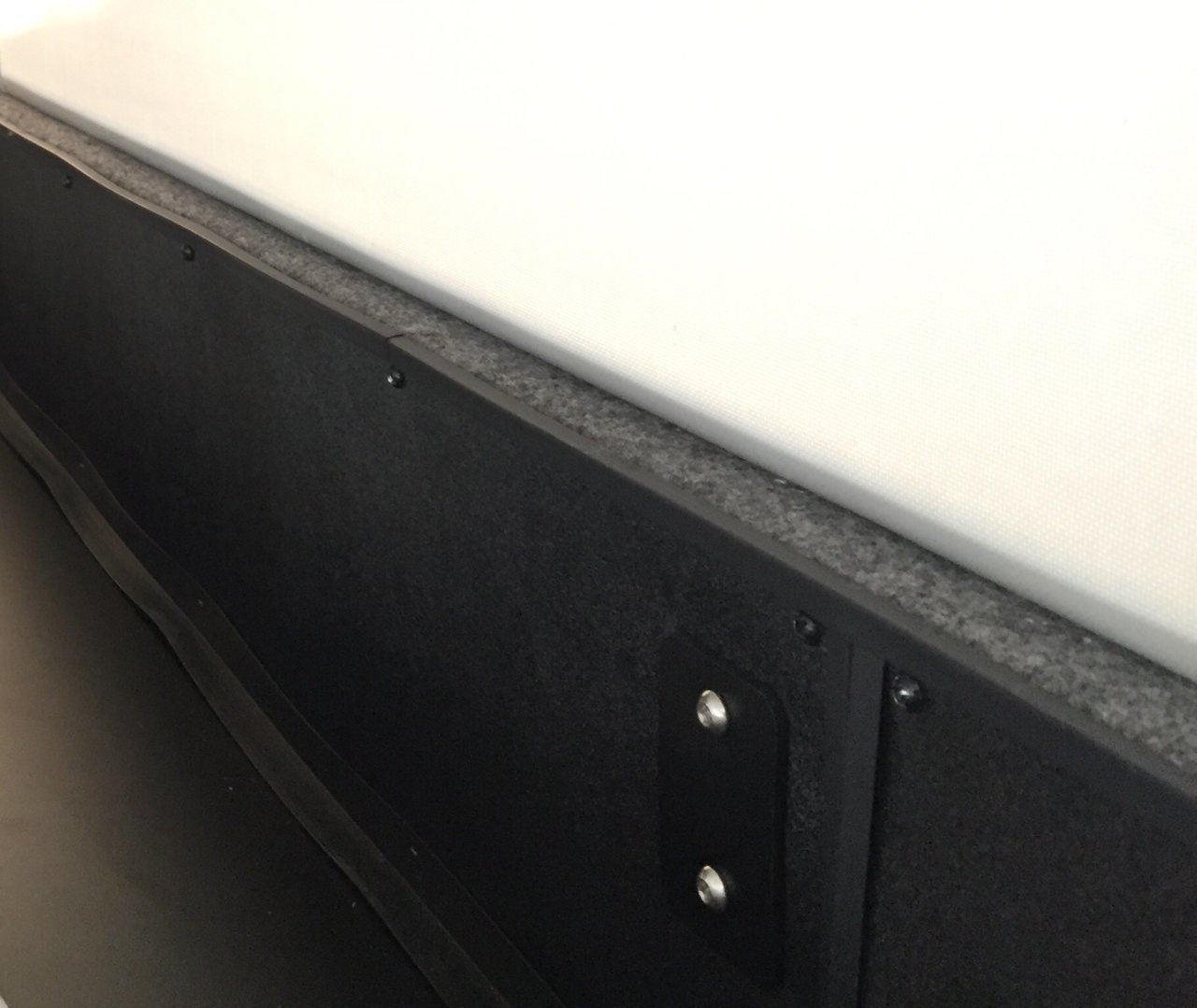

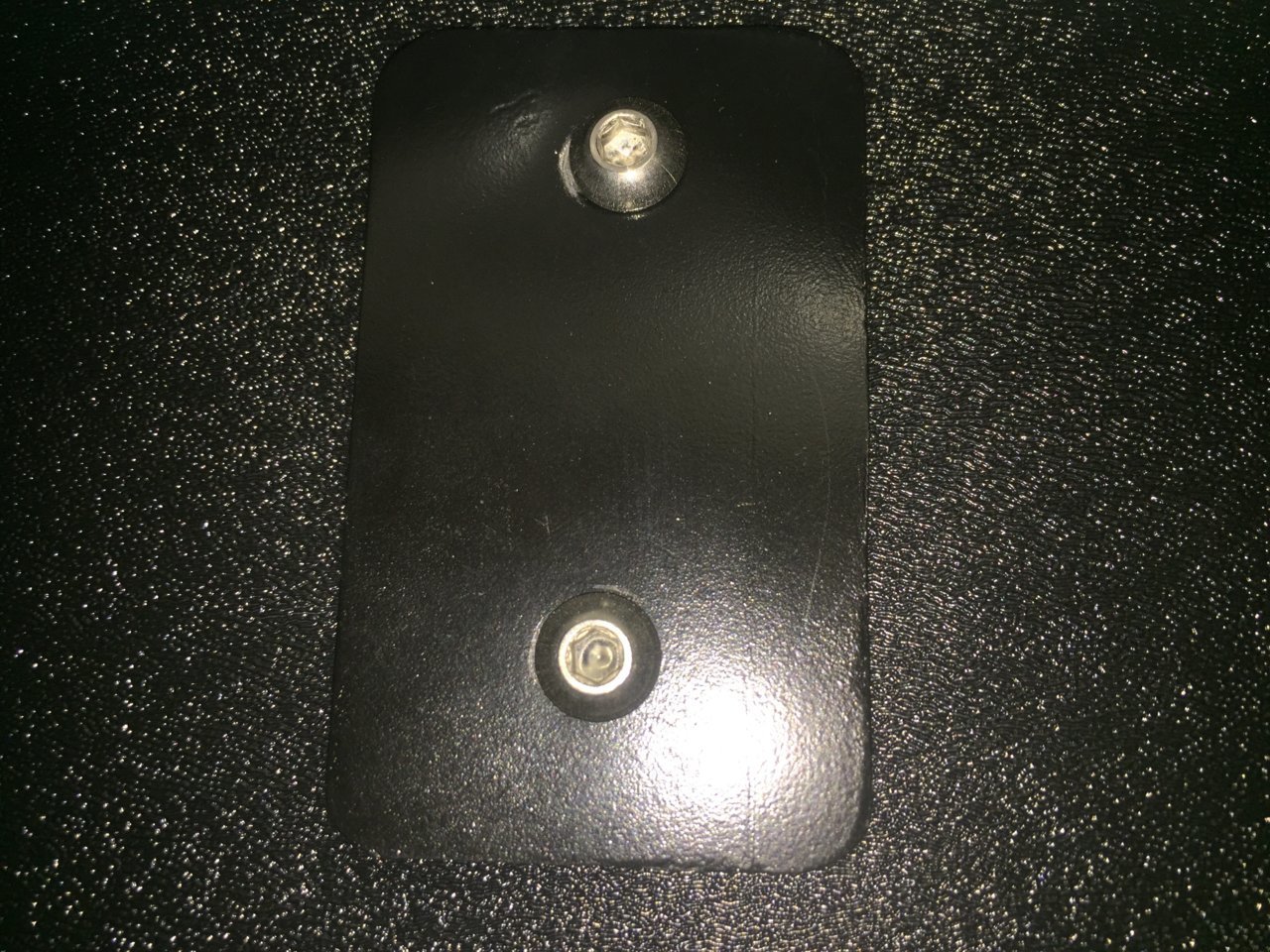

    Due to the placement over the top of the latch plate on the frame, I had to use a piece of aluminum as a spacer. Shorter lifters may have worked better to avoid this. Although it was not a big deal to fabricate. I eventually cut down the screws and used nylon core lock nuts.
    There is nothing behind the abs plastic and the screws seemed a bit loose so I used some high strength 3M double stick tape as well. No issues so far.

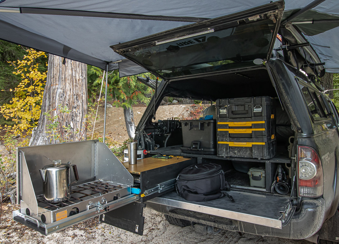

    Nice build. I was looking for more info/pics on the Project M now that they have been out for a while and I definitely appreciate your pictures and review in your thread.
    Funny enough I have a very similar setup to what you had with your ARE MX series. We are considering upgrading to the Project M within the next year or so. Hoping they have all the details worked out on them when we go to order.
    I think one of the biggest flaws with the Project M right now is that it doesn't come with a pass thru slider option into the cab. Did you have this option with your ARE? We use this quite a lot. It would be nice to retain this option. Not sure if it would get as much use though considering the extra space the FWC provides.

    I did have the pass through on the ARE. We really didn’t use it much but it was useful when needed.
    Indeed the space difference is huge. It’s like a palace inside the FWC compared to the coffin like feeling of the ARE MX. It’s nice to be able to get out of the weather and be comfortable.
    I like your set up. Nice how the stove tucks away. Will you carry over your current set up to the Project M?

    Ya I'm hoping a pass thru front window becomes an option eventually.
    I also hope they add more options for the side doors with a potential door/sliding/screened window similar to the MX series.
    Im not really sure how I'd build out the back of it yet. Id like to retain the stove/drawer slideout, but the other half if the platform would get modified to provide full height standing room. I wasn't really sold on the shelfs the FWC has but seeing how you modified yours I'm liking the idea a bit more.
    I still want to see one of these toppers in person. Was hoping to go to the BC Overland Rally in Whistler, BC again this summer but with Covid it got canceled. FWC has ran a booth there for the last 3 years.

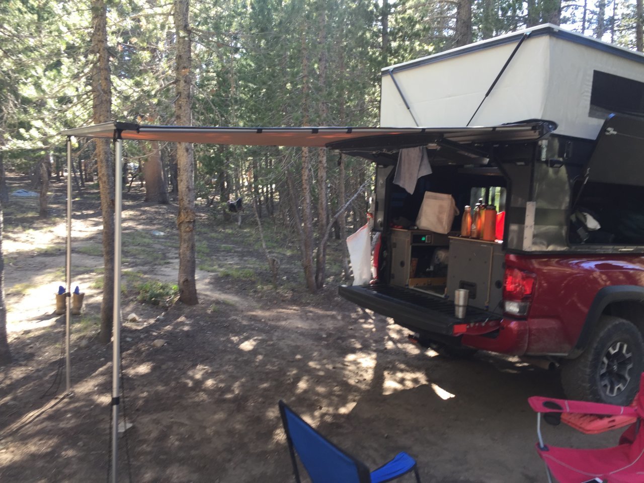

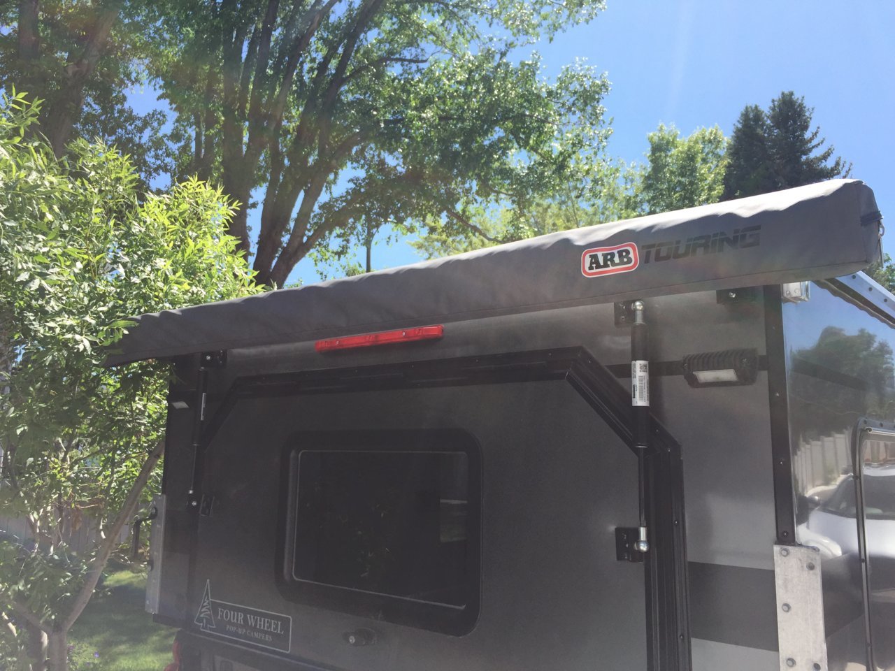

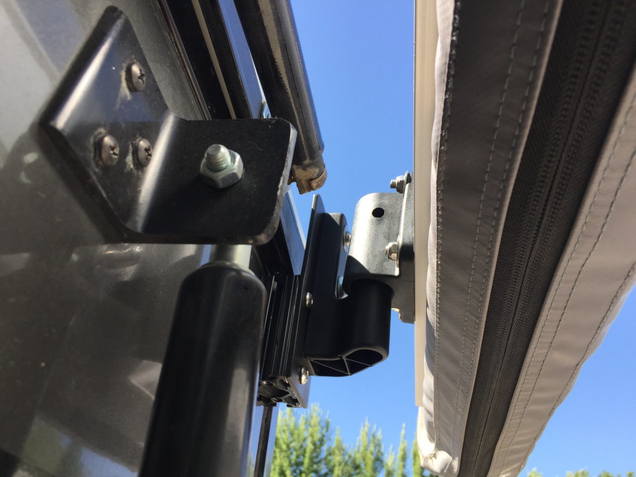

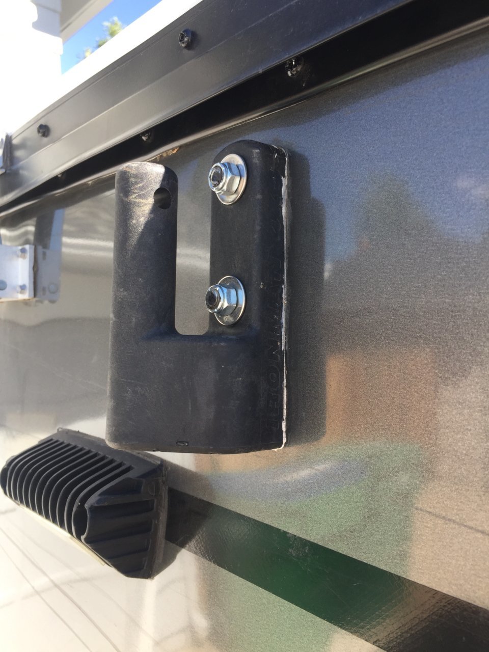

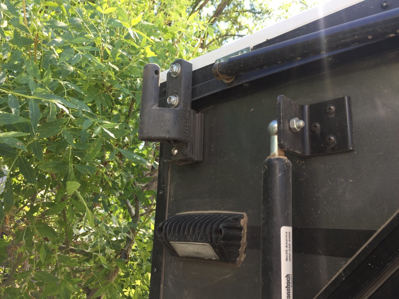

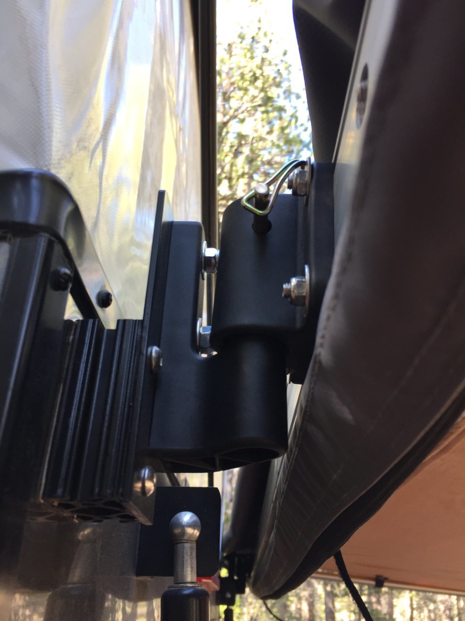

    I finally got around to installing awning mounts. I had a six foot ARB awning from our last build and I figured I’d reuse it. My last build I had mounts on the back and side. When traveling the awning would be on the side. Once at camp depending on the sun I could move it to the back if needed. Initially I considered a Bat Wing awning for the new build until I saw the price and weight. Plus the ARB has a nice awning room if I ever wanted to upgrade.
    Whilst designing awning brackets, I came across IronMan4x4, an Australian company, that makes removable awning brackets. They allow you to move the awning easily and take it off when not needed. The basic set was $90. Additional mounts were $32.
    https://ironman4x4america.com/awning-quick-release-mounting-brackets/
    https://ironman4x4america.com/awning-quick-release-extra-hooks-kit/
    I ended up putting mounts on the passenger side and rear. At some point I might consider putting mounts on the driver side as well. Taking the awning on and off is super simple now.
    The side mounts where easy to install. Two holes drilled for each mount all the way through the wall. I fabricated a stylish aluminum plate on the inside for the bolts to go through.
    The rear mounts where problematic because of the rear door lifters and the roof lifters, I had to fabricate a step out for the mounts. I used left over 2” 80/20 and some aluminum flat plate. Since I will never be traveling with the awning on the back, I didn’t drill all the way through the side. I used rivnuts instead.
    I forgot to take pictures of the awning on the side. Next time we have it out I will take some pics and add them to the thread.
    Overall it seems to work well when I remember it to bring the awning. Forgot it last weekend.
