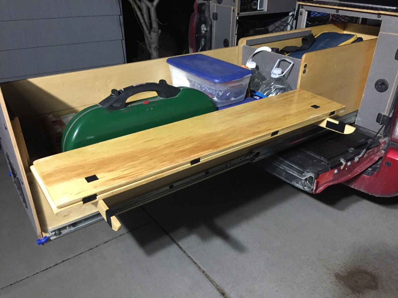

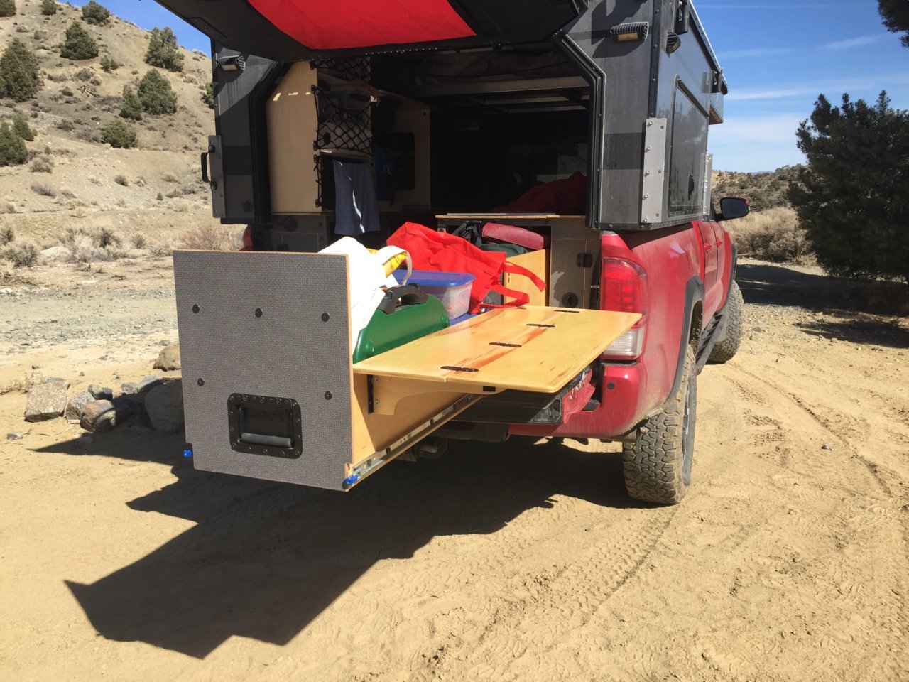

    We got out this past week and spent four nights in the snow. We camped at Lassen National Park and spent the days backcountry skiing. The Project M build was outstanding.
    We were able to finally test the DIY thermal pack. My initial impression is positive. I think it helped out quite a bit making it more comfortable to be inside in the evening and mornings. Even with the heater running, before the thermal pack, there was cold air around the fabric top. The thermal pack improved this making it much more comfortable. We only ran the heater in the evenings and mornings. With the heater off overnight, the temperatures inside by morning where 33, 34, 37, and 38. The outside temperature where in the low to mid 20s overnight.
    As far as condensation, there was some but only on the ceiling and top of our sleeping bags. The thermal pack and inside walls stayed dry. The condensation was limited to where the ceiling fabric touches the aluminum framing. We left the roof vent open and side window cracked each night. On the nights when the wind was calm, there was more condensation. The last night it was very windy out and we had almost no condensation. A quick wipe down with a towel took care of the condensation in the morning. We attempted to experiment with the 10 speed maxxair vent set on its lowest setting to see if that would pull enough air through overnight to eliminate the condensation. This would result in lower temps inside but in theory would help exchange the moist inside air with dry outside air. Unfortunately the vent stopped working after about 20 min. I have a repair request in with Maxxair to figure out a fix. Apparently Maxxair vents are quite sensitive to voltage fluctuations.
    The diesel heater was the superstar for the trip. It made for comfortable evenings and mornings. It easily kept the inside temp around 60-65F. I kinda felt bad as there where several people that where sleeping in their minivans and Outbacks and one guy in an open truck bed. Way more hardcore than us with our heater blasting away. We ran the heater about 6-7 hours a day with about 50% of the time on low. I’d estimate we used about 1-1.5 liters of fuel per day.

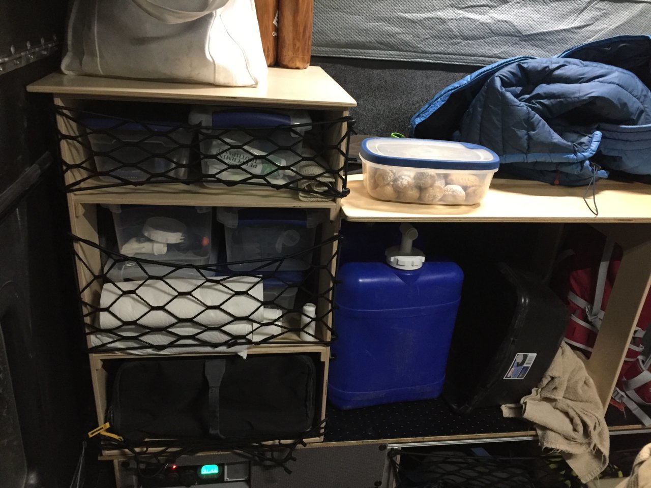

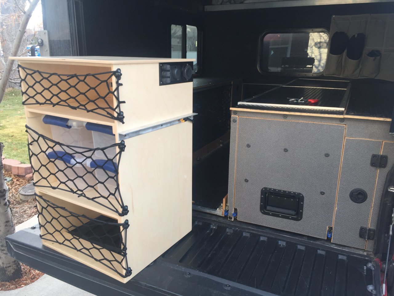

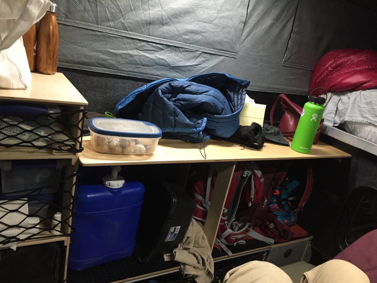

    A new addition to this trip was a cabinet and countertop. I have been working on this since November and finally got it installed before the trip. This is a game changer for space management and for cooking inside. The whole unit is fairly light weight and easily removable. The cabinet is 3/8 ply and counter top is 1/2”. To save weight I made custom cargo nets to hold plastic containers on the shelves. I also added cargo nets to the lower spaces under the bench. The cabinet helped free up space in the drawer for more storage of bags and personal items.
    I installed three switches, USB charger and 120v outlet in the cabinet. The switches are for the USB chargers and under countertop lights. The third switch is for future use.

    Custom cargo nets

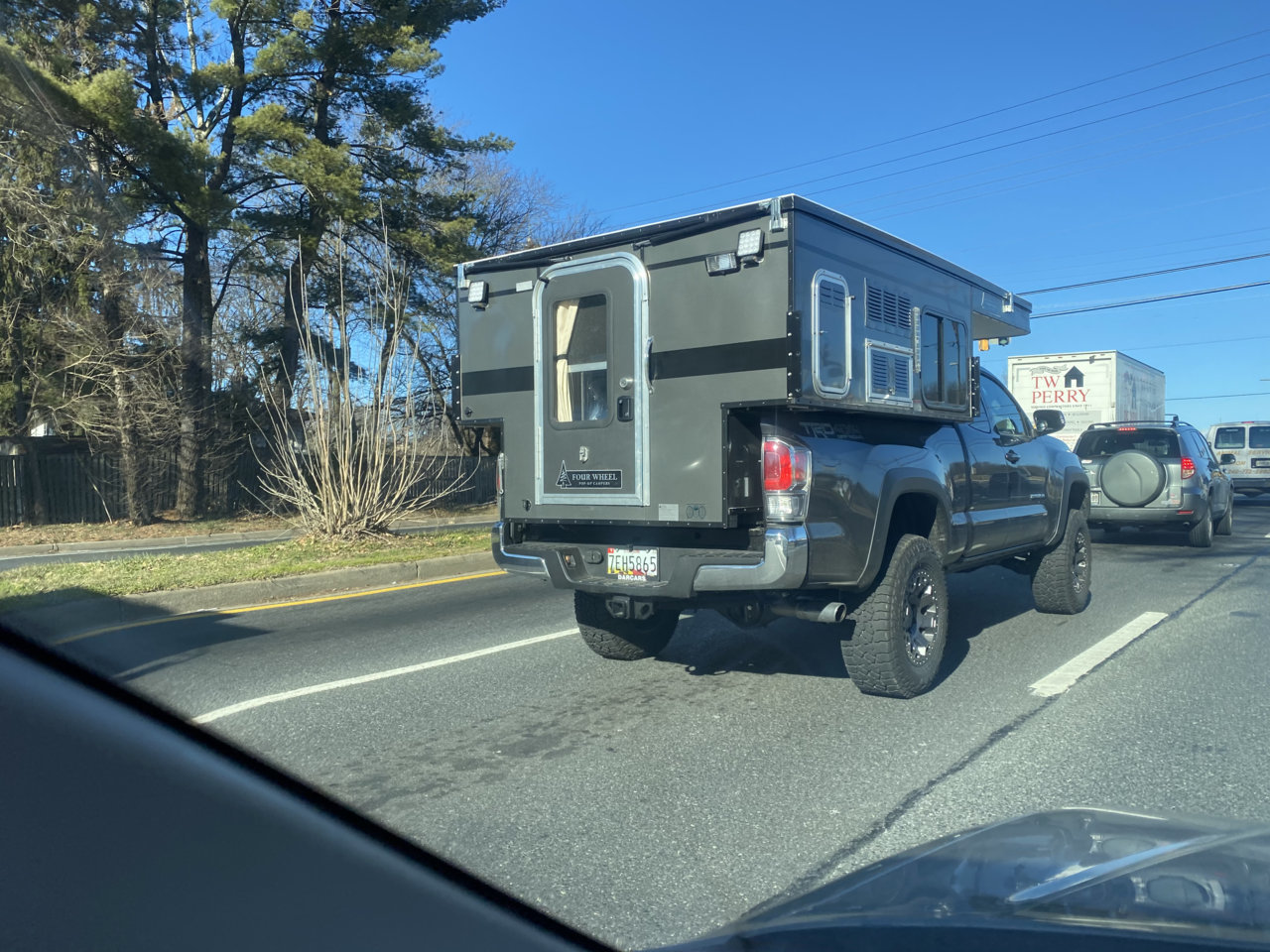

    I saw this guy in Maryland today. Looked pretty slick

    Looking good. I like the color choice.

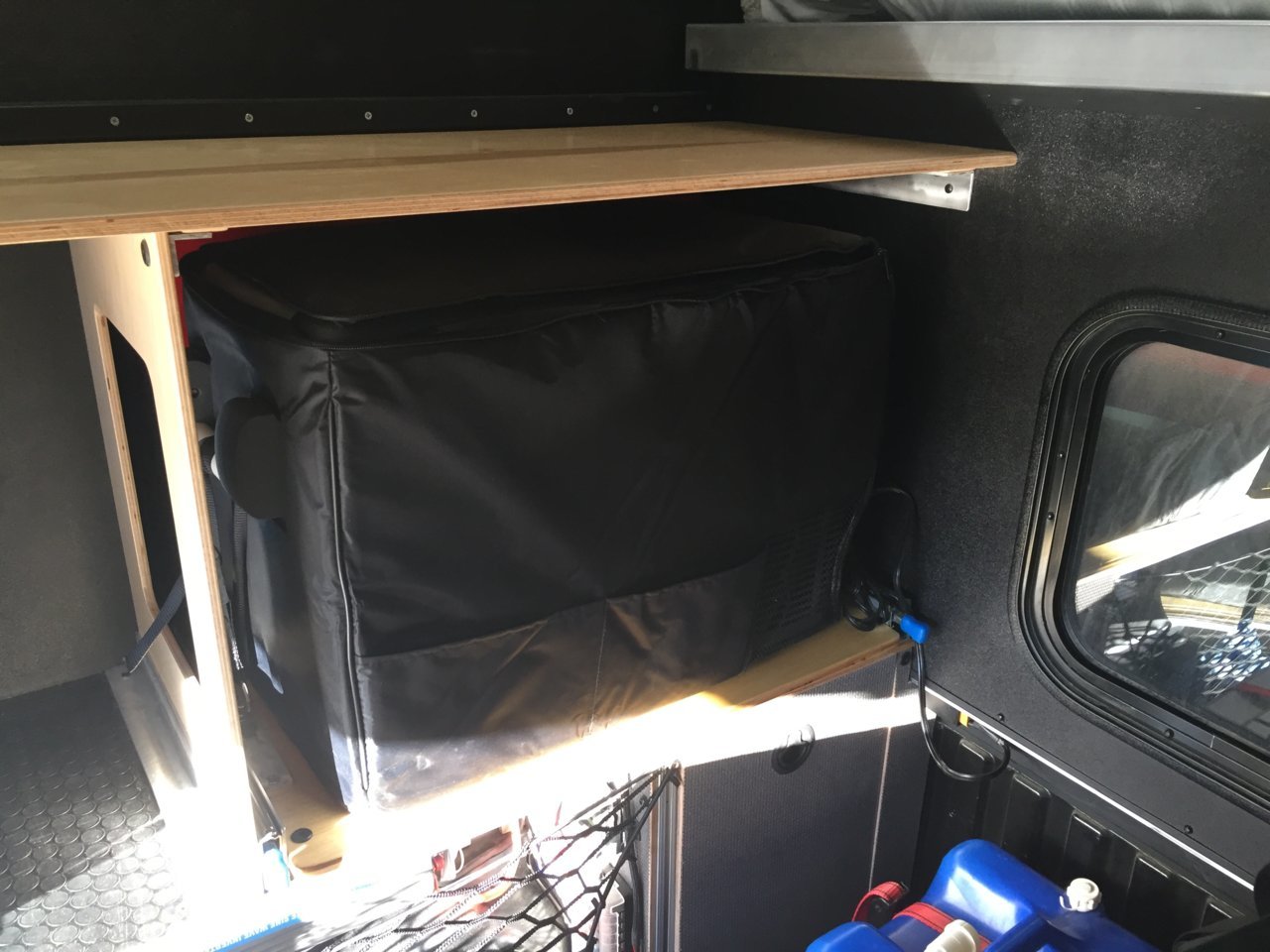

    I purchased a Iceco JP40 fridge over the holidays and have had a chance to test it out a bit. I will do a preliminary review in the future. Really wont know for sure on how well it works until summer. I am impressed with it so far especially considering it was about 1/2 the price of the Dometics. I will be installing a slide out under the new counter top to hold the fridge.

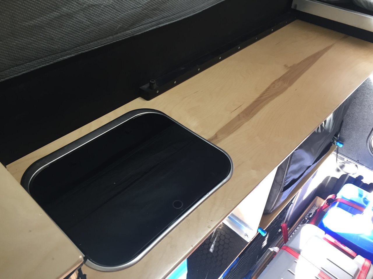

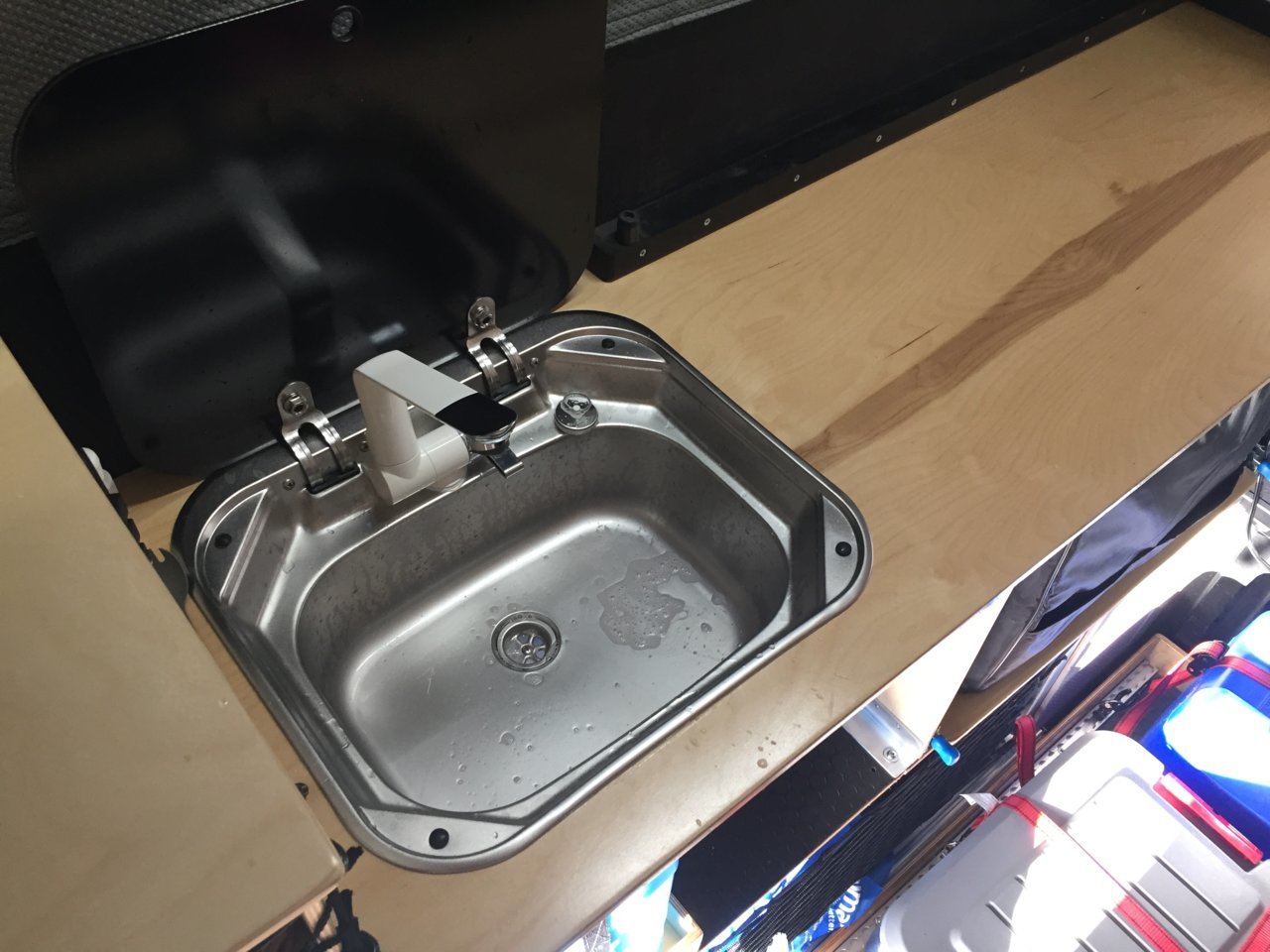

    I also purchased a small glass top sink that will be installed in the counter top. It is flush mount and will allow use of the counter top when the lid is down. The positioning on the counter top will allow access when the bed is pulled out. My plan is to drain the sink into a 2.5 gal jug. I haven’t decided if I will do a water system. It will be nice for winter camping. Currently we wash dishes in a plastic bin which is a pain inside and sucks to do outside when it is 20F out. It will be nice to do inside. Not sure how much use it will get in the summer. I will post more when I get these projects done.

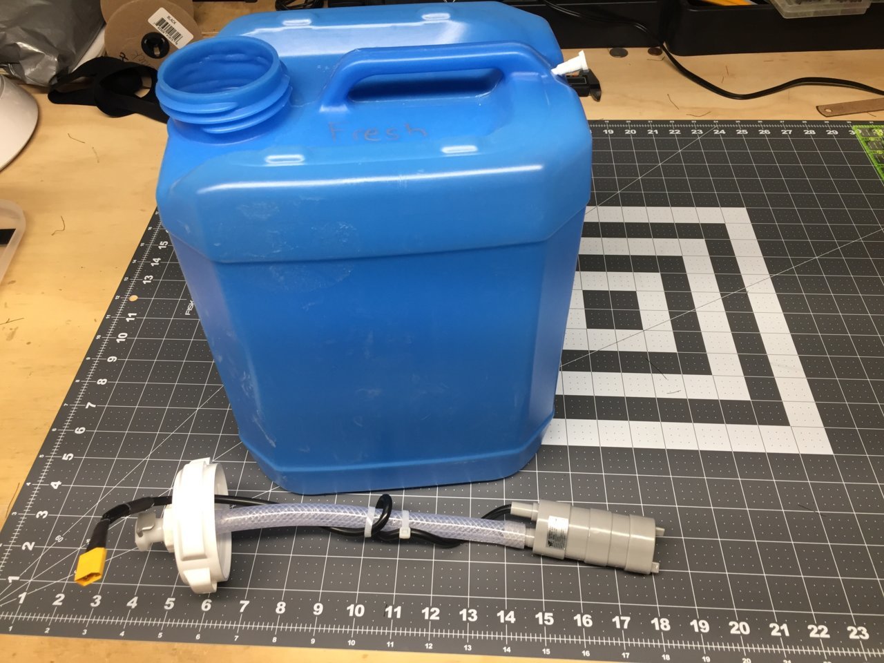

    We got out this weekend to test out some new upgrades to the Project M. We spent the weekend out near the Pine Grove Ghost Town.
    Friday night we woke up at 3:30am to the strongest winds we have ever experienced so far with the Project M. We decided to drop the top and go find a more protected spot. Getting the top down was difficult and required both of us. The wind caused the side fabric to pooch out on one side. Needless to say, it wasn’t a fun experience getting the top down. I don’t think the top would have been damaged if we stayed, but we definitely would not have gotten anymore sleep. We ended up driving around for about an hour to find a quiet location. You can put high winds as a con for a pop up camper. In retrospect it didn’t seem wise to be monkeying around with the top in high winds.

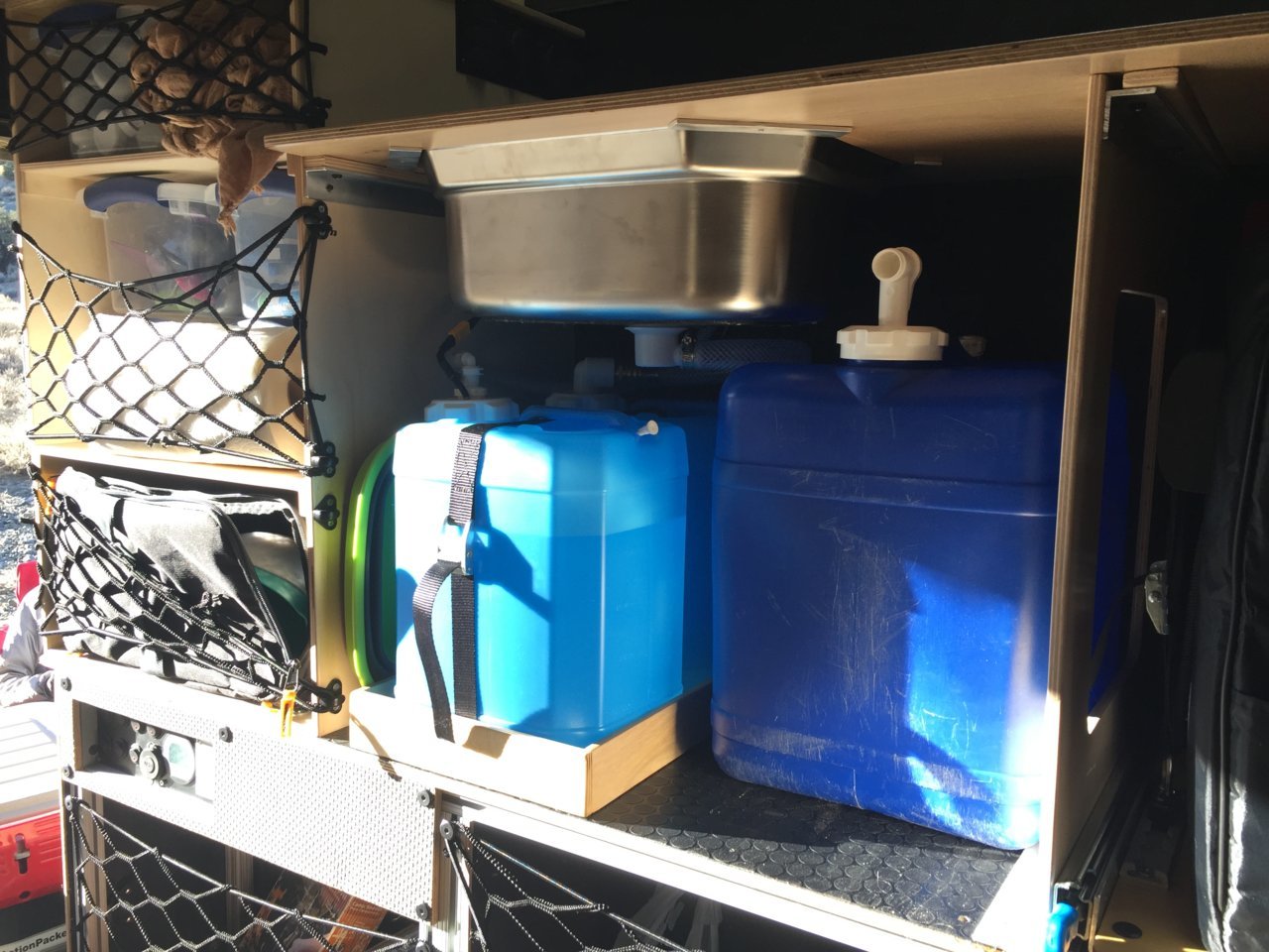

    The upgrades we tested were a new sink and water system, fridge and slide out, a new side table for the drawer and new window covers.

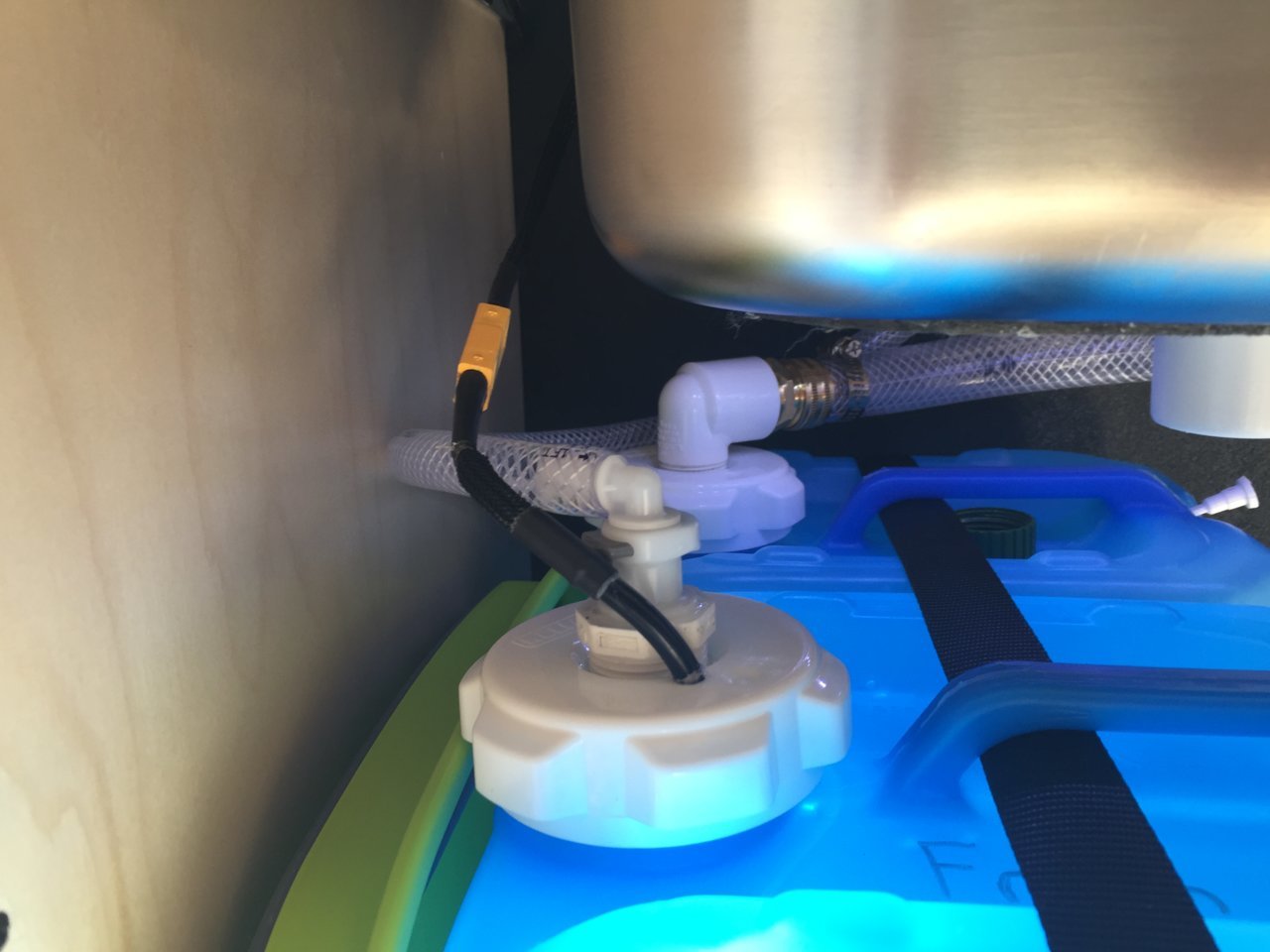

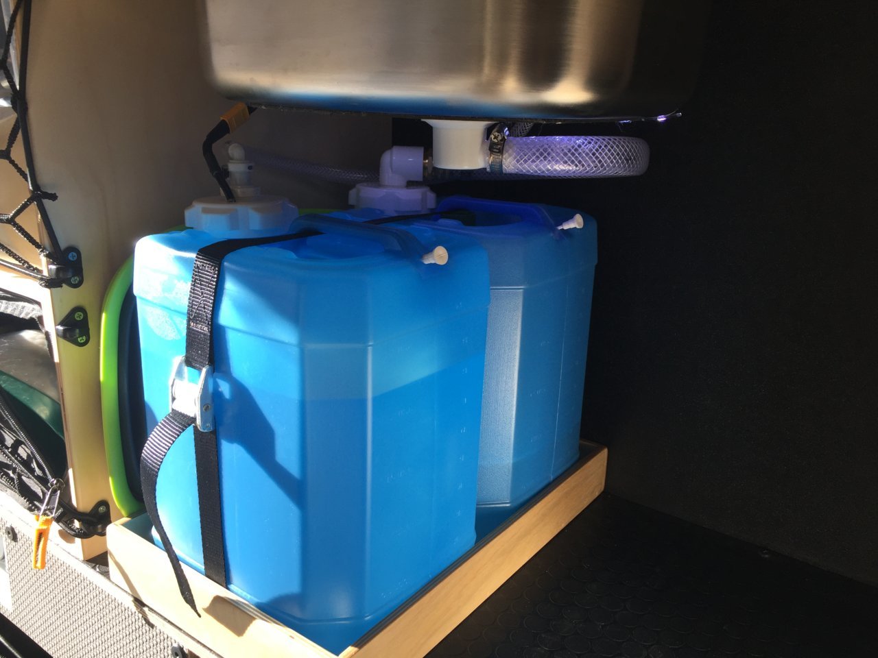

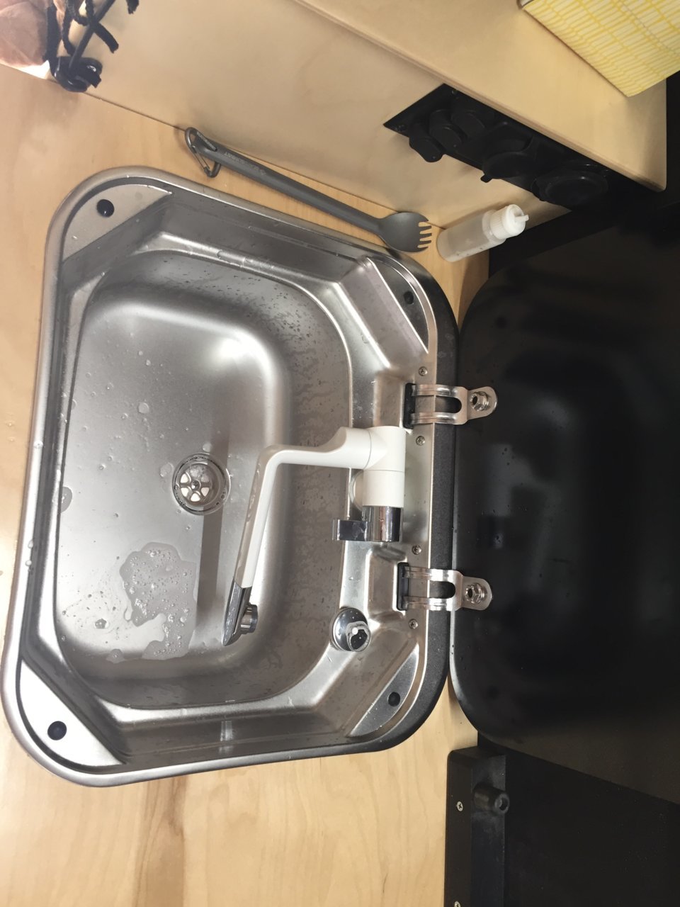

    I recently installed a Dometic knockoff sink in the countertop. The water system is made up of two 2.5 gal Reliance water containers. One is for water supply and the other is for the drain. The water pump is a small sump pump in the water tank. The faucet has a switch in the handle to turn on the pump when the faucet is turned on. I also have a master switch for the pump to prevent accidental turn ons.

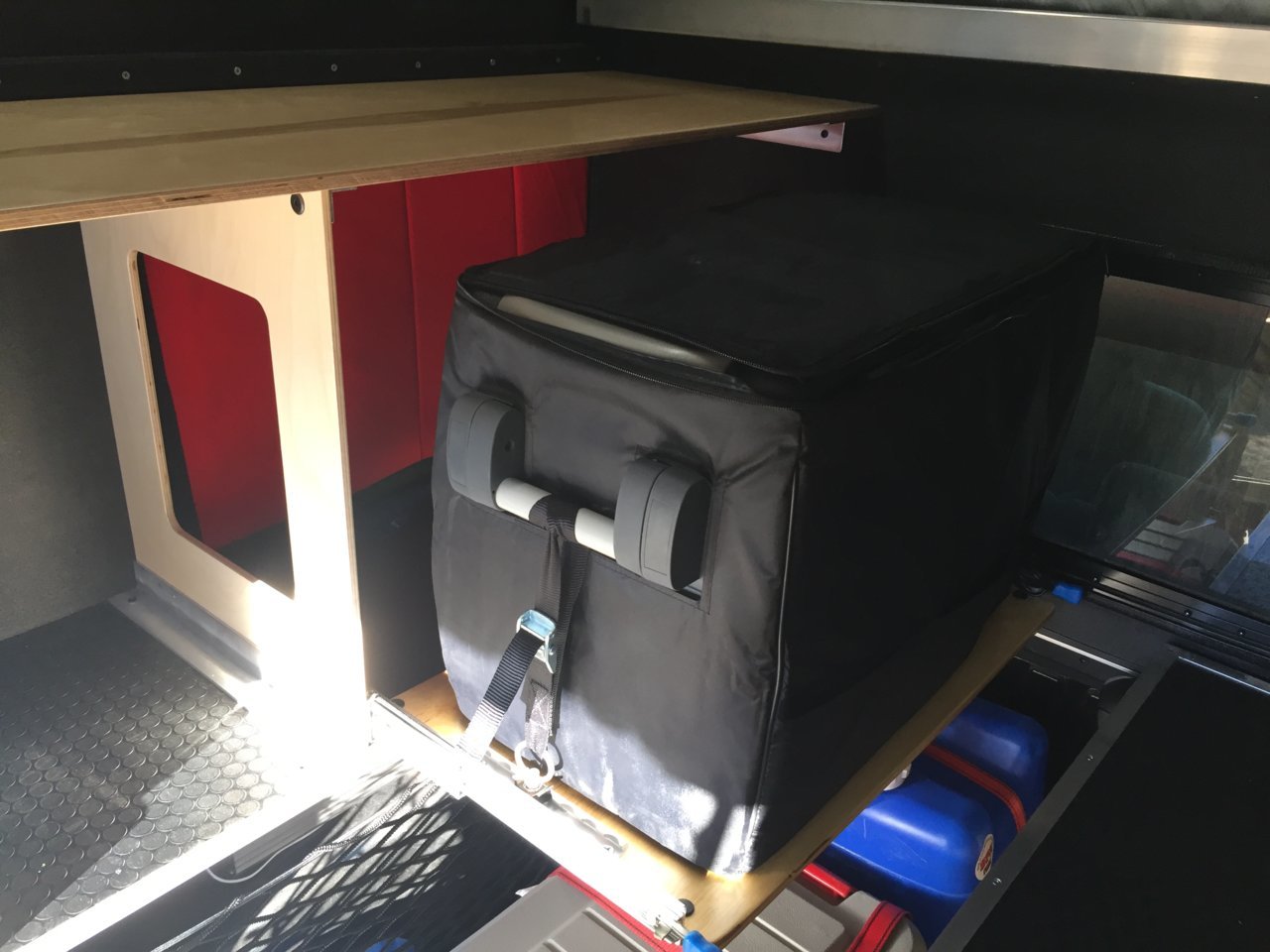

    The next upgrade is the addition of a Iceco JP40 fridge. Over the holidays Iceco was offering a huge discount. The fridge was $430 with tax and shipping. There are many reviews out there on this fridge. I am happy with it so far. It seems to hold temp and evenly cools so far. The real test will happen this summer when it is hot out. I built a slide out under the counter with L-track to hold the fridge down.

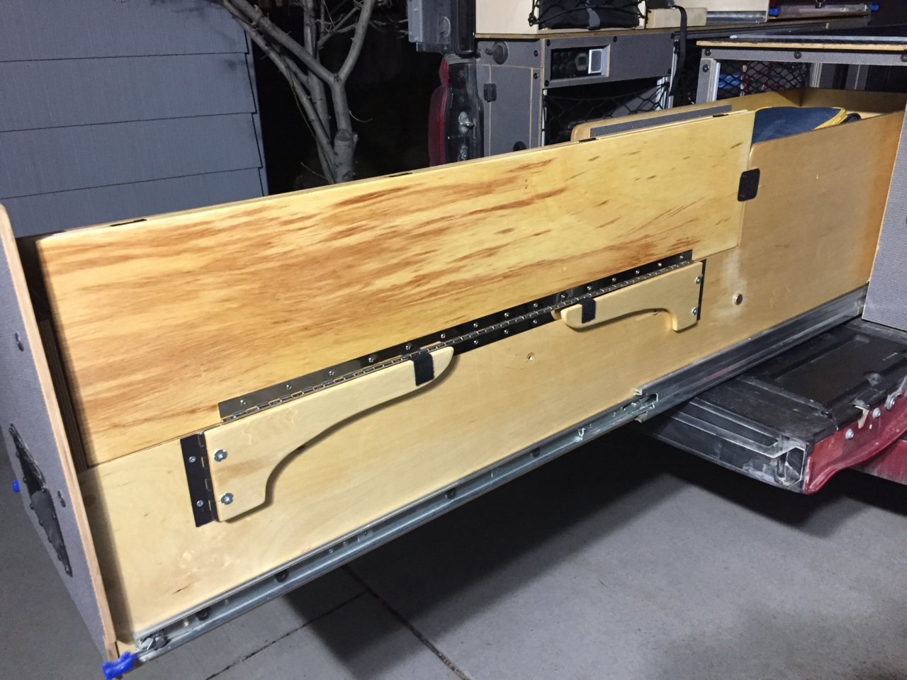

    I redesigned the side table for the drawer over the past couple weeks. It utilizes butler tray hinges so it folds up. The arms under the table hinge against the side of the drawer.

    Thanks for sharing your build. I am planning a similar water install in a Vagabond Drifter. Was it pretty easy to find the fitting to adapt the Reliance threads to connect the tubing?
    I originally planned to install a 15 gal RV tank, but have changed my mind and now plan two Reliance 7gal jugs. I like the flexibility of removing the tanks in the winter and using the space for other things.
  17. Mar 12, 2021 at 7:28 PM
    #117
    AverageGuyTaco
    AverageGuyTaco [OP] Well-Known Member
    Oct 14, 2017
    #232959
    213
    2017 TRDOR-DCLB
    The reliance cap uses a 3/4 NPT thread for the the center hole. A 3/4” threaded PVC plug will fit and is easily found in the plumbing section of most hardware stores. I drilled a hole in the plug and fitted this CPC quick disconnect fitting. I drilled the hole so it was a fairly tight fit and added a little silicon to prevent leaks.
    https://www.freshwatersystems.com/p...nel-mount-hose-barb-coupling-body-3-8-id-barb
    The other end of the quick disconnect I used was this fitting.
    https://www.freshwatersystems.com/p...e-elbow-hose-barb-coupling-insert-3-8-id-barb
    They make a straight version if that works better for you.
    I used 3/8” ID tubing for the water line.
    Fresh water systems is a good source for cpc parts. This particular model, APC, is a lower end version of the ones you see on Amazon. Much cheaper than the other models and work just fine.
    Since the reliance caps are interchangeable, I left extra wire on my pump. I can swap out for longer tubing so it can work with the 7gal tanks if I ever want to set it up that way.
    I always carry a 7gal tank so it is fairly easy to fill up the 2.5 gal tank from it. We use the sink for hand washing and dishes etc. The 2.5 gal tank actually holds close to 3 gal when full. That lasts us almost 3 days. We fill up water bottles etc from the 7 gal tank.
    One of the great things about this system is winter use. When the master pump switch is off, if you turn on the faucet valve, the water drains back into the tank. This will help prevent the pipes and faucet from freezing in the winter. As long as you keep a bit of water in the tank, it should keep from freezing to quickly. We generally travel in winter with temps in the high teens at night at the lowest. With the insulation of the topper the worst we’ve seen is a little ice in our water tank overnight. When we are not traveling, I remove our water tank. Will see how the smaller 2.5 gal tank performs. So far so good.
    The drain tank uses a 3/4 pvc threaded elbow and a garden hose adapter. The tubing is 3/4” ID.
