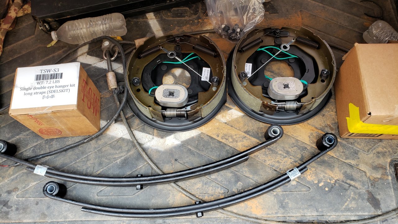

    Just picked up my brakes, 1250lb leaf springs, hanger kit for double eye leafs, new U bolt kit.

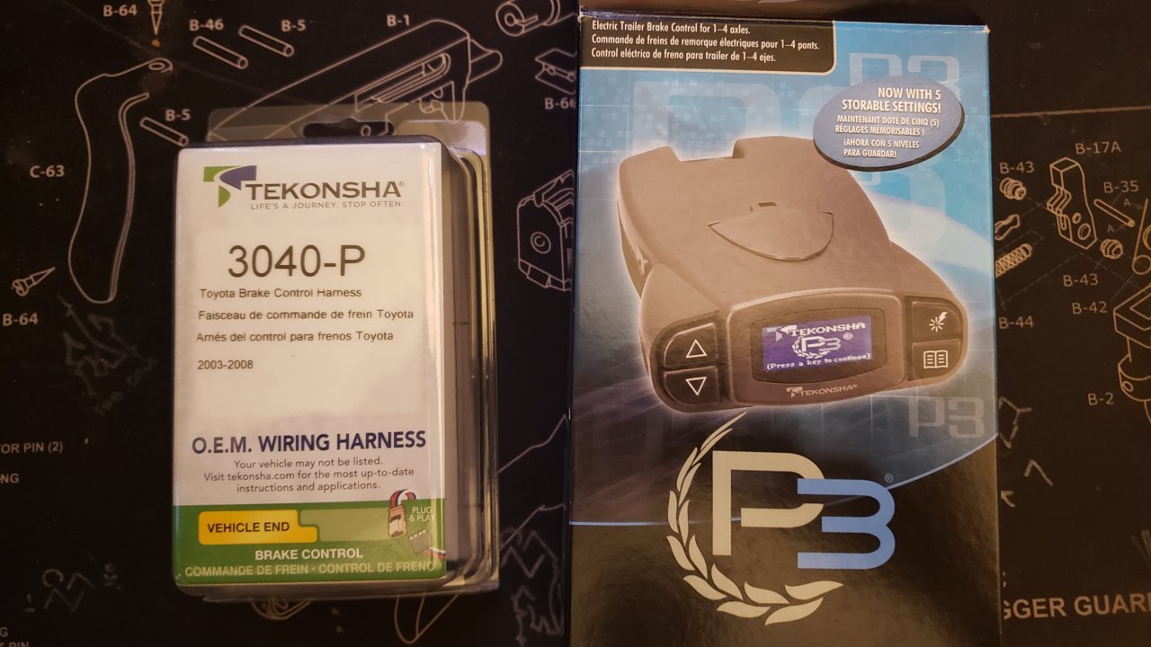

    And the brake controller is in!

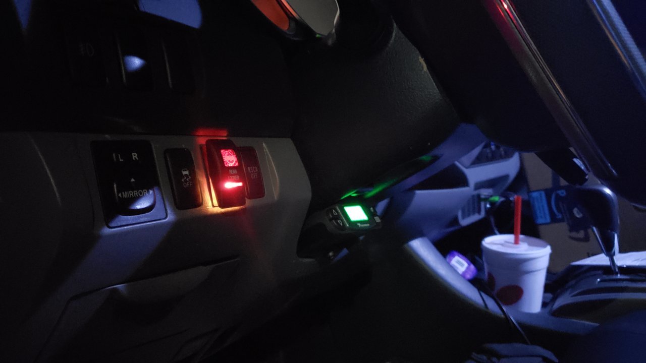

    Got the tekonsha P3 brake controller installed last night in preparation for the new trailer brakes I just bought. During the install I also found the issue with my locker switch so I went ahead and fixed that too. Locker and brake controller ready for action!!

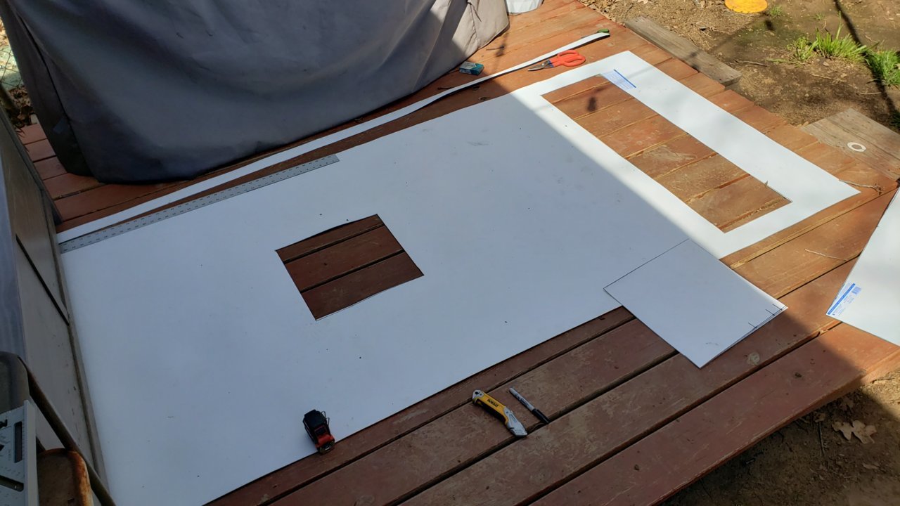

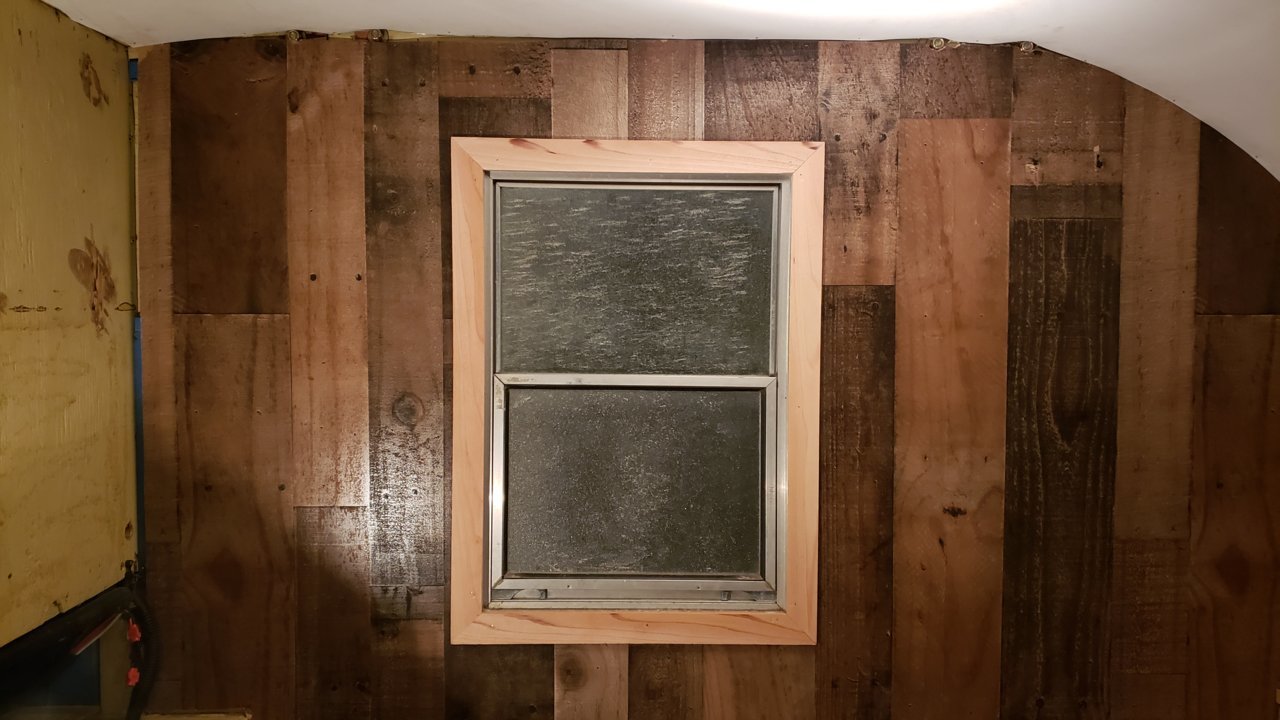

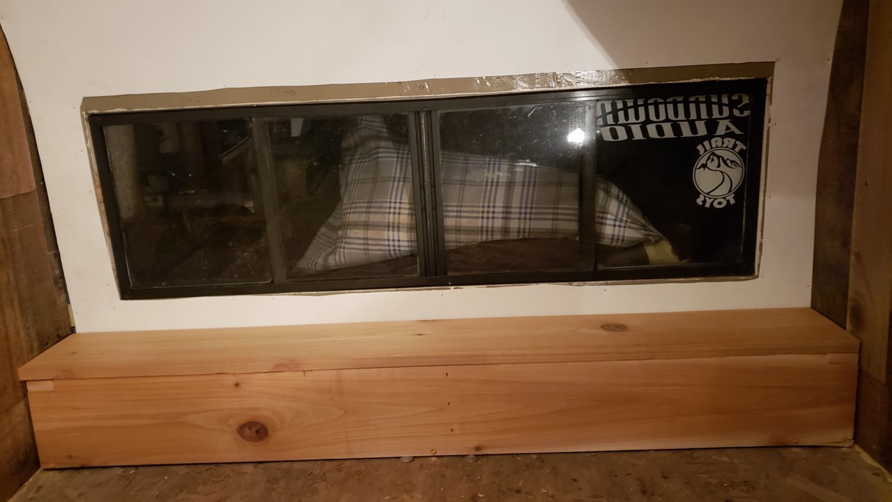

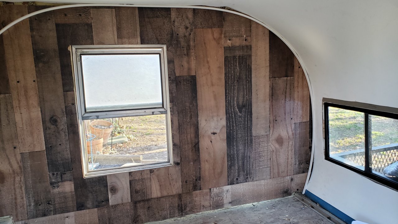

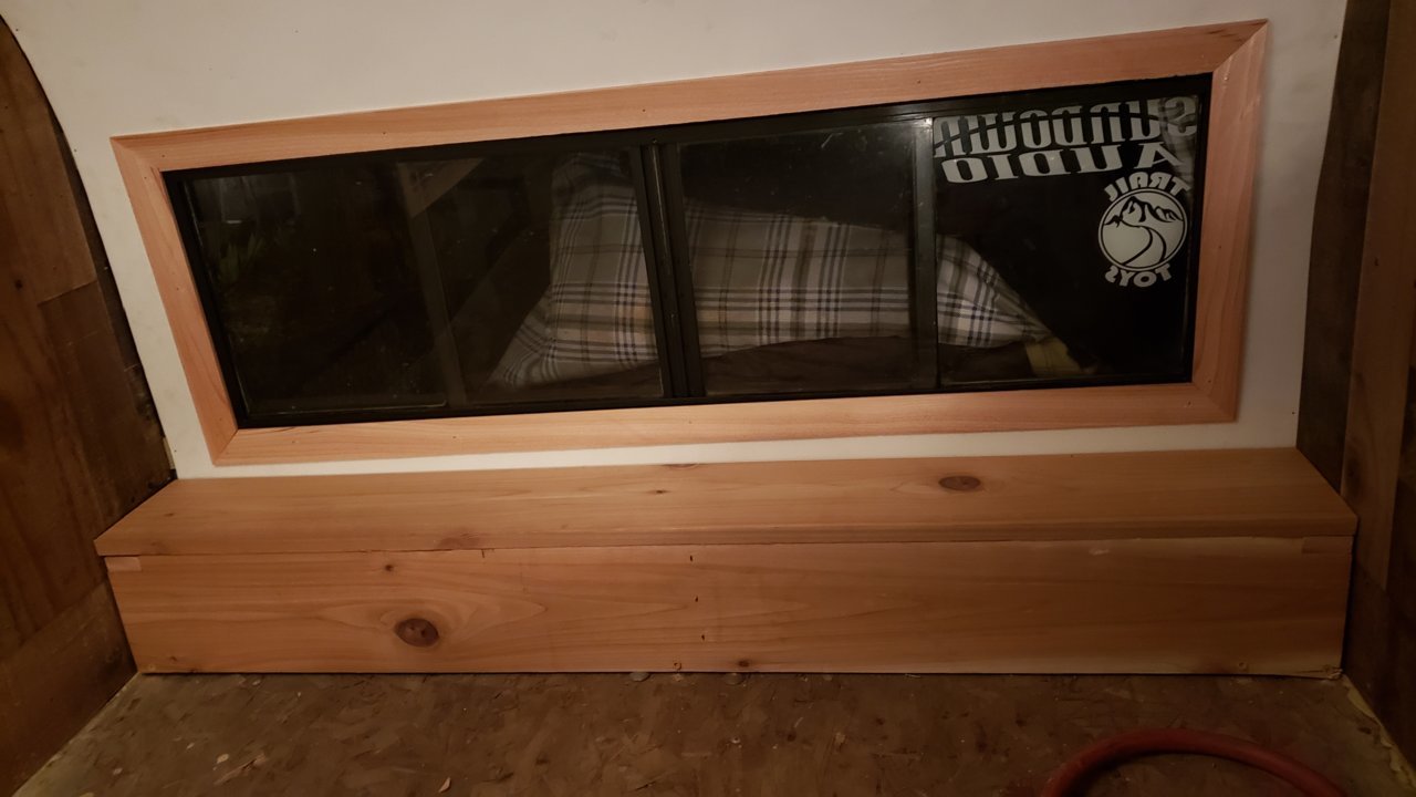

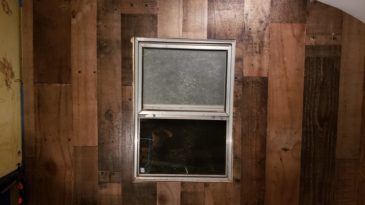

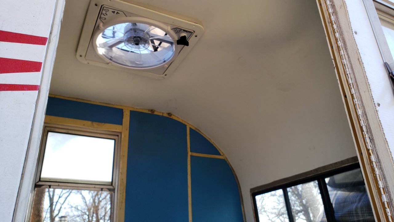

    Got some more work on the trailer done this weekend. This time it was on the inside!!
