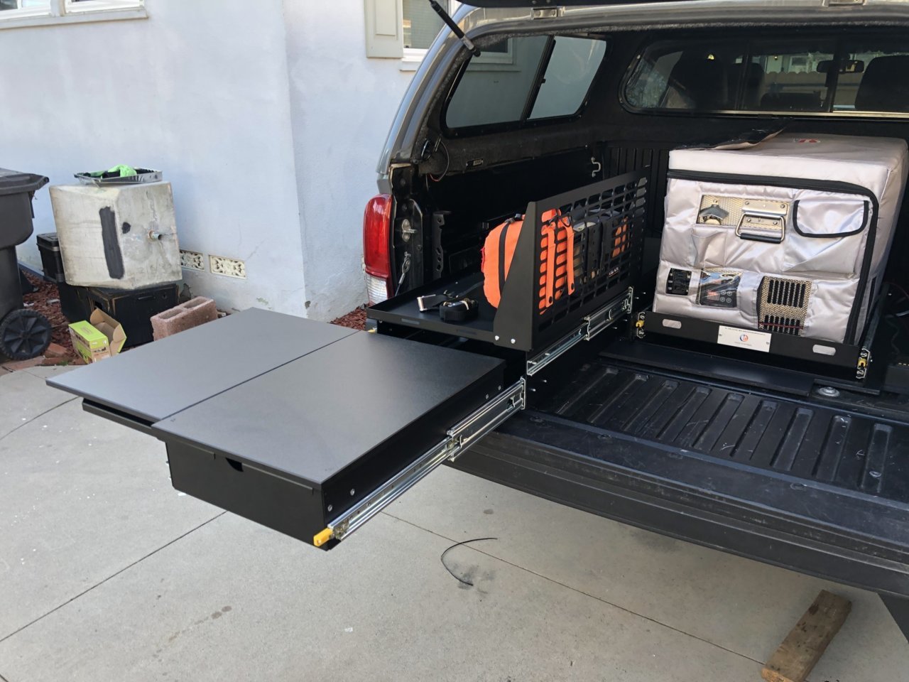

    fuck me!! I feel like i need this slide out in the rear of my trailer now...

    Yeah im not sure that i could get a fridge mounted in the back of my trailer but i could probably get the base mounted in the rear.

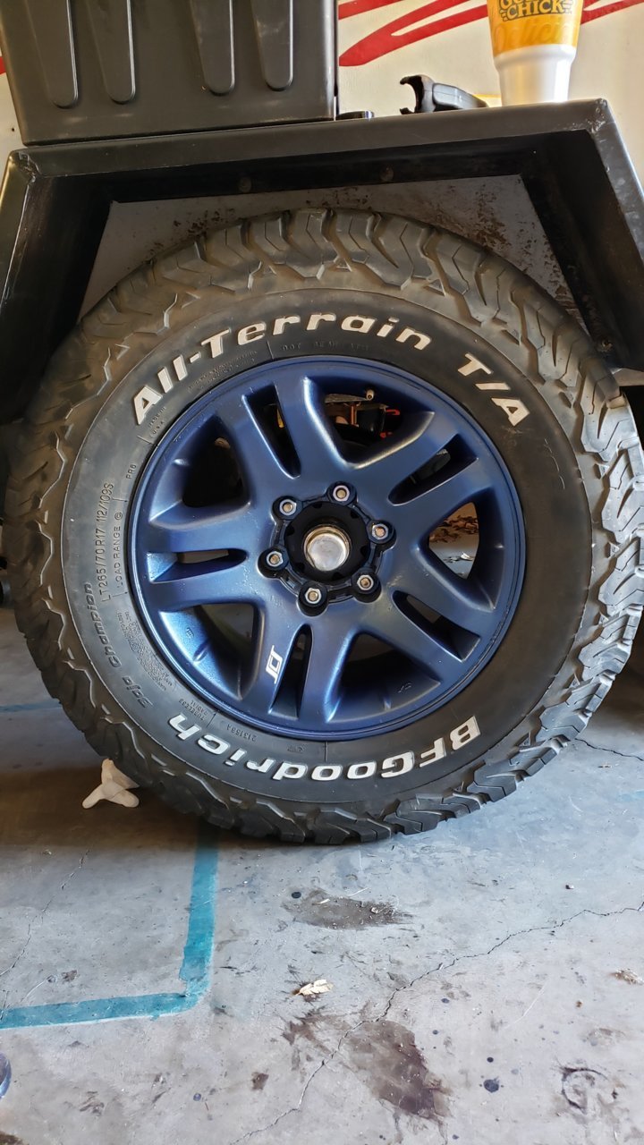

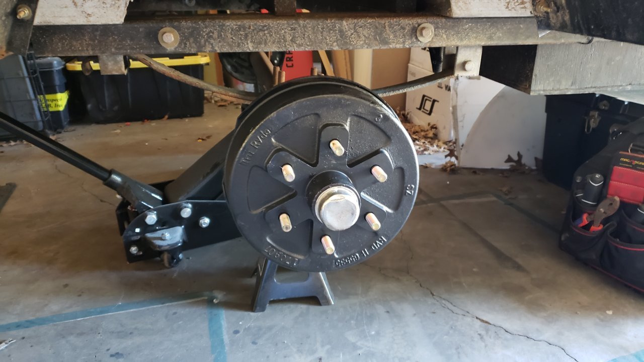

    Trailer brakes are installed
    Wheels repainted "stealth blue"

    Yup! Figured i may as well right! The trailer wheels needed to be painted anyway, so i found that color at walmart, started with a grey primer...
    Moved to a light black coat, and then a light blurple coat. Had to touch out a couple spots but it turned out pretty good.
    I had originally done just the grey primer and then a couple heavy coats of the blue, but it turned out too bright, and some of the paint was messed up.

    Yeah i sent them back. I was really debating on paying for them to go on the trailer but i felt pressured to send them back. I replied to your PM.
    As you can see i resorted to painting the wheels i currently have...

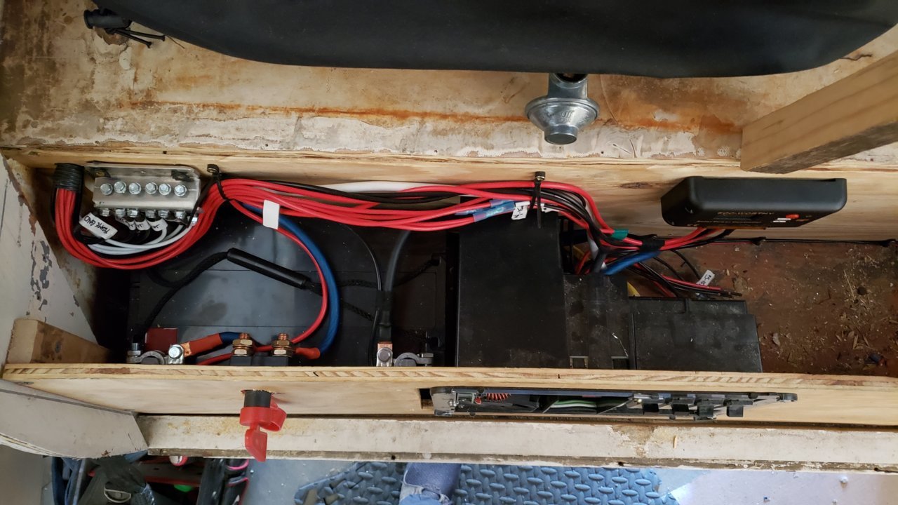

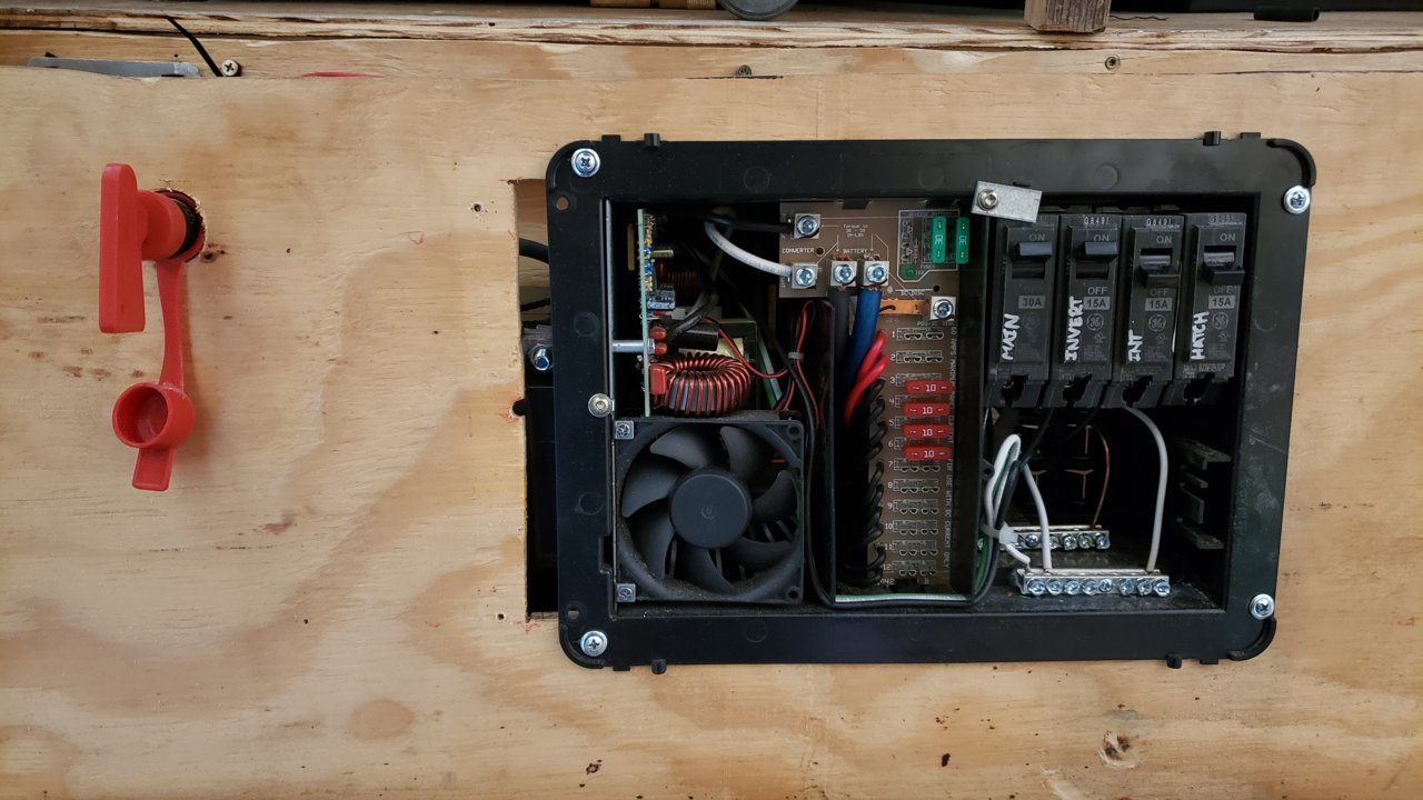

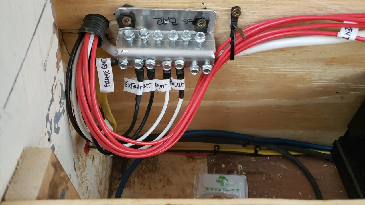

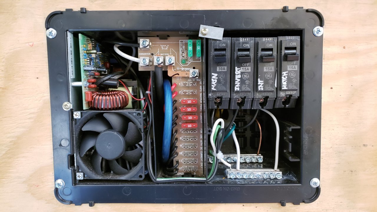

    Getting some electrical done...
    Now have AC outlets inside the cabin. DC is also powered so I can run lights, the radio, and USB outlets.
    Still need solar panels, charge controller, and 100ah battery.
    DIY buss bar...
    I fully reccomend a PD4045 electrical panel to anyone building a trailer and wants to run AC & DC power.
    Its important to know that you need 3 grounds for this unit. 1 gound goes to the neg battery terminal in the unit, 1 ground goes to the neg terminal on your battery, and the last ground is for your buss bar to ground all your 12v electronics.

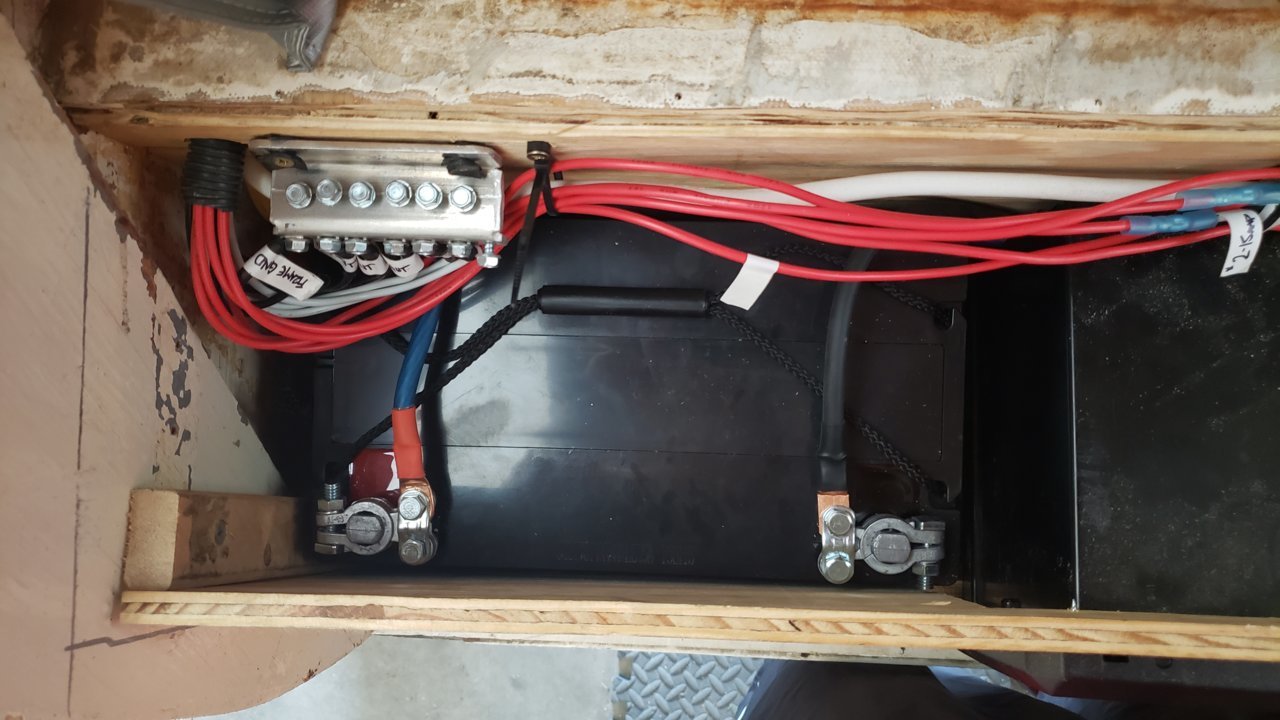

    Finally got a battery!! And it barely fits!!
    This one is 100ah, we will see how well it works with all the stuff I'm running.

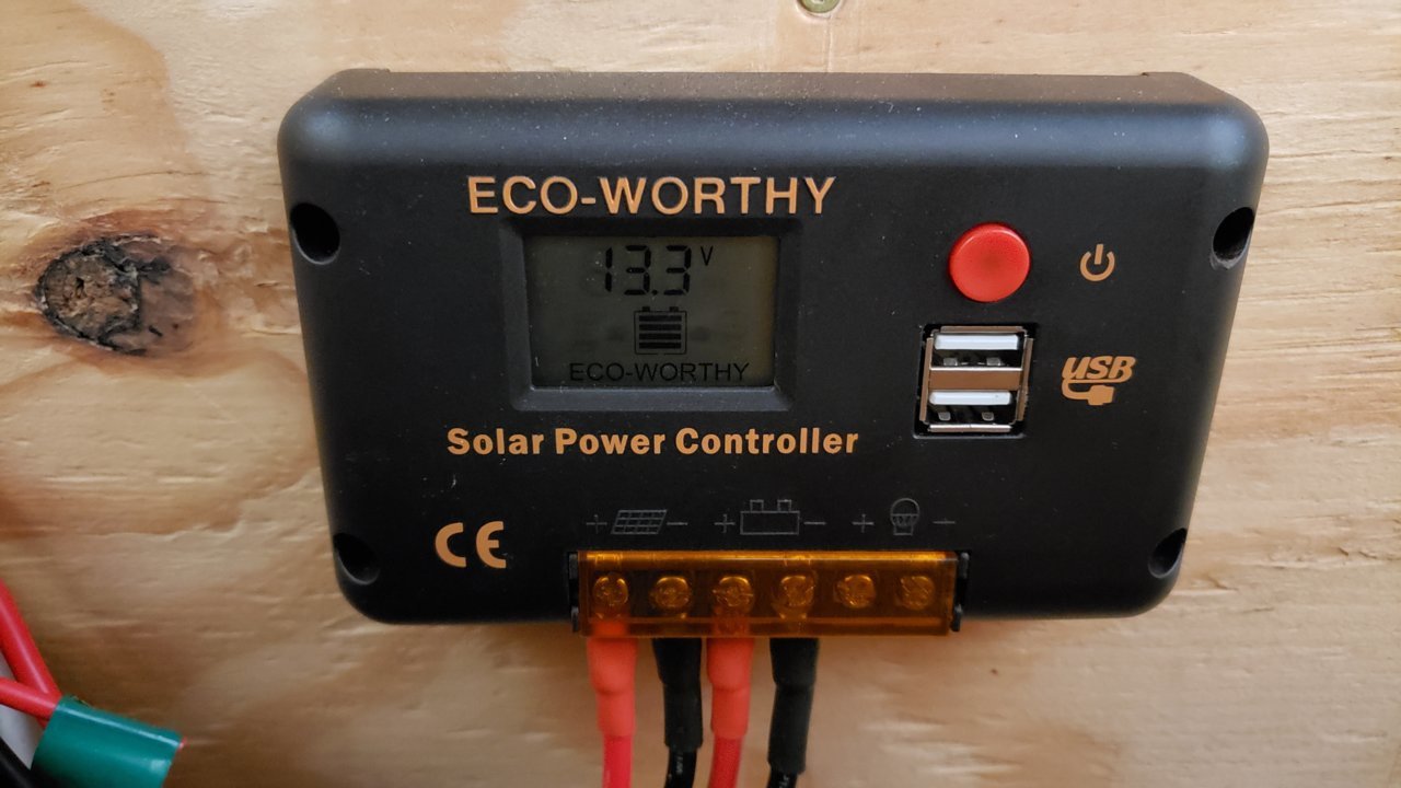

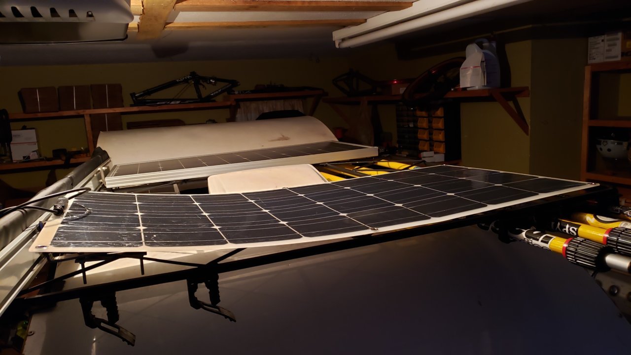

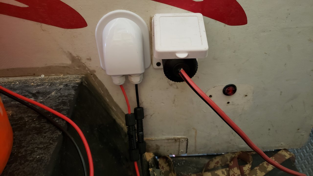

    So electrical is pretty much done. Battery shutoff switch installed, solar panel mounted, solar charge controller installed, 20ft solar extension cables made, charge controller for AC power hooked up to the battery. 30amp shore power hookups, power inverter working to run 12v while plugged in, 120v AC power strip with USB ports installed in the cabin.
    Everything will get buttoned up once the final cabinets and stuff is made/installed. I'm sure I will think of something else to do. Like an amp load display so I can see how many amps I'm pulling at any time.
    I also have a 2nd flexible 100w solar panel that I plan to set out in the sun. Once I get the rear hatch reskined with an aluminum panel I may mount the flexible panel on the hatch and then set out the framed panel. (Had one purchased but it burnt up in the fire at my parents house) Will probably work better when trying to lean it against something.
    Electrical compartment
    Fuse panel and battery shut off switch
    Solar & Shore power hookups
    Solar panel attached to roof rack, flexible panel is just up there to be out of the way at the moment.
