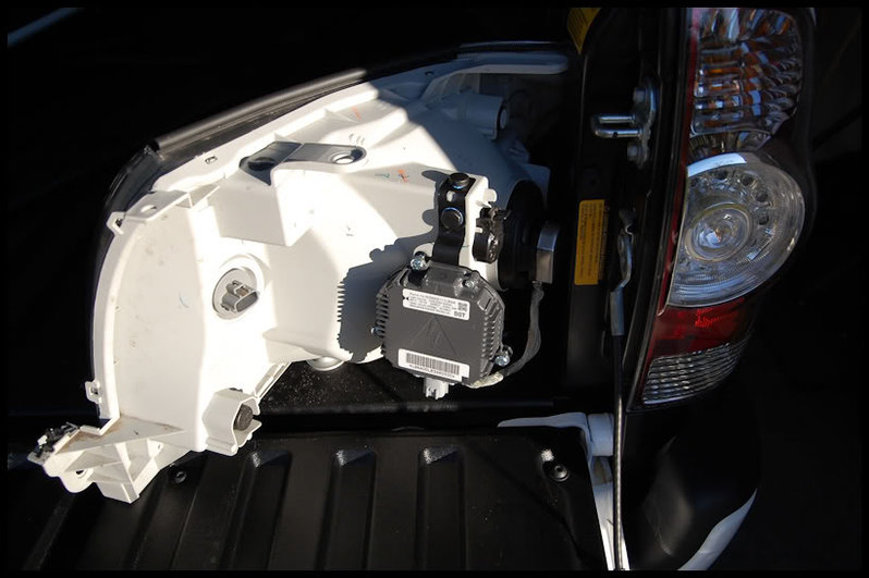

    Getting ready to do my retro soon. I got an extra pair of headlights so I can take my time to do retro and run the harness and swap out the lights when done. Where did you mount your ballasts?

    on the side like the attached picture, but i used industrial strength velcro

    agreed! simple and does the job. Hasn't moved or fell or lost its grip since then.

    How did you attach that bracket to the headlight housing? Did you drill 2 holes in the housing to attach it? I have a pair of Matsuhita ballasts and some Morimotos as well, trying to figure out which would be easier to mount.

    With the morimoto ballast, i used the supplied bracket and mounted the same way as in that picture. Used one self tapping screw on the top and industrial velcro behind the ballast to further support it. It's solid and looks almost oem.
