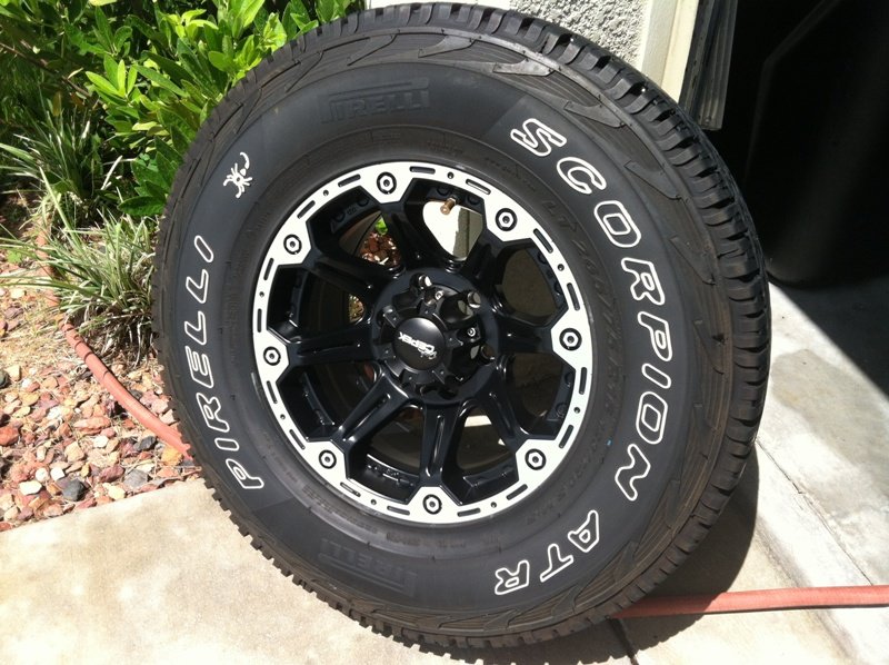

    Well after searching Google and this site for way too long I have decided to possibly help someone that may be in the same boat as I was.
    I purchased a set of DC Torque 16x8 wheels last year and had them mounted to my 2008 Tacoma by a Toyota Dealership in Tampa (Toyota of Tampabay). They were mounted using the conical lugs provided at the time of purchase specific for the Torque wheels.
    I recently traded in my 2008 for a 2012 and as part of the trade I kept my wheel/tire combo. I was doing some work this past week and took off the wheel for the first time since purchase. To my surprise the lugs came off at approximately 4 1/2 turns as opposed to the minimum 8 turns needed for the 12 x 1.5 - I immediately started getting paranoid about this and searched for a solution that would make these wheels solid (IMO at least). I decided that longer lugs would be out of the question at this time and went with a set of Gorilla Lugs E/T conicals.
    I installed them this weekend and had no issues what so ever. I am now fully seated with no less than 9 turns and feel much better about the install.
    All of this being said, here is the short and curly of it all - The Dick Cepek Torque wheels do work with the Gorilla ET lugs - Part number 21133ET

    hello froridaoccifer, what is the backspacing of your wheel?
  4. Jan 17, 2013 at 4:55 AM
    floridaoccifer
    floridaoccifer [OP] Civil Servant
    Jan 14, 2009
    #12582
    778
    All info is on DC website
    4.5 backspacing / 0.0 offset / 22lbs / bolt 6x5.5
