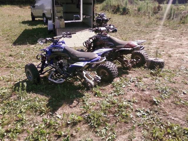

    Dont know what kind of riding you do but G-force isn't always the best choice, but then I have broken most brands. the pic below where both g-forces, broke 2 in one day.
